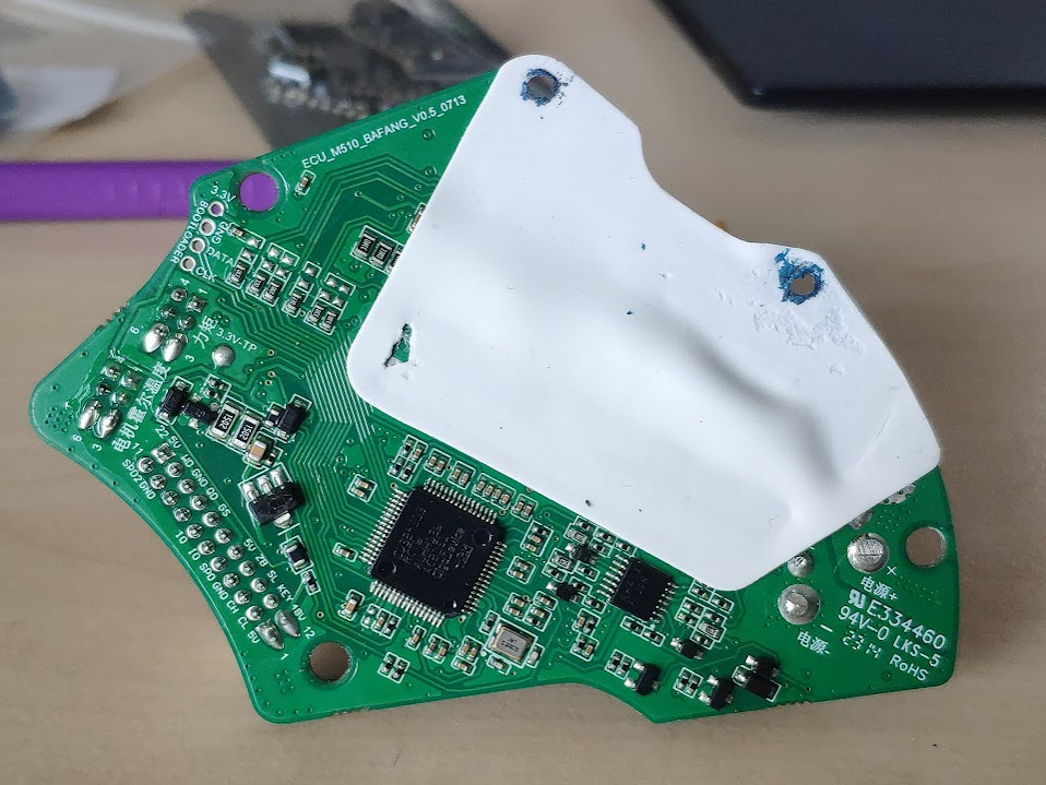

MCU: GD32F303RCT6 (basically STM32 alternative/clone)
FETs: 12*CRSM033N08N4
Hall: MT6818

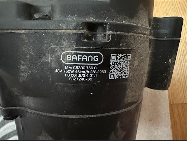

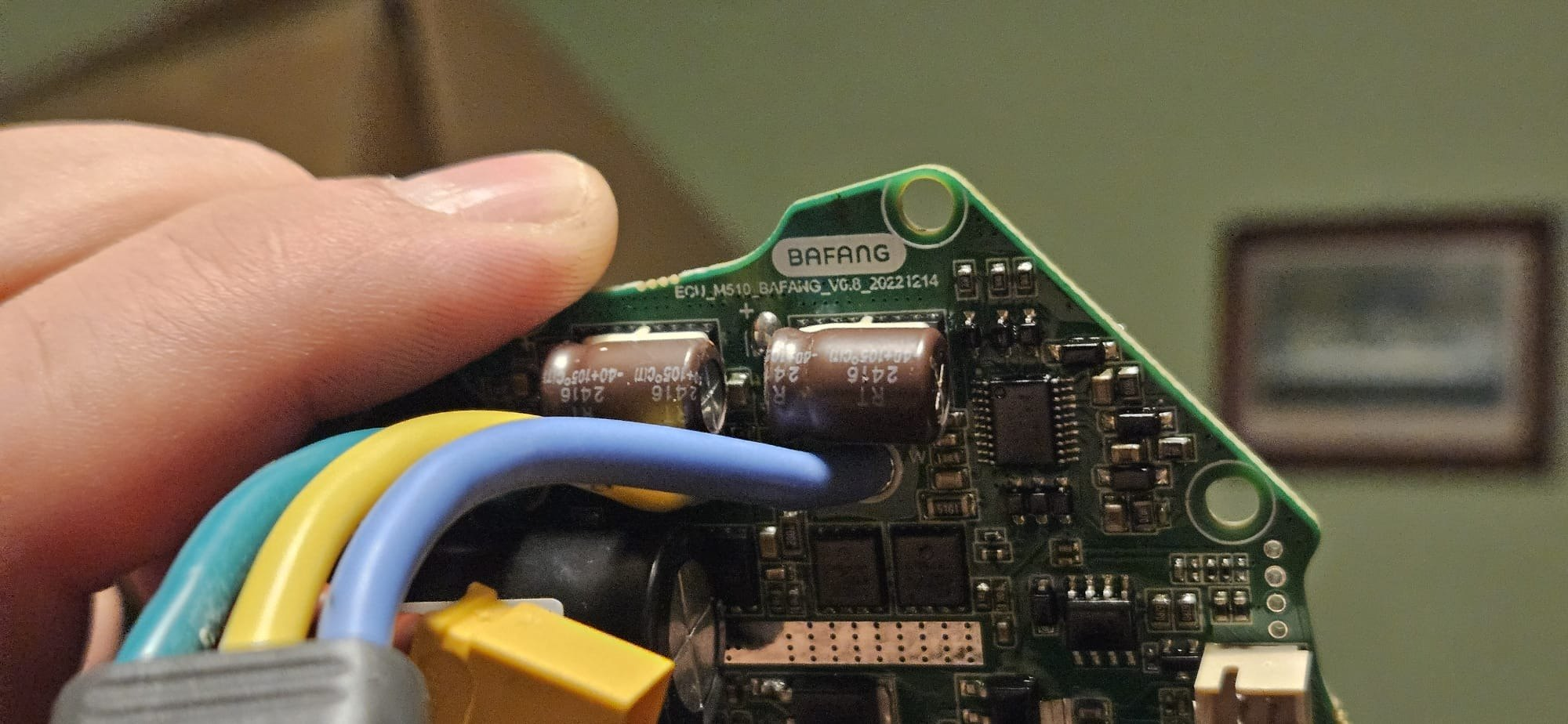

Guys, two weeks ago I've received M560 with board ECU_M510_BAFANG_V0.8_20221214
Do they still use boards from M510 for M560 motors or did I get an old lemon ??? If we consider how noisy it is I would say it's from first batch of these motors but why would Dengfu still sell this ? Label looks like this:

Therefore it would be good if someone who got motor recently can open it up and check internals.

You can't even set wheel diameter there, from factory it comes with 28" diameter - WTF is this ?
You can order it with whatever wheel diameter you want but to change it you need besst. It's because you could easily make the bike illegal otherwise.
The 28" wheel diameter is correct for 29" tires. Because it's based on the rim and not tire itself. It would vary too much based on a tire people would use.
