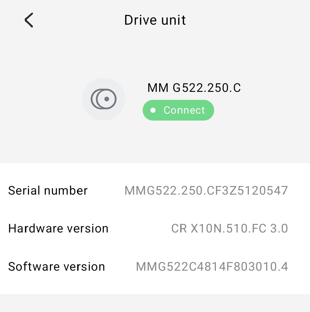

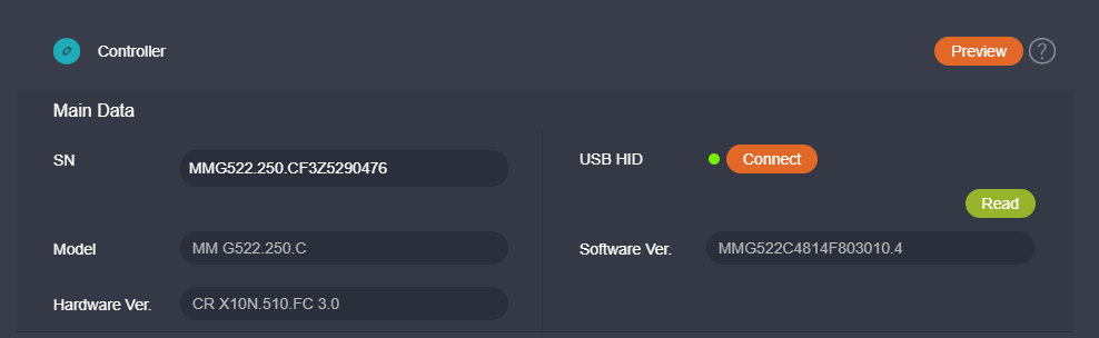

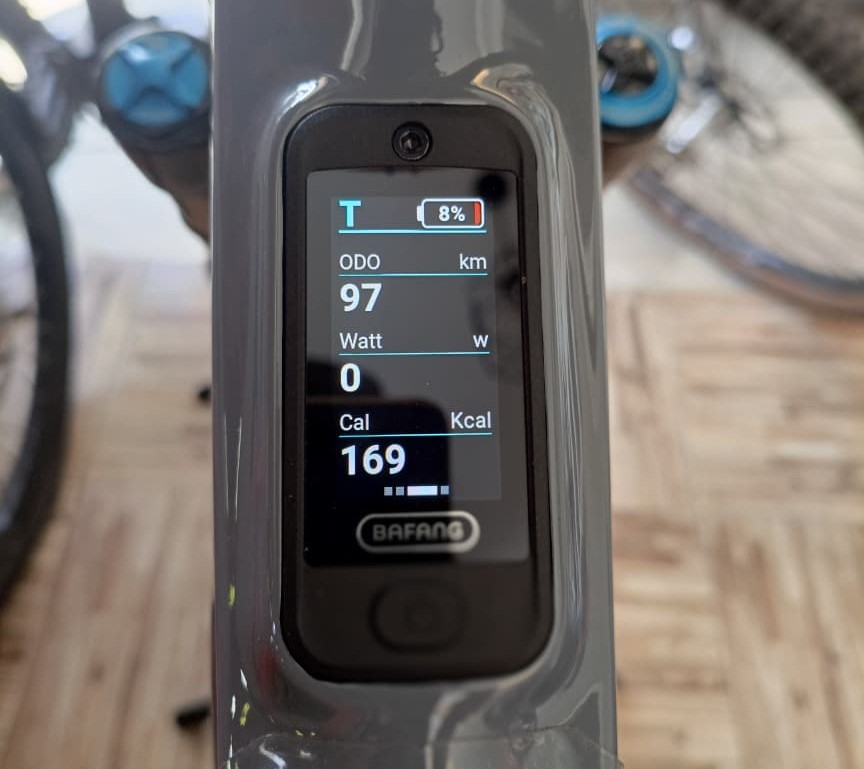

Tested Bafang M510 3.0 version with CEF69 frame and 720Wh battery. Total 97km, 2050m EG battery 8% left and still can pull up to 300w power. Also the walk mode now can get enough power. Very good update from Bafang although maximum power only 600w, maybe more power power can update on next firmware.

Who/where did you get the 3.0 controller from? Thanks

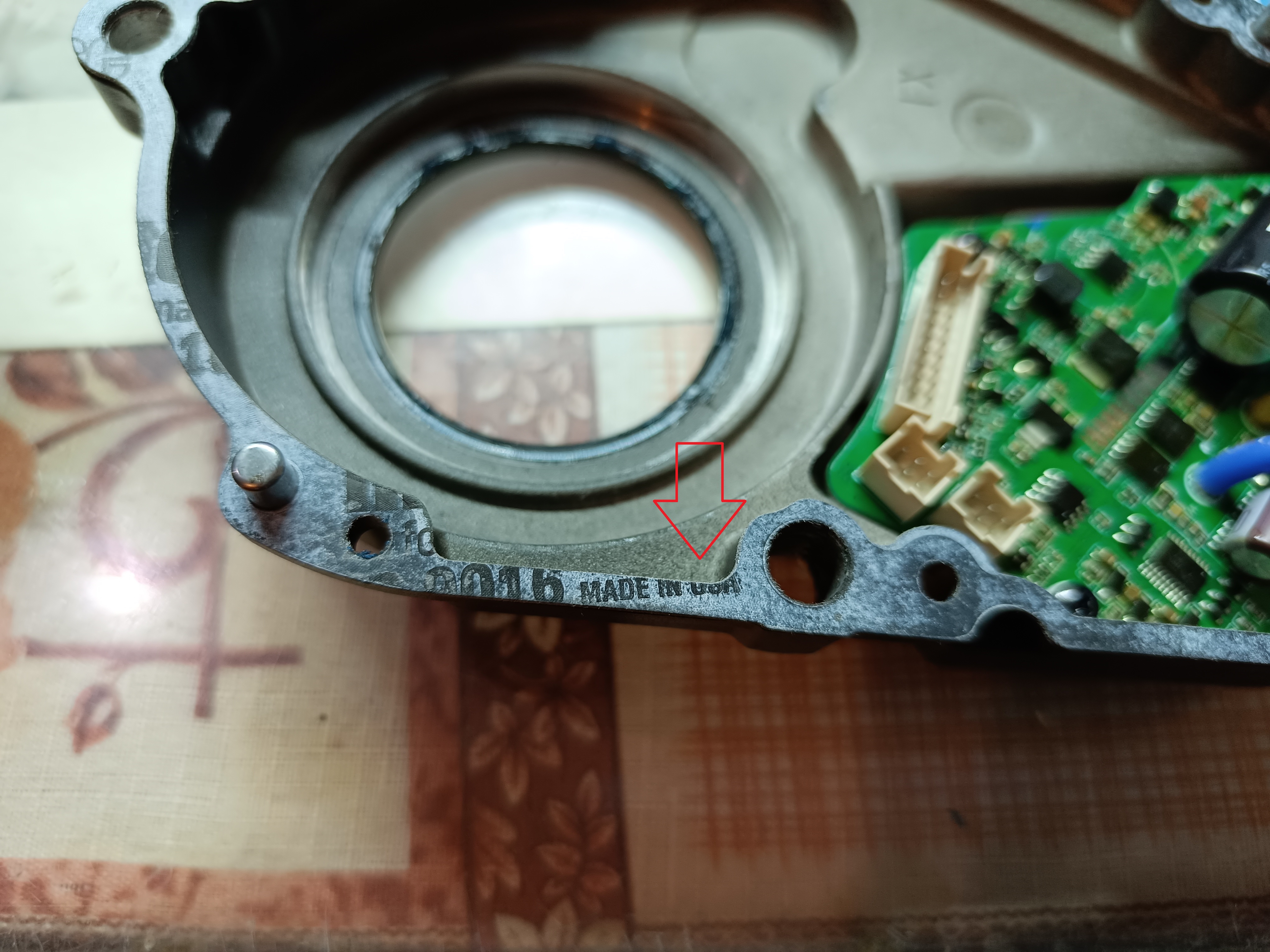

I found some strange, or it is only fantasy? I clear see "Made in USA" on main m510 gasket.

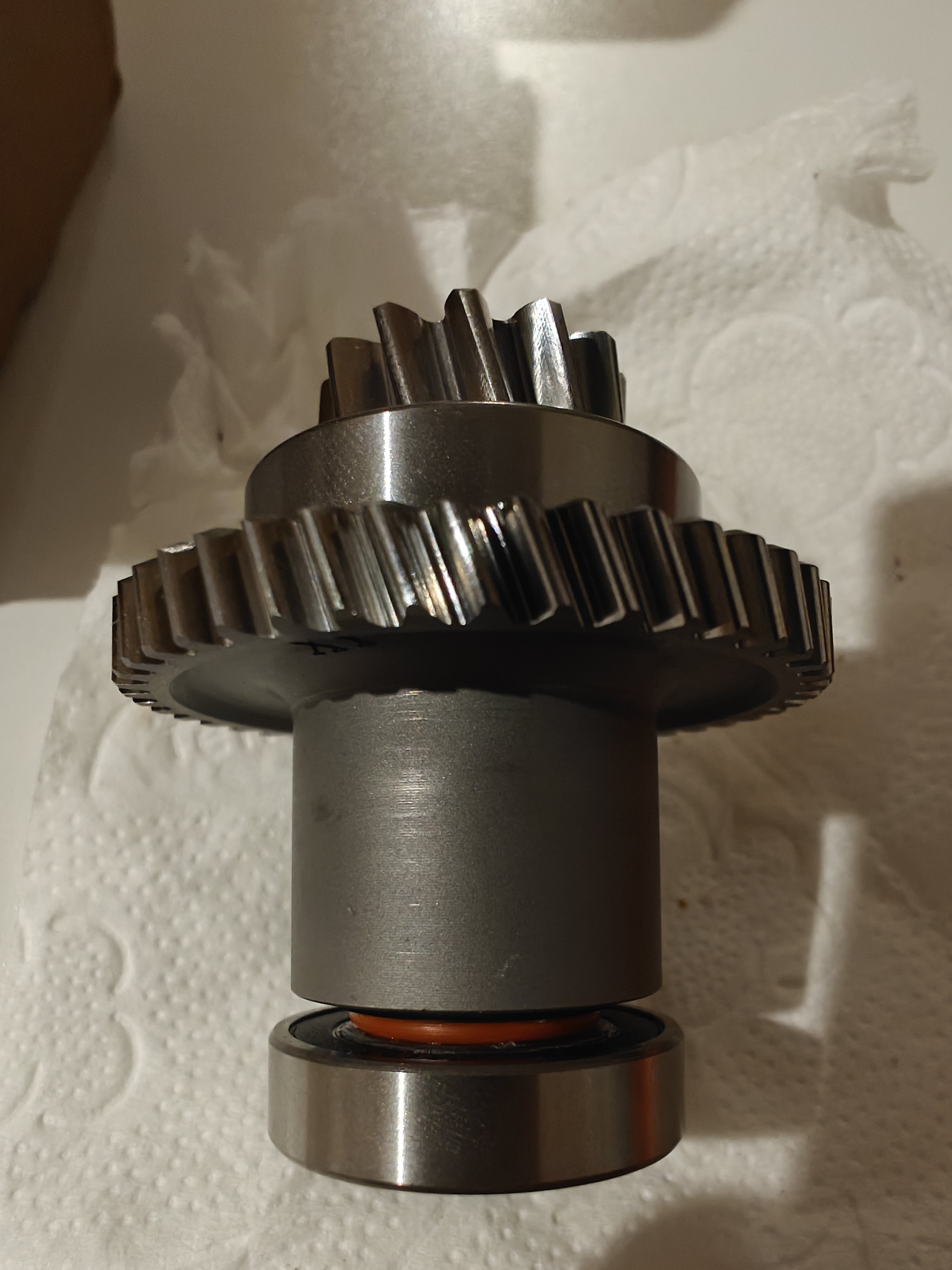

Have finally gear with one way bearing for M560. After half a year!
Had an idea. To replace it with normal gear pair, with solid shaft. I dont care If rotor is turned with pedalling. And should stand even more power...
Sorry, for out of topic.
I tried to firmly lock these gears. Unfortunately, the controller throws an error if the rotor spins when it shouldn't. You can only ride with the throttle pressed.

It's impossible to even start moving without the throttle trigger. If you ease up on the pedal while moving, causing the motor to shut off, but continue pedaling, the controller initially shuts off the motor without displaying an error. If you stop for a while, the motor works again. If you continue pedaling, an error appears. Unfortunately, I don't remember the error number.

Hmmm, does not make sense to me. If you pedalling with some assistance, controller can not know you have locked that gear. Interesting.
On PAS 0 when you pedalling, then you regenerating (with locked gear), there are some voltage spikes and this maybe cause the issue and controller is shutting off. Good to know.
