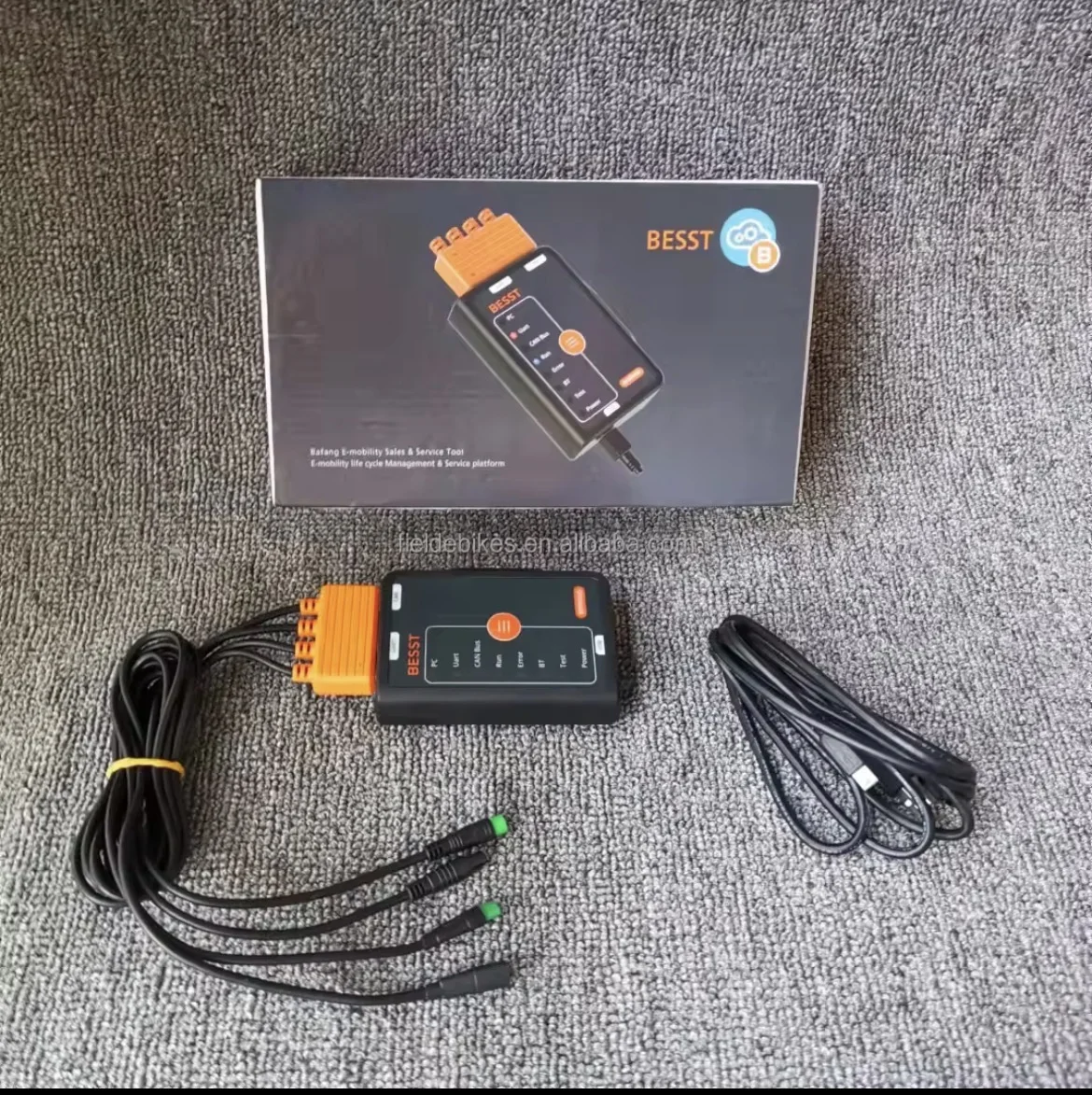

And for calibration i need to use besst pro tool, right? What cable do i need to connect the M510 to the PC? In Chilis shop there is a cable listed as well. Is the one with the black box and the orange plug the right one to choose as attached to the post?
There are also some cheaper USB Plugs with a Button on the USB Plug and Bafang plug and socket (house form) available.
No worries mate.
From Europe or Germany, controller can be more expensive. Yes, from Chili is great (3 weeks delivery). Or also from Aliexpres (that can be with u in 2 weeks).
Dont worry about cables, it will come with Besst. It is that one with green house shape and cabling instead of display. You would need to run rotor calibration after swapping controller (or when swapped rotor).
