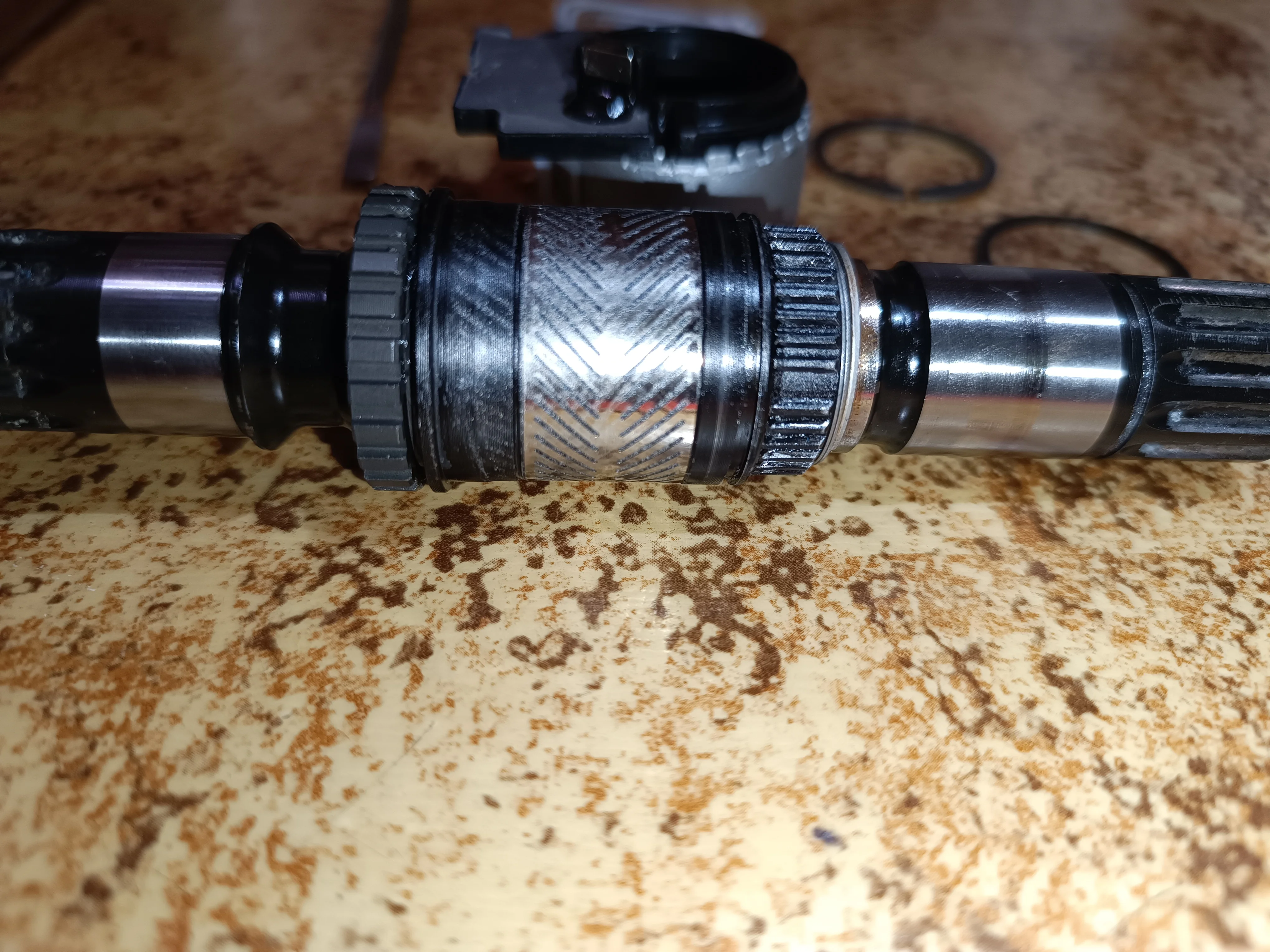

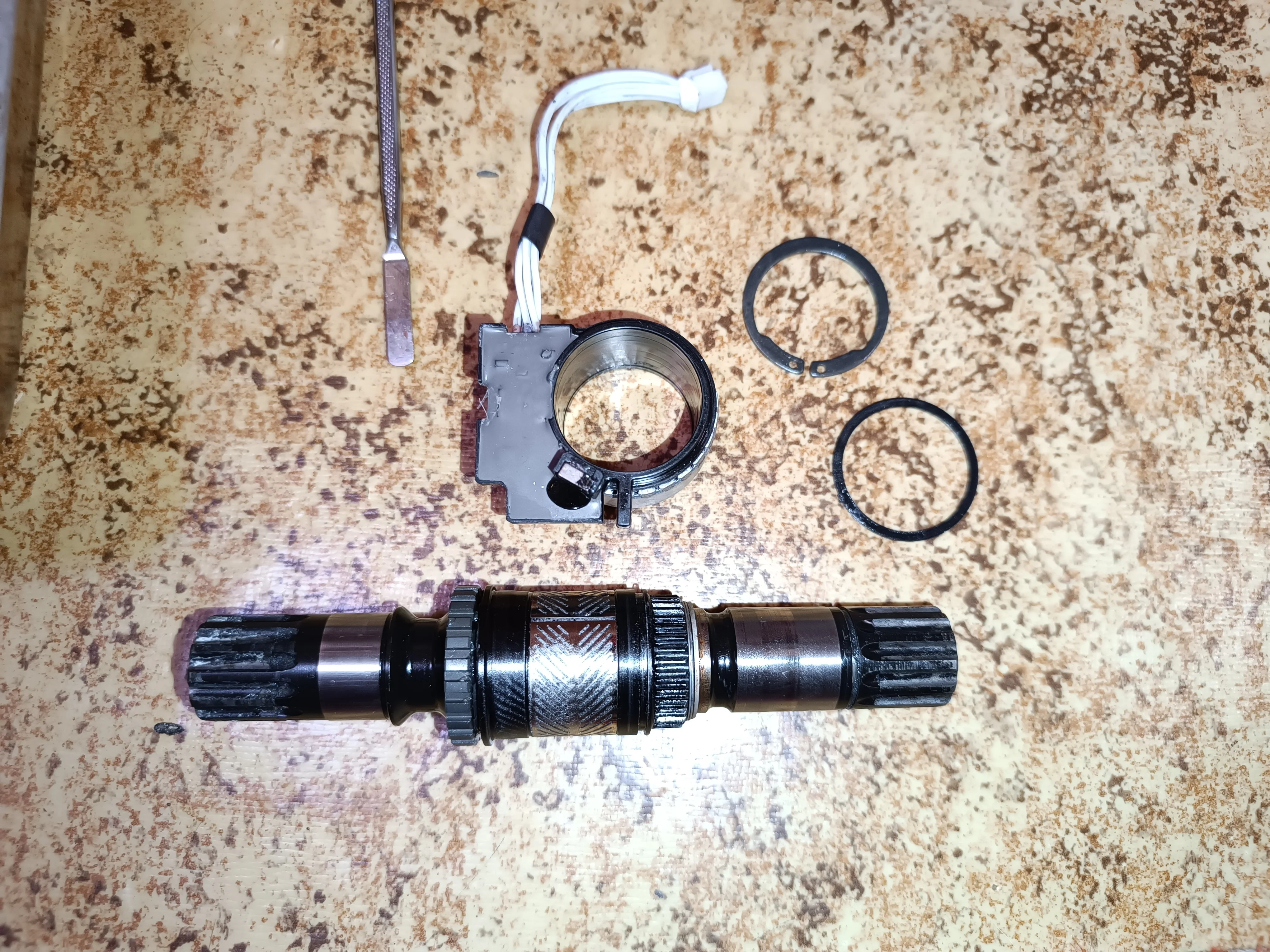

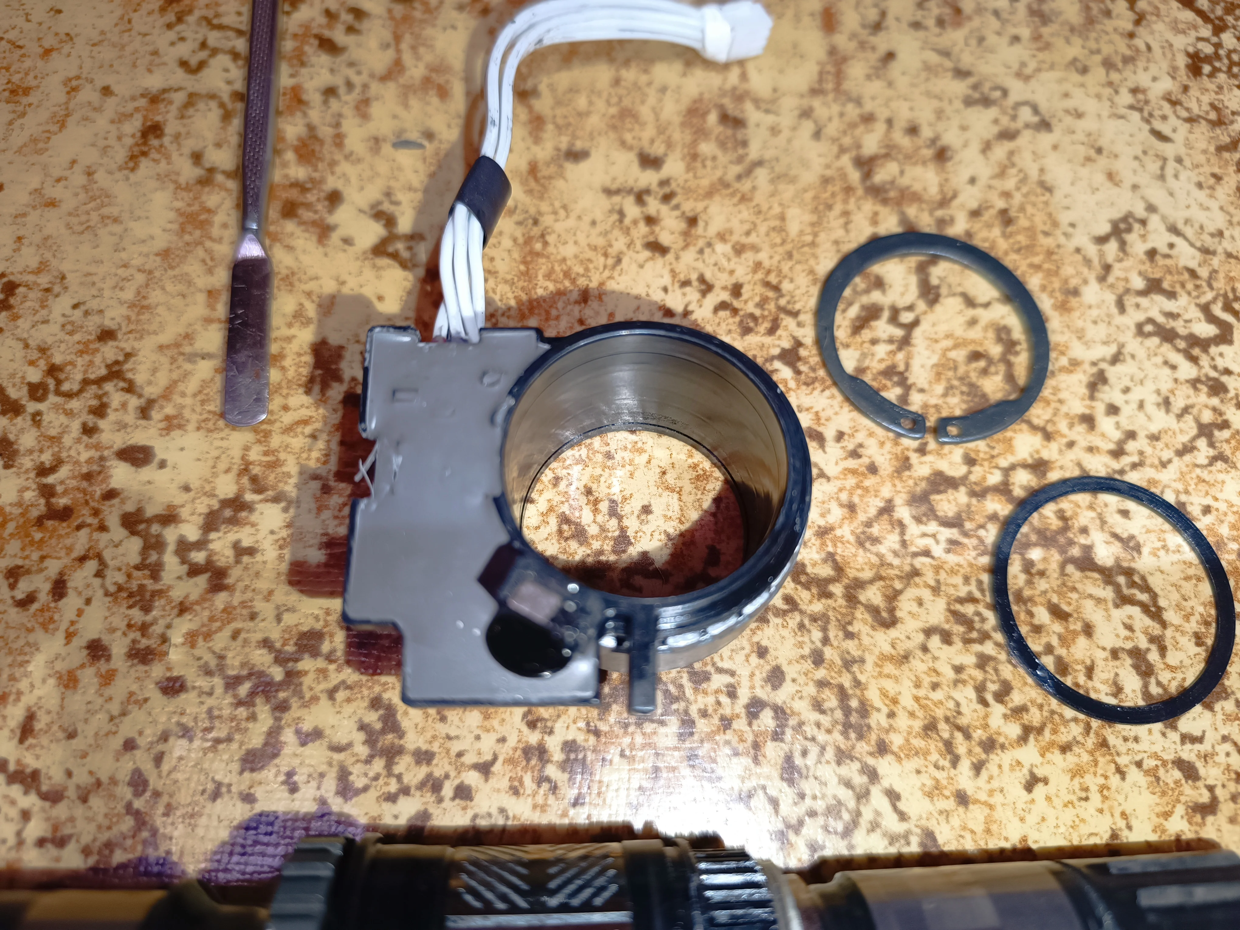

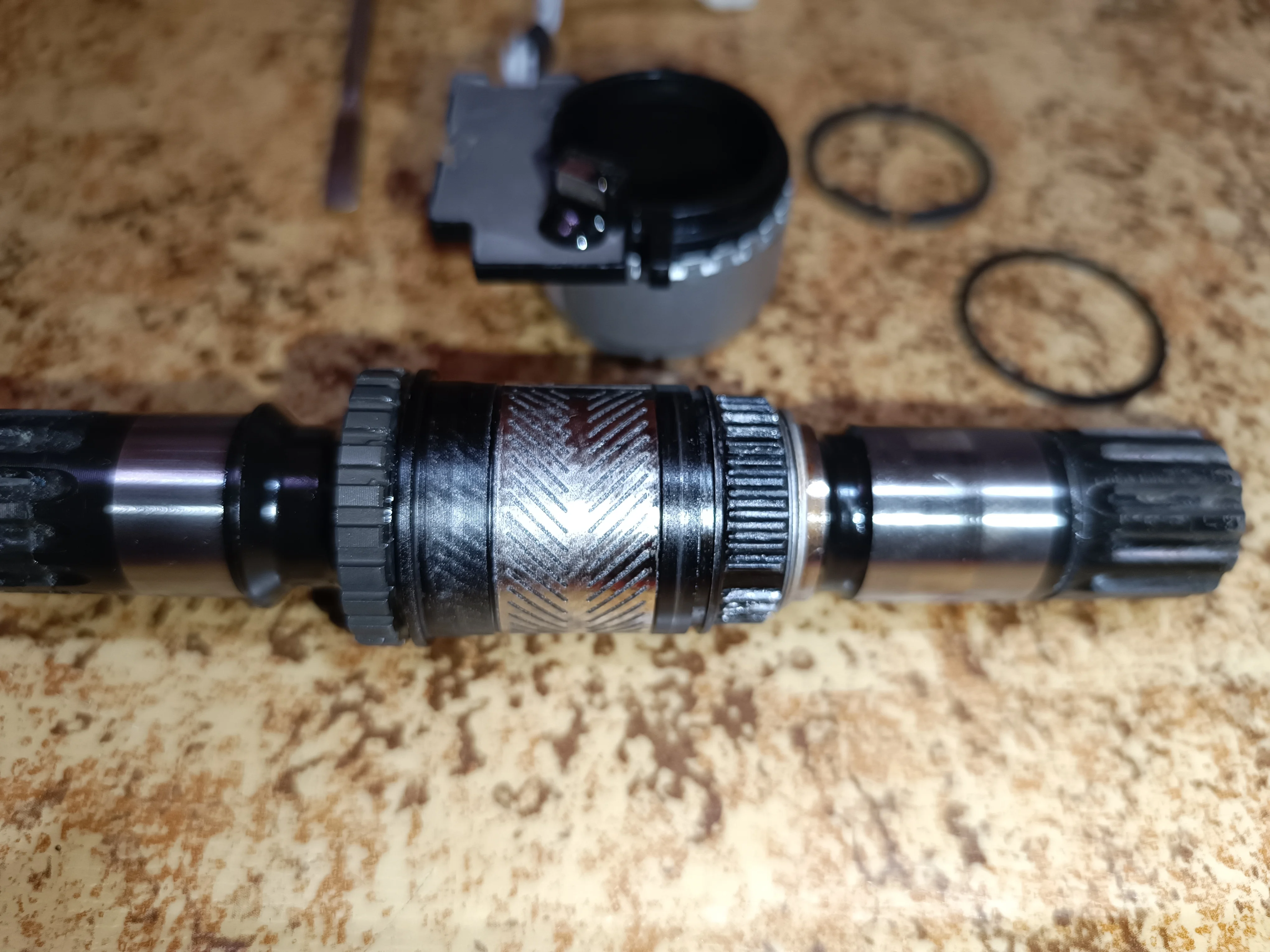

One day motor stop support at the middle of trail, disassembly it at home and found signs of water inside. Magnesium chassis also damaged and corroded. When I take torque sensor it was wet with white signs of water on metal and on sensor sheet.
My first attempt to recover it was failed because I clean it, take away any white corrosion by Scotch-Brite, and lube it with thin oil for protect from water (it was failed decision) - when I assembly for test - sensor not work.
Second attempt was success - I take away metal cylinder with sensor sheet from main axle, de-grease it, and wash in water with hand-clean soap. After I dry it and heat with hair dryer - not overheat, just to remove water. Assembly for test and it work! Take 7 rides after repair, sensor work without problems, acceleration feelings like it was before.
Pictures from my second motor that has not water inside and sensor work, but I saw white lines too, don't touch it, will wait when it failed =)
Main warning - don't use abrasives and don't try to remove perforated metal sheet from metal cylinder if you won't buy new sensor. Everything is at your risk.

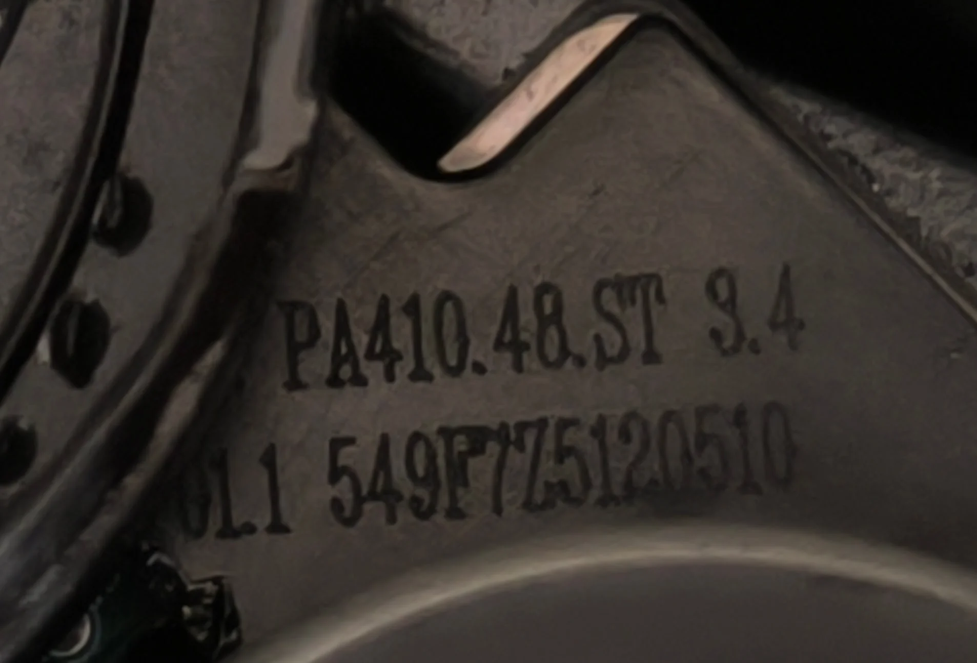

Do you buy any chance know the marking of the torque sensor? I am considering of just getting the newer controller and 3.0 torque sensor
With marking of Torque sensor is kind of weired.
You need to believe to the sticker - behind the "/" is Torque sensor label.
Or to open it and check on a torque sensor itself.
In the begining (M500, M600) there was torque sensors with CAN bus and you could have seen actual torque sensor on a display. Then they changed torque sensors to analogue output and you cant read serial or HW type of torque sensor.
And now with M560RS Besst is again reading Torque sensor numbers. But funny, I am not measuring CAN bus pins on a torque sensor connector. Controller could fake the response.

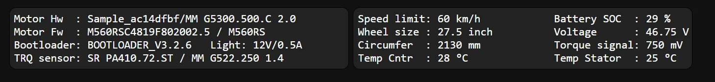

This is M560RS:
72 impulses per revolution.
And now thinking as it is again reading TRQ sensor, if bafang did not move to something else like SPI interface. Need to measure it.

The 560RS torque sensor output was measured with VESC Tool and VESC for Bafang M560 motor controller. It starts slightly below 0.75V at no torque and probably goes to about 1.5V or higher at maximum torque.
The controller processor reads the torque sensor voltage to determine the PAS torque value. If you see any PAS torque sensor related information on the Bafang display then it was sent to the Bafang display from the controller processor through the CANbus transceiver.
Looks like it really reads from sensor. Has also longer timing. But yes, could be still faking by controller.

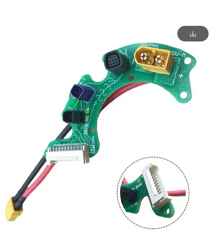

I wonder if that small interconnecting PCB has become water damaged and the ribbon cable connectors have become damaged ? We had a not unsimilar problem with the very first batch of motors with the startup voltage not being correct ( resistance of the connector ).

You can try that connector PCB board to swap. Thast not expensive. But I am rather sceptical if this will be it. When this board is watered and oxidated then usually power on/off miracles and Error 30.
