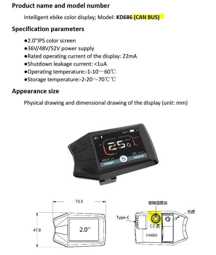

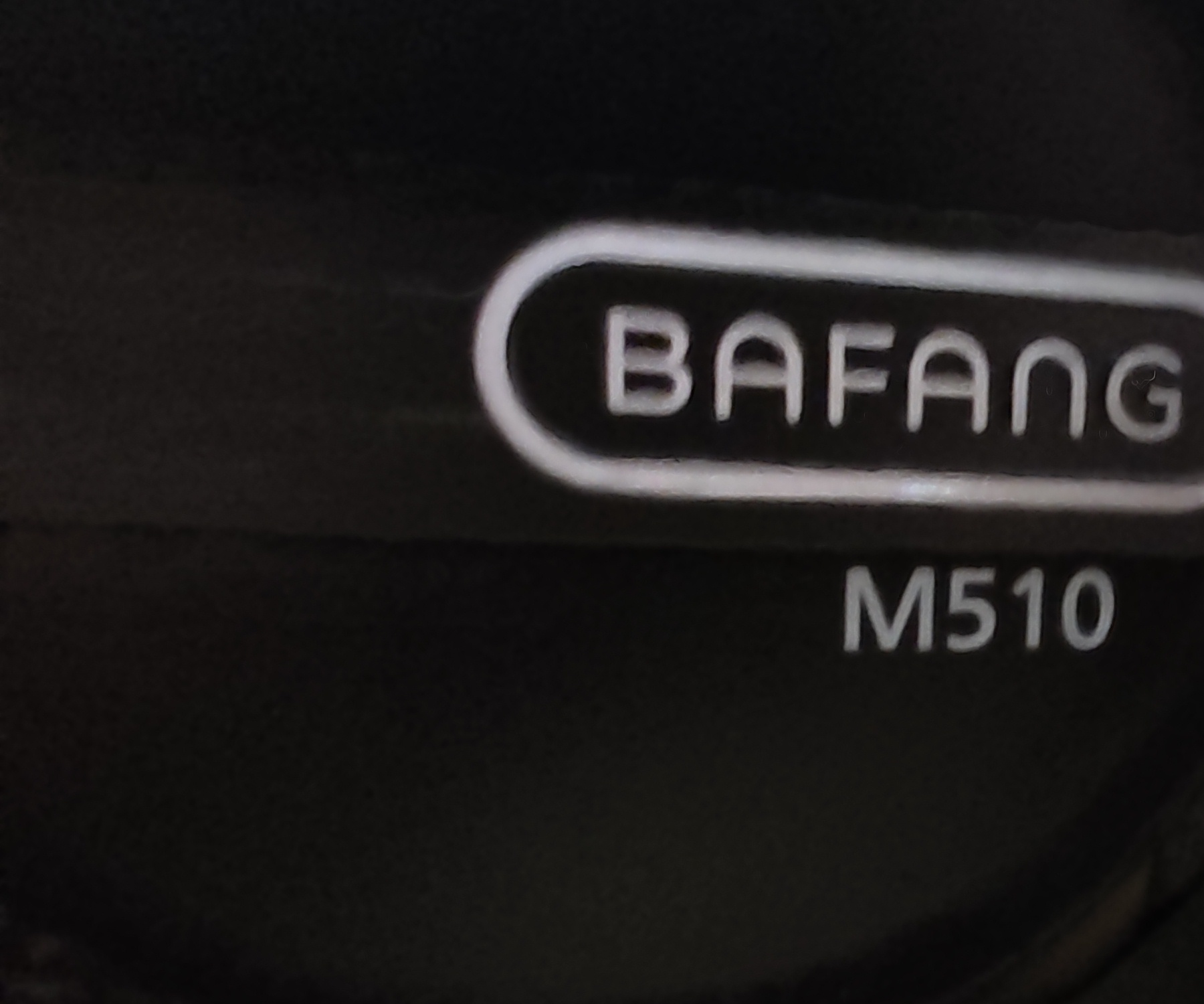

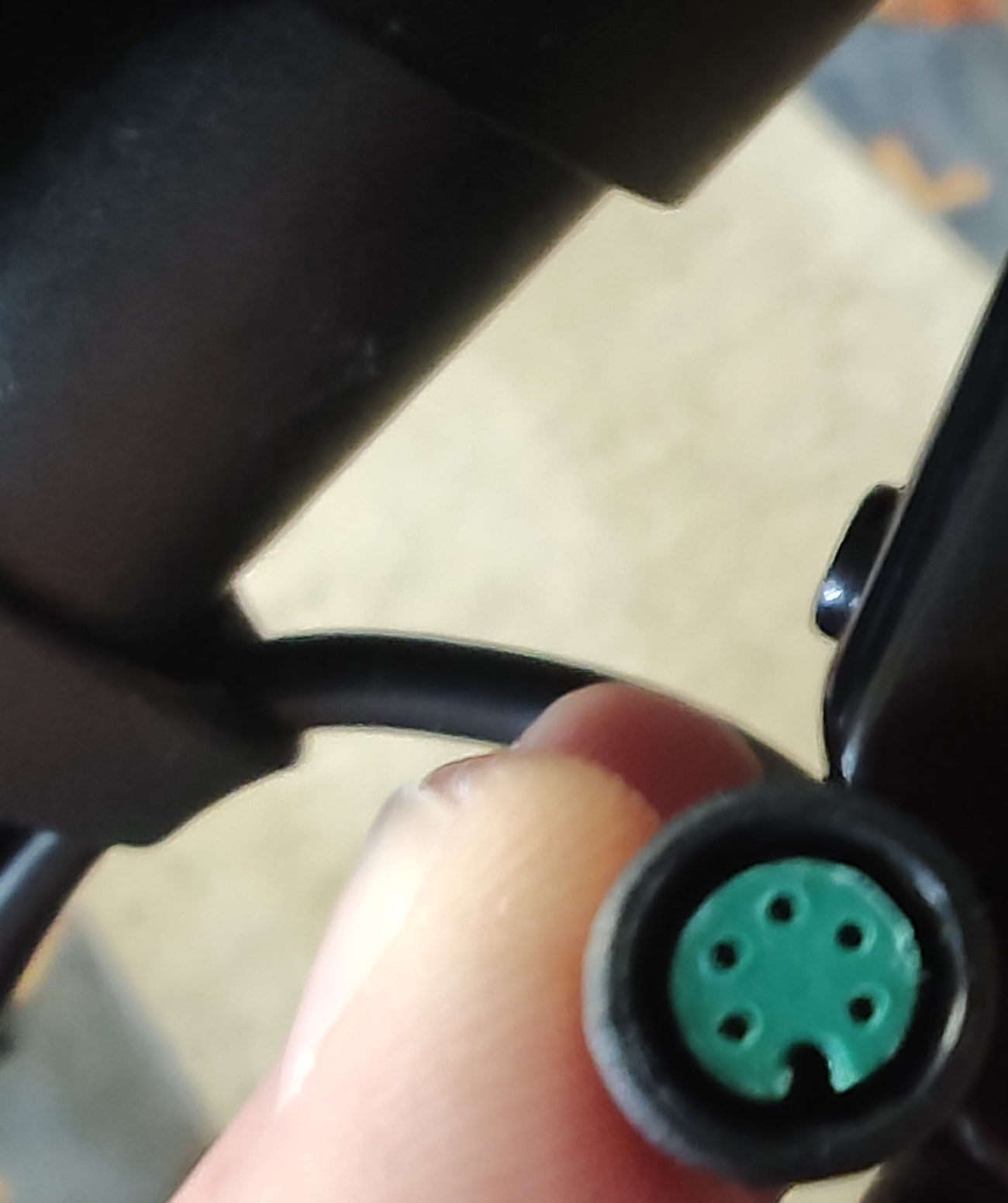

I would like to ask about my Leaderfox E-Bike with Bafang M510 Motor. I tried to read into the topic for quite some time, but would still need a bit of help to understand all of this.
I read, that the Bafang M510 should already have pyramid-shaped CAN BUS type Connection to the Display - but on my display, there is a round UART type plug (please see pictures).
Even more confusion for me is, that the Display Manual (Type KD686) also shows the round UART connector but mentions the display being a 'CAN BUS Model' - which I tought always have a pyramid shaped connector.
I have the intention to find out more - as I want to adjust the speed limit on my display/controller - which is obviously locked at the moment. We have some where nice offroad mountainbike- and race tracks where I live that I want to try out with some more motor support ;)

Hi, I think it is CAN, look url COMPTEUR / DISPLAY VAE LEADER FOX KD-686 COMPATIBLE MOTEUR CENTRALE BAFANG SUPPORT CAN BUS, CONNECTEUR BAFANG G5.4 3700948290743 - P2R
So you should trace wire from display inside frame to found normal CAN connector.

Now it makes sense (to me) - so it is the cable that has different plugs on both ends.
Since ncs mentioned that the motor could be locked I guess I have to forget about finding a solution and have to accept it then.. Sad :(

You should trace wire from display inside frame to found normal CAN connector, if you found it you can buy (take from someone) BESST and use loginbypass.py + old version Besst soft try to set speed limit you want.
