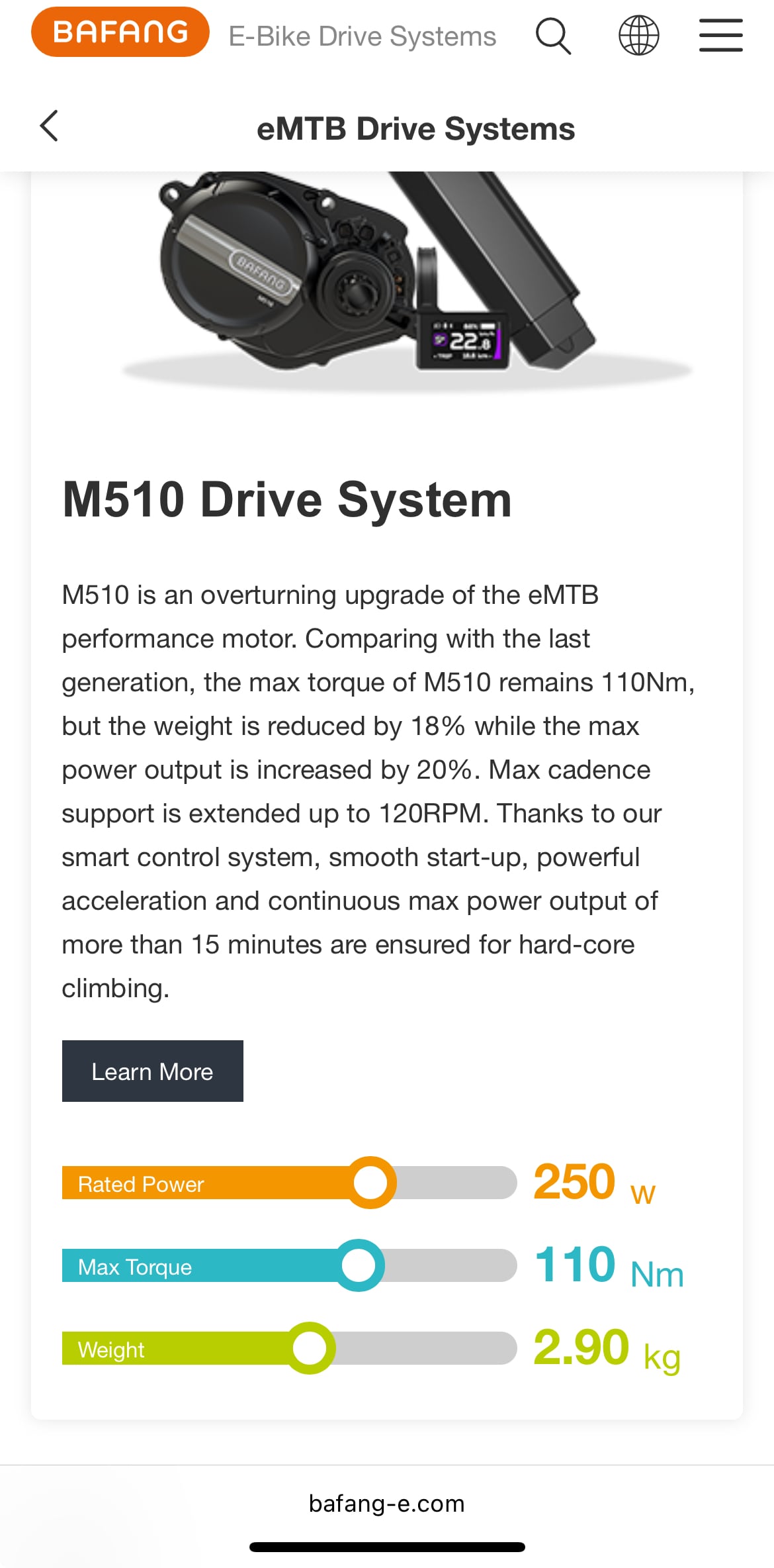

We received extra marketing 15Nm :) hopefully Im waiting for firmware with this extra 15Nm
Meaning this? 110NM??
Yeah they seem to have gone and increased the torque rating on at least the M510 and M560, I think the M820 is now higher as well? Don’t remember the exact spec of the M820 before. Assumptions is some sort of firmware update will be coming at Eurobike that’ll unlock a little extra power.

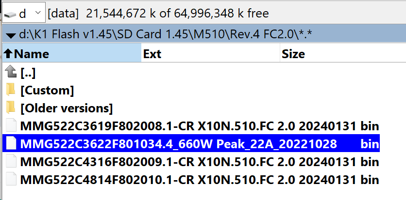

It is proportional to current, so 95 to 110Nm is +15% , so it should be 19A to 22A
There is a 36V and 22A firmware with K1 Flash (Oct. 2022 compilation)

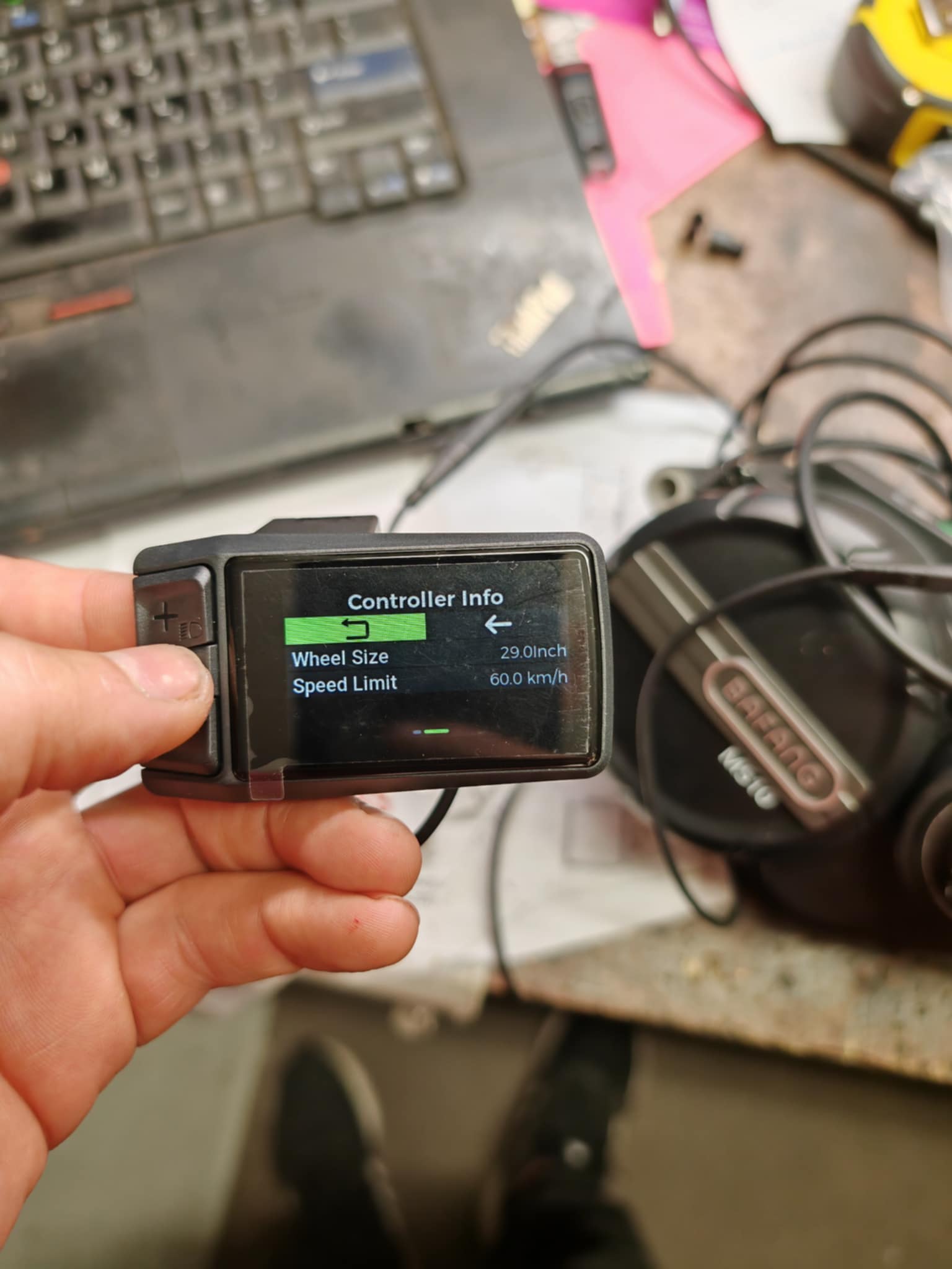

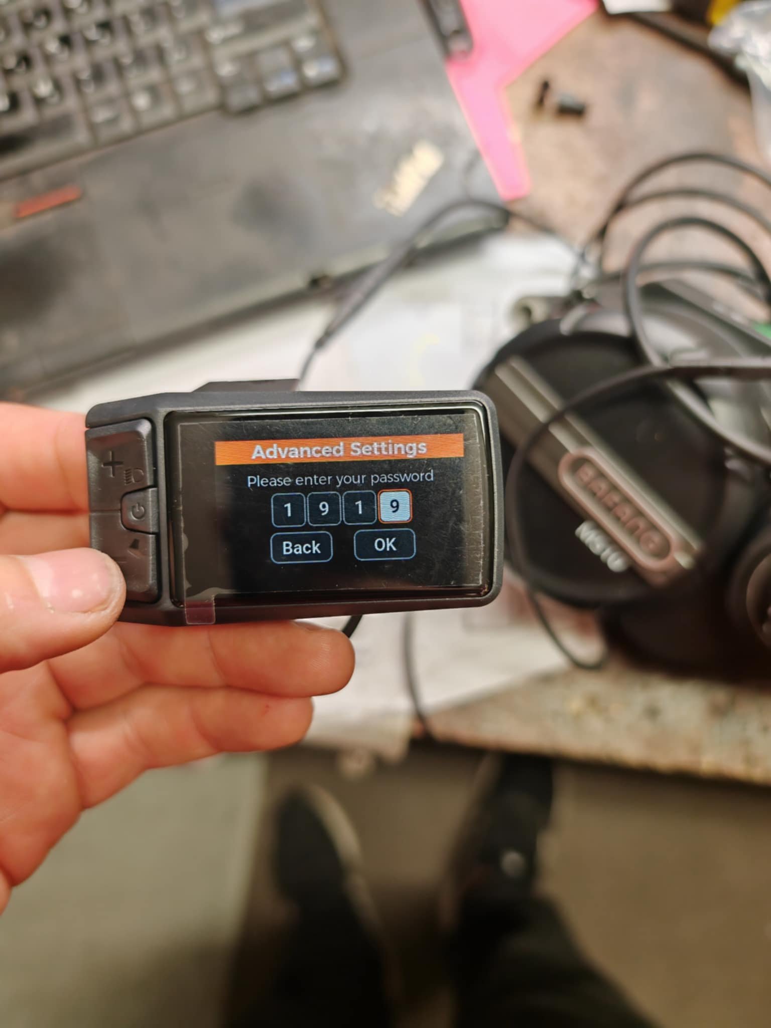

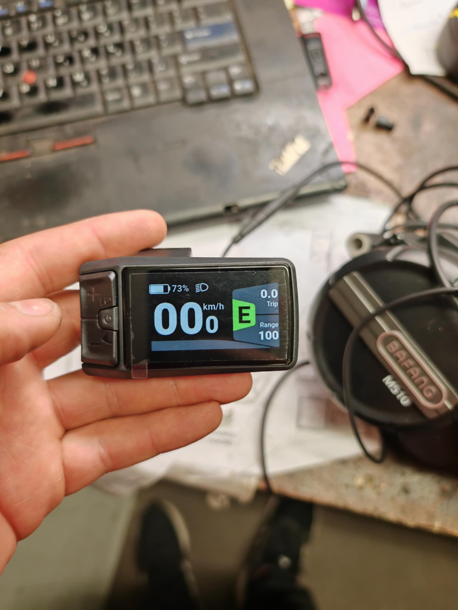

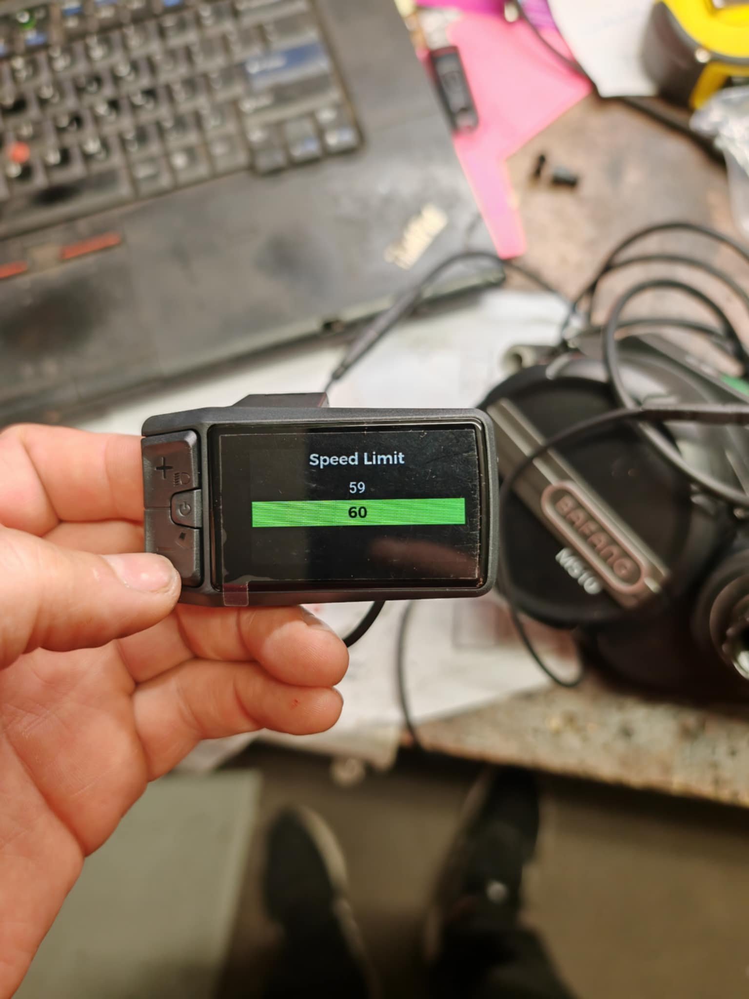

Warning, top secret information bellow, please do not share the secret password :D:D:D for advanced settings.
  • Like
Reactions: ncs
The m510rs might be a nice upgrade in therms of power delivery and overall motor feeling experience.
Who knows when it will be available.
View attachment 163351 View attachment 163352 View attachment 163353 View attachment 163354
borysgo2 please, what display are you using? I broke the C600 holder yesterday and I don't think I'll be able to fix it. Can you switch percentages/%/ to battery volts/V/ on your display?
