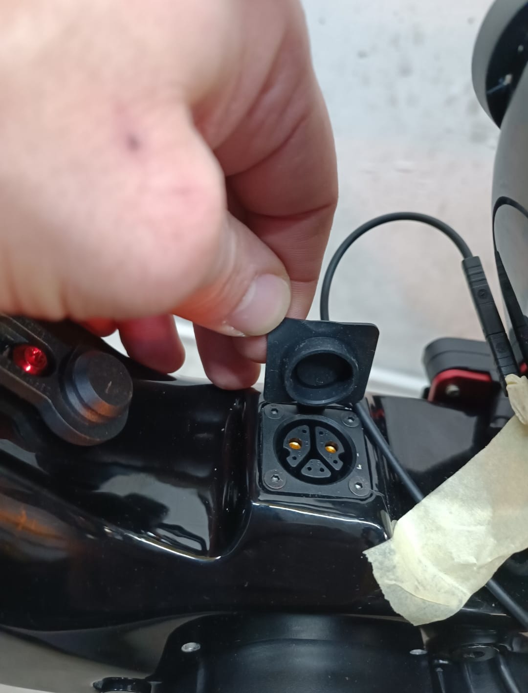

Hi everyone, I just bought a bafang M510 but I don't like the cap, I'm afraid that water and mud will get in. Is there a more precise and robust replacement cap? Link to buy it? Thank you

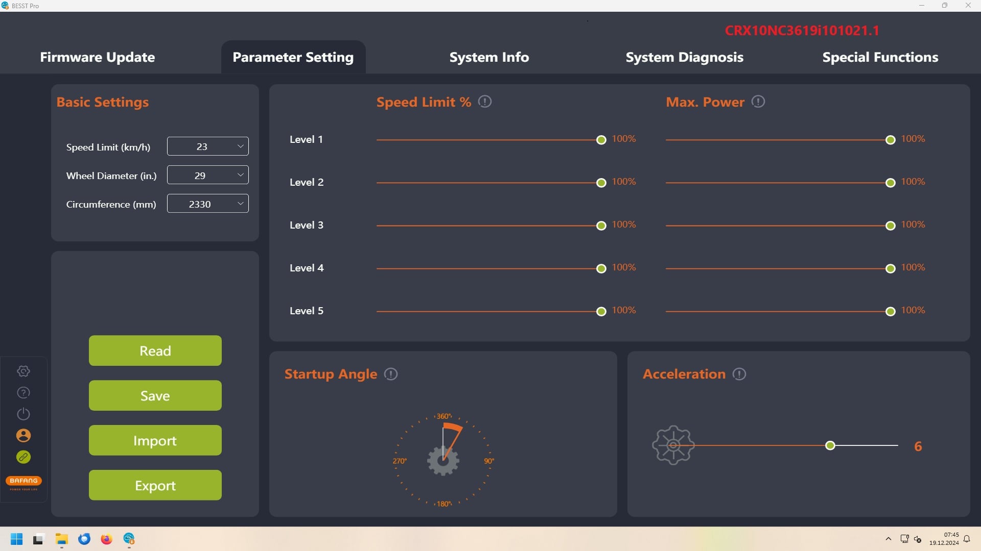

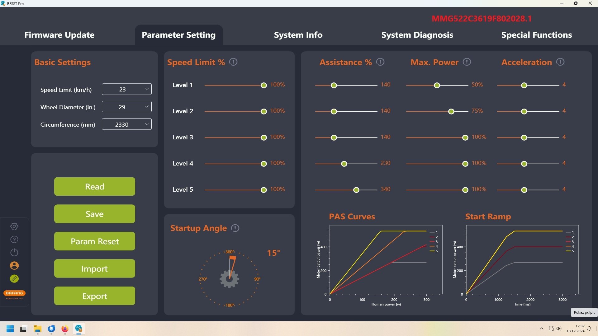

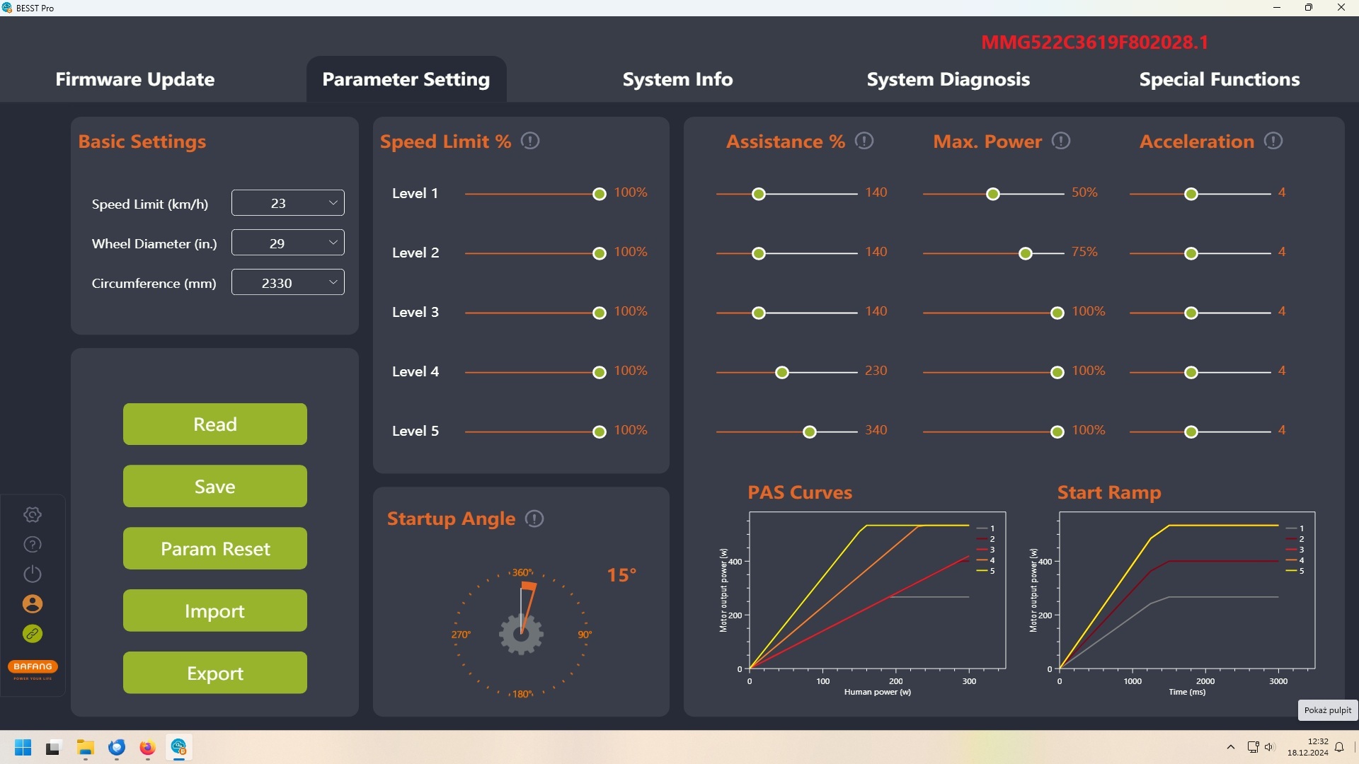

Hi everyone, I have two bikes with M510 motor
1st one is CRX10N.510.FC 1.0 with software CRX10NC3619i101021.1
2nd one is CRX10N.510.FC 2.0 with software MMG522C3619F802028.1
the problem is that the software CRX10NC3619i101021.1 don't have "Assistance %" option like the software MMG522C3619F802028.1 ---> look fotos
is the only solution to replace the driver with version fc2.0? or can I update the software?

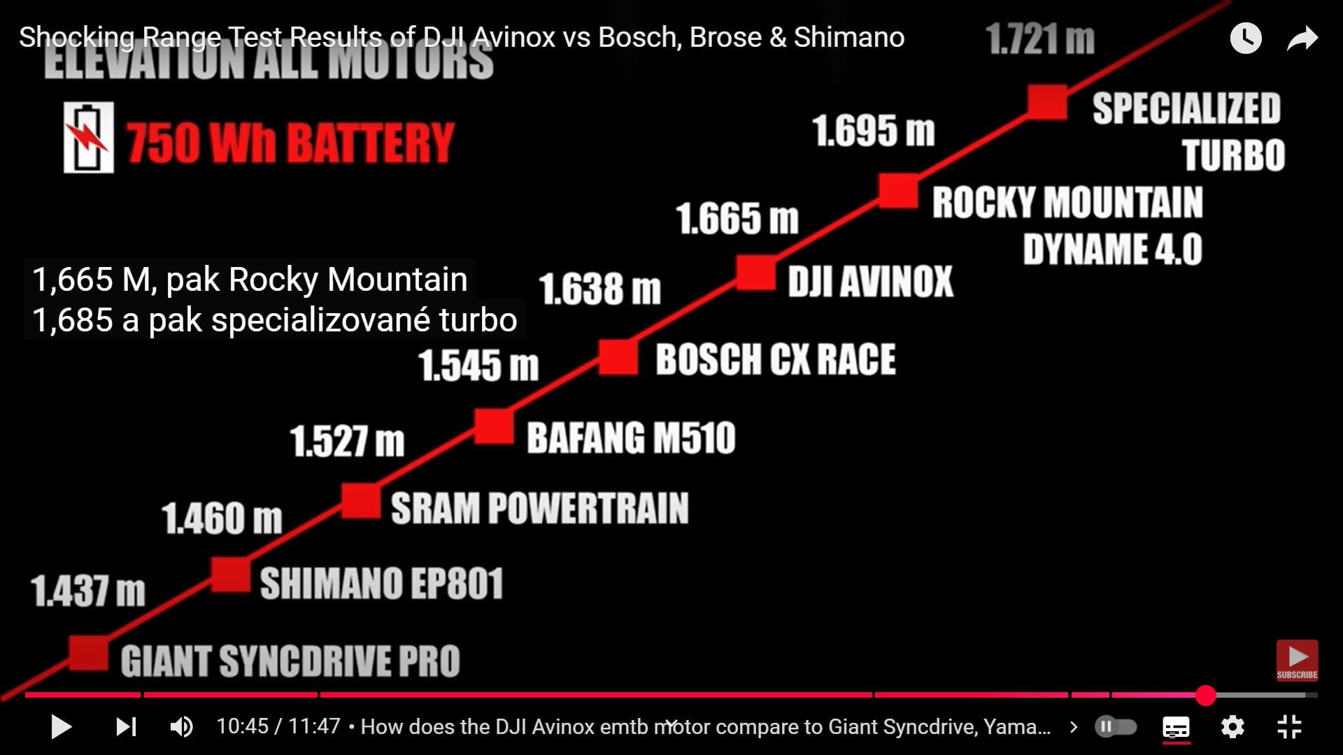

Motor efectivity-comparison: It is often mentioned in user reviews that the Bafang motor M510 is less efficient than Bosch 4Gen or Shimano EP801 motors - that is, it takes more Wh from the battery to achieve the same power during a ride.
The attached video compares several of the most used motors by Extreme range test climbing (same rider, same conditions, same heart rate,...). The M510 motor was placed in this efectivity comparison behind the Bosch CX Race motor, but ahead of the Brose S Mag or Shimano EP801 motor. The best are Specialized Turbo and Rocky Mountain Dyname 4.0 and DJI Avinox.
Note: Not much details on the methodology, but I wonder how they made the calculation of the power consumed by the M510 motor, where the percentage of battery capacity on display is a very inaccurate. Unless you recharge again to full battery capacity with a charger with a wattmeter included.

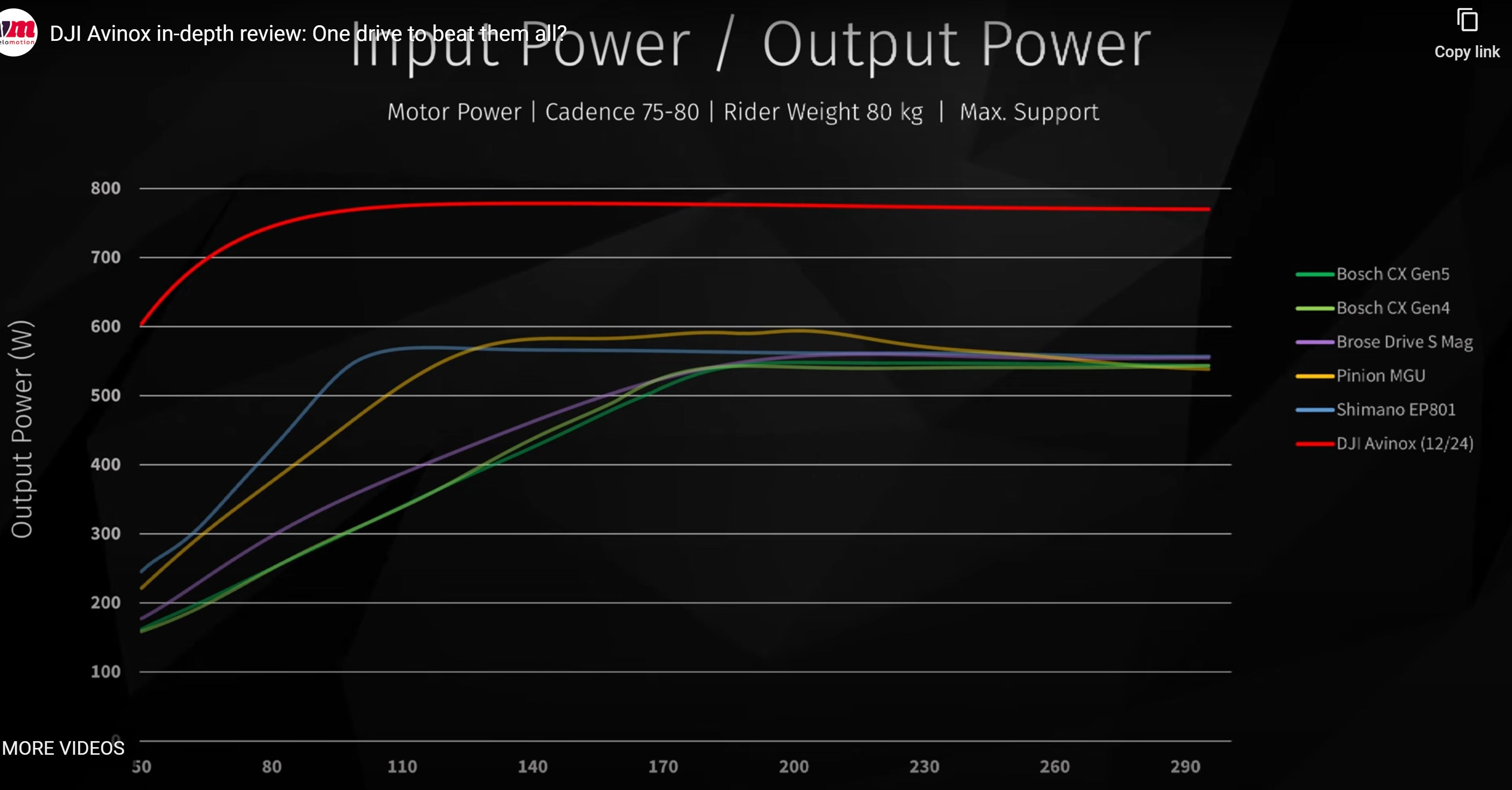

Hear in this very interesting video you can see a lot of graphs about peak power, thermal stability, power under different cadenses,...and comparison DJI versus other motors( unfortunately our M510 is missing) -autor Astro 66-Feb. 12,2025 in
