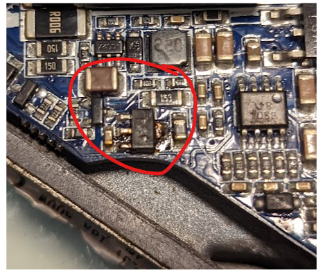

I think there is damage on the controller board although how this can happen I have no idea:
Looks like bulging on the package

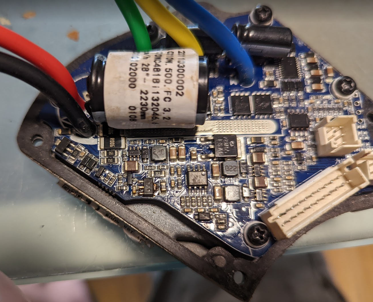

here's the whole controller:
Is this the controller from the M600 ?
Yes, looks like attaching the HMI from the M510 fried it, to be clear it worked initially, with the E160 HMI (used walkmode). Then I thought I see if the C230 controller worked with it and it never fried something. Looking at the board it sort of responds to the - button and the pwr button (green light on controller board, but not enough power seems to get to the display). I'm working into it, but I think both m510 and m600 are now dead (well sort of). Maybe a HMI powered from another source would work as some things work with the BESST controller attached (motor calibration for instance). Unfortunately I'm pushed for time at the moment, so this isn't going to get fixed today :-(

Yes, I'm at a loss to see how a failed upgrade to the m510 can trash a HMI so badly that plugging it into another motor can trash that too. Seems like a very bad design. There's still hope though, as I think it might be the power going up from the controller to the HMI that is the issue as CAN comms seems to work between everything with the BESST plugged in. I'm going to try the throttle out this evening see if that works, better than nothing! Also need to check the P+ voltage on the power connector see if that is low. I've got a new M510 on the way as a spare from Greenbikekit, but am very wary about changing anything after this.
