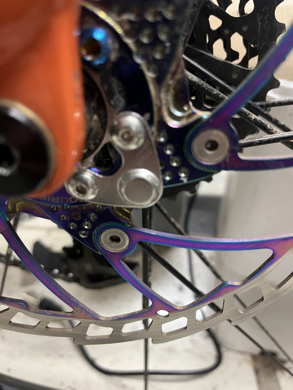

1. Speed sensor magnet adjustment. The M510 seems to be more sensitive to magnet position, but I'm using the new dropout sensor and brake rotor mounted magnet. Adjusting the position, and using stainless steel screws closest to the magnet resolved this.

I have replaced the BAFANG magnet with a weaker Bosch magnet with 2 stainless steel screws and hope this will stop the dropouts. I am satisfied with the battery management as far as I use a 14S battery and at 40% there are still 46 volts. A good value to reduce performance.
