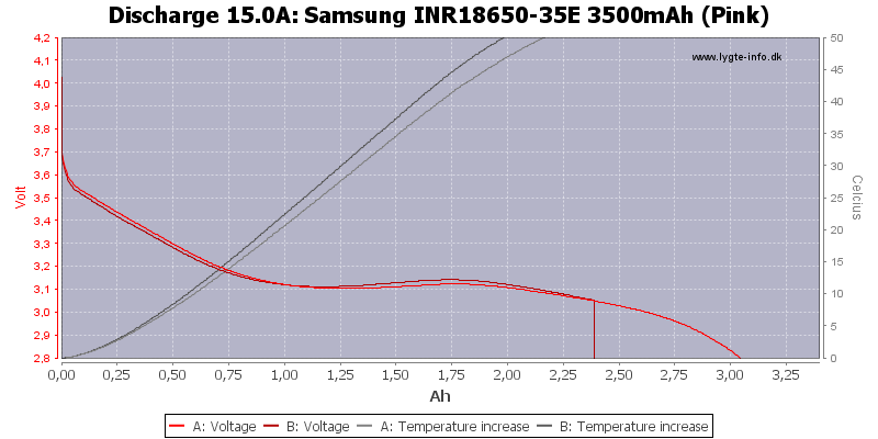

You are correct but and a bigger but, even though you have 46.5 V at low amps, increase the amps ( Watts ) and the battery volts will sag to a lower value. The more the battery is drained to say the last 30% then that sag becomes a problem as it will trip either the Bafang low volts or the battery BMS itself. Usually the bike switches off, the rider switches it back on and the voltage is say 46.5 volts ( no load ) and the rider says to himself that he has still 40% charge left, why has it cut out ? So the likes of Bafang get around this by limiting the max watts early, the lower watts won't pull the voltage as low and you get to ride for another 40 minutes. The downside to this is you will have to ride slower or put more effort in yourself.
Unfortunately we all use the very common Samsung 35E cell which the manufacturer focused on capacity and not sag value, unfortunately at this stage you can't get both, so at the tail end of charge, this cell voltage will sag dramatically. We built a few packs of 13S2P's and they were not great, the voltage sag was such to trigger the BMS from around 65% of charge ( we were running around 600W's max ). We had previously used the 30Q's which have less capacity but higher discharge rate ( C Rating ) which in the 13S2P gave a better range than the 35E's. We built a few 13S3P's with the 35E's which if used less than about 400W's were fine. In your case at 13S4P I would suspect the 500W's would be pretty comfortable to be OK but once down to say the last 25% you may risk triggering the low volt level hence Bafang indeed are cutting back the Watts early to prevent this.
A lot of systems are now using Coloumb counting together with volts and getting better results, or simply using cells with a better C Rating.

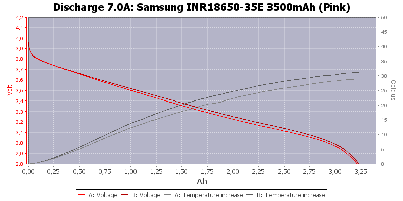

If you want to get a bit techie looking in on the discharge curve you can see why we are having the early shut down of amps. We found that the predicted and actual was somewhat less in colder temps, but you get the idea. Note I have used the 7.0 scale as effectively the total amps is spread over the 4 batteries.

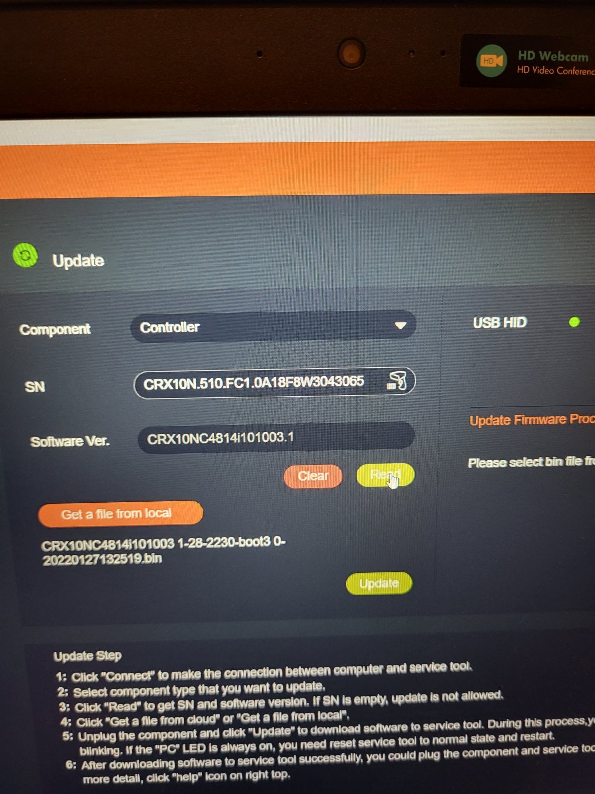

Type "CR" in the SN field and you'll be able to update firmware.
Worked 👍. I could reinstall the original firmware. Here the picture of the Besst Screen before my update - so this shows information with the new firmware i did not install with success. Thanks a lot for this hint 👌. Now i will wait for the next new firmware to come!

I tried to upgrade the engine, it didn't work. loads in besst and writes to disconnect the controller and reconnect. I do it but nothing. any advice?
