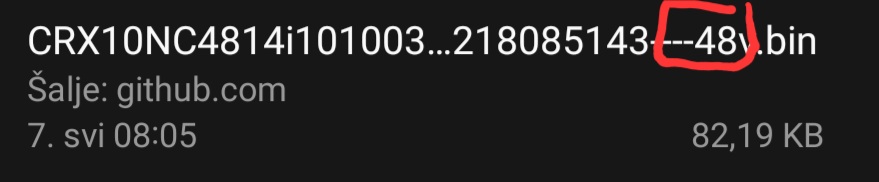

should be deleted, ---- 48v

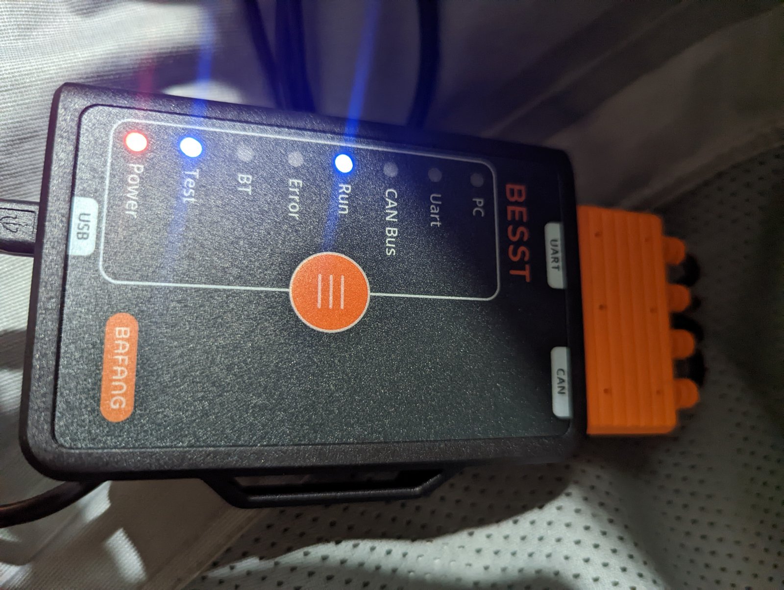

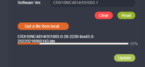

Did you see 2 progress bars:
1. uploading to BESST
2. when you plug the motor back in and it uploads from BESST to motor?
Then the test light should appear on the besst box (blue light)
(the above is a screenshot from 1. upload of newer file and 2. besst box update from older file)
I got confused when I first flashed it and thought it was just 1 step, but I then messed it up so badly I've trashed 2 motors. Both of which still are flashable but just don't seem to communicate with any displays now, so careful guys!

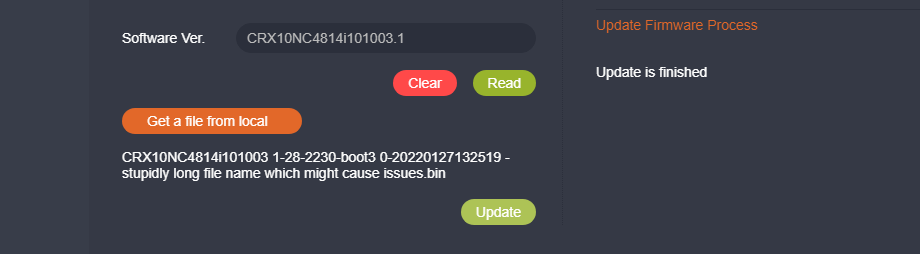

Long name possibly might cause the issue so you may try name it even „xdbafang.bin” and shall work.
Nice idea, but I tried the rename to a short file name, moved it to a shorter path. Also as a control I renamed the known working original bin file as follows:
And that still worked, so any other ideas?
