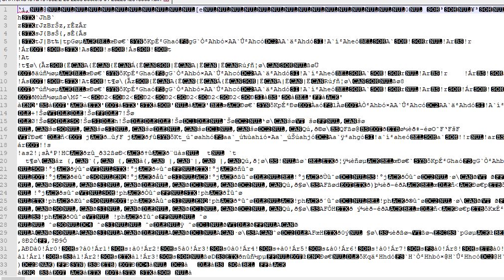

Has anyone ever been able to decode the .bin file of the firmwares? It would be interesting to compare the variables of the two M510 firmwares here :
When I open with notepad++ it is completely unreadable

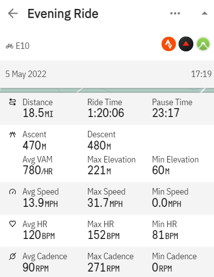

Just in the middle of a ride (10 miles in). All in all pretty good, very impressed with the response when climbing technical rooty rocky stuff. Only complaint is occasionally it cuts off if I reduce cadence or possibly the force on the pedals. I'm a high cadence rider and using short cranks (150 I think) so that may be the issue. It is only very occasionally though so not a deal breaker by a long way. I was using the m600 before so I can't comment on a comparison to the m500. Will update this post later if I think of anything else!

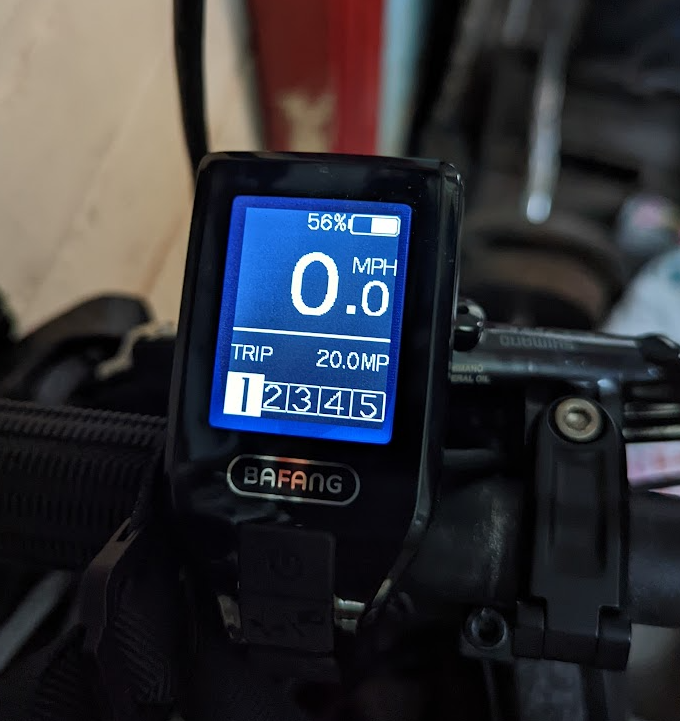

Got back and the battery is showing 56% at the end. I think I like this M510! I've upped the speed limiter from 20mph to 35mph as the cut out was way too sudden and I seem to hover around 19.9mph on the roads in-between trails so the cut-out is super annoying. I don't think I've got my wheel circumference correct yet as the GPS didn't match the odometer on the display. On the return journey (about 9 miles I didn't really drop the assist from level 5 either, and the motor was only slightly warm to the touch)

View attachment 87532View attachment 87533

Thanks for the update and taking the risk to test the software! 271 rpm is a remarkable cadence mate! So updating the firmware with besst using the python bypass worked with no issues?

Yeah I think my cadence sensor needs a new battery, it was all over the place today 🙃
