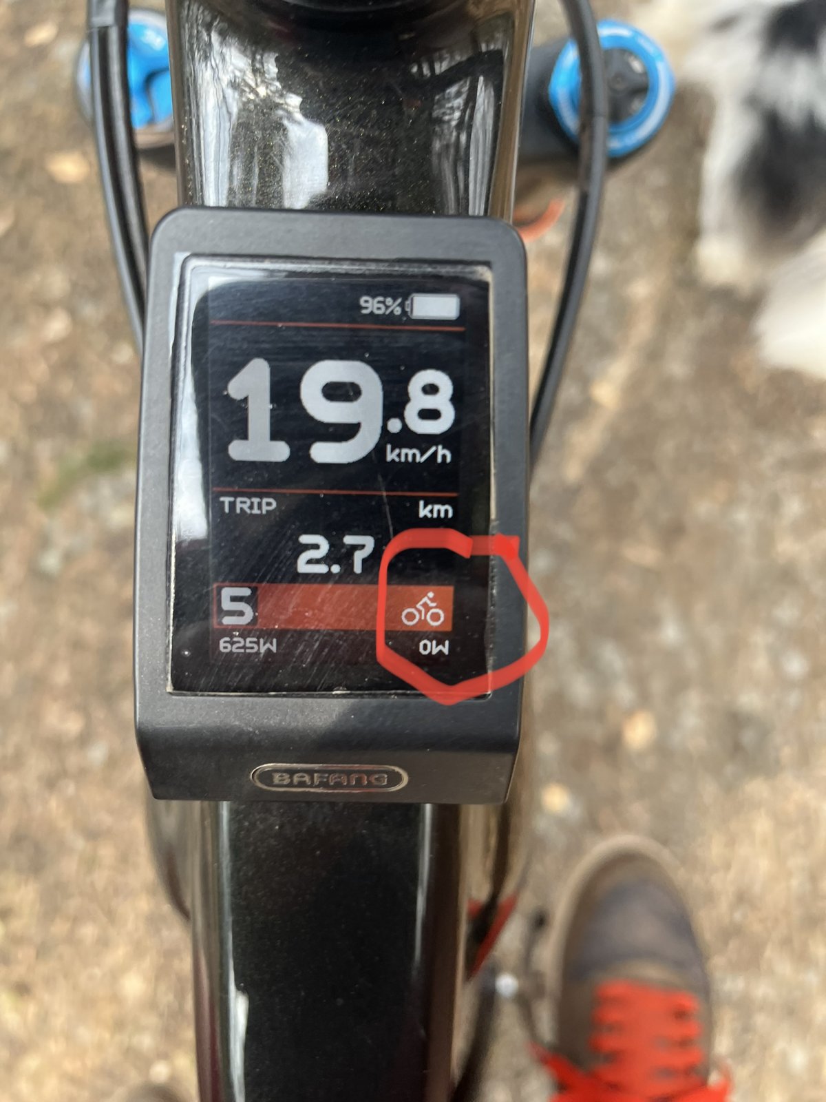

Today a first short ride.I'm a bit disappointed with the response. The engine has more than enough power, but it cannot be dosed well. I may need to do a calibration as I changed the firmware from 36V 19A to 48V 14A. I can't imagine that this programming should be taken seriously.
Today the 2 Ride a little longer. I reloaded the firmware and calibrated the position sensor. Unfortunately no improvement. The engine reacts too little to the pedal pressure. The performance development is only satisfactory at high cadences. I am afraid the torque sensor is not as sensitive as on the M600. There is also no wattage of your own performance displayed 🤷 If it weren't 1kg lighter than the M600, I would remove it straight away

If I ride up the hill in level 3 at medium cadence, the display shows 350 W. If I increase the pedal pressure, the power remains the same. Only when the cadence increases does the power increase to 450 W. With the M600, the power is increased depending on the pedal pressure, regardless of the cadence. That's what I meant by not sensitive enough.
