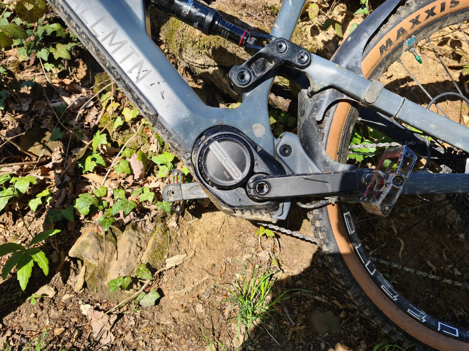

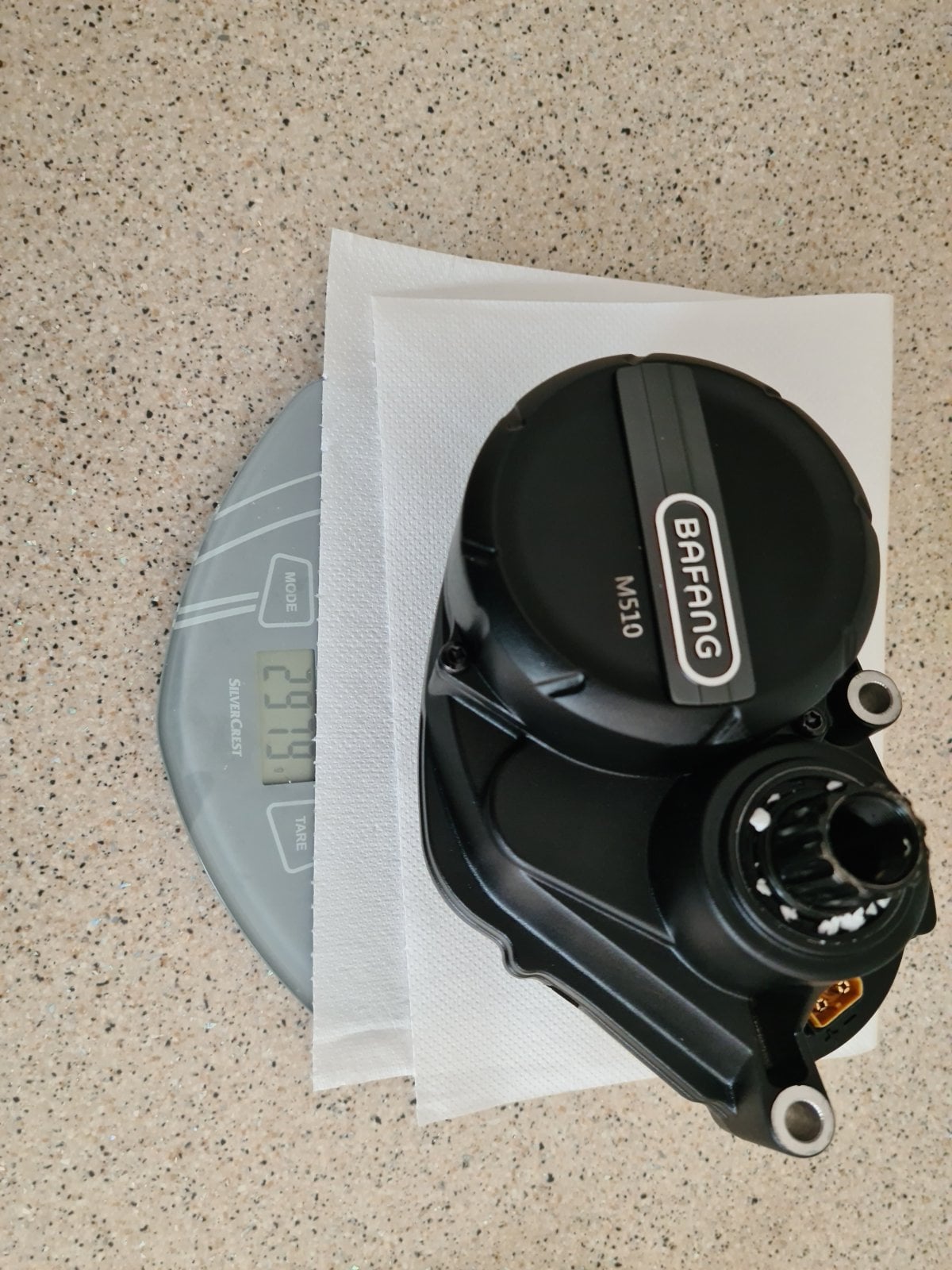

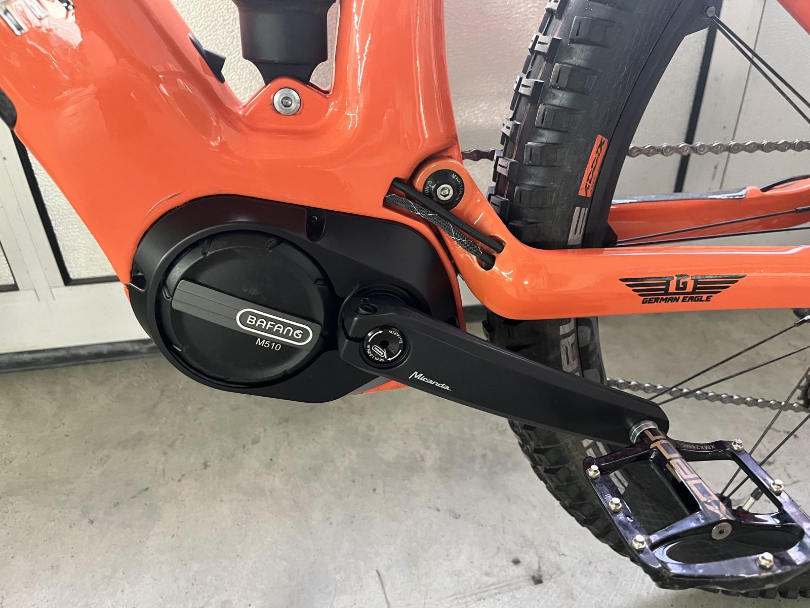

Hello everyone. m510 arrived. built-in and tested. a faster engine reaction is immediately felt. stronger power supply on uphills. if some details are still being worked out, let's hope so. on some hills it even delivers too much power at low revs. but you need to get used to it. at some moments 2 and 3 level the engine stops at low cadences when there is no load, when going from uphill to straight. but for the most part there is an improvement and a stronger supply of power on the hills. before on a hill quite steep m500 was the same 4 or 5 level. now the difference is felt. lower battery consumption! now shows in the application bafanggo and bms from the battery similar voltages. and they fixed that part. these are the impressions after the first run of 20 km and 1000m altitude. consumed 40% of the 480wh battery. I will write more comments after another ride.

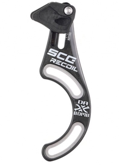

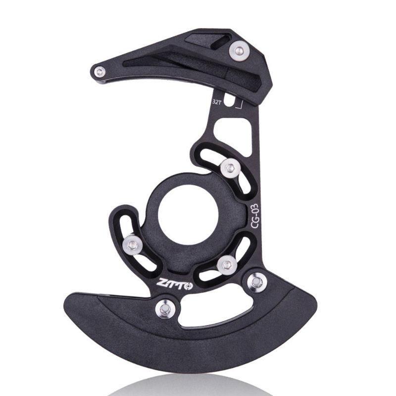

Do you know if the new chainguide can be purchased anywhere? My m510 will arrive soon but i ordered only the motor. Thanks
I've been running my M600 right through the winter ( where the chain guide is needed most due to the sticky mud and the likes covering the gears ), having removed the chain guide and fitting the motor with a simple 104BCD narrow wide gear without a single derail. You may want to try it as the £ 10.00 gear seems good value over a chain guide.

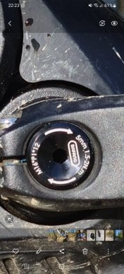

Just learned that the M510 requires M16x1 treaded crank bolt instead of M15 with M500. M16x1 is almost impossible to source. Go back to where You ordered the engine and ask for supply of crank bolts if they are not supplied with the motor!
could you clarify ? it is not "bafang isis" cranks arms ? which bolts do you speak ?
This crank bolt. The spline (axle outside) remains unchanged, but the hollow Axle has M16x1 tread instead of M15.

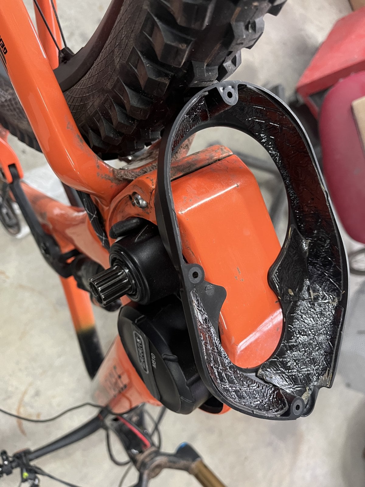

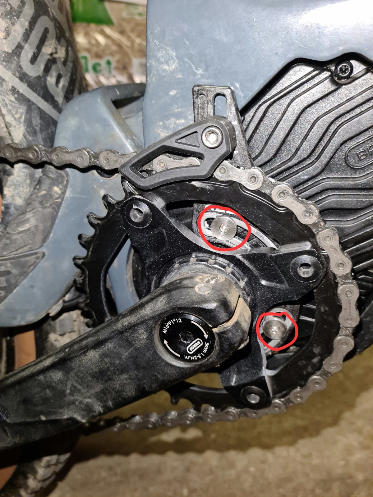

when installing the chain guide, the chainring spider should be slightly sanded. because the chain guide bolts get a little stuck.
So the old chainguide of the m500 seems not to fit anymore with the new m510 right? Can someone tell me where to purchase the new chainguide if i ordered only the m510 motor without extra parts?

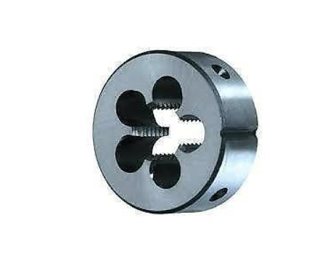

Although M16x1mm seems super weird M16x1.5 I can maybe understand, but x1mm WTF!
I'm guessing I'm going to need one of these and some M16 bolts with a smooth top bit to cut down if I lose mine when the motor shows up:

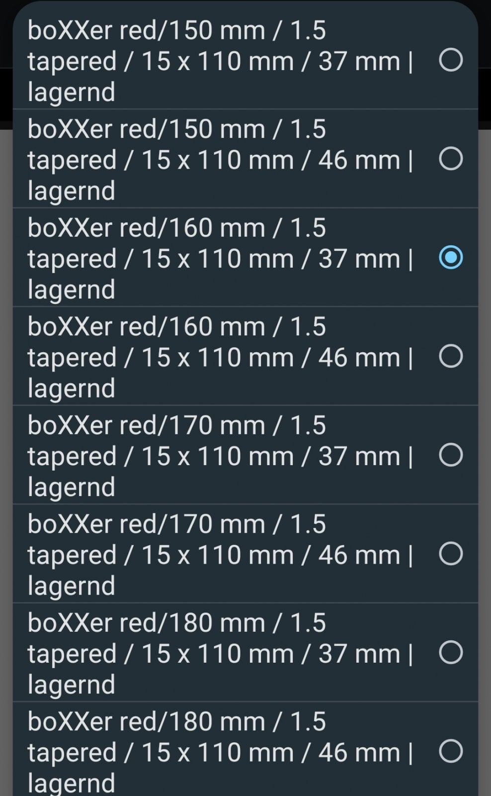

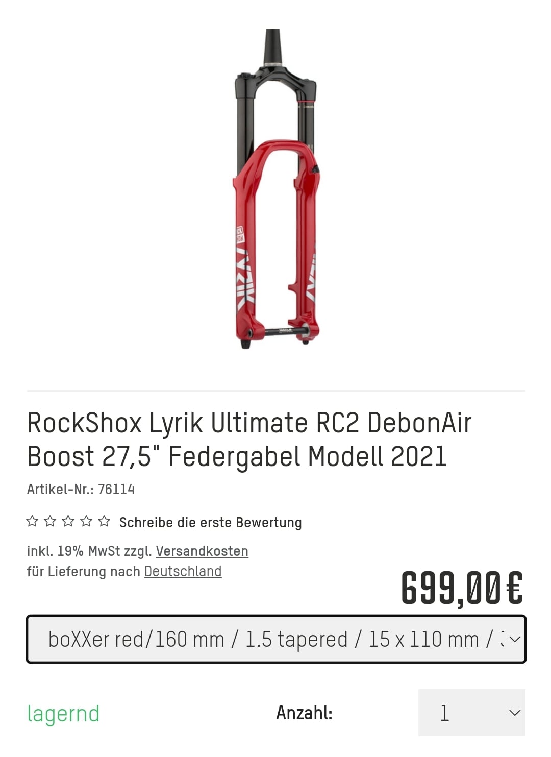

Can you please help me choose the right fork for my dengfu size M?
I will be using a 27.5" front and rear wheel.
here are the results of today's ride. the engine is a beast. there are some minor flaws. sometimes in 1pas it does not give enough strength as if it needs to be warmed up a bit. as far as I noticed only when the engine starts, not while driving. from 1pas to 5pas the power is noticeably stronger, a really big improvement. at the start a little too strong power delivery, but you need to get used to it. battery consumption very good. today 33 km, 1400met altitude pas1-pas4, battery 480wh remaining 10% battery. all forest trails, lots of steep uphills. I hope this helped.
