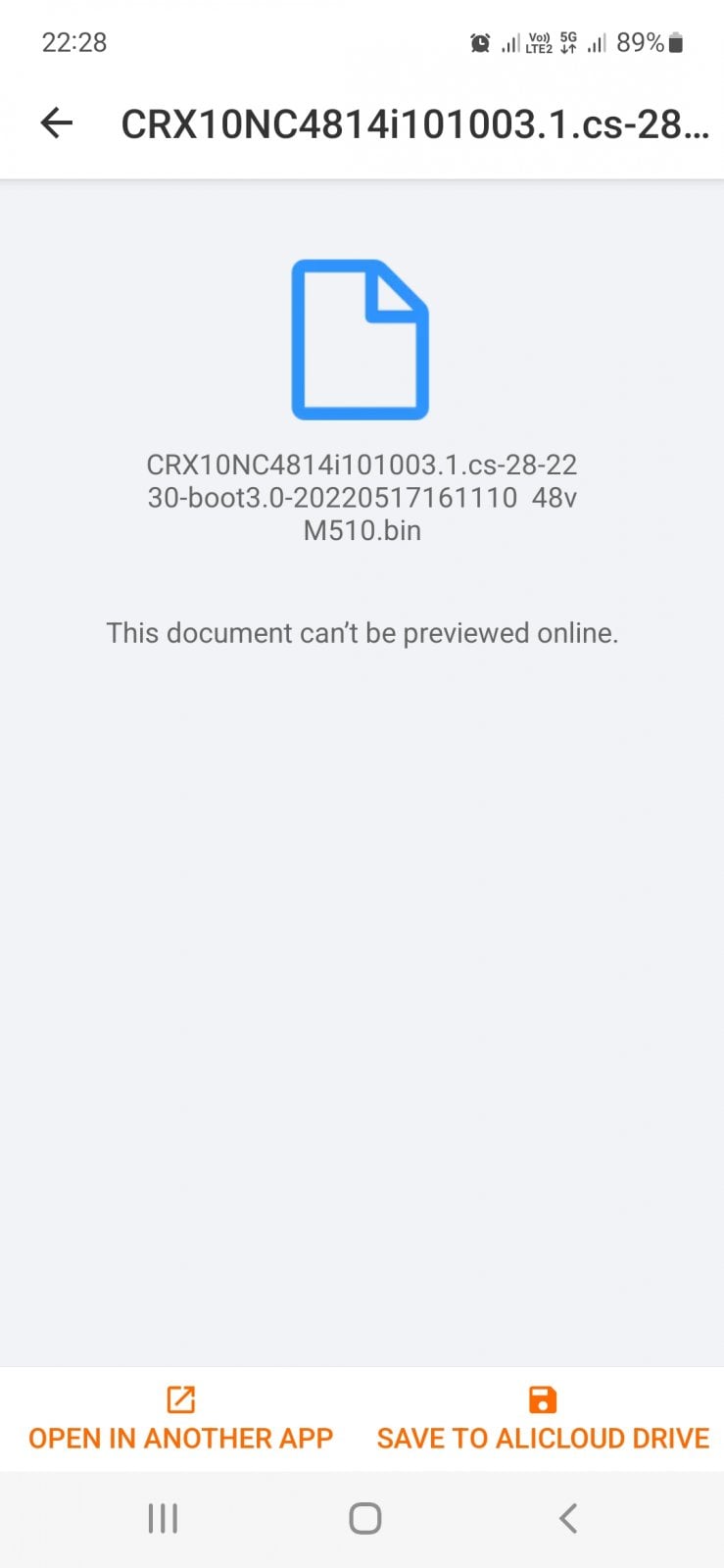

I tried to upgrade the engine, it didn't work. loads in besst and writes to disconnect the controller and reconnect. I do it but nothing. any advice?
I did not yet see a post from @Kyokushin with the newest firmware so which one did you install 🤷‍♂️? Dont think you have the one i got from Chili or did i miss something?
The firmware i installed is the one like inthis screenshot attached.

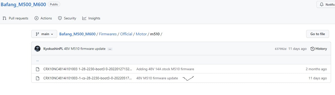

Just looked on GitHub, its there:
@ficorama installed the firmware we all could'nt install. Only now he tried the new firmware as mentioned above and it was succesfully installed. he will update us on the perfomrance of the motor and will also tell us how the motor behaves under 35 % of battery capacity.

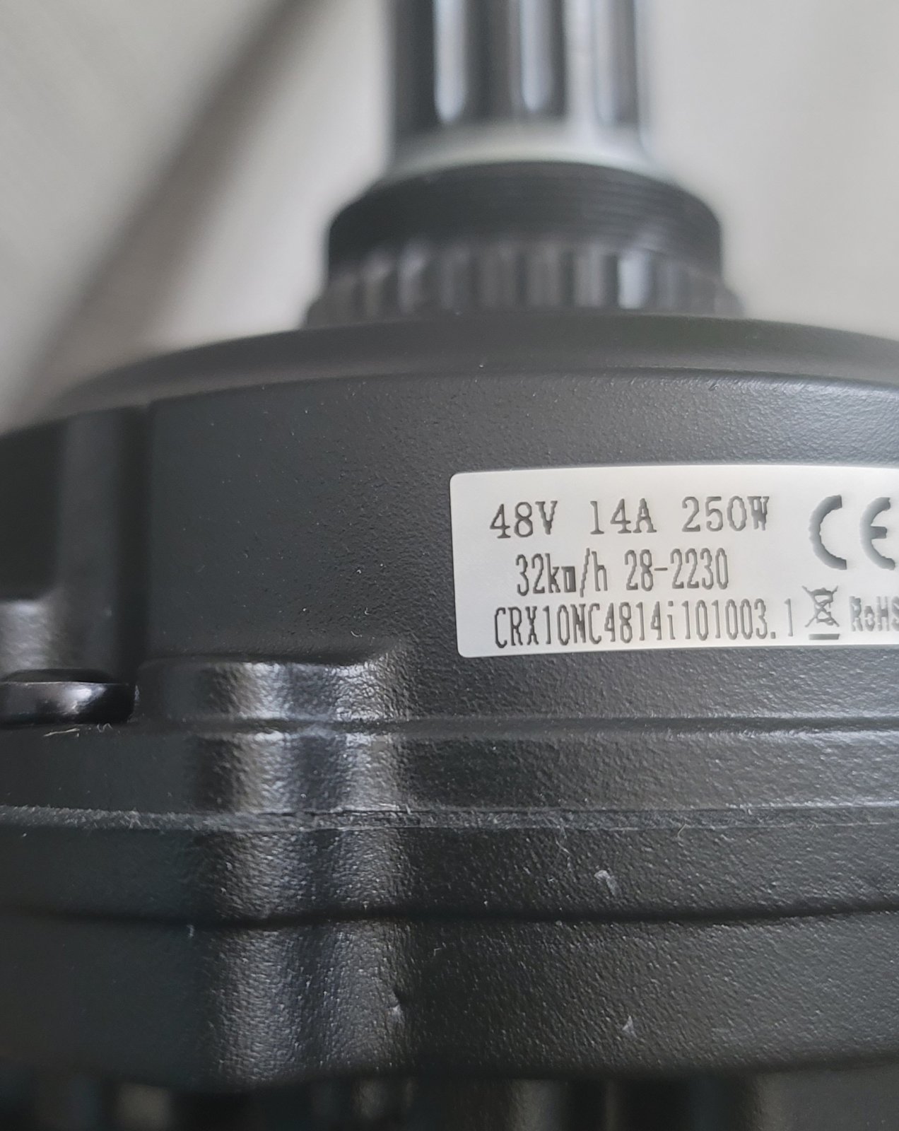

Today my motor arrived but on the sticker is written that the maximum speed limit of 32km/h instead of 25km/h.
This is annoying if the police in Germnay check the motor.
Do your motors have the same sticker with the same maximum speed?

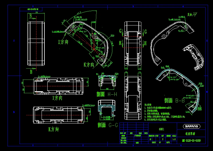

Does anyone have a higher resolution version of this CAD drawing or similar? It appears to be the CAD design of the motor mount point on the frame for an M500, which I believe should be the same for an m510. As I mentioned earlier, I'm having a custom frame built and I'd like to get the exact specs for the frame builder.
Did You notice that You can easily buy the aluminum welding bracket for the motor as of the drawing?
M500 and M510 are interchangable.

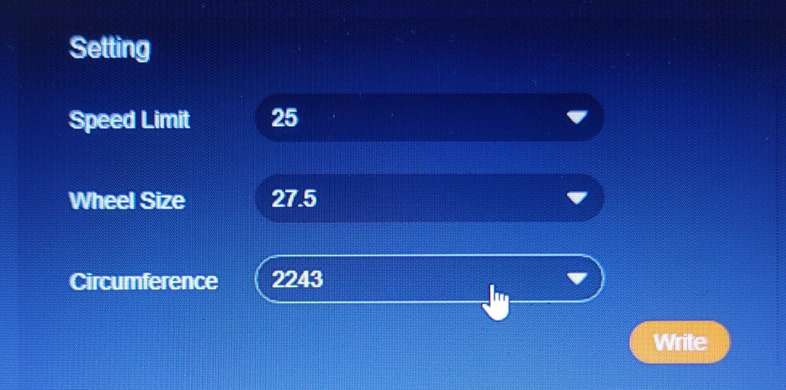

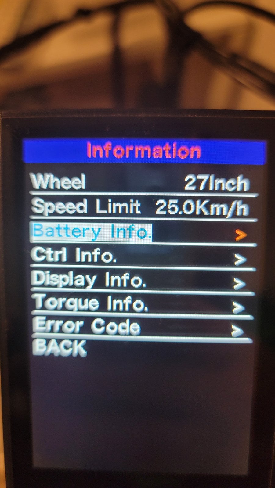

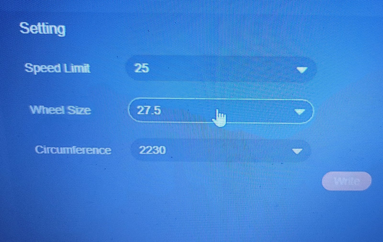

When I choose 27.5" wheel size using BESST, it appears 27" on the bike display, what is the reason?
Or should I choose the wheel size 28?
My bike wheels are 27.5" front and rear
I can't comment specifically on the setup.
But wheel size isn't really the critical factor. It's tyre circumference. For example, you could have a 29 x 2.2 tyre, which has a near enough circumference to a 27.5 x 2.8 plus size tyre.
And a 27.5 x 2.3 tyre is completely different to a 27.5 x 2.8 tyre, even though they both use 27.5 wheels.
Looking at the first picture, there selection below wheel size is circumference. What happens when you adjust that???
My tire size is 27.5" x 2.6"
Circumference: 2243 mm
When entering this data, nothing changes on the bike display. It appears again that the wheels size are 27".
Even if I change the tire circumference to any other number, nothing will change.
