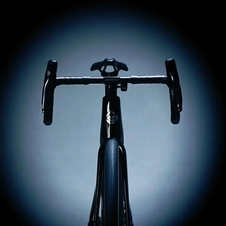

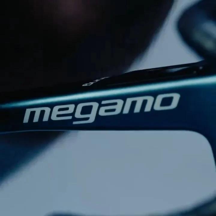

Found a teaser video on instagram from start of April and grabbed a couple of screenshots, it looks like it's the along rather than the upon from what's written below the screen on the top tube. The video has hashtags for along and upon. Tekmotiv | E-Bike Store on Instagram: "Coming soon from Megamo......... #gravelbike #ebike #egravel #along #upon #megamo #saffronwaldenlocal"
Doesn't look like it has mounting points on the fork which sucks from a backpacking flexibility stand point (Velduro Phantom has them). Slick tires is also unusual for a gravel bike which would also suggest it's the along. The cockpit is also very clean, can't see the Avinox bluetooth remotes on there.
Think the along would be the first Avinox road bike unless I'm mistaken. Not sure how the motor resistance would go down with roadies. I spent about half my commute above the assist limit on my Fazua Ride 50 gravel bike before it stopped working for the third time. Wish there were published non powered assist figures somewhere to compare systems.

Ah I didn't have audio on. Originally it was suggested the names were the other way around. Upon being the gravel bike and Along being the road bike. The screen grabs I posted also suggest that the along is the road bike assume all three are the same model. The audio has them as your previous post.
Guess we will find out soon enough, hope the wait isn't too long! I want to get a new bike so having more options to choose from is good.
