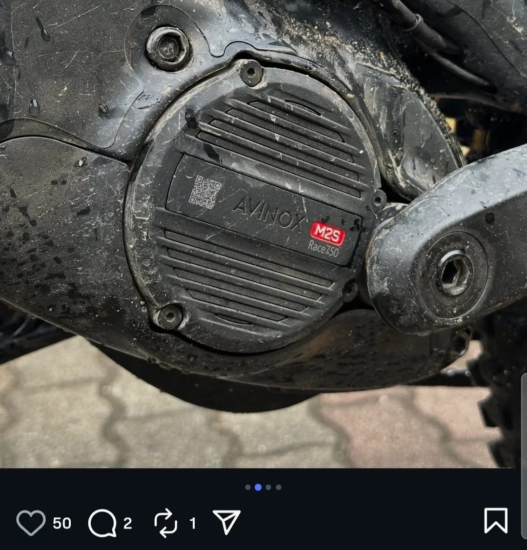

The UCI approved M2S Version
This piece is probably relevant with regard to RE's. Looking at 'absolute watts' for clarity you can see the difference between the Avinox 700 and 800 battery performances. Now as you say, is this a real life issue? For many of us probably not - rides tend to not be flat out in situations where you can use full power continuously. Climbing on a UK public right of way or Singletrack? Very unlikely - tight, short, not that much altitude gain. In the European mountains however, I could see people climbing 600, 800m vertical or more in a single run, all of it being on wide gravel track in hot sun where they'd see some thermal issues. they could chill out a bit, and enjoy the ride, but there are times I can see you'd hit feel it.

Not according to the forbidden spec sheet.
Yeah nah, this from the Forbidden site..
Spec-wise, for the M2S, which comes on our Tier 1 and Tier 2 builds, you’re looking at 130 Nm of torque (150 Nm in boost) and 1300 watts of peak power in a 2.6 Kg package. For the M2, which comes on our Tier 3 and Tier 4 builds, you’re looking at 110 Nm of torque (125 Nm in boost) and 1100 watts of peak power in a 2.65 Kg package.
