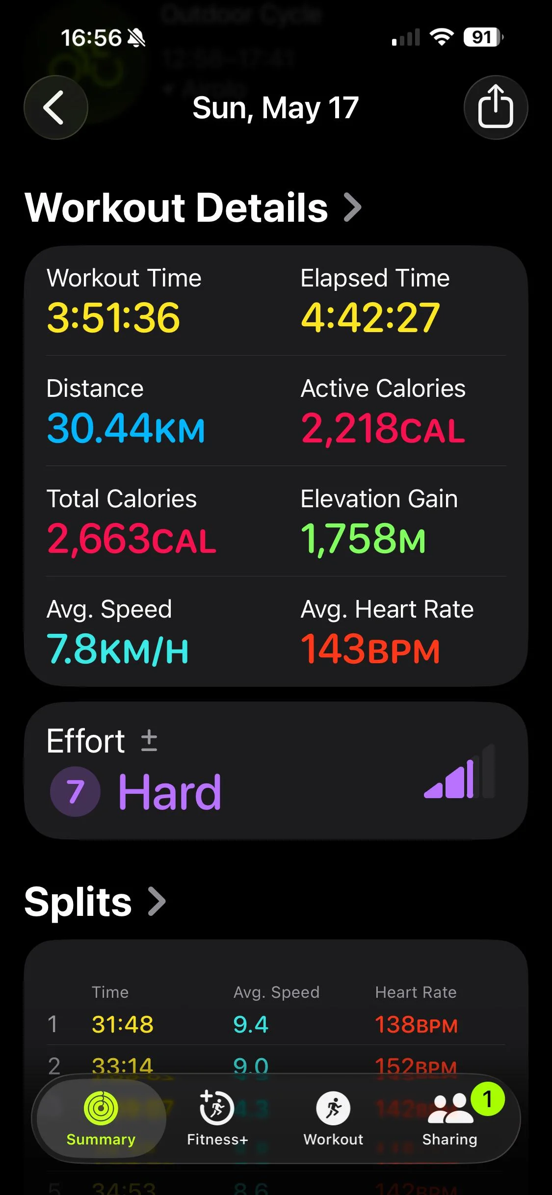

Yesterday tour, I started at 923m did 1758m elevation as it has a bit up and down to reach the peak at 2430m, 31km 90% single trails. I did a stop at the mountain hut for ~40min recharge and arrived back home with 4% battery left. So probably used ~1100 wh.
I'm sure that you with your skills you would have pedal it 100% on your current bike without using Turbo and without recharging and I'm happy for you.
Me, although it seems impossible for any human to use 130nm and 1300w (combined this time was 193nm), I did use trail /turbo a lot and compared to my old 85nm/600w bike I had to push only in two sections instead of 10+. So I'm super glad that DJI has created this motor and every tour I learn more and more how to use the power and clear more and more sections.
I'm sorry that, me, a below average joe, with M2s can now pedal where he had to push before and his having tons of fun doin it.
