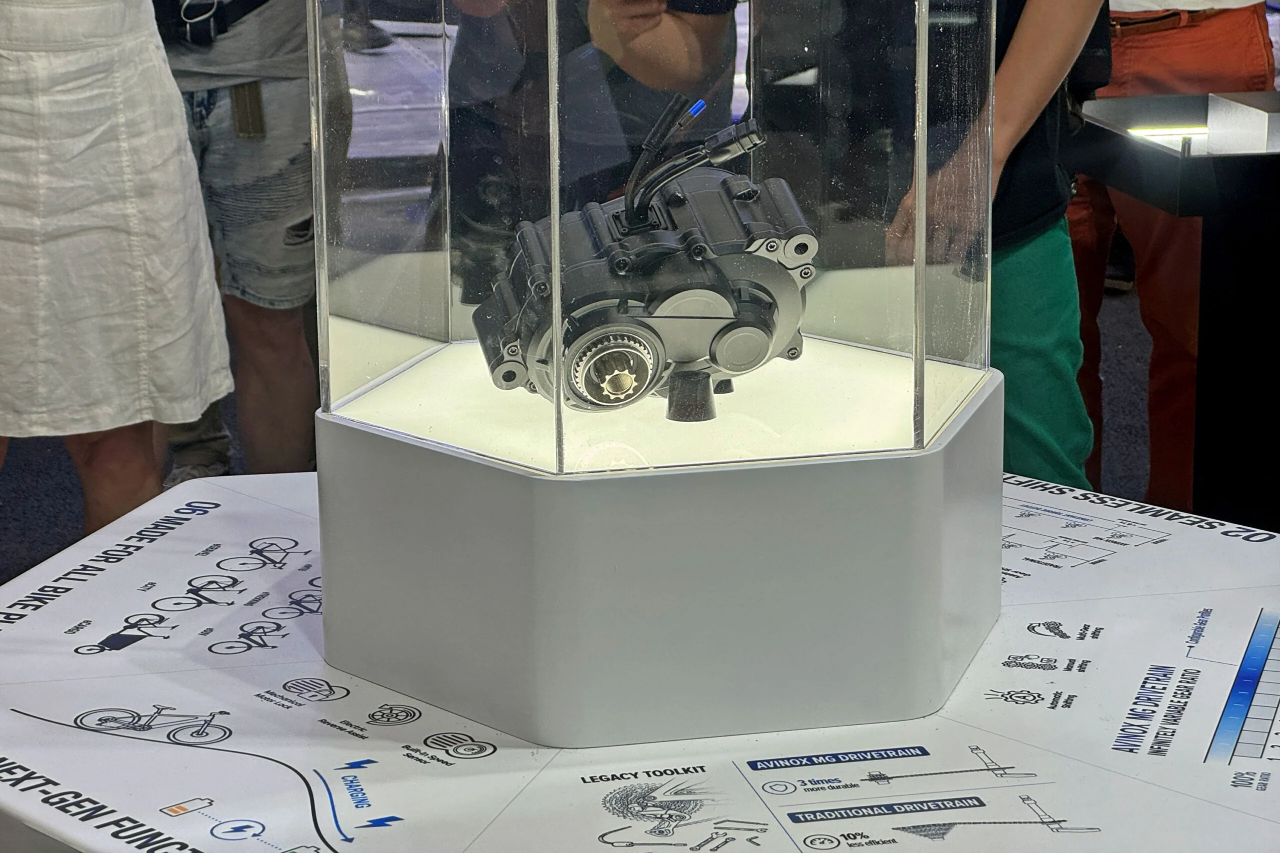

Avinox MG Concept: no derailleur, no cassette, infinite gearing
Avinox has shown its new MG Concept at Eurobike.
MG stands for Motor Gearbox, but the interesting bit is that this isn’t just a normal gearbox motor. From my interview, Avinox described it as using stepless virtual gearing.
That means no traditional rear drivetrain:
  • No derailleur
  • No cassette
  • No fixed mechanical gear steps
  • Gear changes in around 0.1 sec
  • Can be run as 4 gears, 5 gears, 12 gears, or full auto
  • AI-supported auto shifting
  • Similar power target to M2S
  • Chain or belt compatible
  • Potential motor lock anti-theft
  • Regen braking being explored

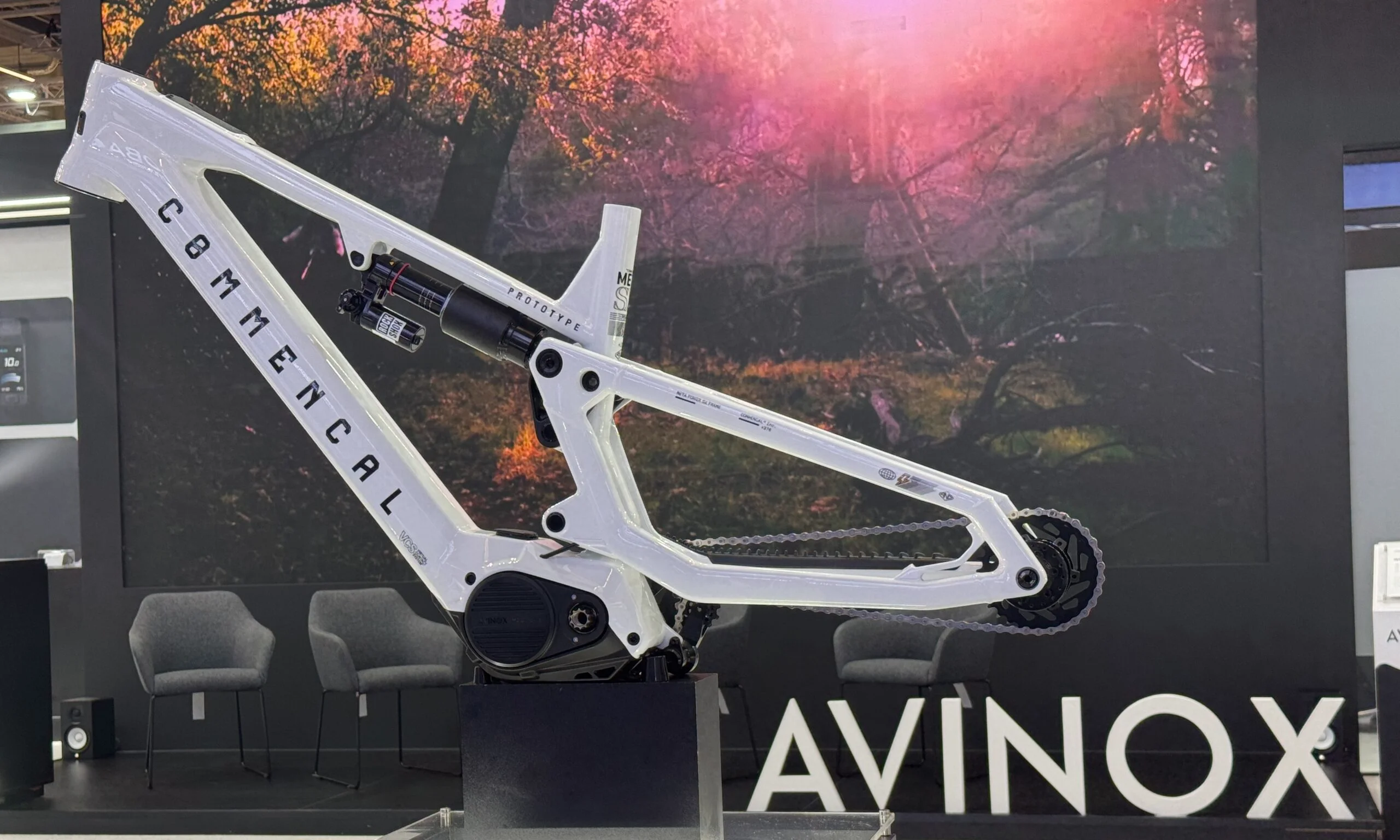

Avinox had concept bikes from Canyon, Commencal, Mondraker and Forbidden using the MG system.

The integration of it on that Canyon is fantastic. I feel sorry for any other brands that had already started developing stuff just to compete with the M2S and now potentially having to scrap that and start over on a CVT. Nobody will want anything else once this hits the mainstream market. SRAM and Shimano won't be happy either.

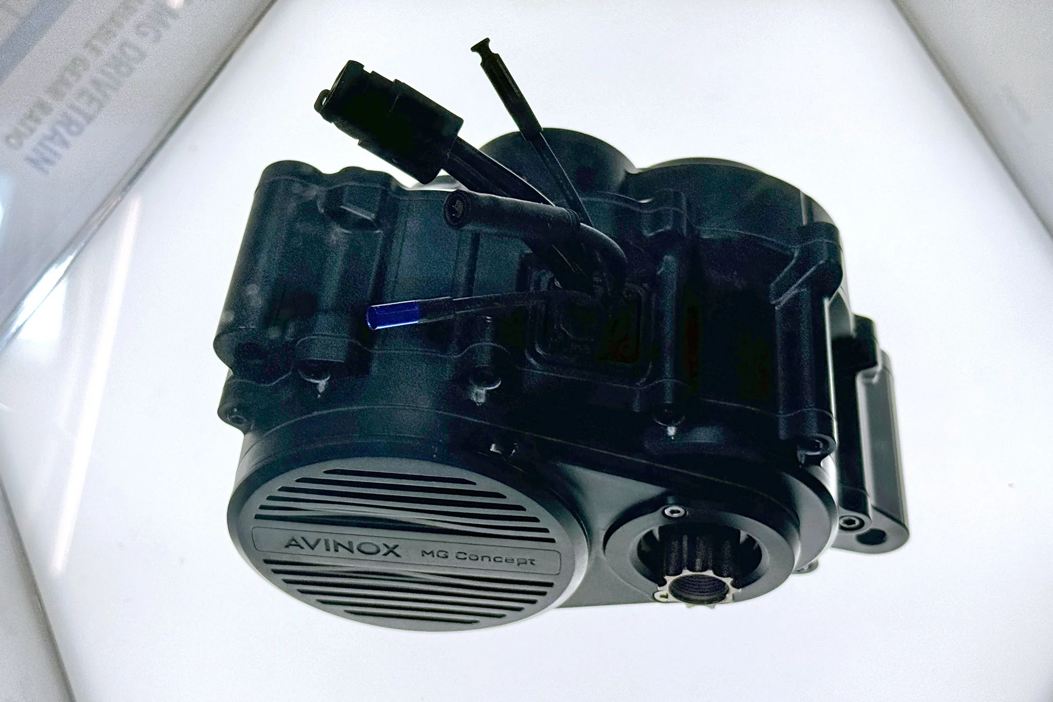

It is not CVT. Avinox uses the idea Grin started working long time ago with their Magic Drive unit
It is basically emulation of the gearbox with electrical motor (tat's why the guy in the the Rob video mentioned about it requires a lot of power, it indeed requires a lot of power. And for the same reason he mentioned they can lock the motor, that is because of it relies completely on the electricity. And for the same reason he mentioned they can use regenerative braking).

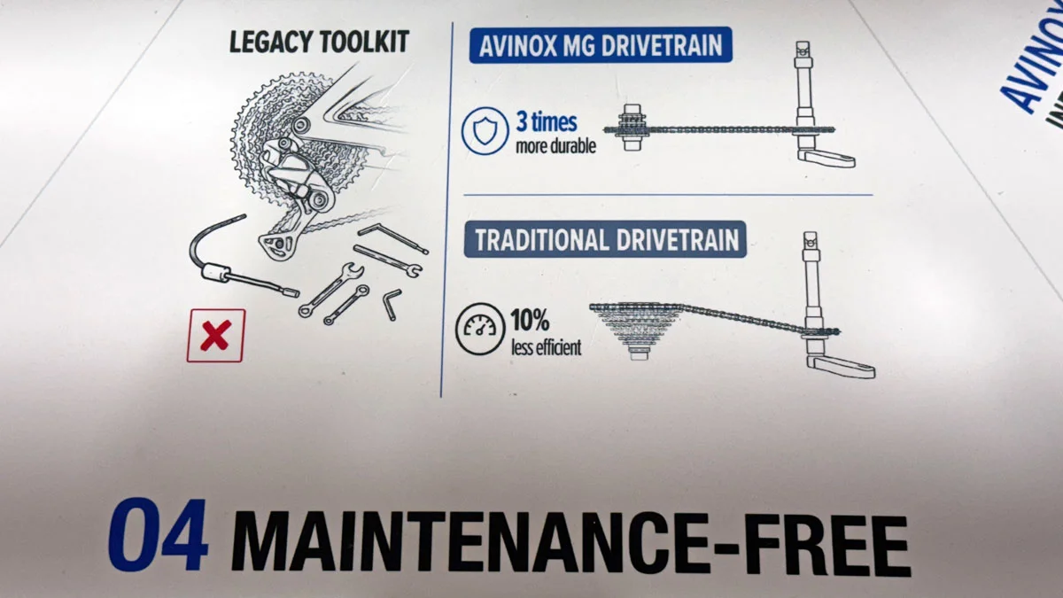

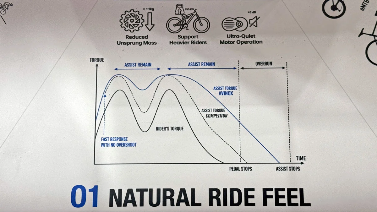

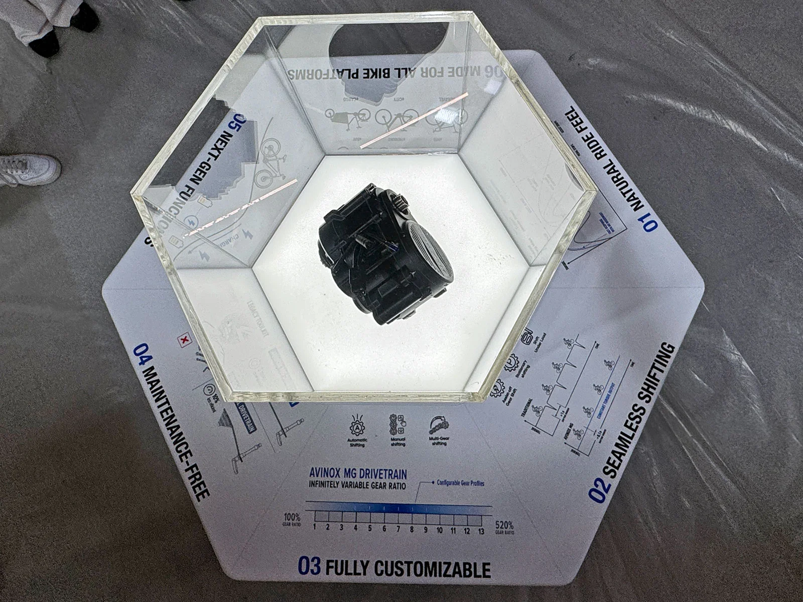

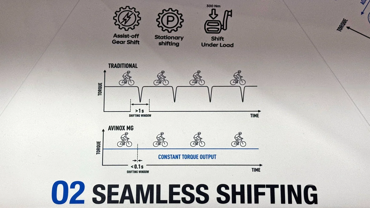

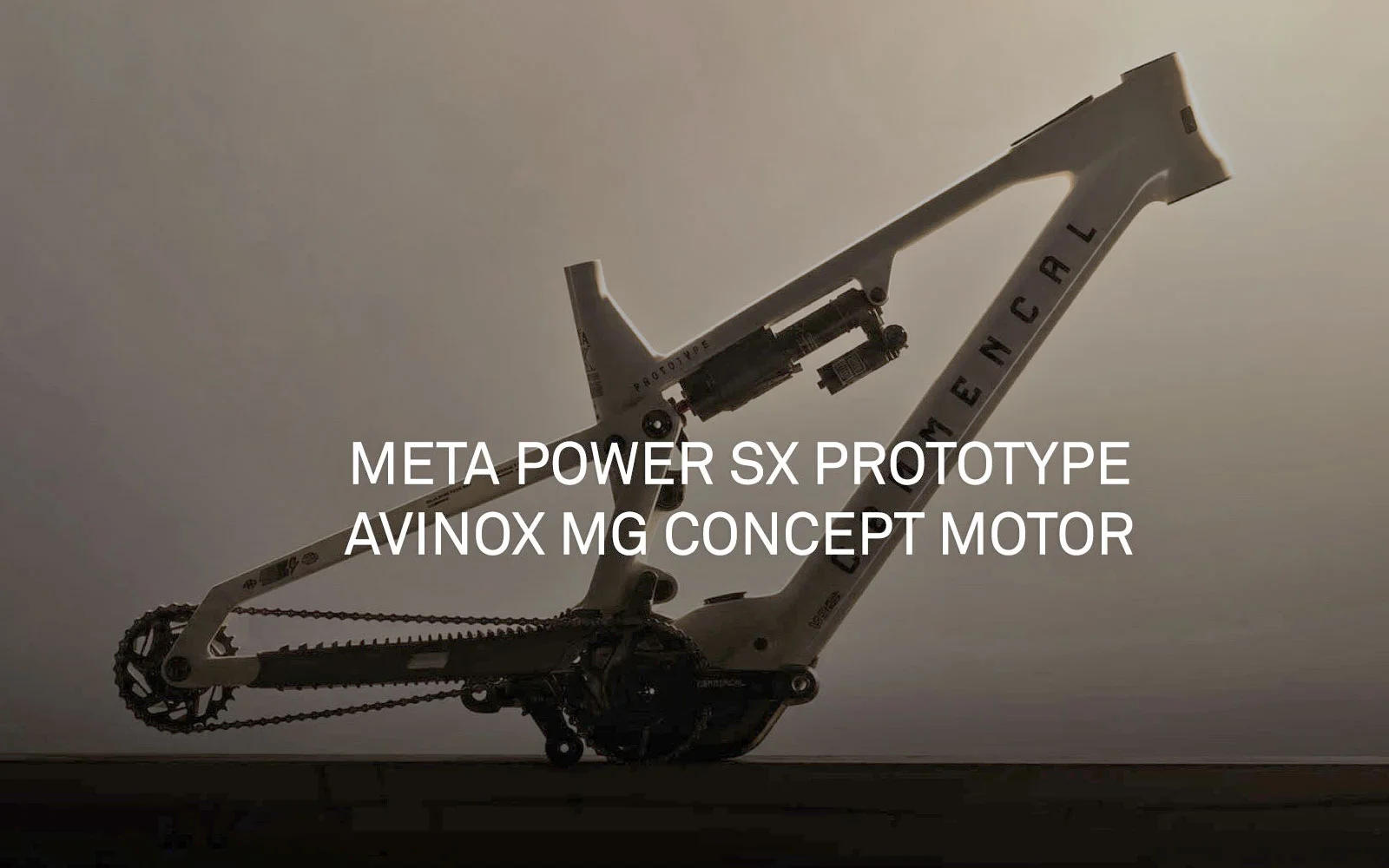

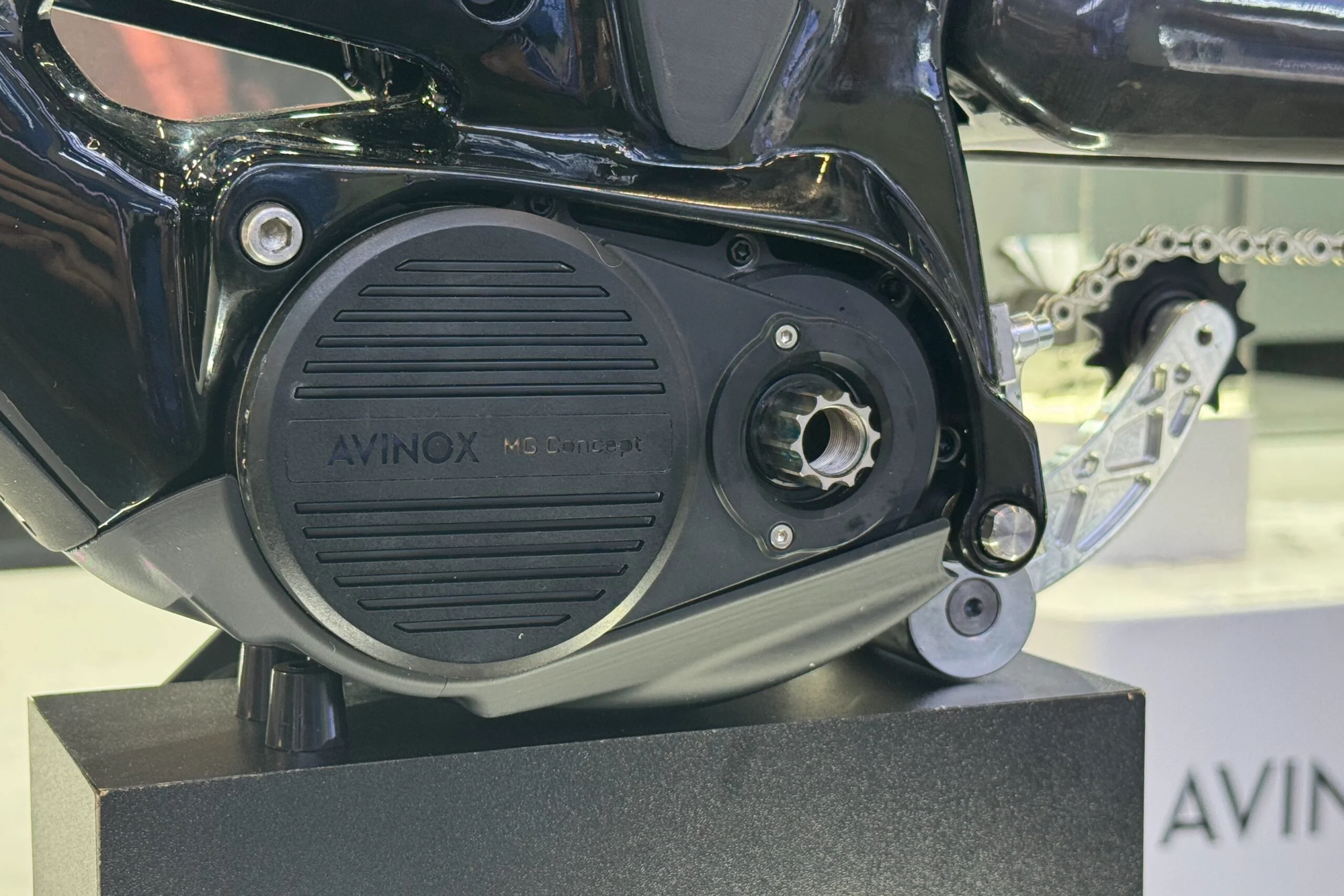

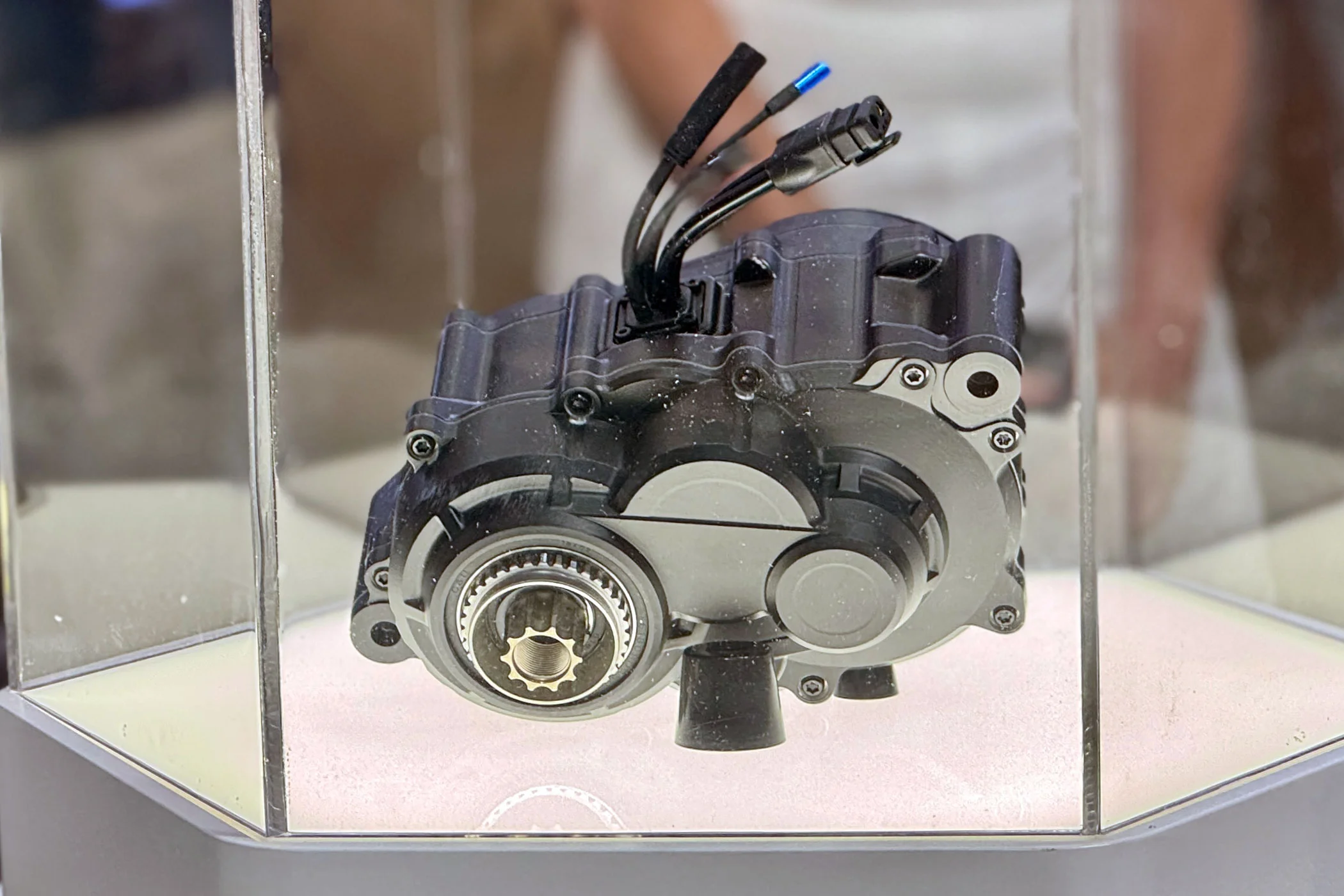

Fotos from Bikerumor:
Avinox-MG-Concept-combined-eBike-motor-and-gearbox-drivetrain_Tech-Specs_1-smooth-natural-rid...webp
Avinox-MG-Concept-combined-eBike-motor-and-gearbox-drivetrain_Tech-Specs_2-smoother-seamless-...webp
Avinox-MG-Concept-combined-eBike-motor-and-gearbox-drivetrain_Tech-Specs_3-Eagle-range-with-c...webp
Avinox-MG-Concept-combined-eBike-motor-and-gearbox-drivetrain_Tech-Specs_4-low-maintenance.webp
Avinox-MG-Concept-combined-eBike-motor-and-gearbox-drivetrain_Tech-Specs_5-regenerative-braking.webp
Avinox-MG-Concept-combined-eBike-motor-and-gearbox-drivetrain_Tech-Specs_6-for-all-ebike-plat...webp
Avinox-MG-Concept-at-2026-Eurobike_prototype-lightweight-full-power-eBike-motor-and-gearbox-d...webp
Avinox-MG-Concept-light-full-power-eBike-motor-and-gearbox-drivetrain-combined_inside-prototy...webp
