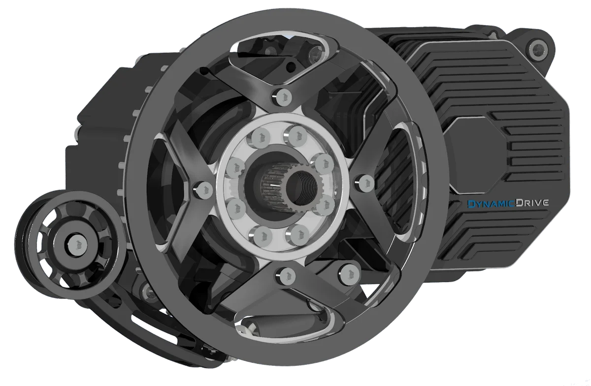

Tensioners are the bane of MGU and gearbox designs. I've harped on this for quite some time and its problem that needs to be solved along with the motor tech. Villeger Dynamic a couple of years back (nothing from them since) has a ECVT motor design with integrated tensioner optimized for the motor - a cool concept.
But judging from these first entries, quite a lot of design progress is needed.
