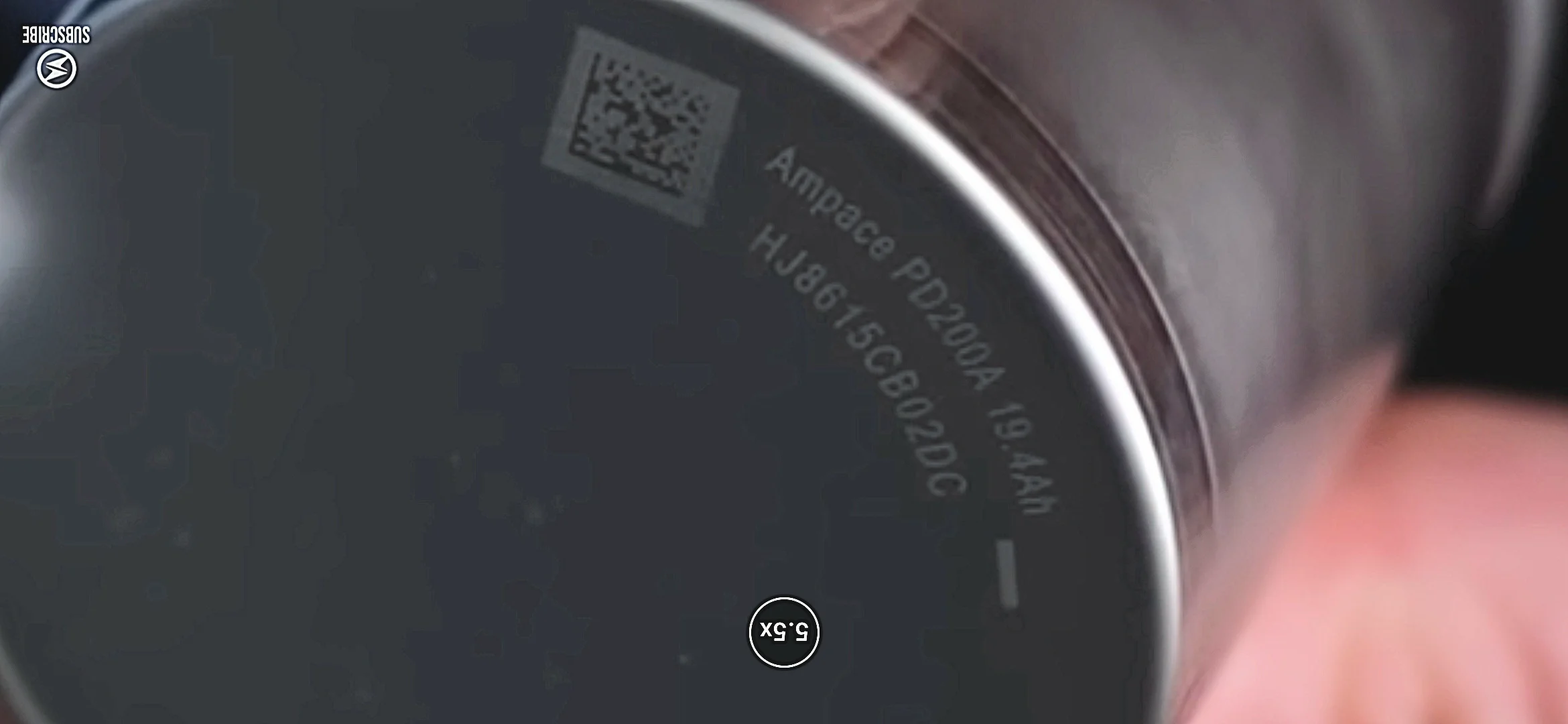

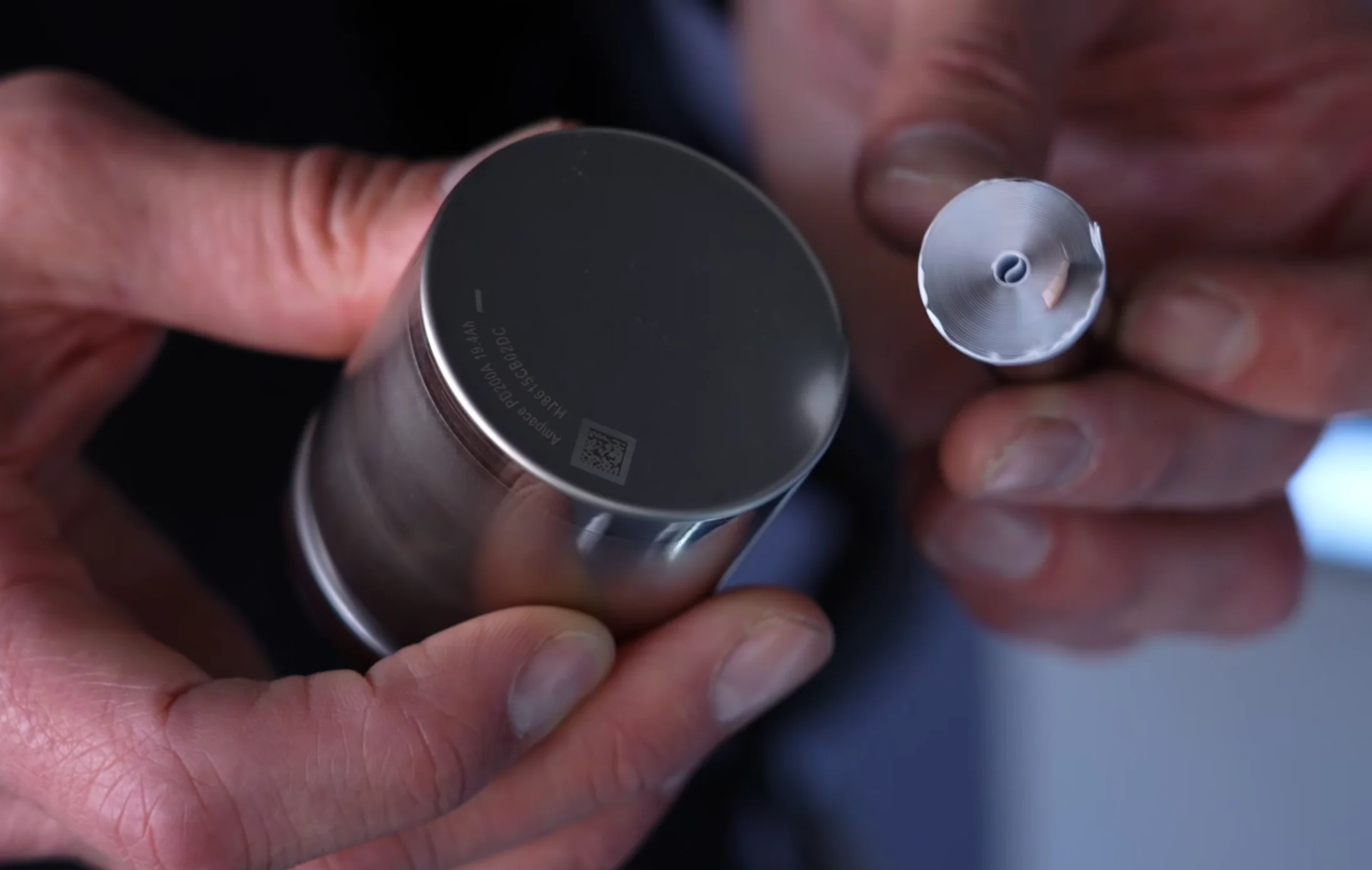

Good screen grab of the cell with some more information on the bottom. Looks to be a Ampace cell not LG like was previously thought in in this thread. Looks to have the model number of "PD200A" and have a 19.4ah rating. Using this I was able to find a article about the new cell where they mention the size format as a 50480, so slightly thicker but also shorter than originally thought. Interestingly though the estimated volumetric energy density seems to be lower than the out going M58T, being (compete estimates and likely to be off until official docs are out) at around 760wh/L which is significantly lower than say the upcoming M65A at 943wh/L.
Excellent detective work 🤟. Interesting, actually a real custom(all-tab/tabless) cell, so slightly (4mm) thicker and (2mm)shorter than we thought. They really went the extra length to do this.
Screenshot of the cell info:
What is interesting is who is Ampace or better said who is their dady, I guess most people have heard about CATL.
Xiamen Ampace Technology Co., Ltd. ("Ampace") is owned by Contemporary Amperex Technology Co., Limited (CATL) and Amperex Technology Limited (ATL).
  • Joint Venture: Founded in April 2021, Ampace is a joint venture created by combining resources from CATL (a world leader in EV batteries) and ATL (a top company in consumer electronics batteries).
  • Purpose: The company was established to focus on R&D, manufacturing, and sales of medium-sized batteries, energy storage systems (ESS),...
Considering the fact that the largest EV battery manufacturer supports Ampace and the fact that Amflow went extra length to do a real custom cell, gives hope this cell isn't a dead end like a fixed 46 diameter would be.
Edit: my previous calculations were not ok as I didn't use exponential cell volume growth as @terro corrected me ✌️ great to have such a fine community here 👍
For example if they increased the dimensions of this cell they can up the capacity also and keep the round downtube shape. Small increase in diameter, for example to 55mm it would get us a volume increase of 21%, keeping it real let's say 19% increase in volume.
19,4Ah + 19% ≈ 23Ah/cell.
10 cells x 23Ah x 3,6V = 828Wh
Doing so could potentially get us slimmer cylindrical downtubes with increased capacity,etc....
