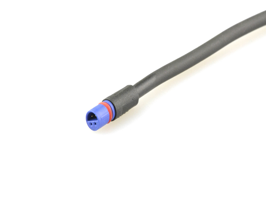

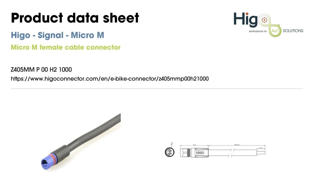

Caveat :
The speed sensor plug (and AXS) on the M2S are changed to 4 pin Higo Z405MM (Micro M) so you would need a new speed sensor or a splice to the new plug or 2.
Female version needed as below.
Speed and Derailleur power cable sockets are both different on the M2S. Good luck finding either.

The M1 uses different connectors for the speed and derailleur power cable. The M2 and M2S use the same Higo Z405 plugs for both. There is a thread about it. We got M2S owners to post pics. I have an M1.
These plugs are near impossible to buy. Let alone getting the complete cable. They should start selling them in the future, but with the madness around Avinox Motors, it could be a while.

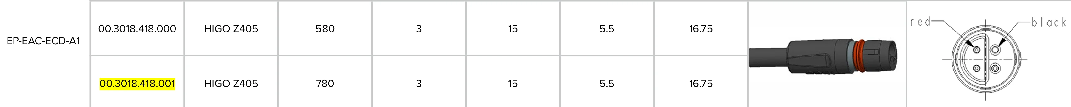

The operative pins appear to be :
1 of the small pins,
and 1 of the small socket type pins.

SRAM Cable Pins :
