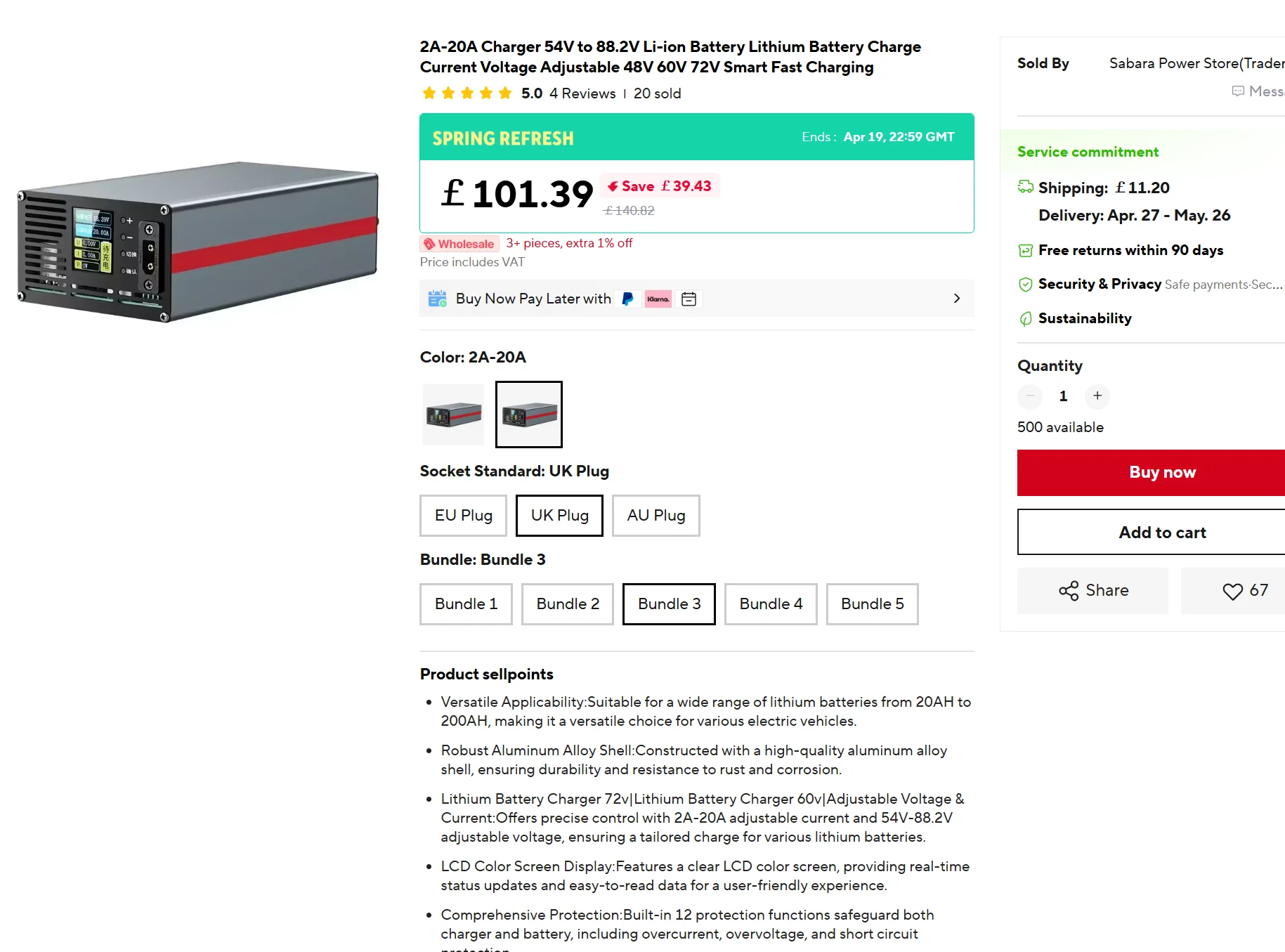

When you say adjustable one from AliX ? Is that for the Avinox, or for other systems ?
Would really like to know what the pin-out for the Avinox charger is, just in case I can adapt my 2A 12V car charger to work with the Avinox !?
TIA
I should have been clearer. It's a generic one, for DIY batteries and ones without firmware protection/handshake protocols. I doubt it would work with Avinox.

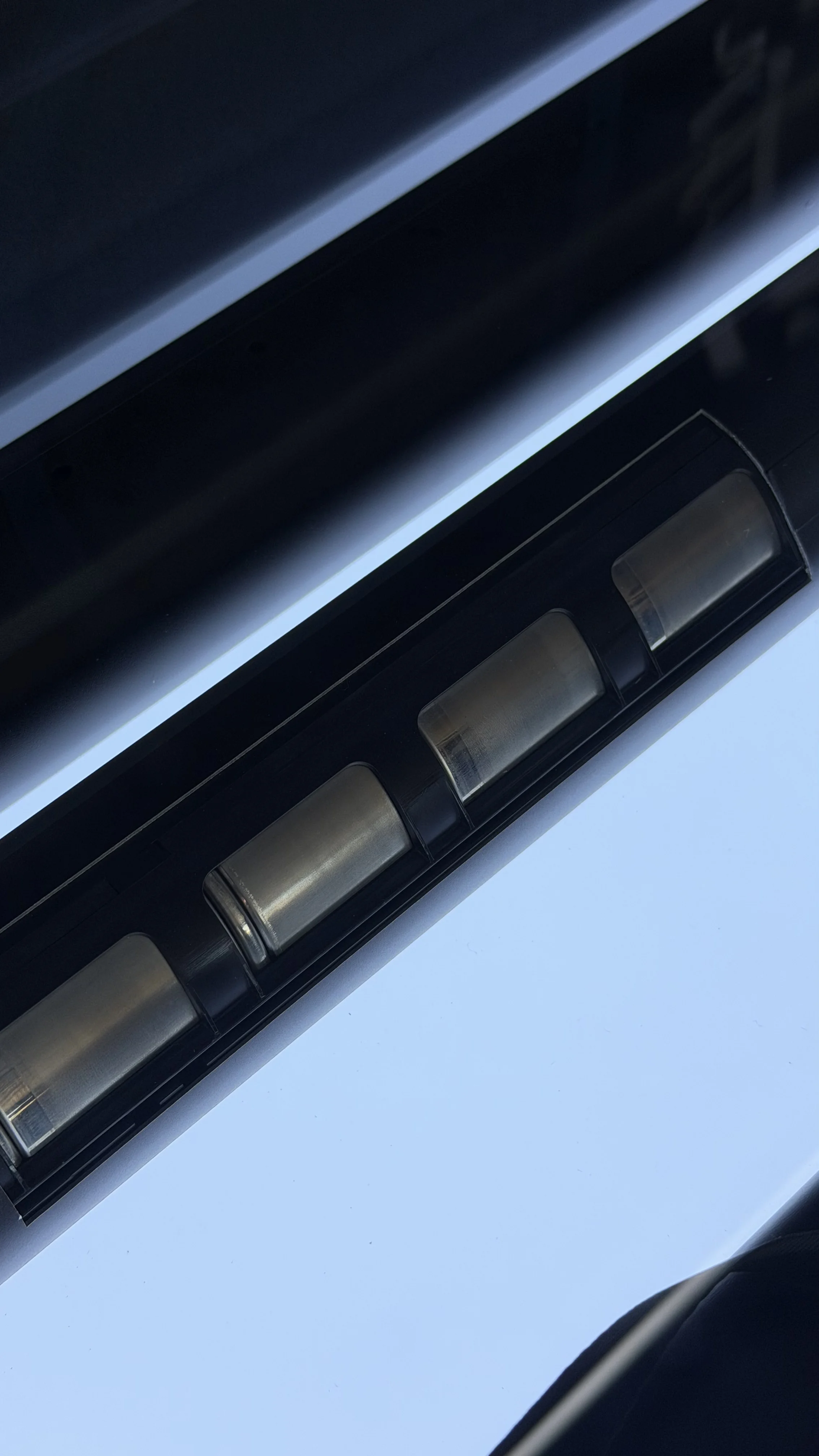

I think they were confined to the 46 format because of the sub cells. Tesla use the 4680 for instance, whilst Rimac shove a couple more in and make the 4695. (Xxyy width length).
I think they went for the 46 cells for the higher current draw potential, they could have made a 700 of similar dimension with 21 cells.
They needed 4650s to achieve the correct voltage with the cells stacked so it wasn't 85cm long.

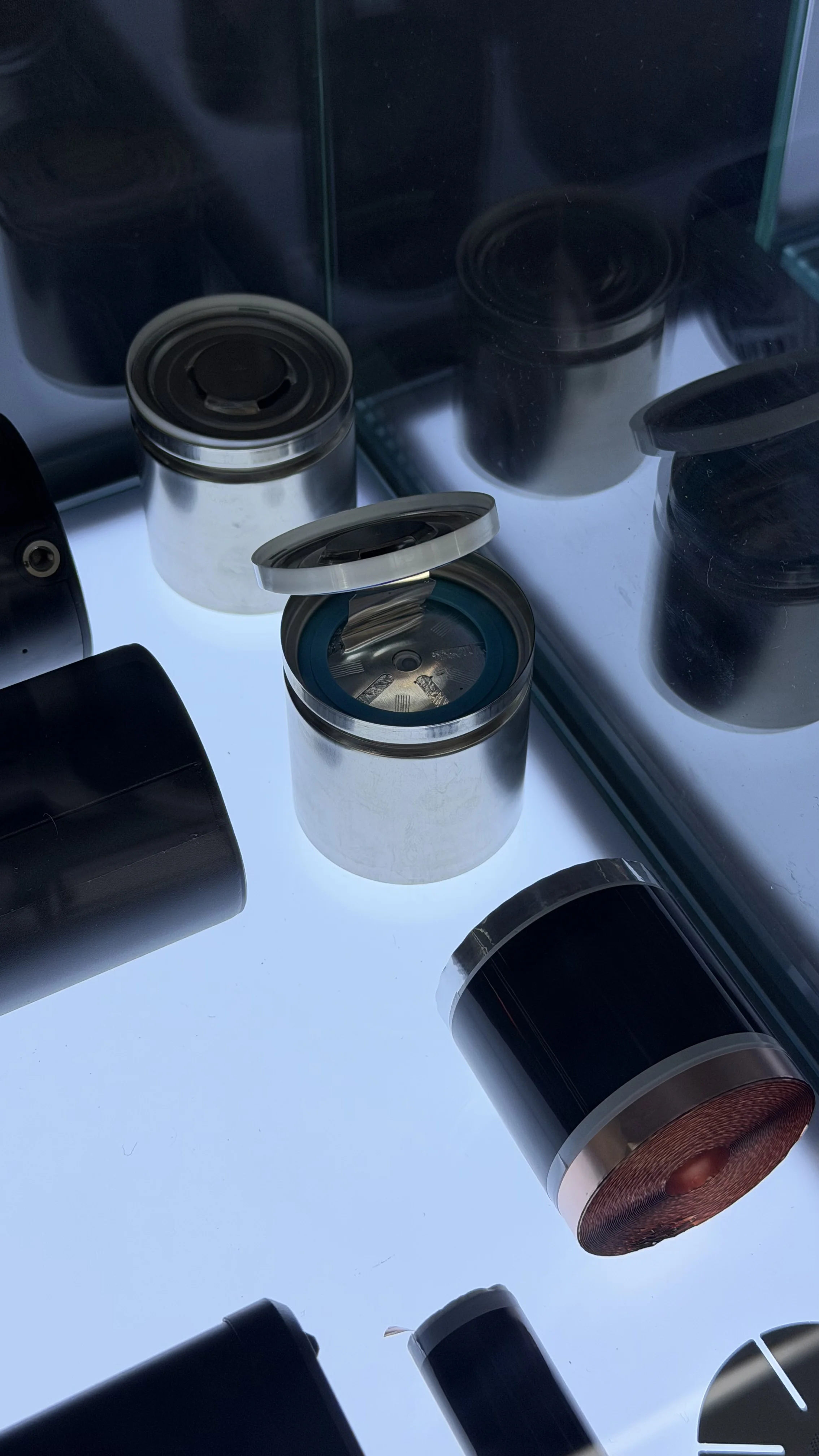

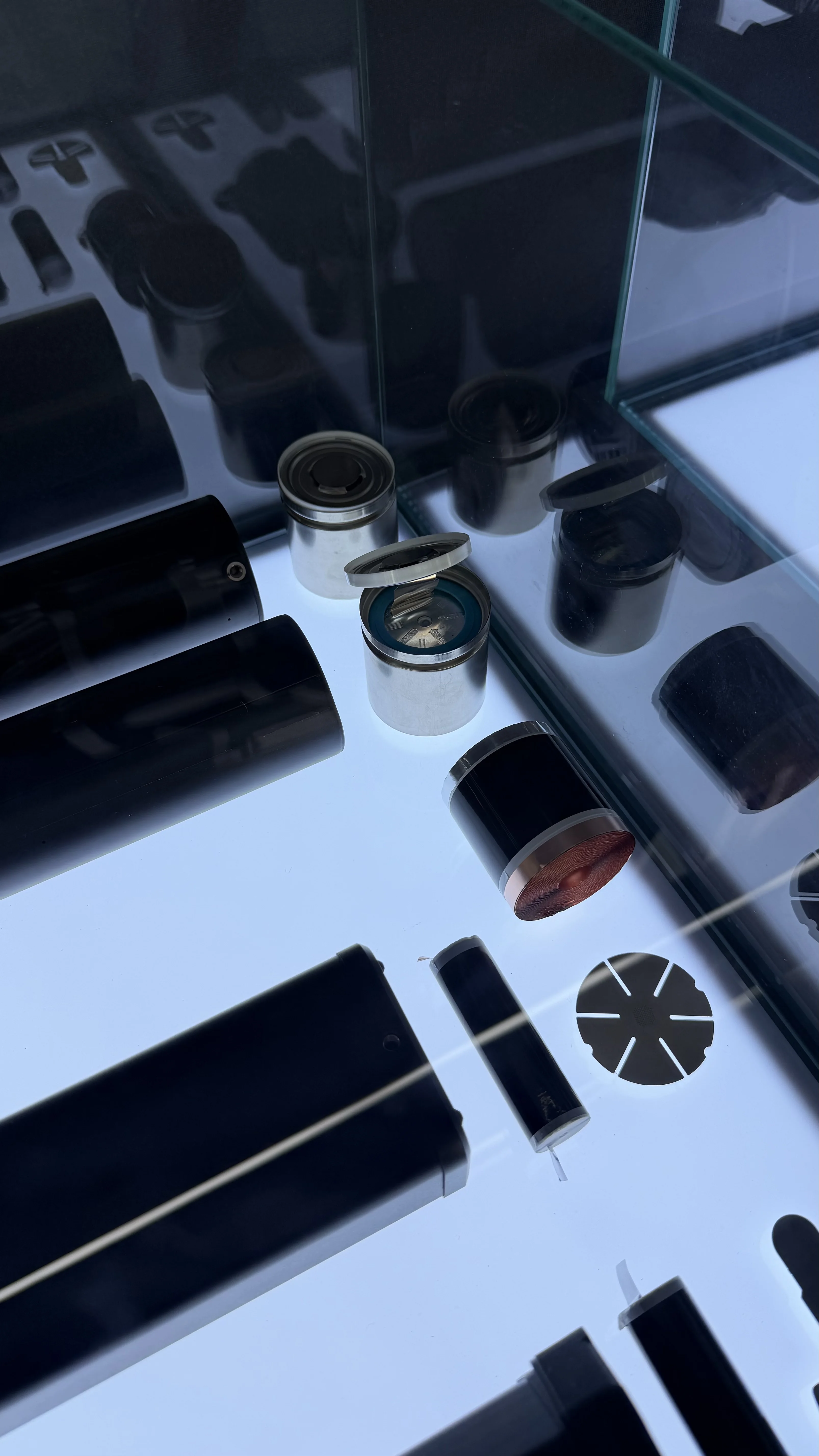

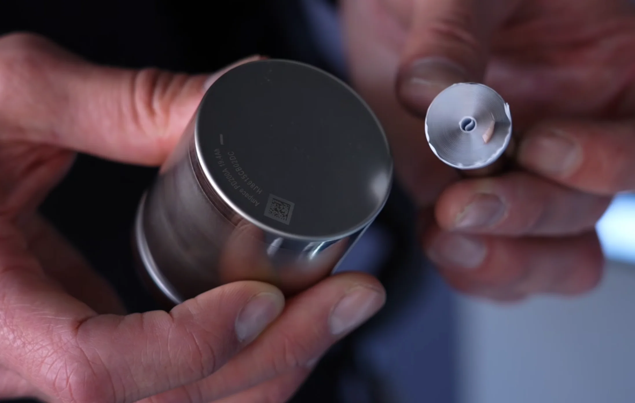

Good screen grab of the cell with some more information on the bottom. Looks to be a Ampace cell not LG like was previously thought in in this thread. Looks to have the model number of "PD200A" and have a 19.4ah rating. Using this I was able to find a article about the new cell where they mention the size format as a 50480, so slightly thicker but also shorter than originally thought. Interestingly though the estimated volumetric energy density seems to be lower than the out going M58T, being (compete estimates and likely to be off until official docs are out) at around 760wh/L which is significantly lower than say the upcoming M65A at 943wh/L.
