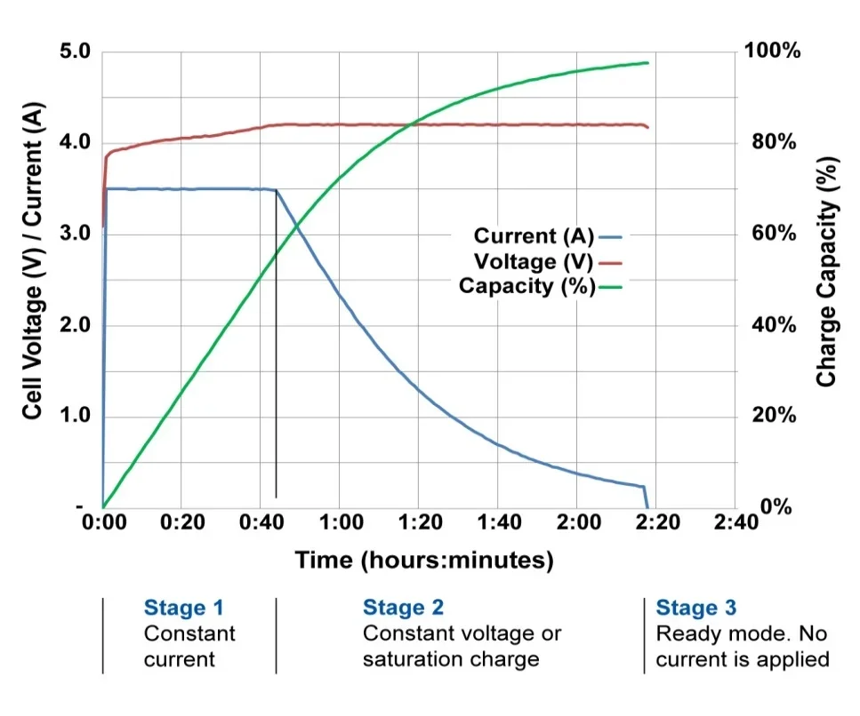

About the charging. The specs say 0% to 75% in 1,5h. I am guessing this is for the 800Wh.
Now this is an example how a lithium ion battery charge curve looks like:
I am guessing that if the cell can sustain the max charge current of 2,7A (LG M58T) for a specific time(this example 40min) without exceeding the maximum allowed temperature it's good to go.
Of course during testing and a few years of data collection(user accounts) they most probably got a pretty good picture how long this first time window where the charge current is at maximum can be and programed the charging algorithms for the chargers and battery bms accordingly.

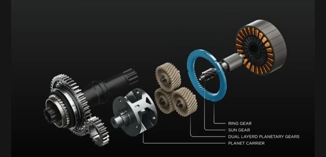

I wonder if anyone has more details about the M2 vs M2S in terms of durability and noise. I've read that the M2S has a better "dual" gearset. I wonder what that actually means and how it will affect long term durability and quietness on the trail? Is there any info on this available?
Just watched a video saying M2s is quieter...
Good question
I guess they could say it's 397% more durable - but we wouldn't know in real world terms for a few years.
I believe the m2S now has some helical gears to reduce the noise whilst the M2 sticks with straight cut.
Good point. I wonder if “dual” gear sets exist anywhere else in the wild? Like maybe in automotive or factory machinery. I’m not even clear on what that means.
My best guess is that it’s two helical gears back to back with reverse cuts. Or maybe a helical and a straight cut back to back?
Anybody know of dual gears used on other applications?

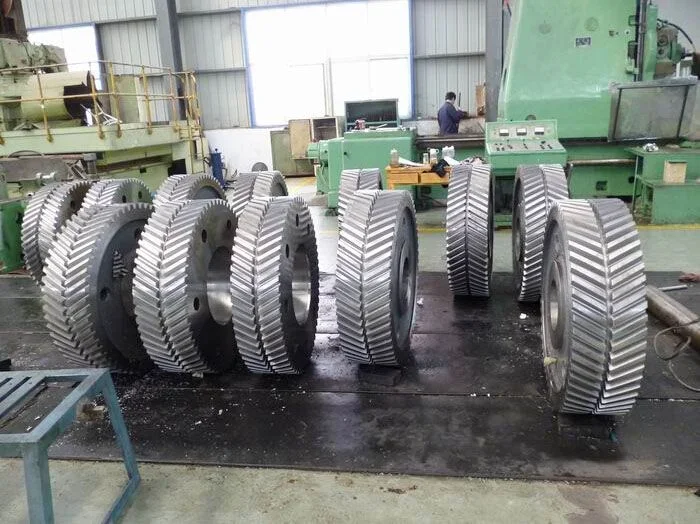

I don't know much further than pros and cons of strait/spur cut vs helical gears. Straight cut have excellent durability easy to manufacture but are loud, helical are quieter but create sideways/axial forces so you need trust bearings and are more expensive to manufacture.
So it's an Interesting topic to build on...
Here's what the internet provides about double helical gears:
Key Pros of Double Helical Gears
  • No Axial Thrust: The opposing helix angles cancel out axial thrust forces, removing the need for thrust bearings on the input shaft.
  • High Load Capacity & Torque: The combined tooth structure, or herringbone pattern, allows for very high torque transmission and greater load capacity compared to single helical or spur gears.
  • Smooth and Quiet Operation: The gradual meshing of helical teeth results in reduced noise and vibration, making them ideal for high-speed applications.
  • Increased Stability and Reliability: The design provides better contact ratios, leading to more uniform load distribution, improved heat dissipation, and overall greater durability.
  • Self-Aligning: The chevron shape can offer improved alignment characteristics in specialized applications.
Double Helical Gear: Design, Advantages, and Applications

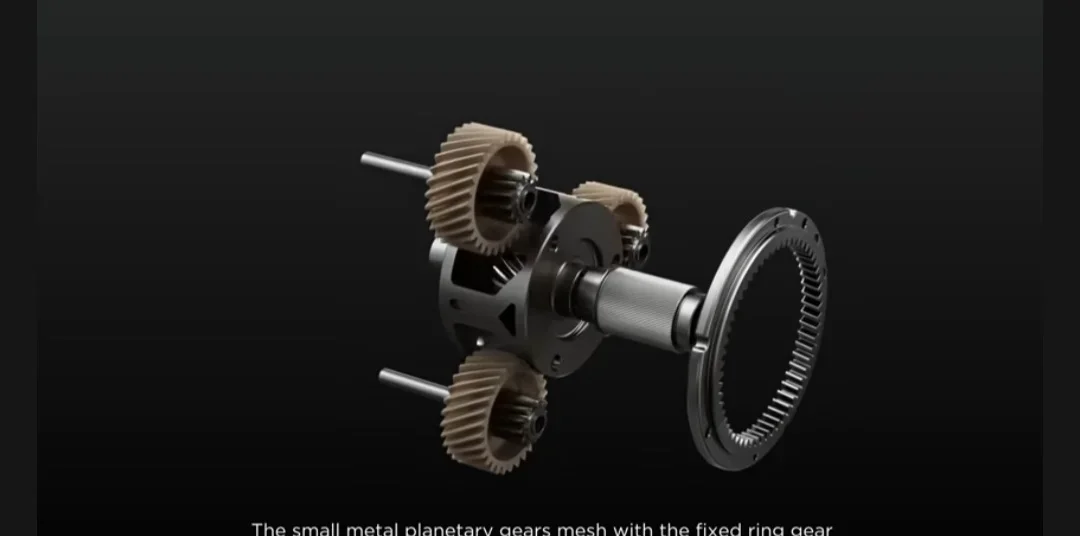

My guess is because the sideways profile of the M2S is a bit wider vs the M1, the main two large gears(bigger on the drive shaft) are now wider and double helical gears. Bottom left on the picture.
My suspicion when studying the internals of the M1 was that the main two straight cut gears were the rattle trouble makers, as usually straight cut gears have extra tolerances for meshing and so can have a significant backlash. @Rob Rides EMTB said that in one of his open examples when testing the planetary gearset created the rattle. On the bottom picture the small metal planetary gears mesh with the fixed ring gear. Looking closely at the small gears they already are helical. So maybe these were made double helical also.
So either the 2 main straigt gears are double helical or the smaller planetary gears are double helical, or both gearsets are double helical, thus the description 》Dual helical gearset《. Hope this makes sense. 🤟
Edit: I just posted the below reply only to see that @emtbeast had been writing up some very similar thoughts at the same time. I'll leave my post as-is though, as it describes a slightly different "dual-gear" method of construction, although that dual-helical setup he shows seems like a likely candidate too...I can't wait to see some cutaways or the first ballsy Youtuber to crack open the casing and show us what's inside the M2S!
@Zimmerframe said: "I believe the m2S now has some helical gears to reduce the noise whilst the M2 sticks with straight cut."
It would be really nice to see a cutaway image of the new M2 and M2S to confirm, but from the various M2/S articles I've read, it's described as the opposite of what Zimmerframe said. The M2 uses what are described as "new" helical gears (vs. the M1) and the M2S uses "dual-gears". Different media sources describe this a bit differently, and I think they're all just regurgitating what the Avinox press materials said, without having seen the internals themselves, which has lead to different descriptions of this gear situation.
The part that leads to the lack of clarity is that the M1 planetary gears were already helical, which you can see in the M1 cutaways (see image below). So when we see a media sources talking about the M2 using "new" helical gears, it is unclear if they mean a refined design of the existing helical planetary gears, or if they have truly added new helical cut gears in the locations where the M1 previously used straight cut gears.
Regarding the question about the "dual-gears" of the M2S, I have seen that tech variously described in different media sources as being either in place of, or in addition to the helical gears, and I haven't seen it specified if the dual-gears are helical dual-gears, or if they are straight cut dual-gears. Based on my understanding of how "dual-gears" work, I would image that they are using them in place of the old straight cut gears, as it seems like it could be pretty tricky to get them to work in a helical application. The reason being that dual-gears are typically 2 gears functioning as a parallel unit, with either the teeth of the 2 gears slightly offset, or with some sort of springy element that allows a little free movement between the 2 sets of parallel teeth. That allows one set of the dual-gear teeth to tightly mesh with the front side of the opposing gear, and the other set of the dual-gear teeth to tightly mesh with the back side of the opposing gear, eliminating the free play that would normally be required to prevent binding.
Helical gears are quieter, straight cut are louder, but straight cut also have less friction than helical and will make more power in a motor vs helical gears. Tl the point about more friction is true it would make the motor less efficient. Yet, it is rated at 84.5% ..
We have enough power but the point about more friction is true it would make the motor less efficient. Yet, it is rated at 84.5% ..
Do we know what are the competitors gears?
M2S — dual-gear meshing (a polymer tooth segment offset against the metal gear to eliminate backlash). This is the more sophisticated solution, designed to handle the higher 150Nm loads.
M2 — helical gears alone, without the dual-engagement polymer segment. Simpler, but sufficient at 125Nm.
Apparently both m2 and m2s are score same noise level.
