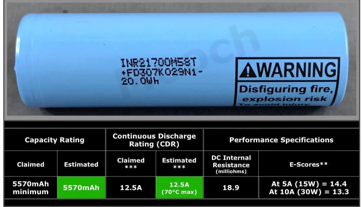

Regarding the disappointing energy density of the FP700. IMO we need to compare the old fixed 600Wh vs the new 700Wh, possible 700Wh with 21700 cells and then the old fixed 800Wh and a possible 936Wh.
The current fixed Avinox batteries were/are supposedly using the LG M58T 5,57Ah cells that weigh ≈ 71,2g. The new Molicel 6,5Ah M65A weighs ≈ 74,5g. That's a difference of ≈ 3,3g per cell.
We have 30 cells in a 10S3P(100g more) and 40 cells in a 10S4P(130g more) pack.
The dimensions of the cells in length and thickness are basically negligible, so the sizing of the pack can stay the same.
FS600 》
600Wh/2,87kg = 209Wh/kg
Cell LG M58T 5,57Ah, 71,2g
FP700 》
700Wh/3,18kg = 220Wh/kg
Cell Custom LG 4650 70Wh, cca 250g
700Wh with the newest 6,5Ah cells (my prediction last fall):
702Wh/2,97kg ≈ 236Wh/kg
Current fixed FS800 》
800Wh/3,74kg ≈ 214Wh/kg
10S x 4P x 3,6V x 6,5Ah ≈ 936Wh
New 936Wh/3,87kg ≈ 242Wh/kg
Recap:
FS600(old fixed): 209Wh/kg
2,87kg
702Wh(My prediction) 236Wh/kg (+13%)
2,97kg
FP700(new fixed): 220Wh/kg (+5,3%)
3,18kg
___________________________
FS800(old fixed): 214Wh/kg
3,74kg
936Wh(My prediction) 242Wh/kg (+13%)
3,87kg
What we can see is that the lower energy density with the new FP700 comes from the increased weight of the whole pack, cca 200g more than my predicted equivalent with best 21700 cells.
In a pack made by smaller 21700 cells we have internal cell holders/spacers(plastic) that also serve as a structural part of the pack, aiding rigidity of it.
The new FP700 is long and thin and only has 10 cells stacked in one column without the previously mentioned structural cell holders/spacers as we don't need them here. The rigidity of a such structure by itself obviously isn't strong, so it needs a strong support(housing).
Because of that the housing needed thicker walls than usual to get the pack to the desired rigidity for passing all the certification tests, and that's is the reason why the energy density of the new FP700 is somewhat disappointing.
Why they didn't build it with the 6,5Ah 21700 cells, I don't know.
Could be longterm contracts with LG, could be tensions between China and Taiwan(Molicel), could be that the Chinese FEB 6,5Ah cells aren't/weren't up to standards...we can't know.
If the 936Wh 3,9kg pack, or a 235Wh 1kg REx, or a 470Wh 1,9kg REx come that would indicate the use of 21700 6,5Ah cells.

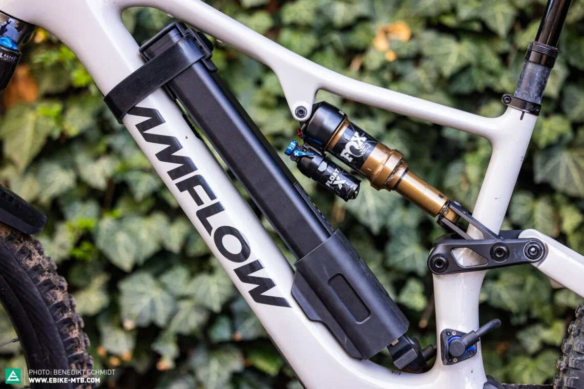

Just in case you haven't seen this image of the RS600 showing the full bracket and strap arrangement, with the little loop cable.
As this is now the battery thread ...
Damn that's ugly but I guess effective.
The issue with that setup will be bike size and bike make. Some models won't have enough space to fit that into the triangle area. I suspect that battery won't fit on a small frame, unless that is a small already. Also wondering how secure that setup is if you choose to "send it"....:oops:

RS600 Battery
Amflow PR
3. When used as an external battery, the Avinox RS600 Battery is only compatible, due to size constraints, with L, XL, and XXL frame sizes of Amflow PR Carbon and XL and XXL frame sizes of Amflow PR Carbon Pro.
Amflow PX
12. Due to size constraints, the Avinox RS600 Battery is only available for XL and XXL models in the Amflow PX series and is sold separately. Additional configurations will be available soon.
Not currently listed on the Avinox Accessories page (UK)

I'm now >80% confident they are still using the LG M58T or a very closely-related member of the M58 family.
  1. The nominal voltage of the RS800 is 35.9. The nominal voltage of the M58T is 3.59 so this fits a 10s4p (4 parallel groups of 10 cells) configuration perfectly.
    1. With a quick search, I cannot find any other cells with 3.59 nominal voltage; most are between 3.6 and 3.7. If there are no such cells, this alone is very strong evidence the M58T is being used.
  2. The claimed capacity of the RS800 is 800 Wh. The "nominal capacity" of the M58T is 5.8 Ah, which would give 5.8*4*35.9=832.88 Wh. However, the "minimum capacity" on the data sheet, which is much more accurate in my experience, is 5.57. That would be a great match: 5.57*4*35.9=799.9 Wh.
    1. This is only moderately strong evidence, because claimed Wh capacities of battery packs tend to be rounded by manufacturers/retailers.
  3. Another source claims the capacity of the RS800 is 22.3 Ah, which is also a good fit assuming a 5.57 Ah per-cell capacity: 800/35.9 (or 4*5.57)=22.28 Ah.
    1. This is strong evidence because, following standard rounding conventions, 22.3 Ah only works for cells between 5.57 and 5.59 Ah (5.56*4=22.24=22.2; 5.60*4=22.40=22.4). I cannot find any other cell with "nominal" or "minimum" capacity within that very narrow range.
  4. The RS800 charger maxes out at 12 A, which in 4p configuration would give 3 A per cell. The max charge current of the M58T is 2.7, which in 4p configuration would permit 2.7*4=10.8 A. If they use the same cells in 600 Wh packs, which are presumably 10s3p, the charging limit would be 2.7*3=8.1 A.
    1. I see this as moderate evidence against the M58T being used. Generally manufacturers will try to keep the current below the max, to prevent overheating and cell degradation. But perhaps they did some testing, or sought advice from LG, and decided 12 A would be fine. Also, the cells allow up to 5 A charging if the charging voltage is reduced to 4.0 A per cell (rather than the usual 4.2 A), so maybe the charger has some firmware that charges in two stages or something? Or maybe it doesn't actually charge at the full 12 A? I would like more information on this.
  5. Avinox used the M58T for their old FS800 and FS600 (fixed) batteries, so it would be odd for them to switch to a different cell that had exactly the same specs. The M58T is also used by Bosch.
    1. A fairly weak but non-trivial point in favour of the M58T.
  6. Aside from the M58T, there are apparently three additional cells in the M58 family: M58, M58V, and M58VT.
    1. This does weaken the case for the M58T in particular being used. However, Chat GPT couldn't find spec sheets for those other three, and what little info it could find appears to be the same as the M58T, so it might just be the type of wrapper used or something irrelevant like that.
So I'm pretty confident it's the M58T or another LG cell that is essentially identical. My main doubt comes from the 12 A Avinox charger, which is beyond what that cell is rated for in a 10s4p pack.

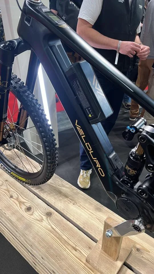

May end up being suboptimal as well.
that’s a third party range extender:
