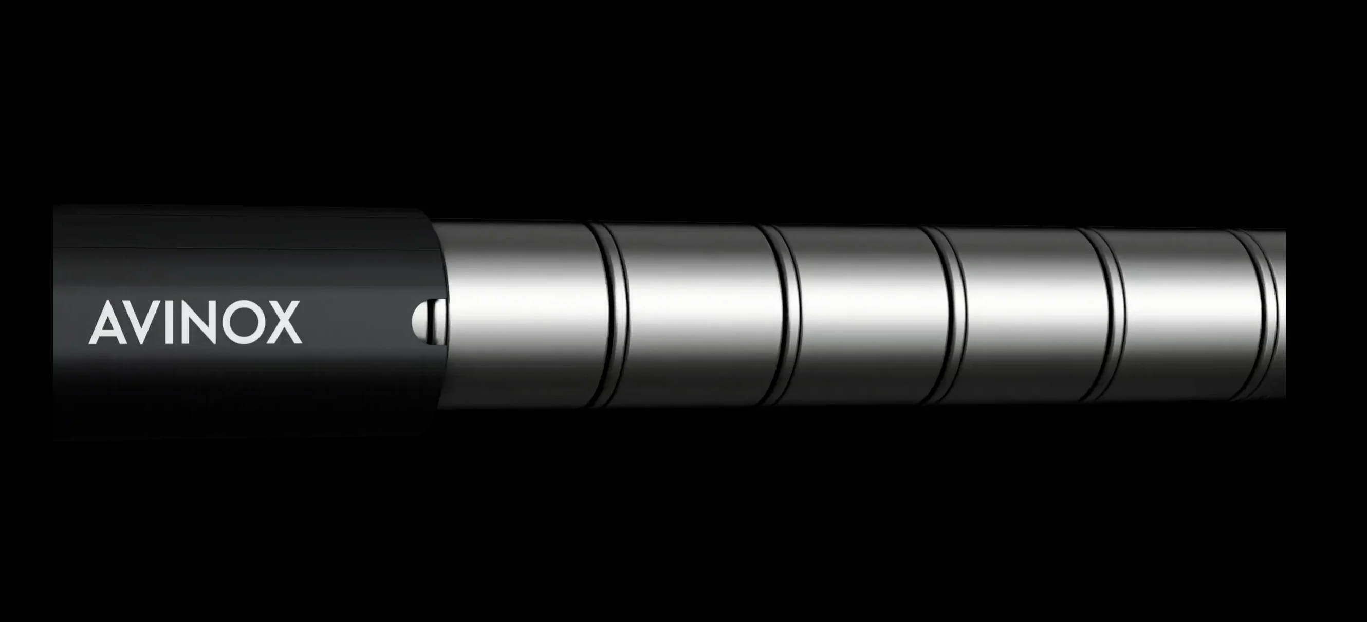

There is video on their website which shows the internals of the battery:
Avinox Antriebssystem – Akkus – Avinox
They are probably using 4650 batteries.

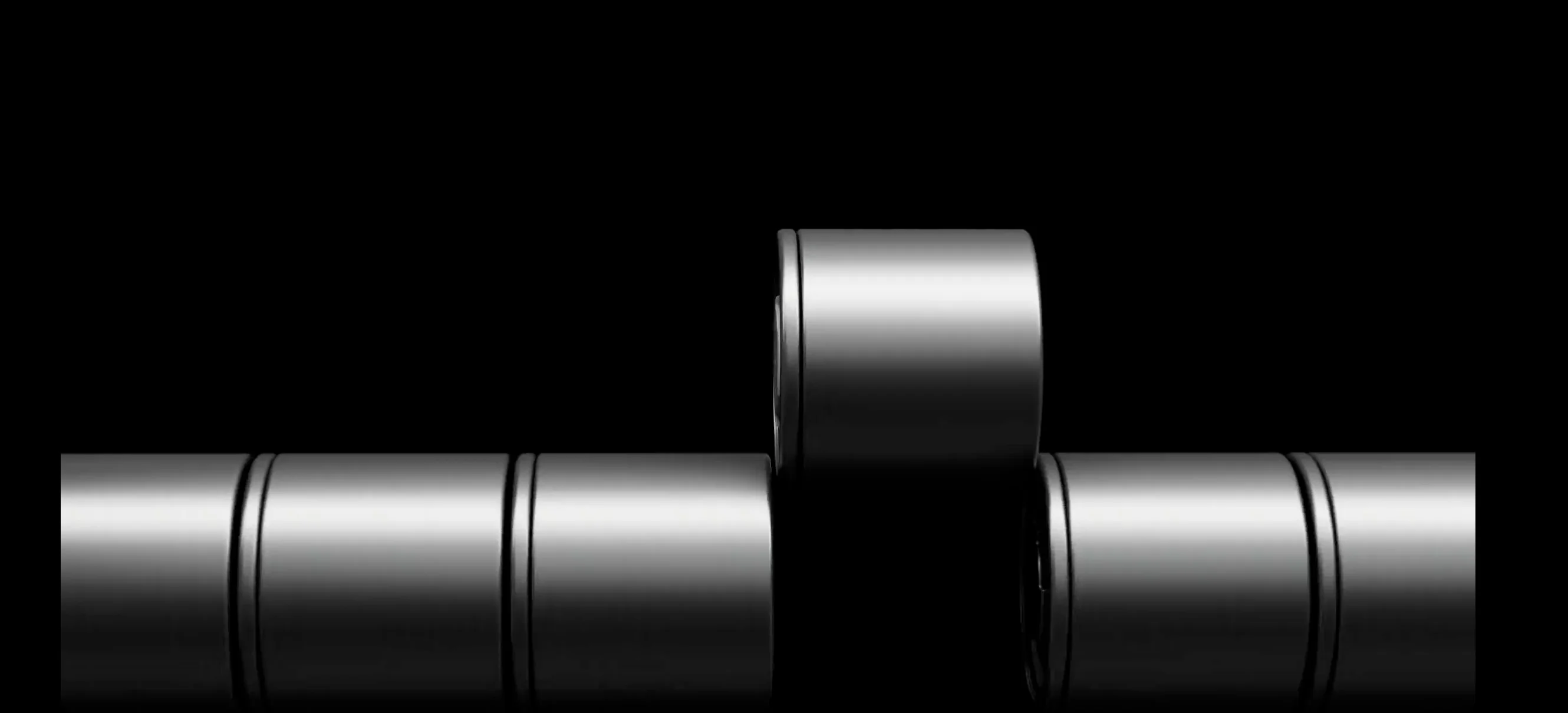

The length of the FP700 battery pack was published by Avinox on their website as 558.5
interestingly this is a tad too short for 7x4680 modules but let's assume they can cram 7 of them.
These guys claim 97Wh nominal per module:
7*97 seems right on the money for the 700Wh FP700 but it does not make sense from the nominal voltage of 36.1V PoV
So I am puzzled and fascinated by the mistery :)

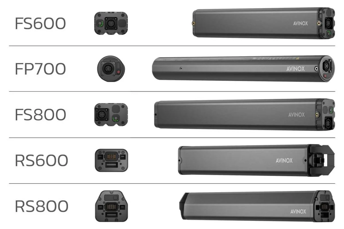

Specs from Avinox Spares (Accessories)
FP700 Battery : NEW
558.5×59.1×56.1mm - 700Wh - 36.1V
3.18KG
Form: 10S
RS800 Battery : NCM Lithium
434.5×71.8×69mm - 800Wh - 35.9V
4Kg
? Form: Looks odddly triangular ! 3P ?
RS600 Battery - Amflow listing has disappeared ! Other Sources Online
2.96Kg
? Form: Looks oddly rectangular ! 2P ?
Original
FS800 Battery : NCM ?
Dims ? 800Wh - 35.9 V
3.74 kg
? Form: 10S4P ?
FS600 Battery : NCM ?
Dims ? 600Wh - 35.9 V
2.87 kg
? Form: 10S3P ?

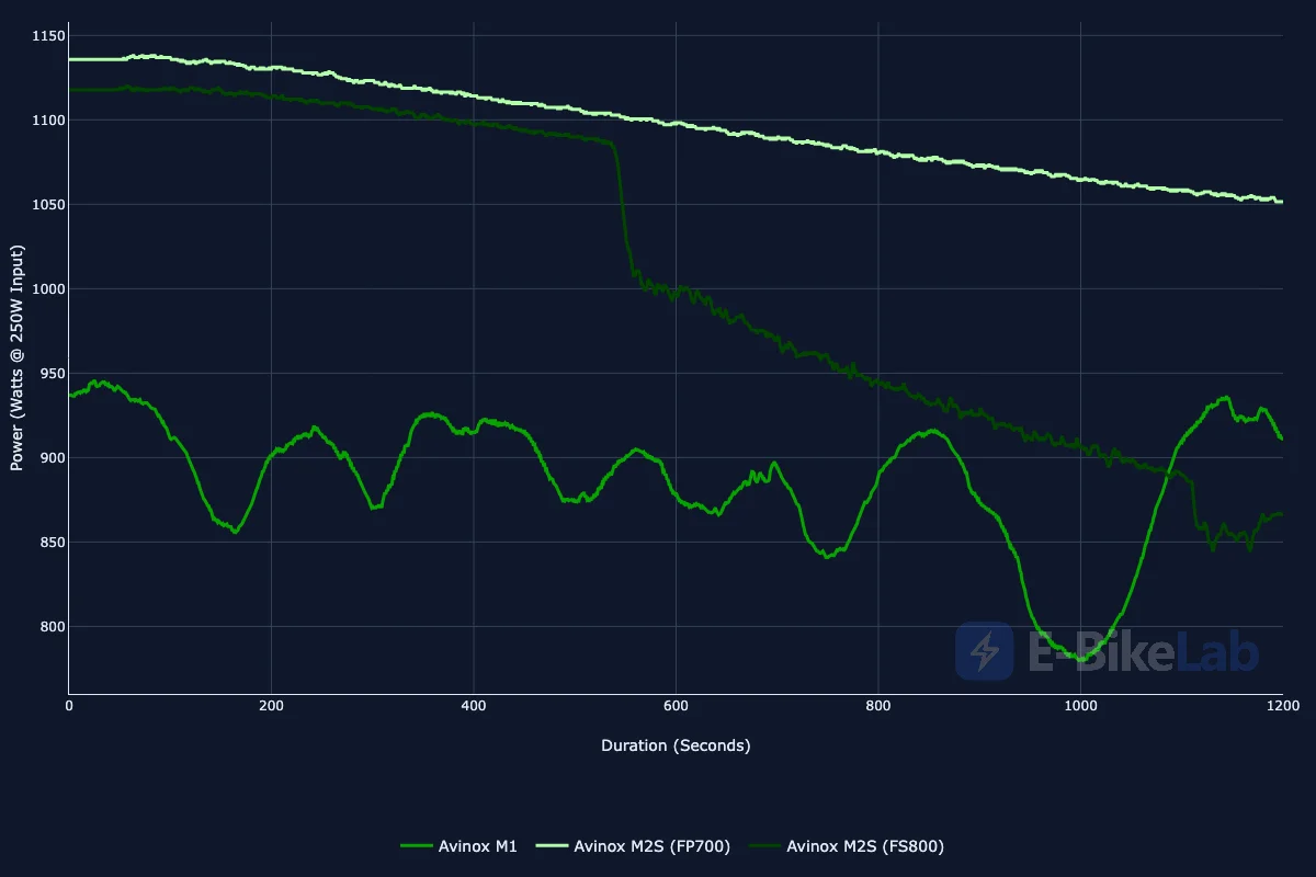

Also a main difference is the thermal performance decay - the stability of the new battery is insane:
I think this graph more than anything else I've seen this early on is perhaps the most important. The M2S turns out to be substantially different than the M1 in sustaining power, and as a byproduct more efficient as well. It's interesting that the M2 hangs with the M2S but then gives up the ghost midway. I wonder if this is a nerfing of sorts or there's enough of an internal design difference to warrant this decay suddenly.

🔋 Avinox Battery Comparison​
🔵 FP700 (700Wh) 19,4Ah​
  • Capacity: 700 Wh
  • Weight: ~3.18 kg
  • Mounting: Fixed
  • Dimensions: 558.5 × 59.1 × 56.1 mm
  • Voltage: 36.1 V
  • Cell configuration: 10S
  • Cell type: Custom 4650 (large-format)
  • Estimated cells: ~10 (large cells)
  • Energy density: ~220 Wh/kg
🟢 FS600 (600Wh) 16,7Ah​
  • Capacity: 600 Wh
  • Weight: ~2.87 kg
  • Mounting: Fixed
  • Dimensions: 434.5 × 72.6 × 50.2 mm
  • Voltage: 35.9 V
  • Cell configuration: 10S3P
  • Cell type: 21700 cylindrical
  • Estimated cells: ~30
  • Energy density: ~209 Wh/kg
🟢 RS600 (600Wh) 16,7Ah​
  • Capacity: 600 Wh
  • Weight: ~2.96 kg
  • Mounting: Removable
  • Voltage: 35.9 V
  • Energy density: ~202 Wh/kg
🔴 FS800 (800Wh) 22,3Ah​
  • Capacity: 800 Wh
  • Weight: ~3.74 kg
  • Mounting: Fixed
  • Dimensions: 560.4 × 71.5 × 49.1 mm
  • Voltage: 35.9 V
  • Cell configuration: 10S4P
  • Estimated cells: ~40
  • Energy density: ~214 Wh/kg
🔴 RS800 (800Wh) 22,0Ah​
  • Capacity: 800 Wh
  • Weight: ~4.0 kg
  • Dimensions: 434.5 × 71.8 × 69 mm
  • Voltage: 35.9 V
  • Energy density: ~200 Wh/kg

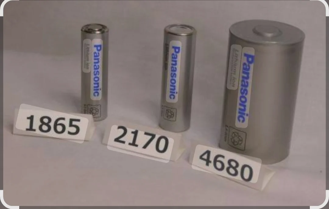

The new 700 is the only pack using the new custom 4650 cell(46mm width x 50mm length)suposedly made by LG. There is no online information about this cell. LG and Panasonic make other in EV industry widely used 4680, 4695 and 46120.
In the picture a comparison of 18650, 21700 and 4680.
The 4650 would be 3cm shorter than the shown 4680.
All the other packs use the 21700 cells.
The new removable packs most probably use newer versions of the 21700 cells that has a higer discharge current limit(New chemistry) as these packs are allowing a higher peak motor power output of 1500W.
But as the old ones they still have the same capacity that is cca 5,6Ah.
The 600Wh(fixed and removable) packs are by dimensions basically identical apart the connector that is different. Internal stack is probably 6 rows x 5 cells.
The 800Wh packs only have a different internal layout of cells stacking.
Old fixed one has 6 rows x 7 cells(one row only 5 as we need only 40 total).
New 800Wh removable pack trapezoidal shape has a similar stack as the 600Wh packs in the lower rectangular part because it's also of the same length as the 600Wh but to reach 40 cells needed it adds another 2 rows on top(trapezoidal shape), so basically 8 rows x 5 cells. The form factor of the removable 800Wh pack is nice because it's short, it moves the center of gravity lower.
