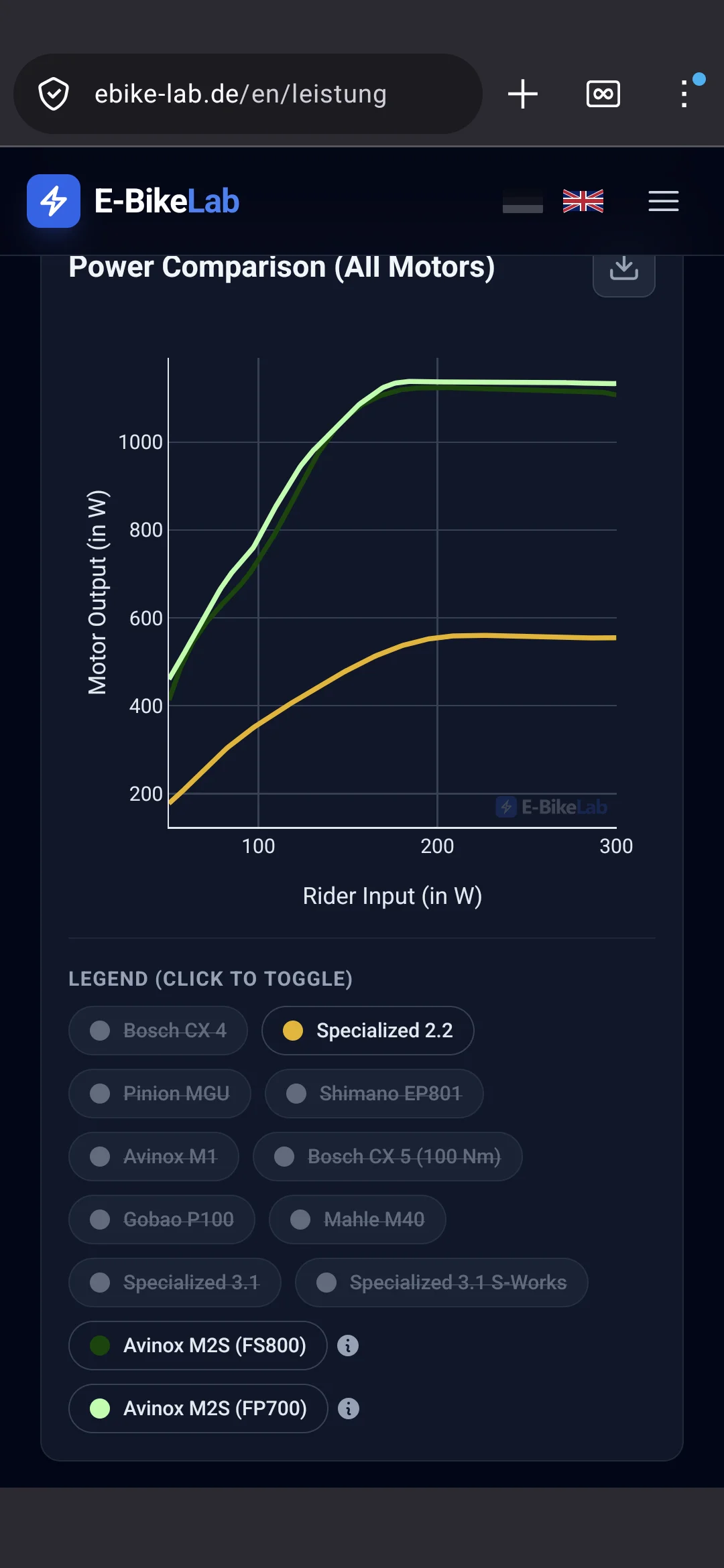

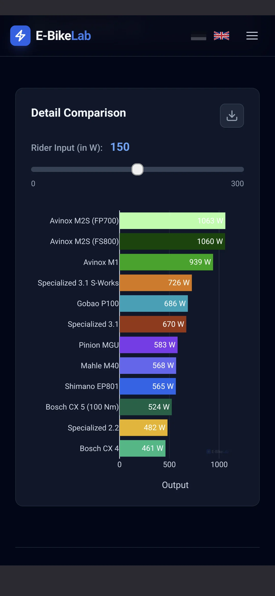

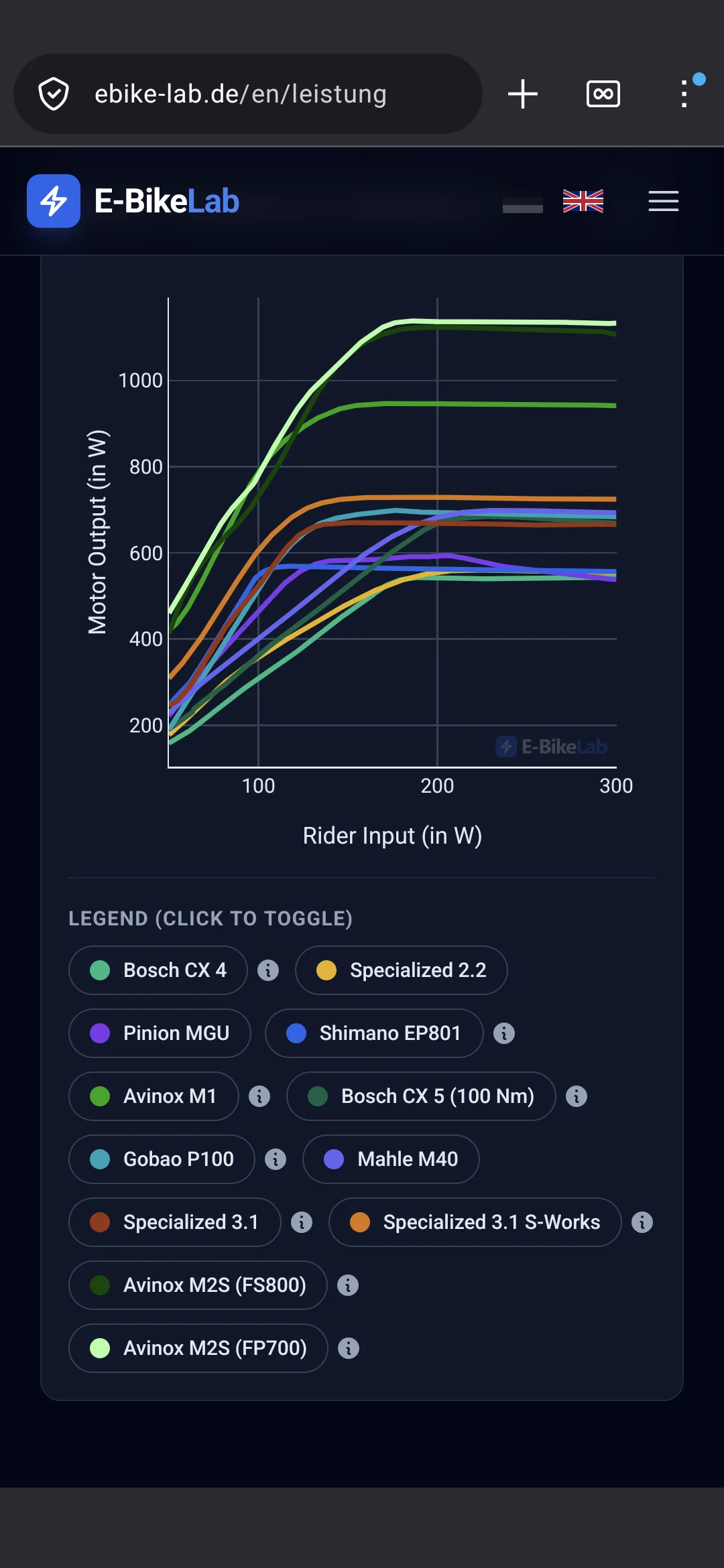

Nice interactive graph.
👍 Thanks for the link

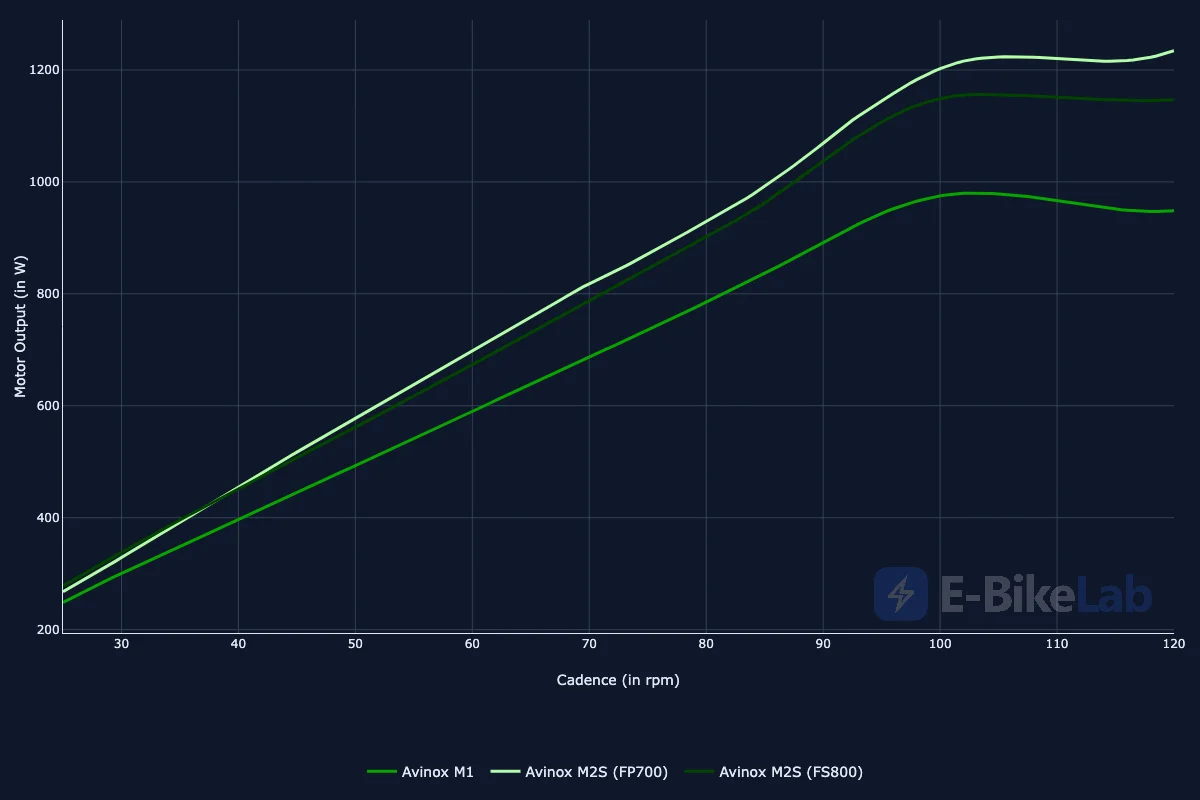

M2S seems much the same in this test with either the 700Wh or 800Wh battery. #1
M1 comes in at #2
The main power difference between the new 700Wh and the old 800Wh battery can only be seen with a high cadence (where the motor goes to the peak power). You can see this in the "Cadence Behavior - Absolute"

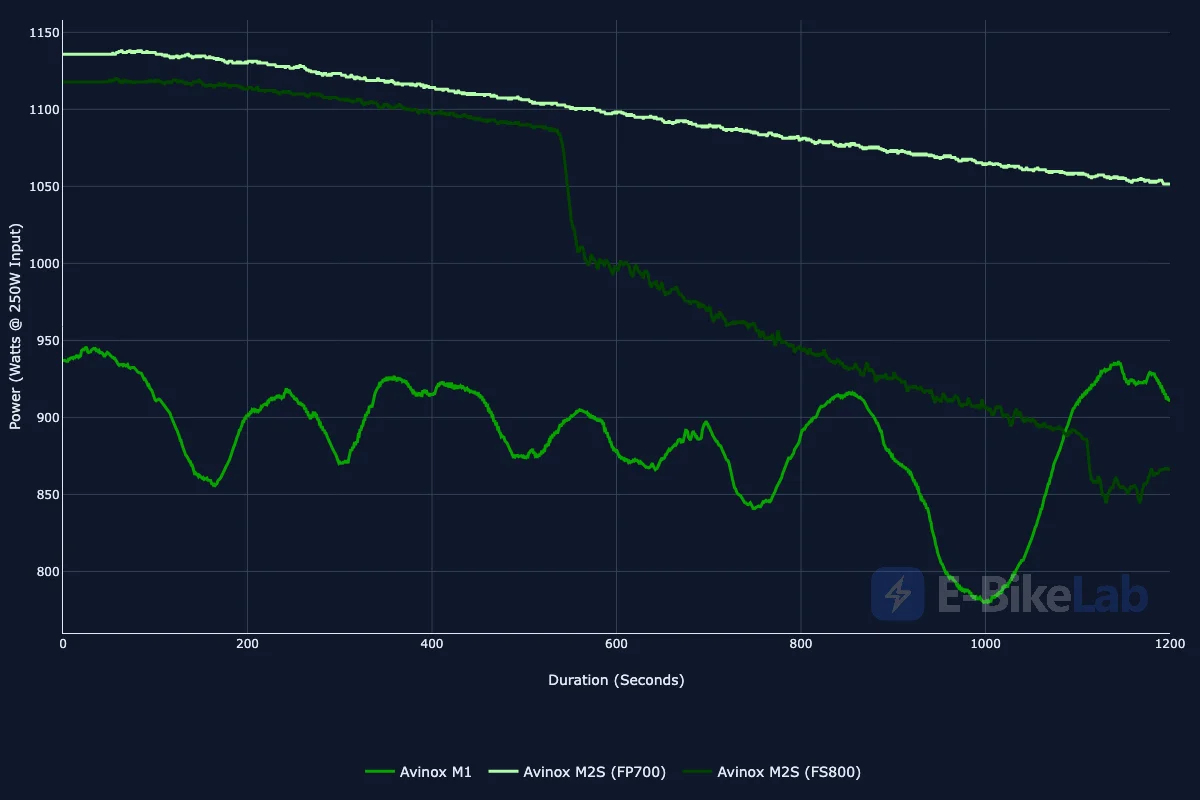

Also a main difference is the thermal performance decay - the stability of the new battery is insane:
Thanks for the extra info 👍
