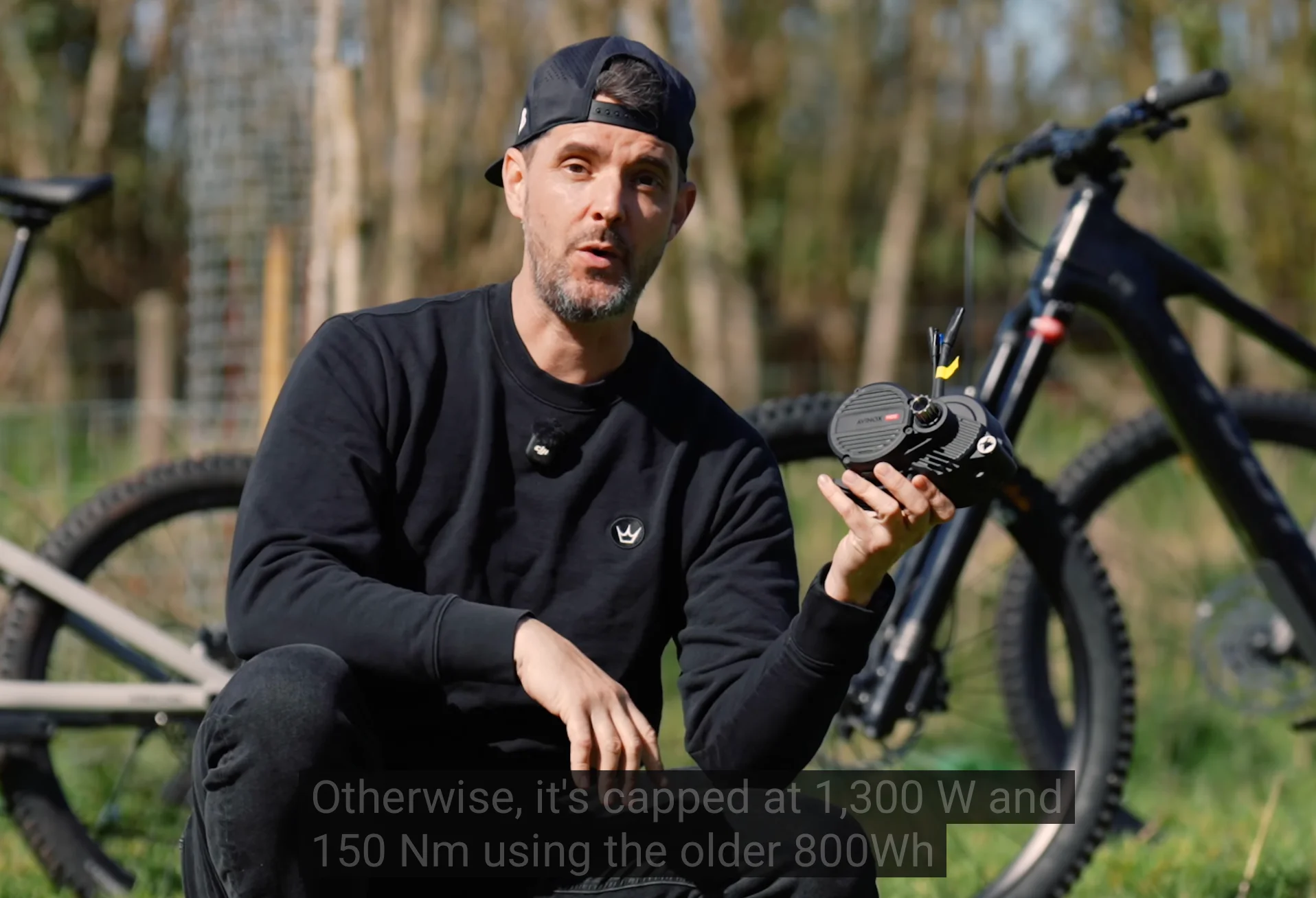

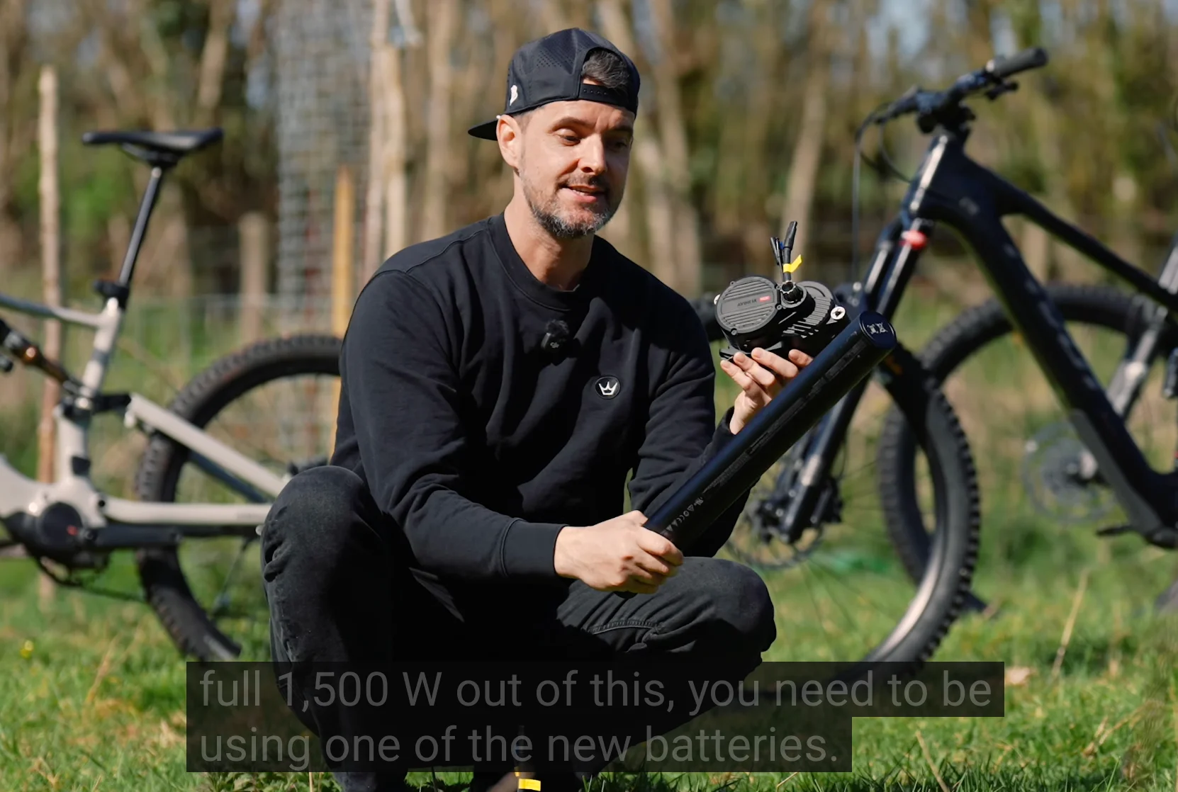

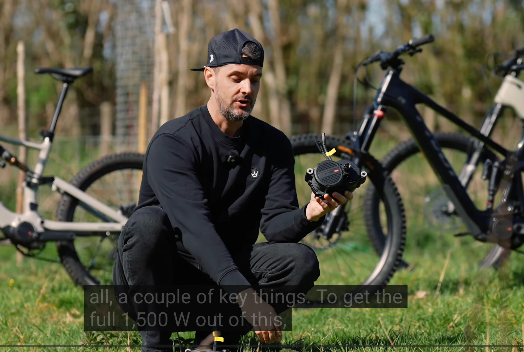

There is a power / torque limit for the older batteries with M2s that only one reviewer mentioned.
700wh gets full power. Not sure if the 800wh removeable one also gets peak 1500w or 1300w.
Nobody mentioned it specifically.

Thx. Which batteries get full power?
Here you go
"Avinox M2 (performance is independent of battery configuration)
Regular Modes: 1100 W, 110 Nm
Boost Mode: 1100 W / 125 Nm
Avinox M2S + 800 Wh fixed battery (FS800) or 600 Wh (FS600)
Regular modes: 1,300 W / 130 Nm
Boost mode: 1,300 W / 150 Nm
Avinox M2S + 800 Wh removable battery (RS800)
Boost mode: 1,500 W / 150 Nm
Avinox M2S + 700 Wh
Regular Modes: 1500 W, 130 Nm
Boost Mode: 1500 W / 150 Nm
On top of that, all Avinox M2 and M2S motor systems offer a support factor of up to 800%. "

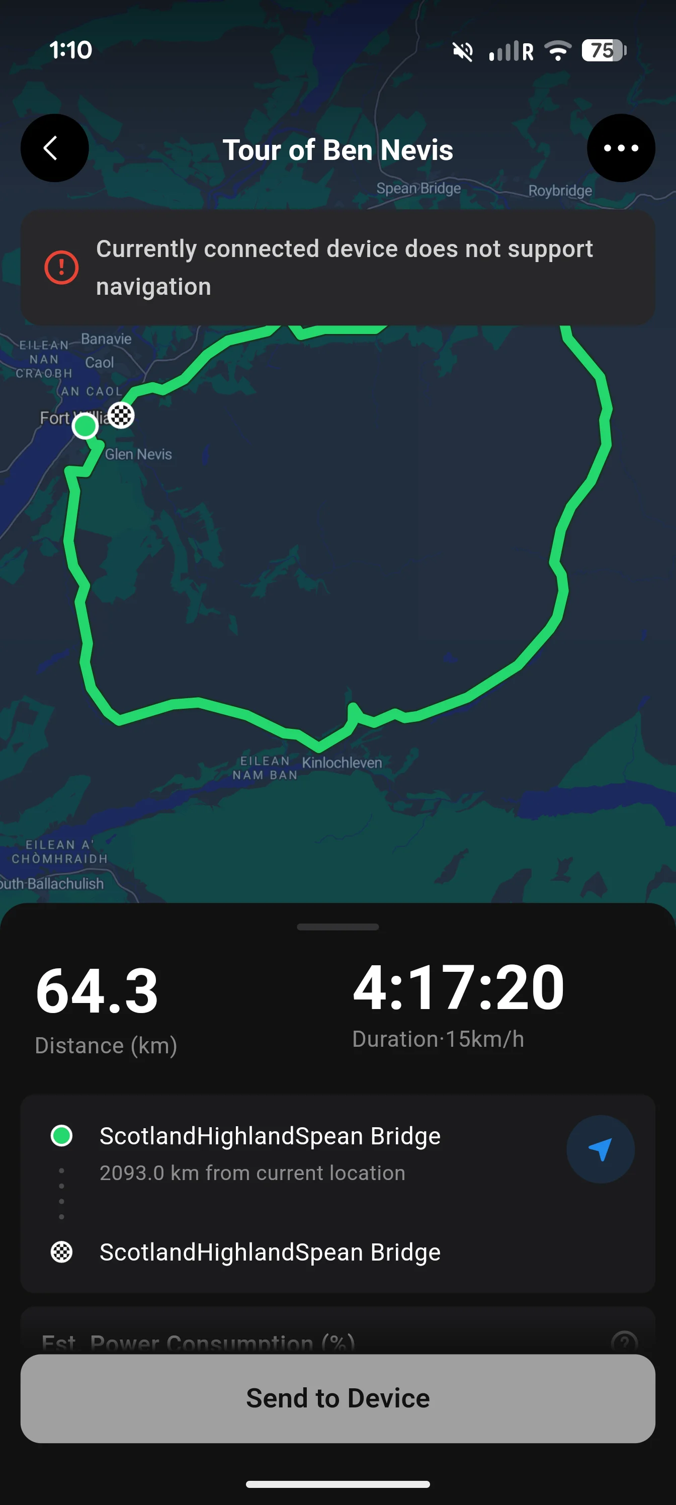

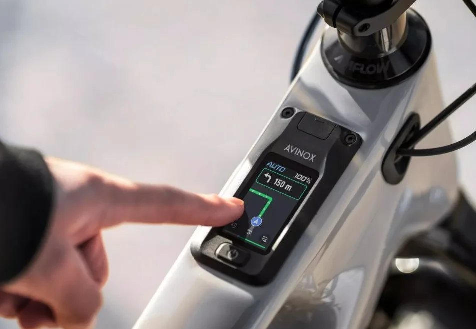

Well, I have just updated the Amflow ride app and guess what, now has navigation option ! Just added a GPX to test and looks good - haven't actually tried it yet but the option is now there.
i'd love to see a screenshot of that. especially if its turn by turn or a full on map?
Here you go
