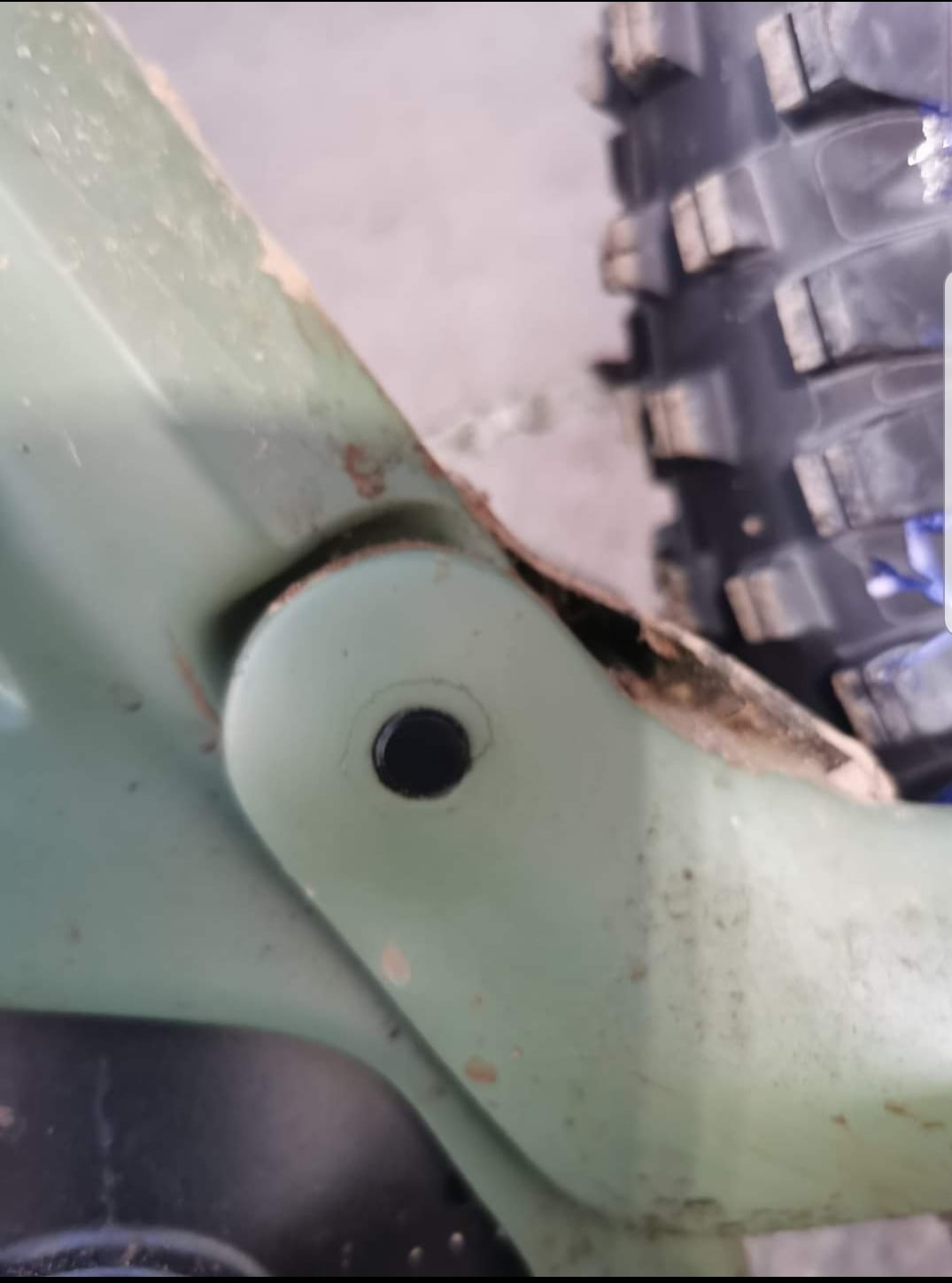

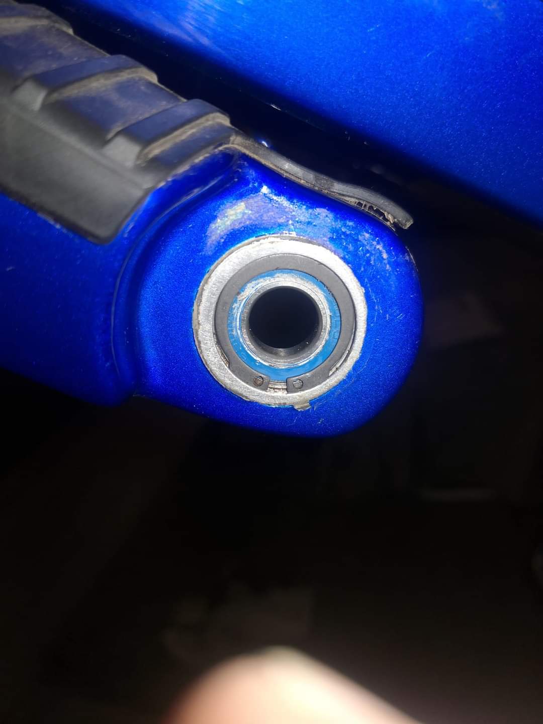

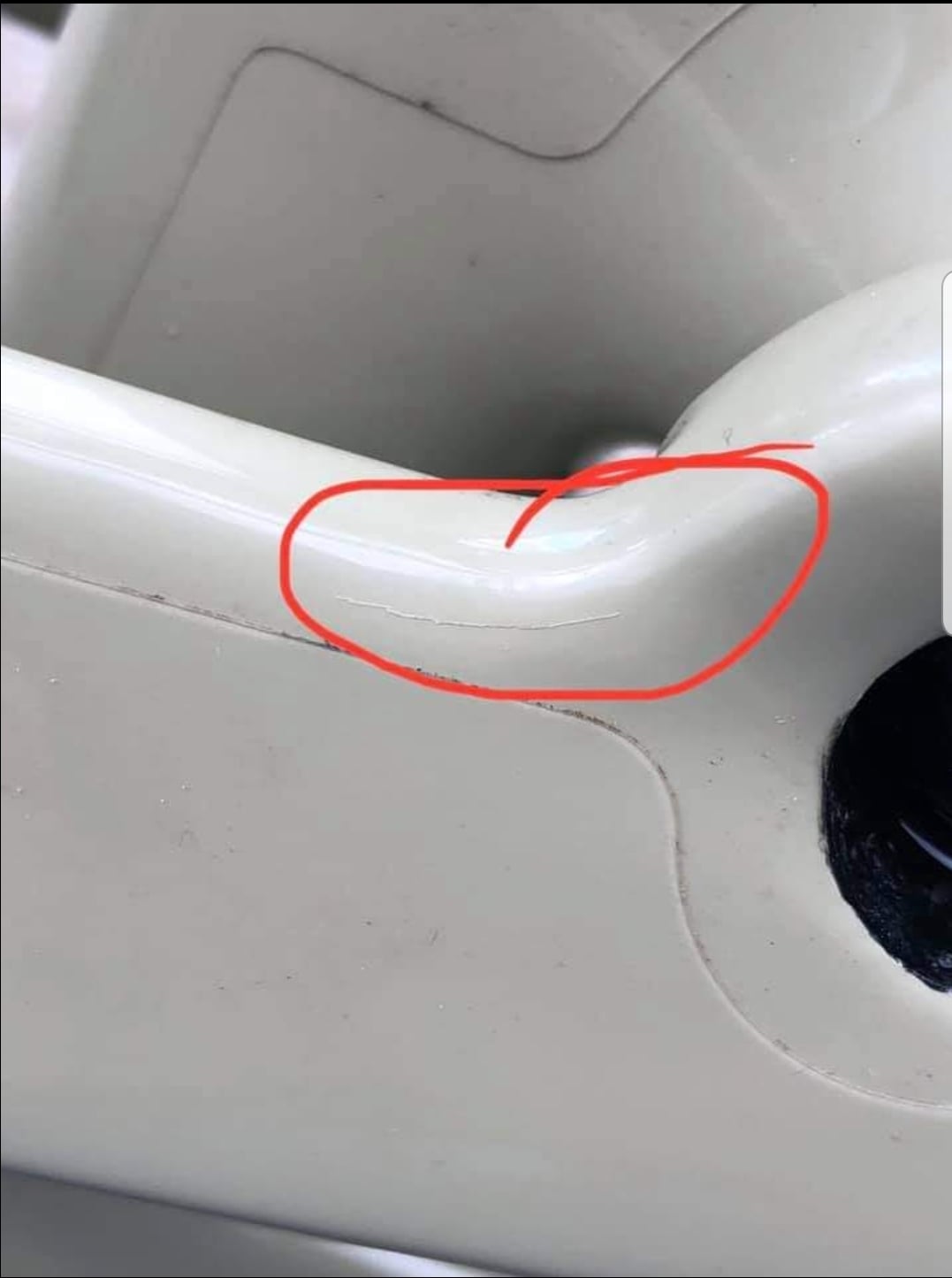

Evening all,
Next issue on these bikes! - If you're on the Haibike UK owners group on facebook then you will already be aware of this.
Check all your linkage bearing areas for cracked paint approx 3-4 mm's around the outside of the bearings (2 by the rear wheel axle and the 2 just behind/below the saddle- inner side) - This could be a sign of the start of major failure. A few owners have noticed this over the weekend but the number is slowly rising with the more people that check them. The linkages came apart altogether for one owner - looked like the housing/shim bonding gave up. Haibike do not have replacements available anytime soon and he had to have the bike refunded.
I've have not experienced this issue myself (Yet- had plenty of others since owning) so don't have my own pictures to upload - Just getting the link started as a resource!

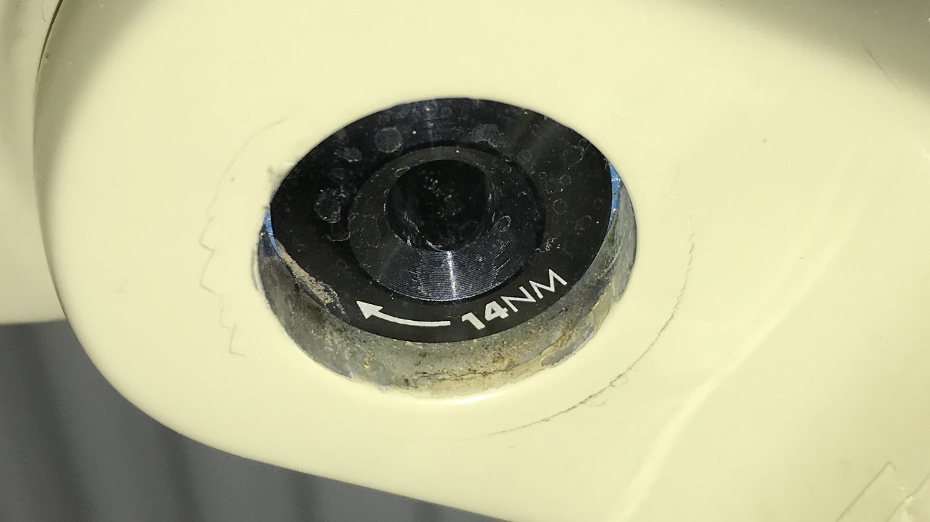

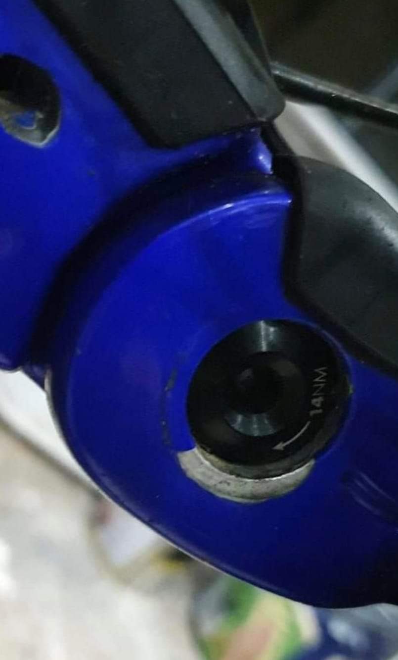

Well after reading this thread and the FB page I checked mine, looks like it’s just starting to fail. 260 miles of riding :oops:
Jan 21, 2021
72
24
View attachment 57160 View attachment 57161
Shit...definitely let your lbs know fella. It might just be a bit of flex and not get any worse but its def. worth mentioning it. As I say only 1 rider that I know off has had a major failure on this so that could be down to circumstance. Keep riding but check it after each ride for the time being bud.

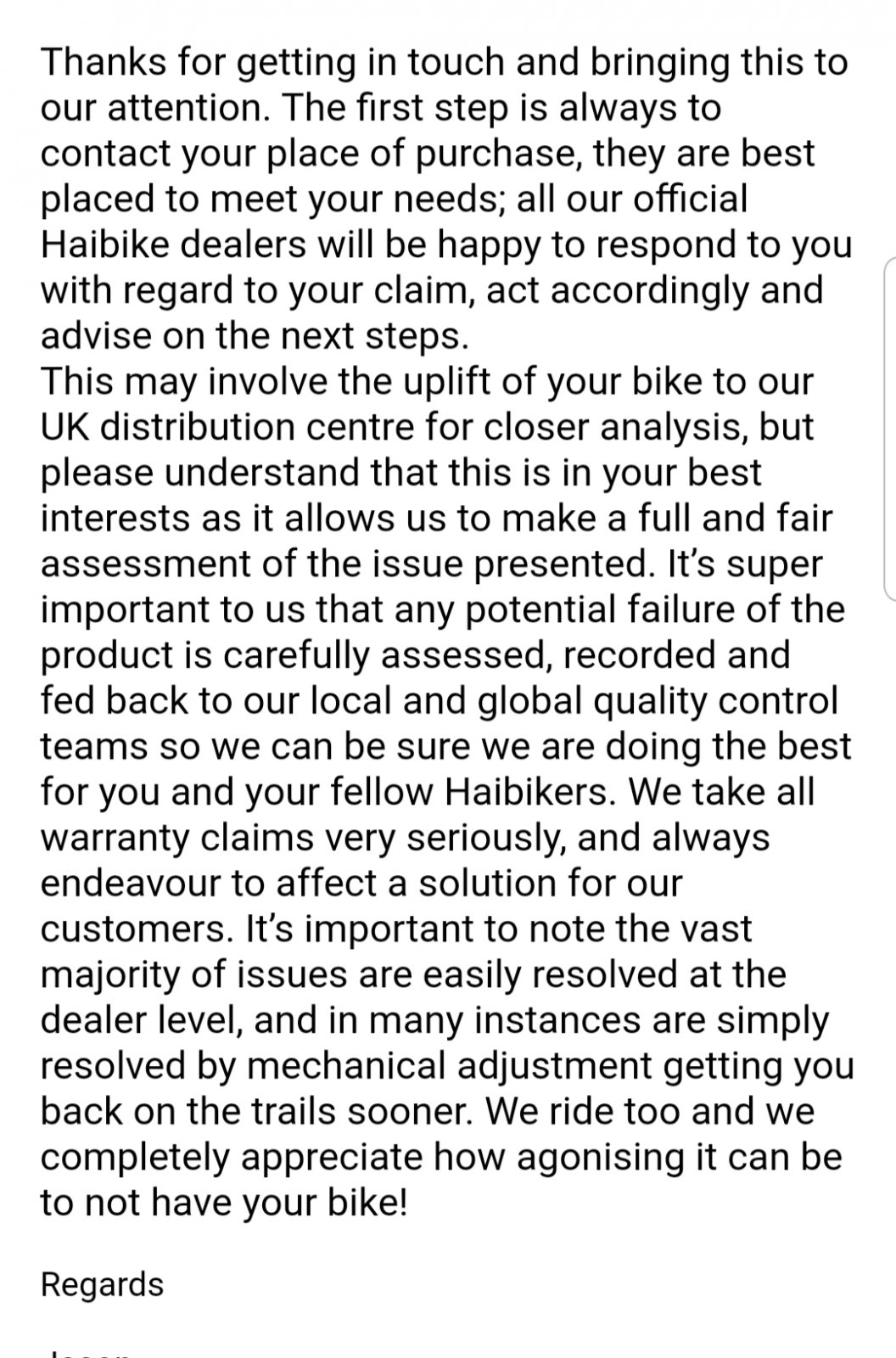

Here's Raleigh/Haibikes response that a number of owners received yesterday. Lame, but to be expected. I'm concerned about the number of returns they'll have from this, and whether they even have the means to resolve it - huge stock shortages of these bikes for this year as it is. Another major fail reported in the last few days, but resolved with a rear triangle from another bike at the lbs.

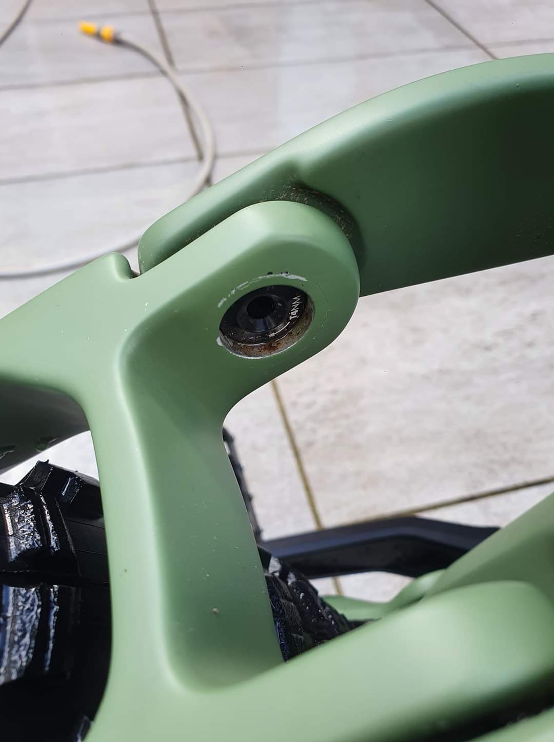

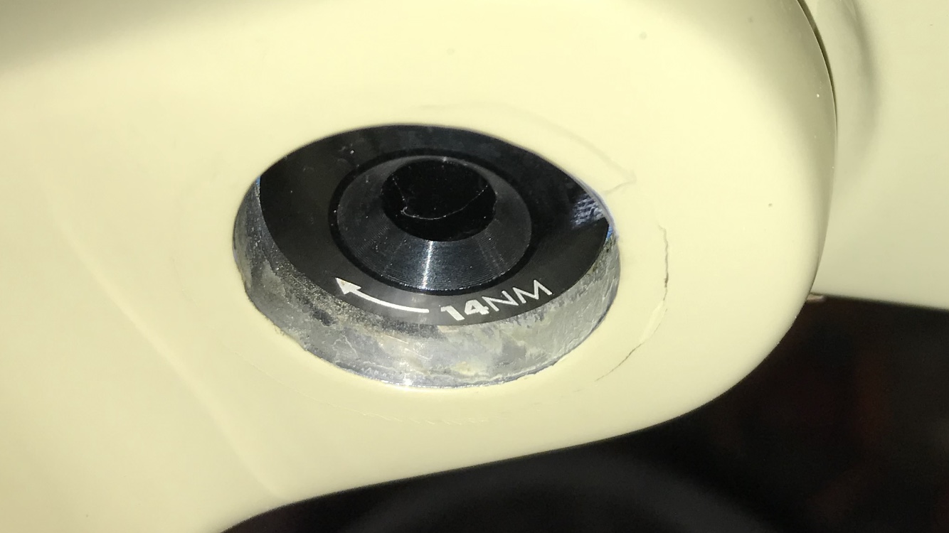

It looks like they used inserts without proper features to be locked properly inside the carbon fiber laminate, maybe they used just smooth bushings.

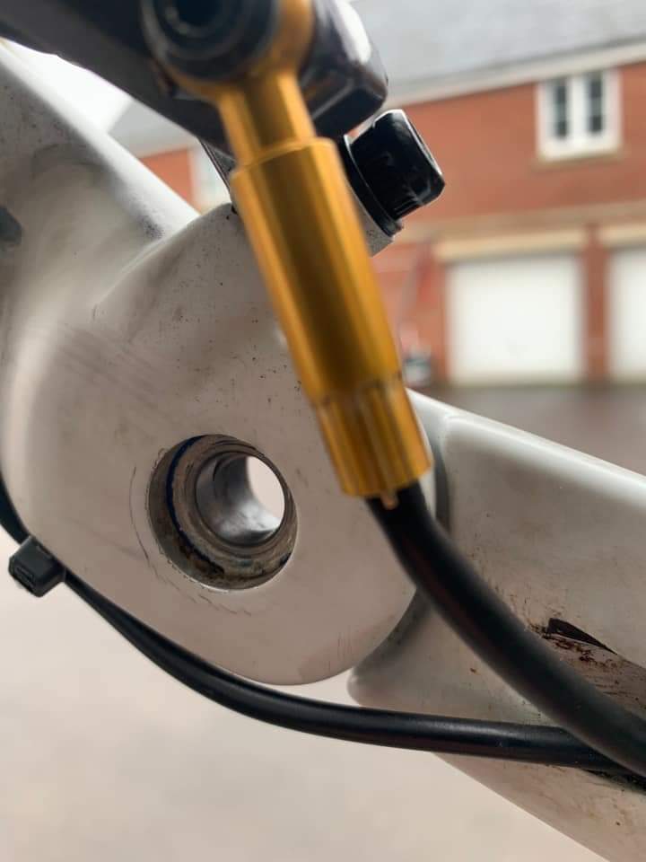

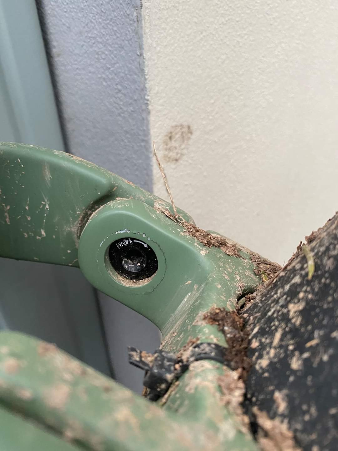

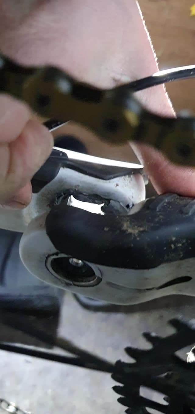

Had my Haibike All Mtn 7 since late November, over 1000 miles ridden in the Peaks. Few problems, chain stay bearing on the drive side came completely apart on a rocky descent. Fixed it with zip ties and have been able to carry on riding while waiting for Haibike service to set a repair date. Now have Error code 64, seems to be a failure of the torque sensor. No power half way through a ride. Bike unusable. Front chain ring also worn out despite changing chain at 700 miles. Not impressed.

Have you had any of the frame issues mentioned on this thread mate?. Share some pics if you have please fella?
No not really, just typical rock strike damage. No frame damage around where bearing failed, I do clean and check my bike well after every ride, no warning, chain stay just came apart unexpectedly. Zip ties work surprisingly well

My rear triangle failure was not the bolts, they were still in place. Always have a couple of zip ties in your ride tool kit. I just put one through the hole, pulled it tight and carried on riding. Worked fine even on rough descents.

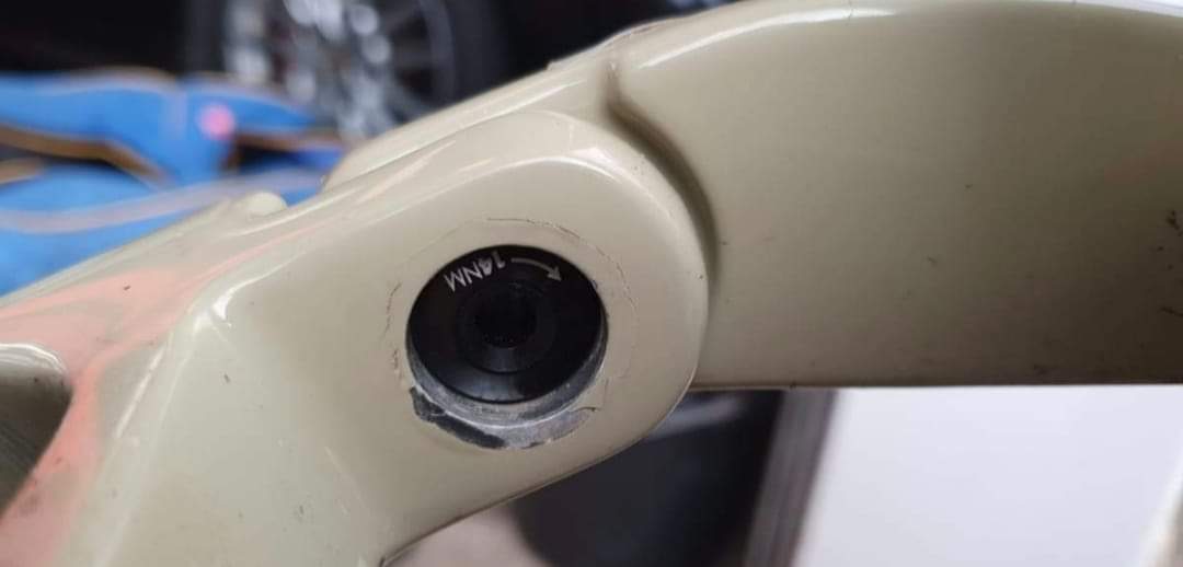

Nope, this is not the problem. I check my bike every time before I ride with a torque key. I have 260km on the bike and every bearing on the triangle cracked, one will fail soon.
Well that just fills me with confidence - Im looking at mine now trying to figure out how to check / remove and retighten etc. And pics buddy. And whats happening with the bike?
