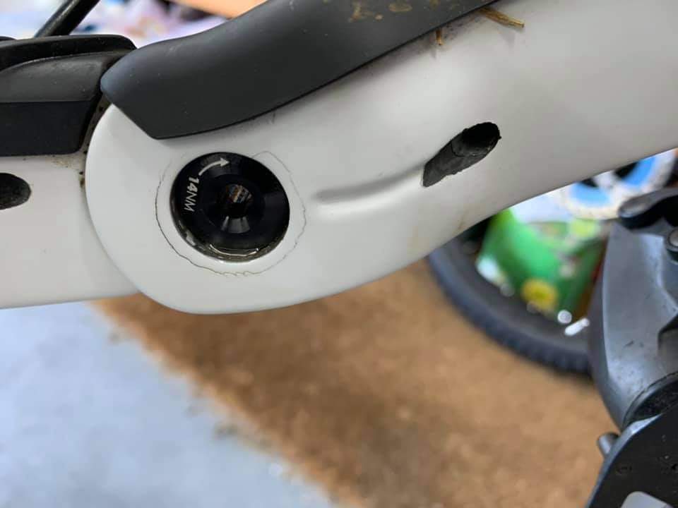

Meh....thought it was too quiet lately. Here's another. This was the poor guys second allmtn7 due to a ceack elsewhere on the 1st

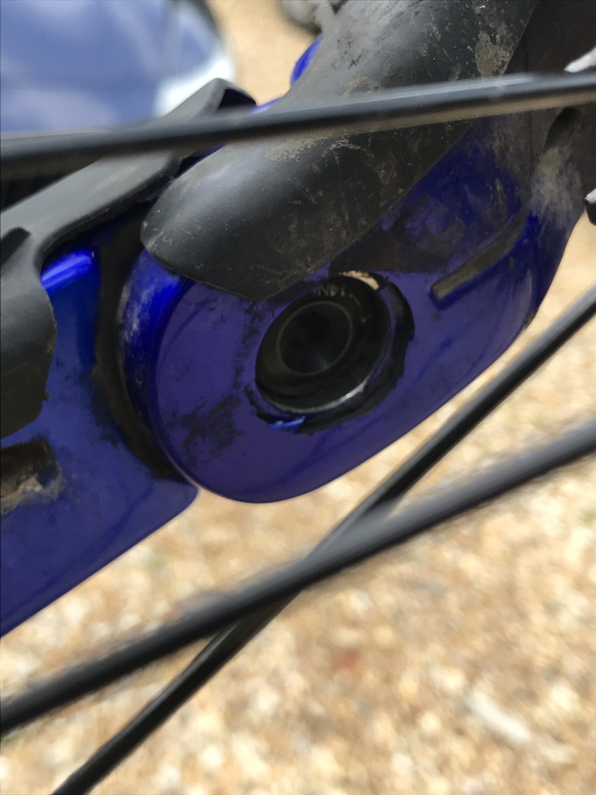

(8 month old All Mtn 7 2021)

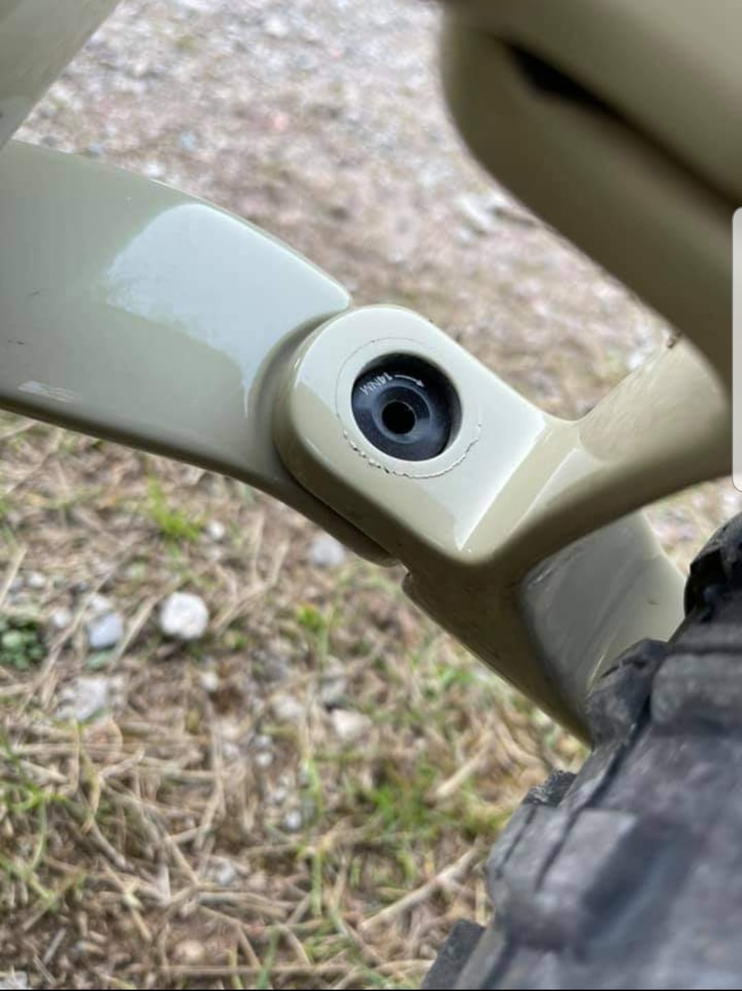

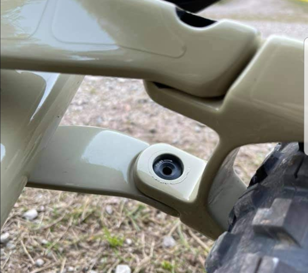

And another one (one of 3 that have failed - this is the worst). I discovered this at the end of last week after investigating a knocking noise. Can anyone advise how long it is taking to get stuff fixed? I am conscious that there is a shortage of bikes, and therefore am concerned that this shortage might extend to parts. I sent photos to my dealer who promptly forwarded them to Haibike on Monday (10/05). We are now waiting to hear what they think apparently. This seems a little absurd if there is a known issue - they should immediately be saying they will fix the bike, and that parts (already stored in the UK) are being shipped to my dealer etc.

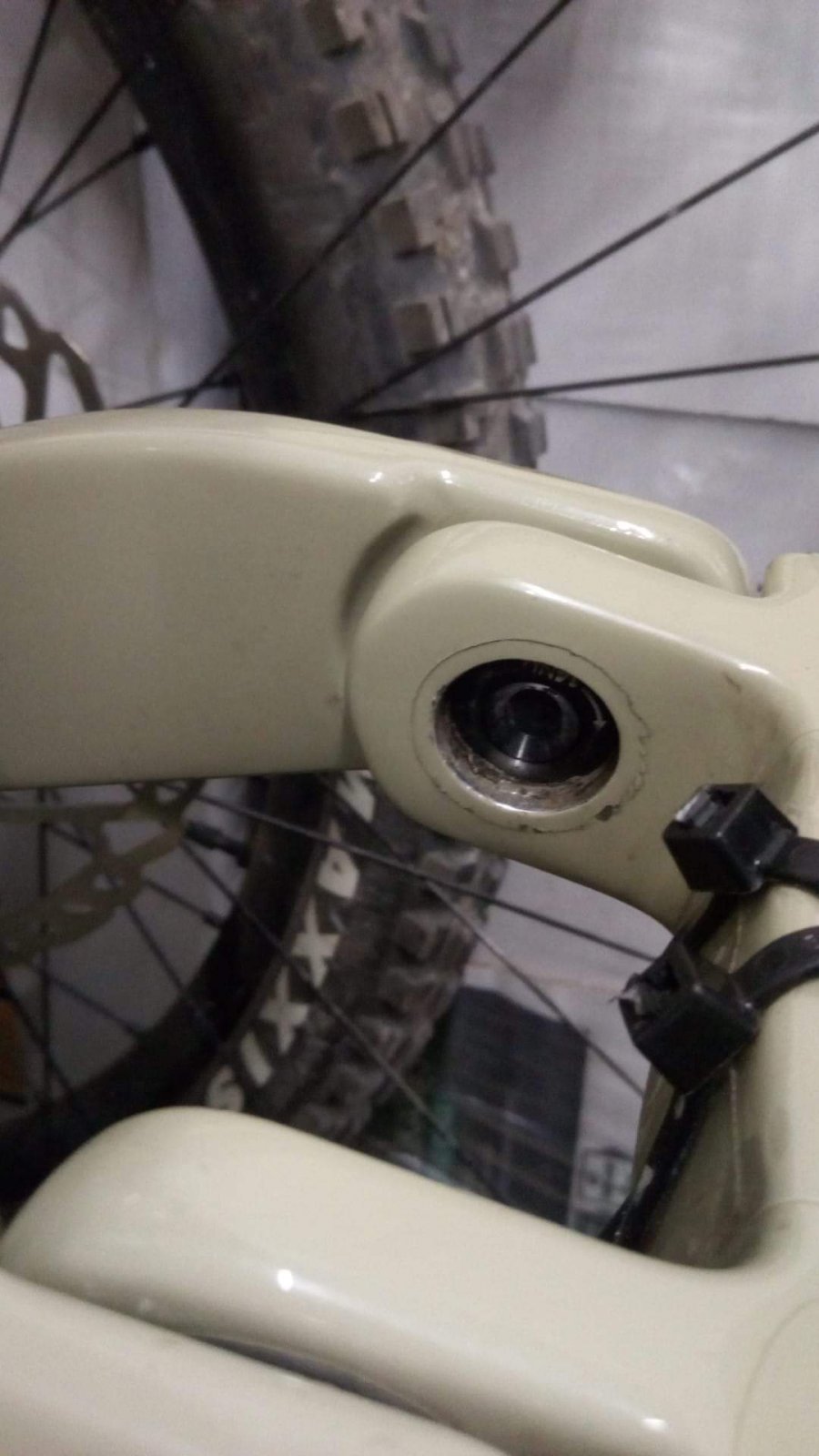

Mines been returned today for a full refund as both upper bearing surrounds had cracked and one of the lower ones in the blue paint was just showing slight signs. A shame as I really liked the bike but no spares to repair or stock to replace the bike. Do I wait and hope that the newer Haibikes coming though are fault free or go for a different manufacturer completely? Mine was quite an early bike, has anyone bought one recently and had problems (or know of one)?
