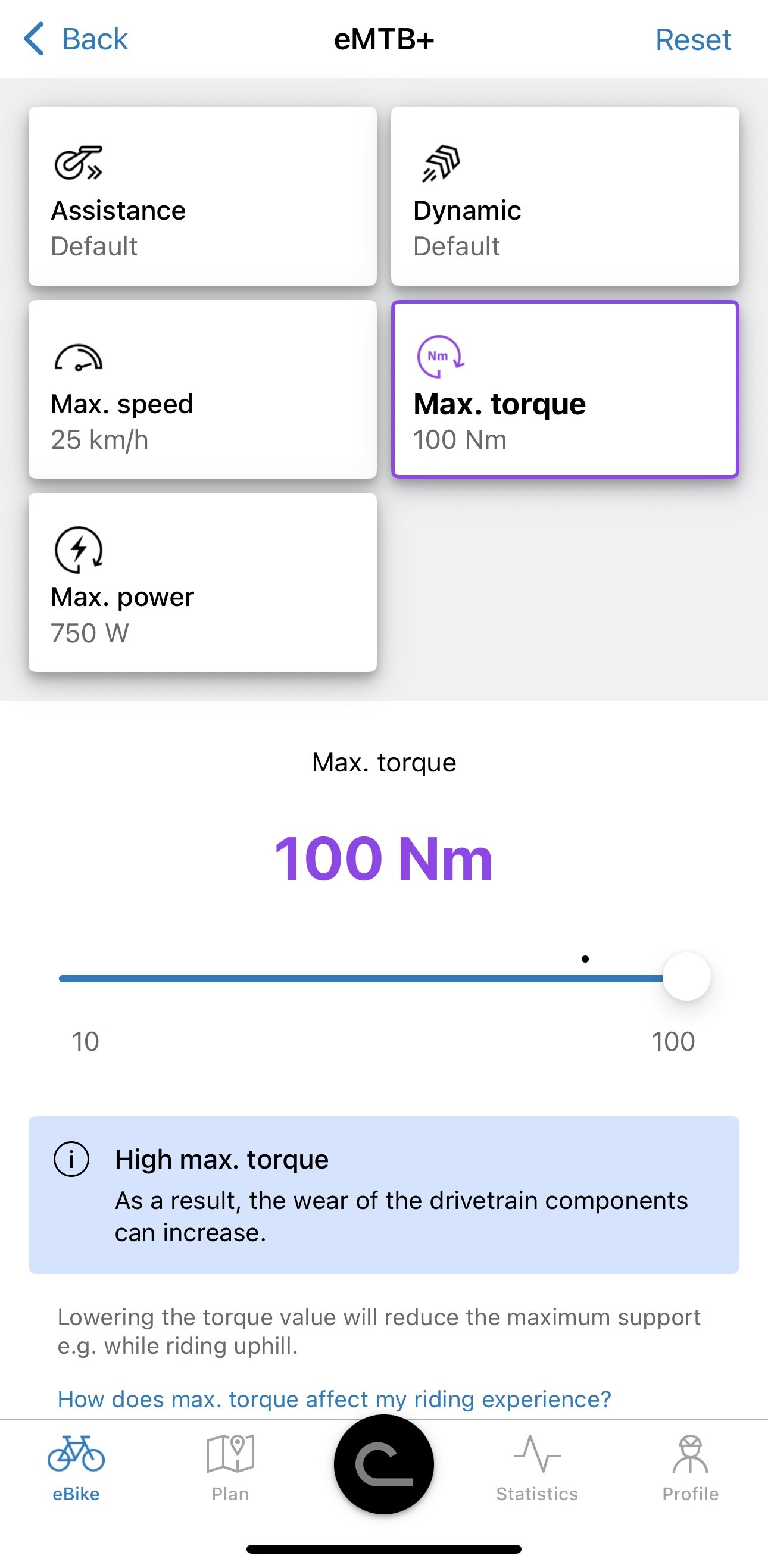

"After performing the first update to get 750 W, the app shows no further updates. But if you tap the gear icon in the top right and then tap 'eBike update', you'll see a message at the bottom in blue about the power update. Install that update, and then you'll see 100 Nm."
I just did the same - the app prompted me to do the main update, but then had to go and do the second update to get the 100Nm option.

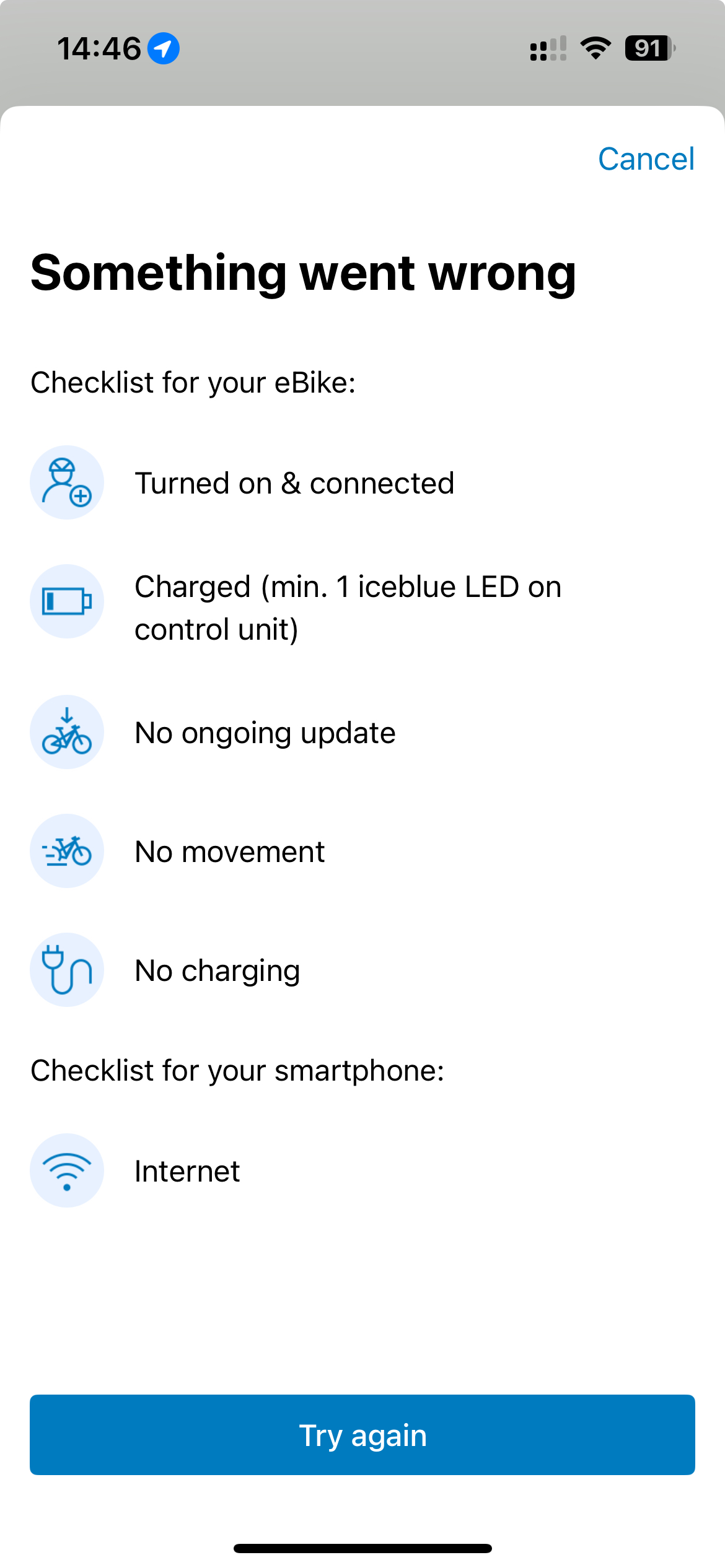

Has anyone experienced problems installing the second update? It does show up but I get an error when trying to install even though all the requirements are met…

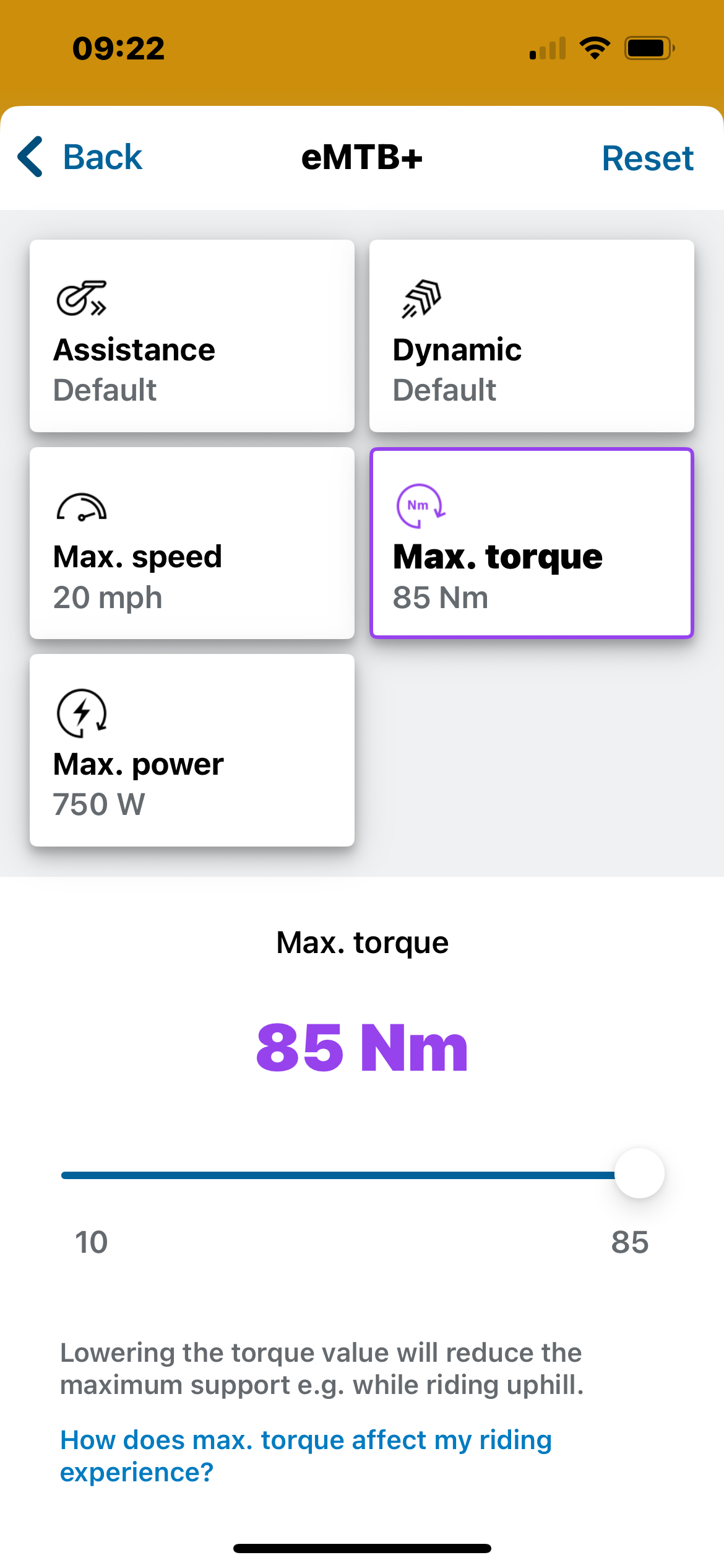

On my new Crestline S180 I’ve updated/downloaded the flow app twice after installing the update.
Also I get 750 watts but it’s still limited to 85nm on the sliders.

I’m in the same boat as y’all. Took the update but nothing past 85 and no option to update further. It’s a crestline and they are definitely doing the 100nm.

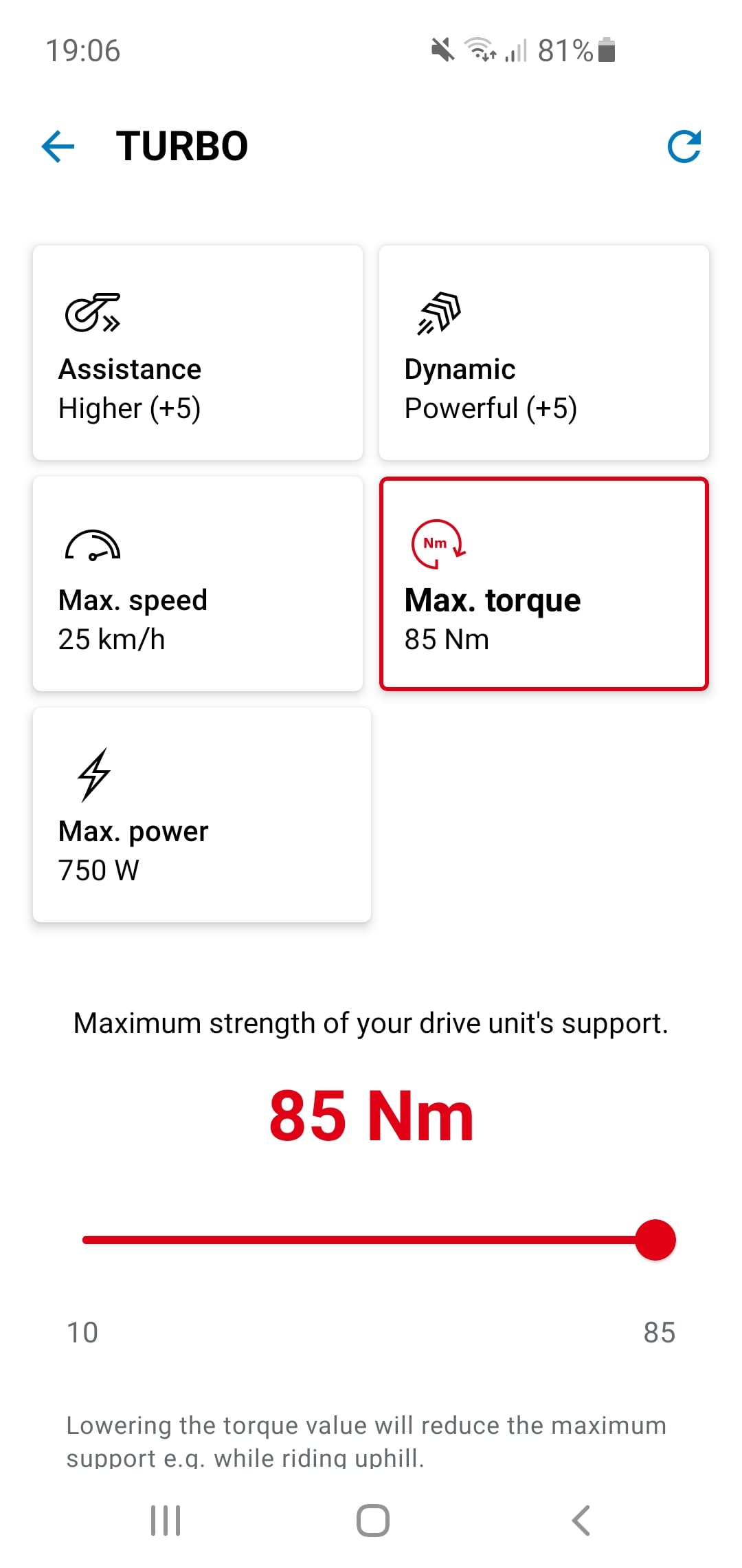

Android, Flow app version 1.28.9, Gen5 BDU3840 EB11 100 00E, location Finland.
I got the 750w upgrade today, but still 85Nm. Maybe i have to wait few days to get 100Nm?

I did the update and got the 750w, but the app still shows just 85nm. What am I missing? I thought it’s 100nm. Any input?
