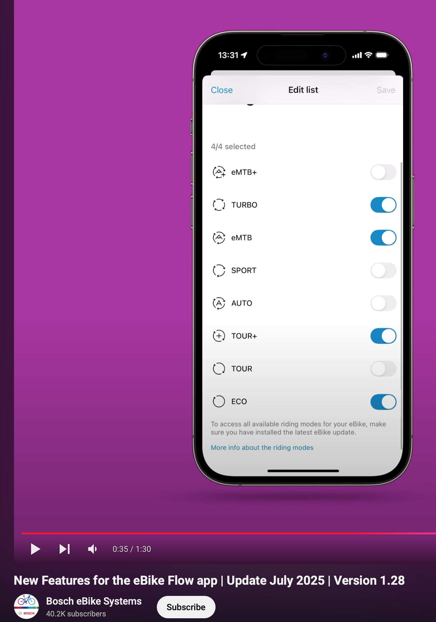

Once the update is complete the fist job is to edit the modes selecting any 4 from the list. I dumped eco, added emtb+ and retained tour+ emtb and turbo.

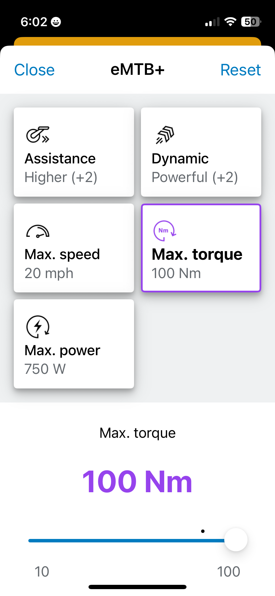

Took me 4 uninstalls and reinstalls of the flow app and finally got the 100nm ....
Performed the update on my Gen 4 Orbea Wild. I only have 4 ride modes available with no EMTB+. I have only had 4 modes ever since the motor was changed under warranty. Not sure if the bike shop killing the other modes has anything to do with the new EMTB+ mode not showing or if its something else. Any ideas?
are you saying you don't get a list of seven (8 post-upgrade with EMTB+) modes, of which you can select max 4, like in this pic?
@GDAS Correct. I did before the warranty motor replacement. Now I only have 4 to choose from. I was hoping to have a 5th now with EMTB+ but nope, still just the 4 after the update. The thing that sucks about Bosch warranty work is they dont cover labor. So you gotta pay for their lack of quality our of your own pocket. It would suck to put my bike in the shops 2 week backlog then have to pay labor.

I can confirm that by deleting the app and downloading again will allow you to see the 100nm update. Mine is all bueno! Thanks all!
Howdy from Ory gun! Android user here. Did all the things yesterday. Like many I could get 750wh but no torque update. Today still nothing. Unpaired Rail 9.8 GX from Flow app, then uninstalled/reinstalled Flow app and the 2nd update appeared in a blue message box at the bottom of the update page. Still don't have EMTB+ mode but at least I can try out the other new settings.

Couldn’t wait for Bosch. A couple of delete and reinstall the app and I’ve got it!
Have you selected "Edit ride modes"......that's is when the.full list of modes comes up and you can select a maximum of 4 from the list?

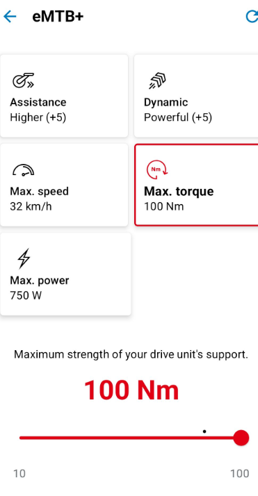

The update for my Flow app became available yesterday (Android / Pixel 8a / Trek RAIL+ Gen5), the update went smoothly, and, as with the others, the 100 Nm performance update was a separate update inside the Flow app. No issues, no reinstalls, it was 10 min and done.
Today I made my first EMTB+ test ride trying some gravel road climbs and more technical single track. I started experimenting with +5 assistance and 0 Dynamic setting (750W/100 Nm) as a starting point, and I am very happy. I'm not sure if I need this much power and assistance, but with these settings EMTB+ works very smoothly and provides significant power boost over the old settings. Overall, I have a very positive initial impression and will continue testing to find the best settings. I don't think I need Turbo mode any longer, probably will set my four modes as EMTB+, EMTB, TOUR, ECO - we'll see.
