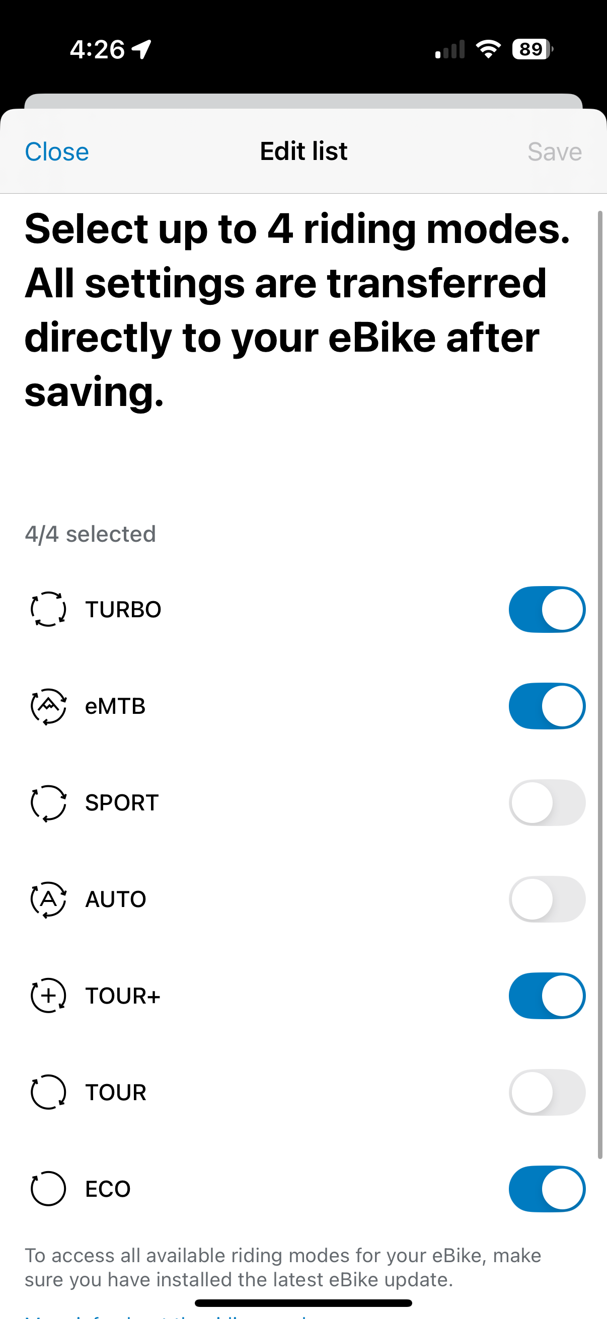

Right, I've found the solution and it seems an error in my understanding. Once the power updates were installed, the riding modes didnt show any change. I only had the four 'current' riding modes displaying (Turbo, eMTB, TOUR+ and ECO.) I could select 'Custom Riding Modes' from the home screen on the Flow app and customise the existing modes. However, to activate the new modes you need to select 'edit list' from the Custom Riding Modes screen and turn on the new modes. Obvious in hindsight I supose. They were off by default after the update and thus didn't display at all. I had no idea and just expected the new modes to display by default.
Anyway I thought I'd post this incase any new user like myself found the same difficulty.
Thanks for this , worked for me also , now have emtb+ , although I cannot really discern any difference on my GEN 4 after a quick loop on the local trail from emtb
