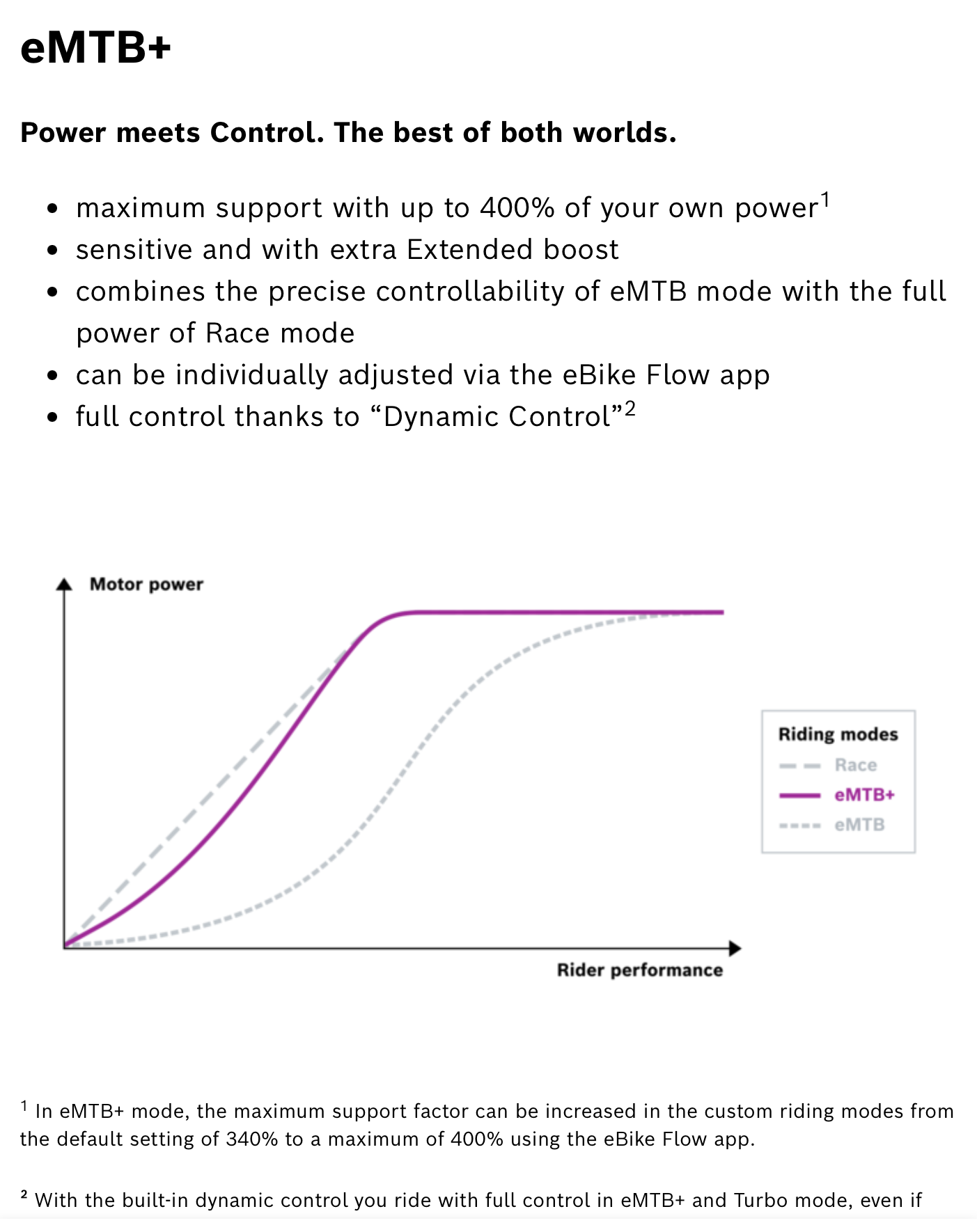

And they kind of show the differences with this graph

EMTB+ gives us 400% maximum assistance, while Turbo is limited to 340%.
For EMTB+, assistance increases at a lower rate when rider input is lower. The rate increases as rider input increases, and then levels off as assistance approaches maximum. For Turbo, the amount of assistance increases linearly with rider input.
EMTB+ provides more power and more sensible delivery. Turbo is so 2024. Even Race mode in the Race Motors has been surpassed.
Not true. Race mode has always had 400% assistance. It is a more aggressive ramp up to 400% than EMTB+ is. There is a graph, (see above ) from the Bosch site.

Not true. Race mode has always had 400% assistance. It is a more aggressive ramp up to 400% than EMTB+ is. There is a graph that shows this a couple pages back from the Bosch site.
Yeah, it's true. The race mode gain is linear. The EMTB+ gain varies more sensibly with user input. If some people want linear gain, the race mode is still there for them. That's why Bosch provides so many modes: to meet the needs of a variety of riders with varied tastes.
