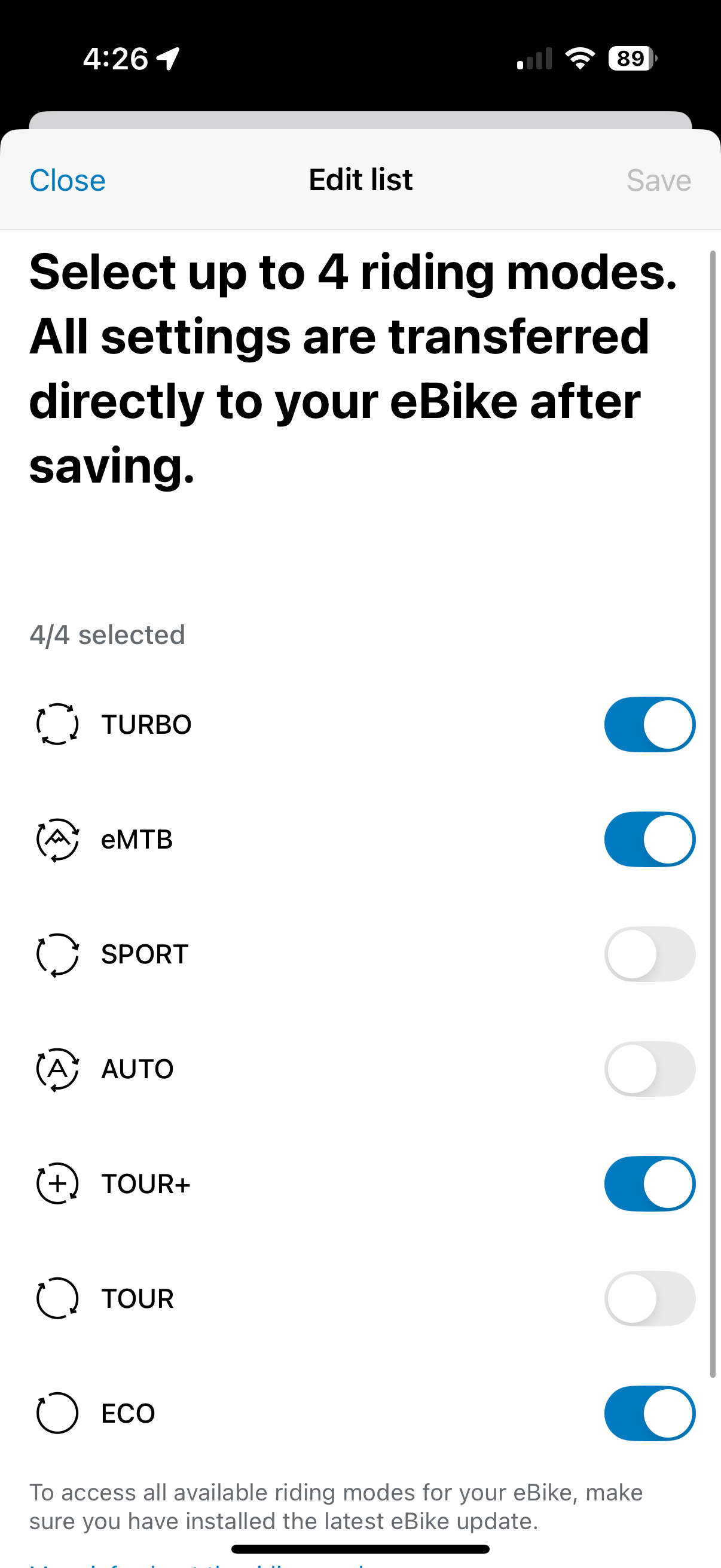

Are you riding a Rail with a Gen4? Curious because I have the same thing going on (Trek Rail 9.8 AXS T-Type Gen4) -- up-to-date on the firmware (16.19.0 for the drive / 16.12.1 for the system controller) and yet still no option to add-in eMTB+. Yes; I know one needs to look at the selectable option list and activate what modes you want to be loaded on the bike up to 4 of them.
I even visited my LBS and had them plug it in to the Bosch diagnostic software. I was looking at the screen with the tech and that also did not show eMTB+ as a selectable option nor that there are any outstanding firmware updates needed across the system (I was having some trouble getting the updates over the air but that eventually worked itself out). While I don't know that I care all that much about it as I'm happy with what I have, I had to visit my LBS for a few other things so figured I'd have them look while there. It is curious that some folks are saying that they have eMTB+ on a Gen4 Trek Rail and others are seeing what I am.
I have a MY2025 Trek Rail+ 9.7 Gen 5
Drive unit BDU3840 (EB11 100 00E) with software version 16.19.0
System controller EB13 100 000 with software version 16.12.1
100NM available across all riding modes.
eMTB+ not showing as an option.

I believe the upgrade has something to do with the brand of the bike not just an update to the flow app

Mine worked after a couple days and cube realised an announcement that is ready.
Wish mine would update. Says failed everytime. Did this on the last update. Had to visit the dealer after bricking it!!
Mikerb , I have a 2023 Whyte E160 RSMX , Gen 4 I have updated the app - Android . latest ,still not getting the EMTB+ , in the app after connecting to the bike , still the same original riding modes - Did you have any issues with your Whyte and upgrade Gen 4.
My whyte won't update. Says failed everytime! Annoying!!!
Well after loaning my Rail to a mate since February I finally got it home today. Did the update 7/25 and I have EMTB+ just fine (Gen 4 smart) simple and easy update took about 12 mins.

I was able to get the update installed on my CX at the shop, we had to run the first update then close the Bosch software, re-open it and the second update was there, turned the power down to 95 and so far its great.
