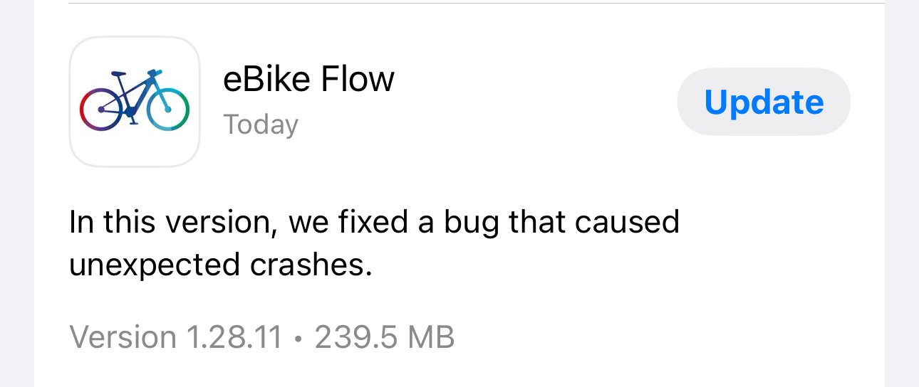

Ive found that the app on my phone is the issue, however no amount of sacking it off and reinstalling resolves it crashing. Another iphone running the same IOS version has no issues and connects to the bike, and stays running, without issue.
All sorted with the latest update...
