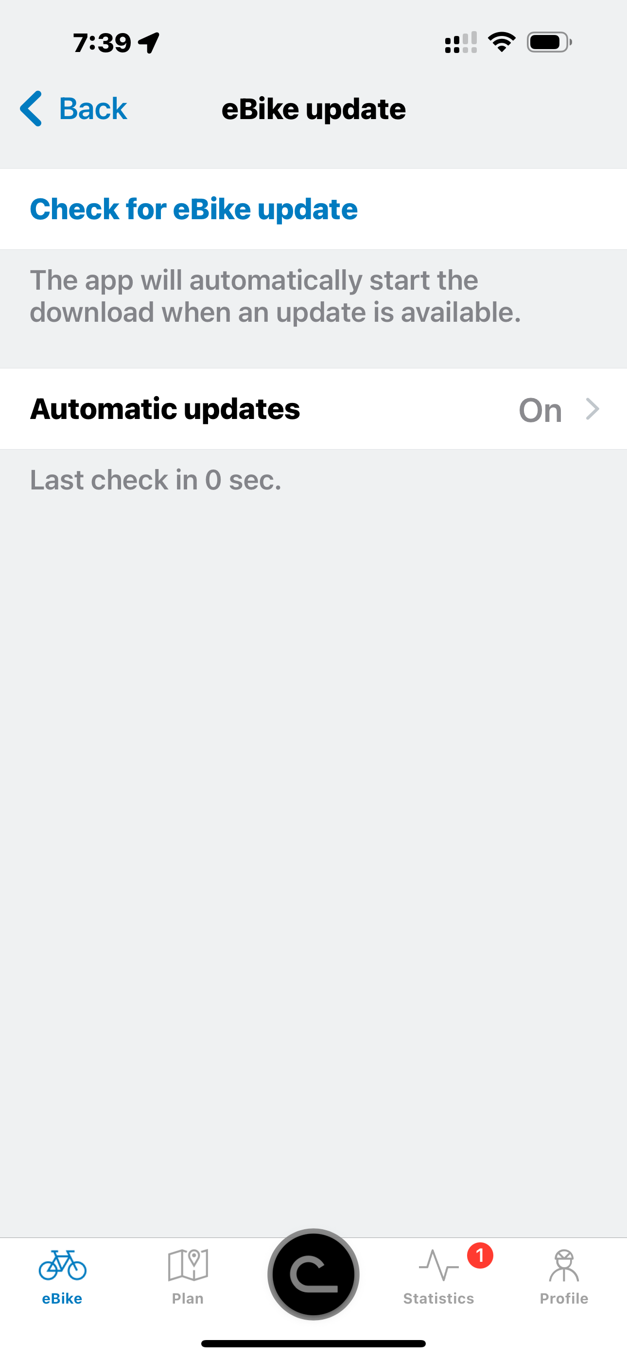

Go to the e.bike update software section in the Flow app and below there should be a blue tab that will allow you to update the app again. That will give you the 100 nm option after the power has been updated.
Not showing on this image but this was where it was after I did the first update.
