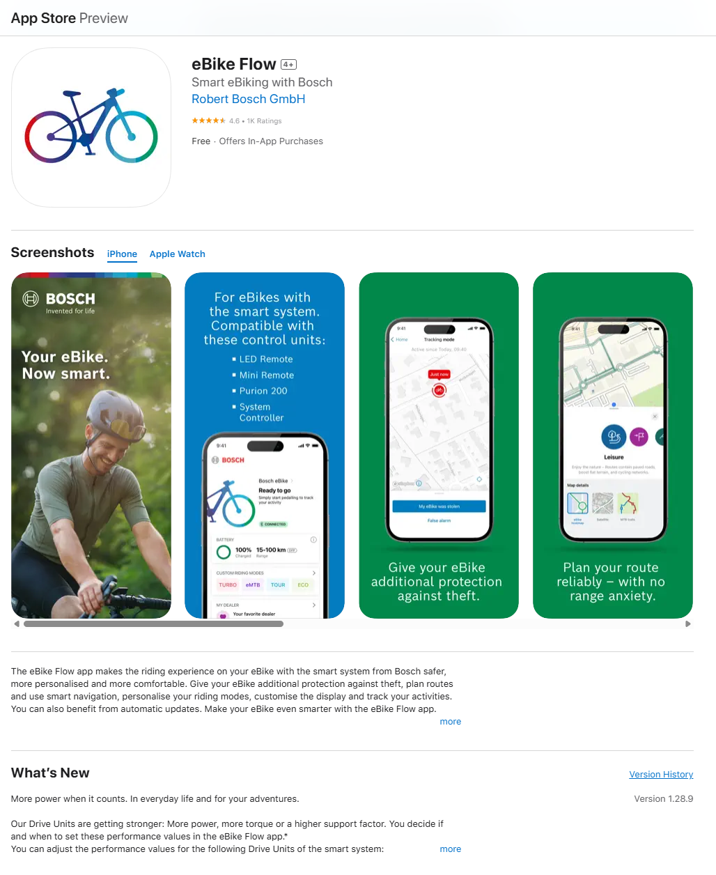

The Bosch update is finally out — at least for iPhone users...
iPhone user here. Nothing in my app.
I've looking forward to this for a long time. It's even my birthday today, so it would be a great present. Come on Bosch !!!
EDIT!!
I updated the Flow app, and rebooted. Now it's there, and downloading. Yay!!
I have it on Android, too! Gen5 100nm.
However, Bosch SX update not there (I also own a SX eMTB). One week more?
I have a two bikes, one Gen 5 and one Gen 4, just completed the update to both. Gen 5 is a two step process with a sperate drive system update need for 100nm. Gen 4 had a fail message but once it turned back on seems perfect, now showing EMTP+ mode as one of the options. Enjoy everyone!!
I've downloaded and installed it to my Mondraker with Gen5 BDU384Y.
I can increase power to 750W , but Torque is still max 85Nm.
