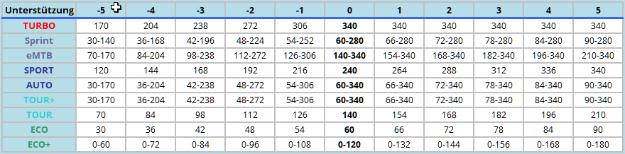

So does anyone have a chart like this one for the new firmware, assistance levels, and mode?

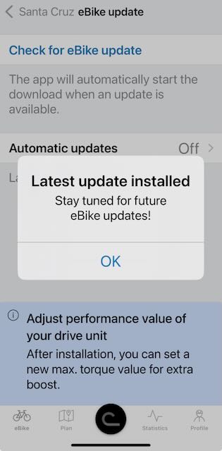

Same issue......I forced a check for another update, and it says I am on the latest, and should be able to adjust the max torque. But I can only increase the watts....torque still capped at 85NM.

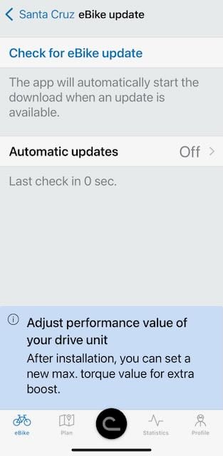

This is what I see. In the video, there should be a button to download this update. This is on a Santa Cruz Bullit. I am going to take it in to my LBS and have them hook it up to a computer.

I'm also on a Santa Cruz Bullit and i'm having the same issue. Let me know if the bike shop can get it done. I purchased the bike 2 hours away from where I live so not looking to drive there unless I have to
