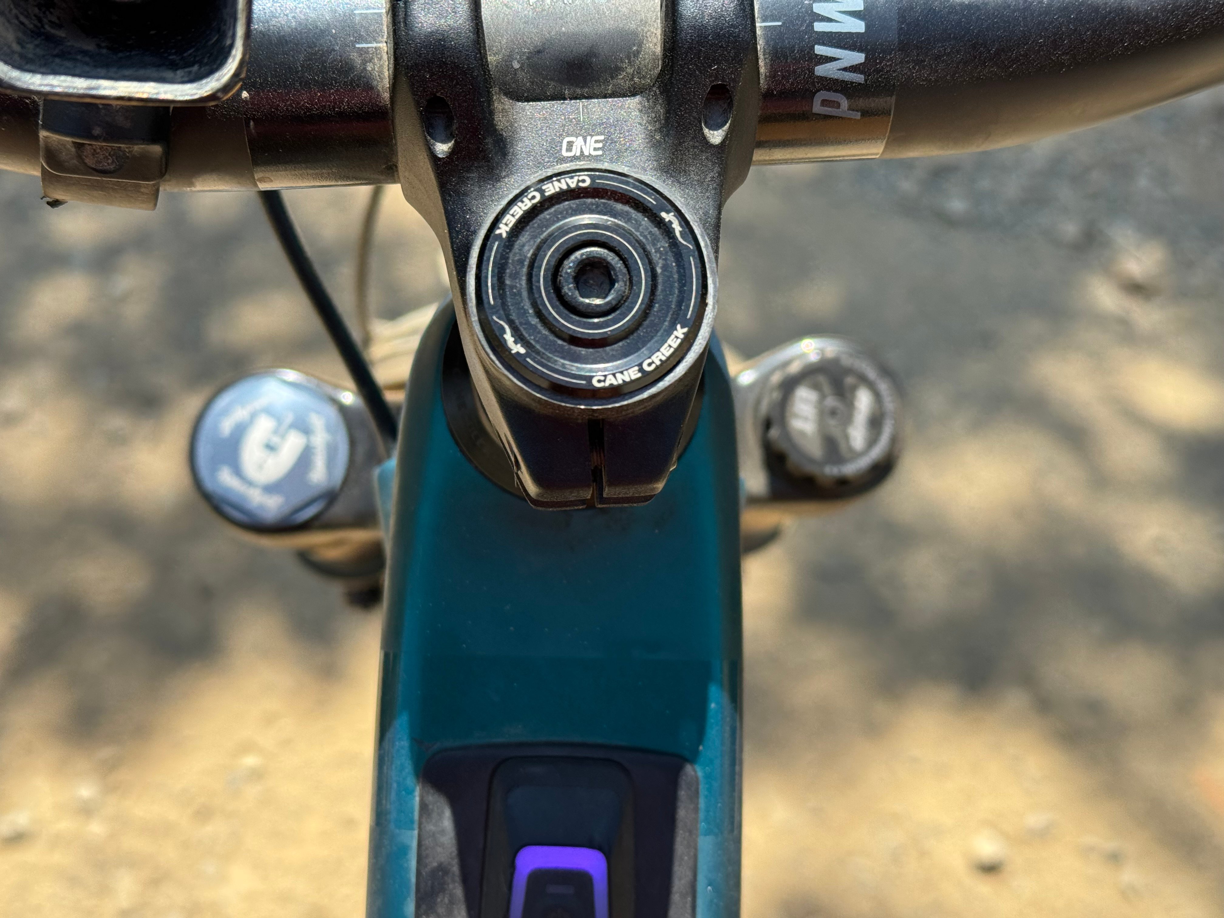

My seat creaks a bit but I dont sweat it too much.. But hey! I just put both an MRP Lift Damper and a Vorsprung Smashpot into the fox 38 on my Bullit, MRP first and then the smashpot a few days later. Really liked the MRP damper on its own and th smashpot just smooths things out even more.. Have Telum coming end of the week and I’ll report back and put up a few pics. Crappy pic Would only focus on the headset lol

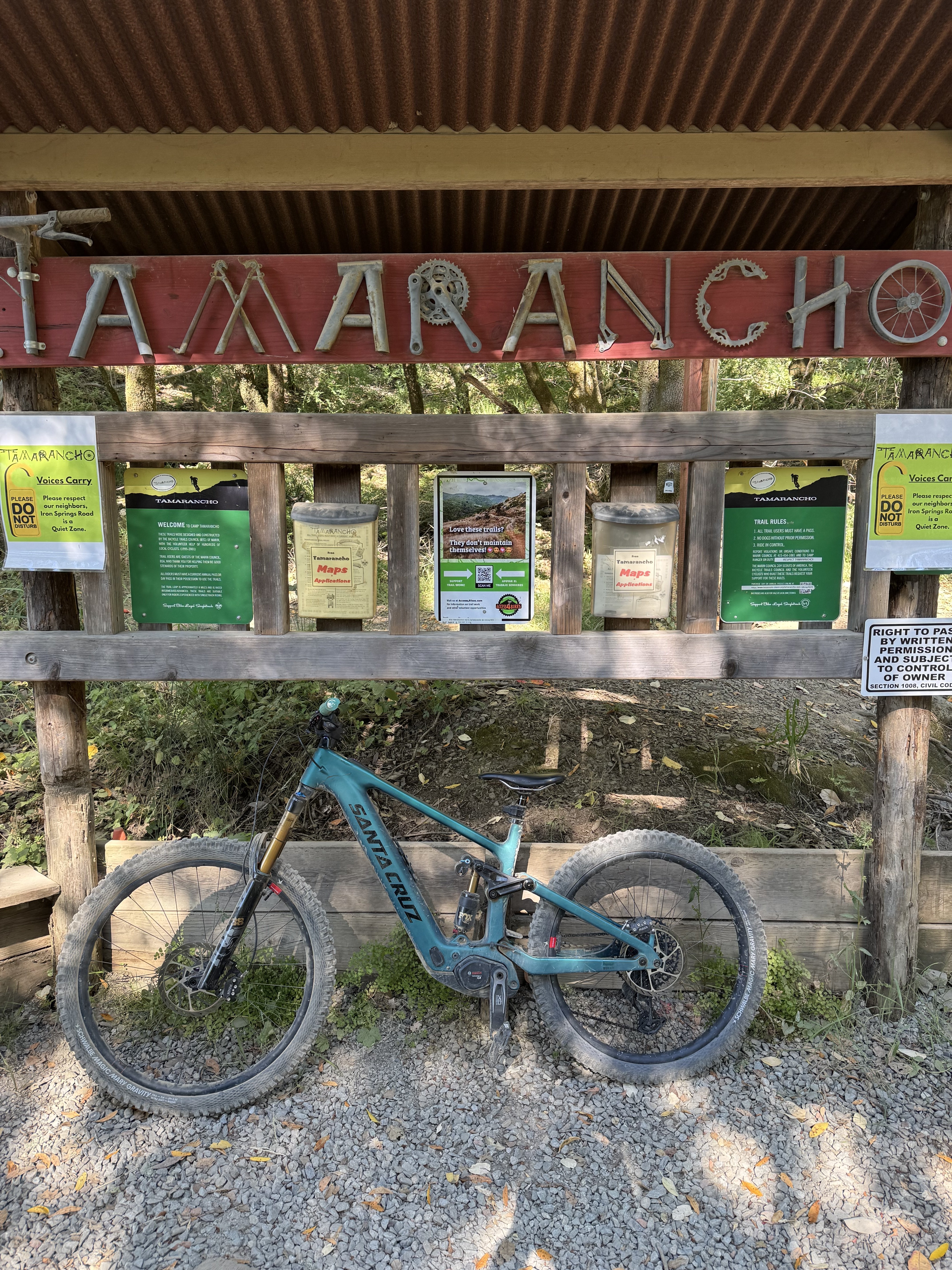

Finally got a proper ride in on the new Bullit. This thing really does rip. Definitely faster on this than I was my Gen 3 Levo.
24 miles - 4,000 ft of elevation and 13% of battery left. I'm 205lbs and used a lot of EMTB mode on the climbs and Touring elsewhere. Buddy with a 750WH Levo finished with 18% battery (similar weight)
