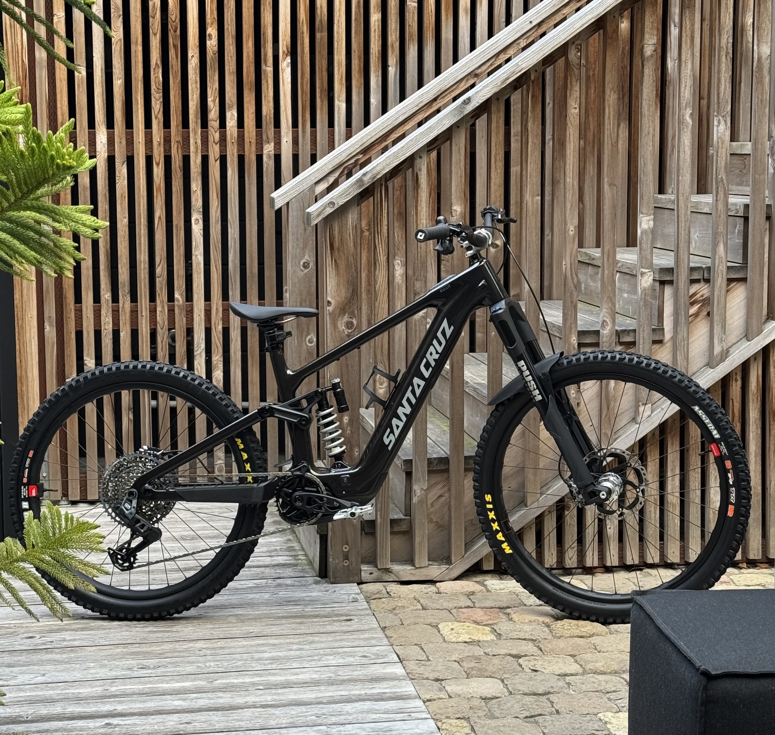

Starting to finish up my Bullit. What a machine it is.
Wish I could get it in this colour without having to pay a fortune for stuff I’d swap out right away.
I love the color! It’s really not a bad deal for the extra stuff and the way cool paint job. But the jury is out on the podium fork . I have an XO RSV TEAL. Weigh a Terlum and a Push 9.1 Coming next week

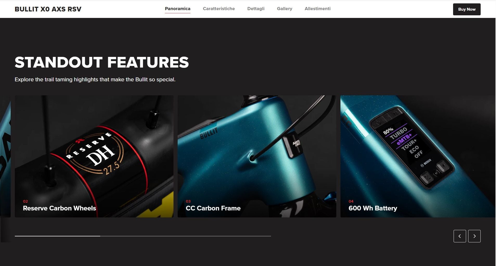

Hi everyone, I just joined this wonderful forum because, after more than 30 years, I'm getting a renewed desire to ride a mountain bike. I immediately have a question about 2026 Bullit: do you know if it's possible to install (or order with) the Bosch Kiox 400c display? I see it's available on the Vala and also on Bullit Podium version. Many Thanks
P.S. Sorry for my grammatical construction, but English is not my native language.
Yeah, it's a direct drop in replacement.
I've seen a few things around with Bullit and Vala where the mini controller has left marks on the top tube where users have swapped them out for the kiox display :(
Following as I’m concerned about this too. I may lift the cover in advance to see. I’m not sure my OCD could take any marks, regardless of how better the display may look!
That really sucks. I would've imagined the outer dimensions are the same between the mini and 400. But as I look at various youtube videos I see that frame cutouts vary across manufactures. I haven't seen a Santa Cruz swap.
