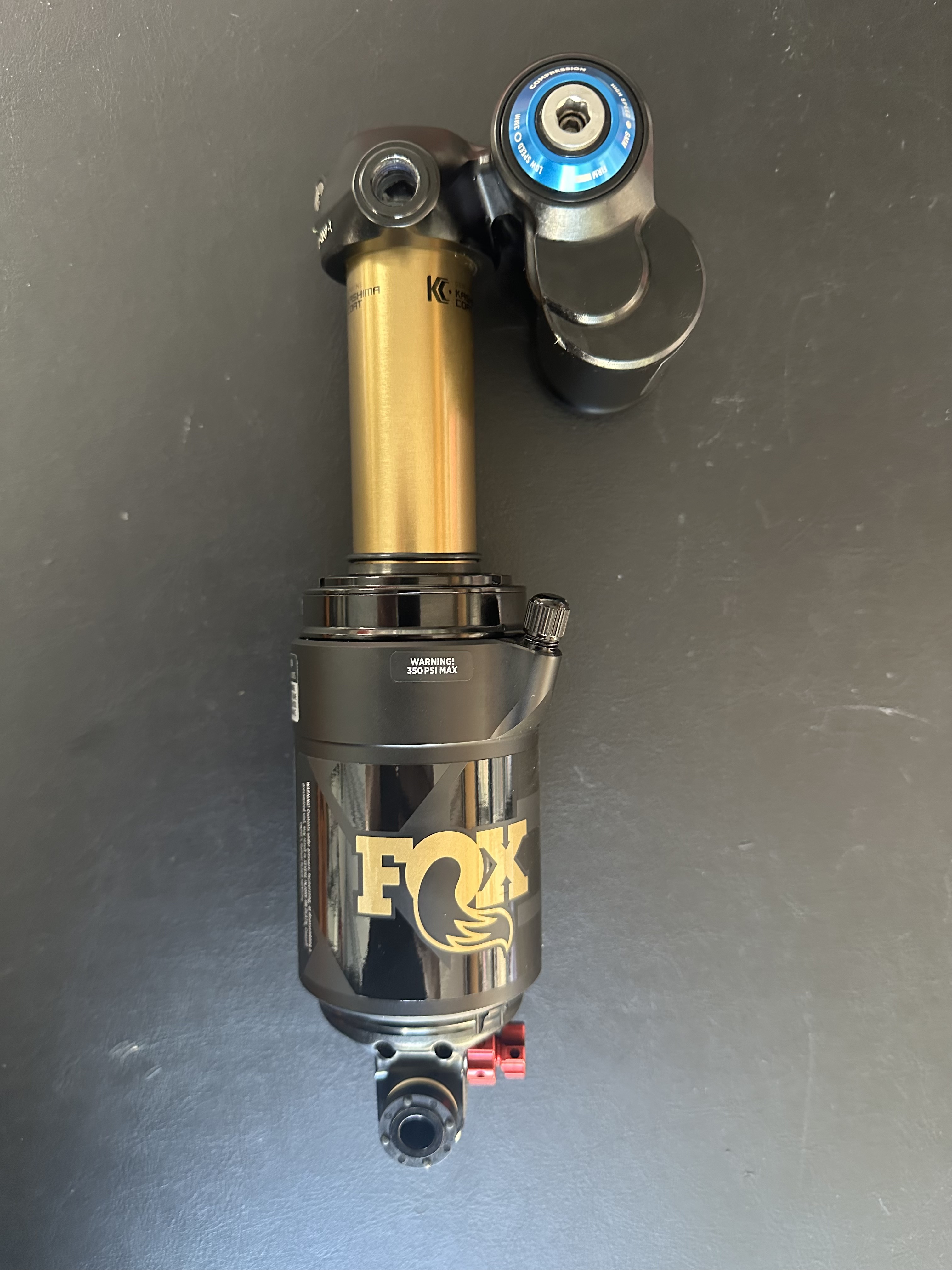

Anyone looking for the X2? This is a take off from a 2026 Bullit, 40 miles use only. Looking for $600 includes shipping and can ship within US or UK.

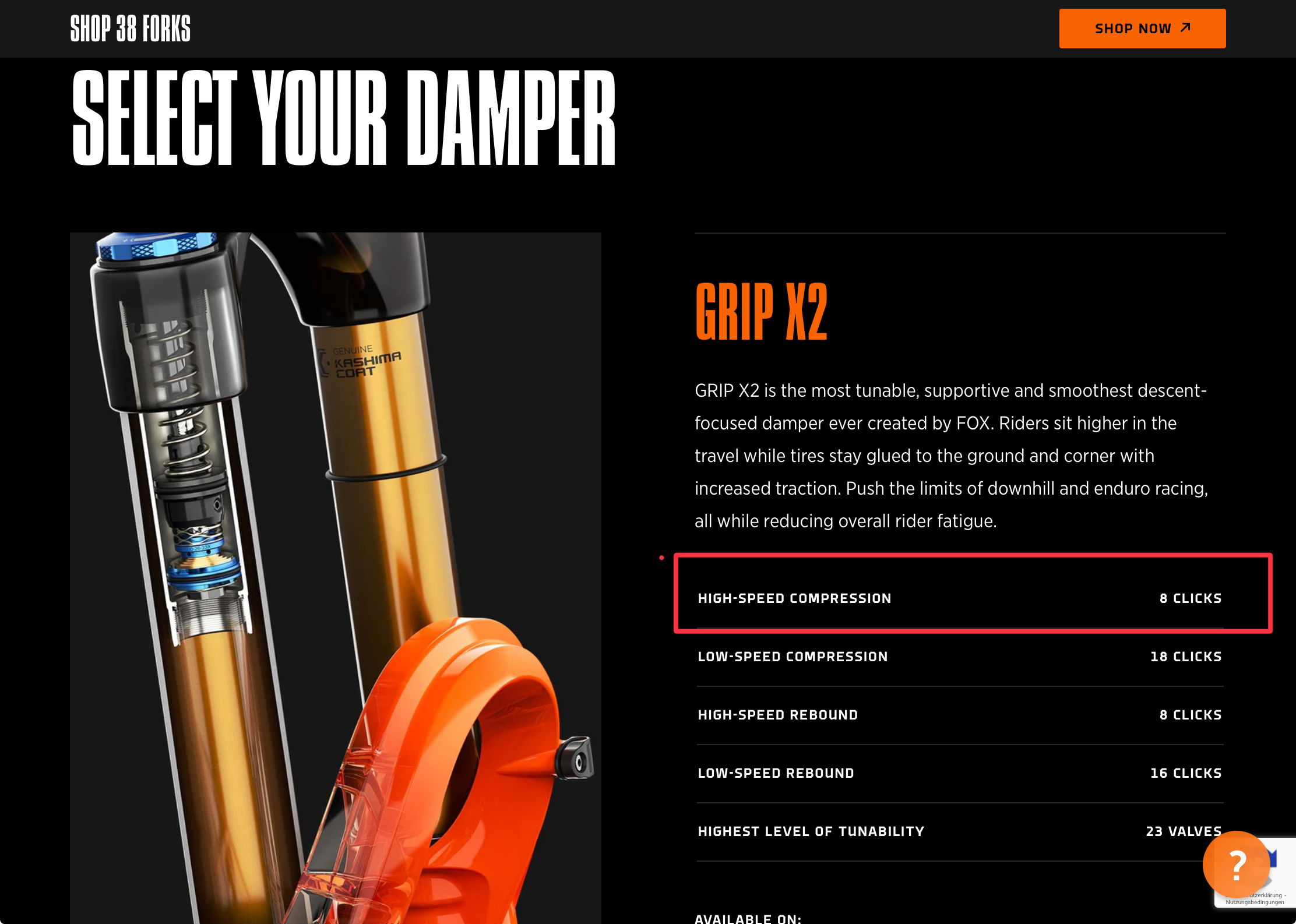

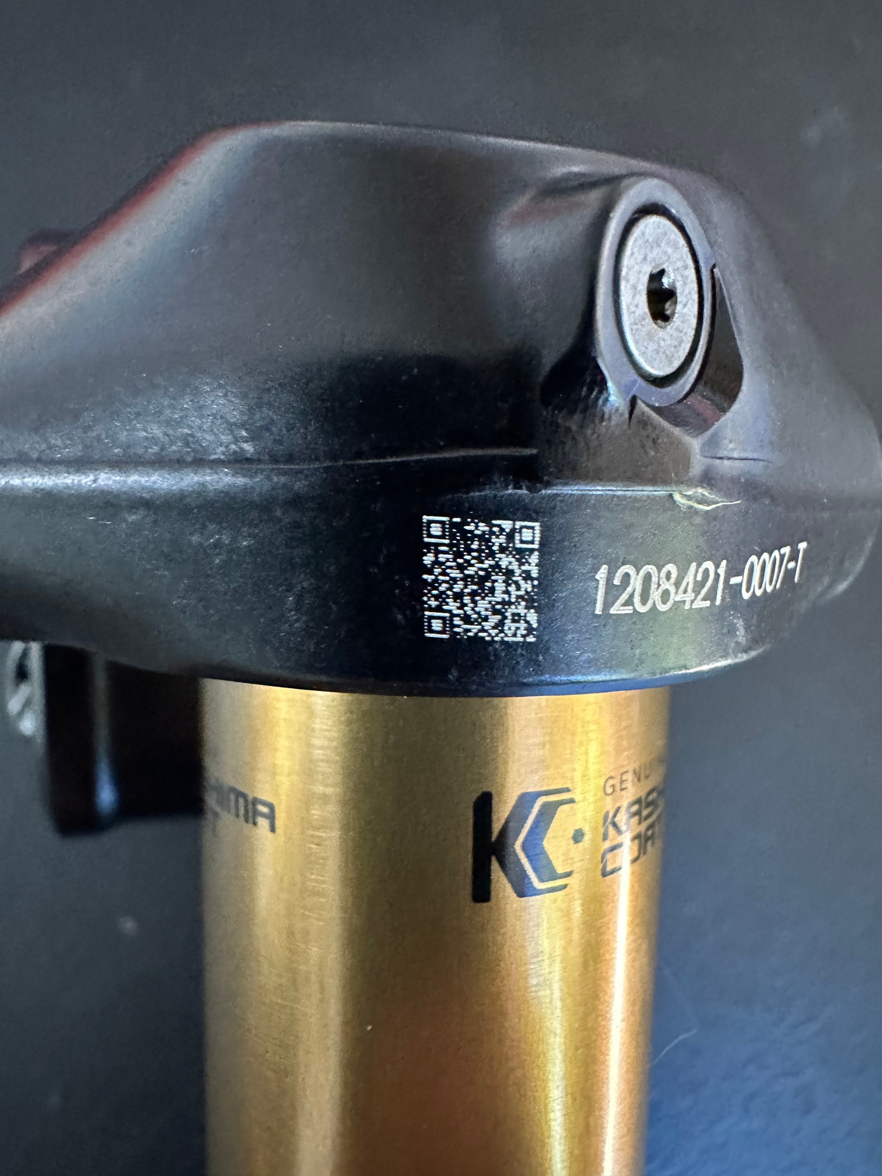

Are you sure about the HSC value?
I think the Grip X2 damper has only 8 clicks available on HSC.
That’s a good point. I spotted that too. I’ll need to check the next time on my bike. I did read somewhere that this fork may have more turns than 8 HSC but anything after 8 does nothing

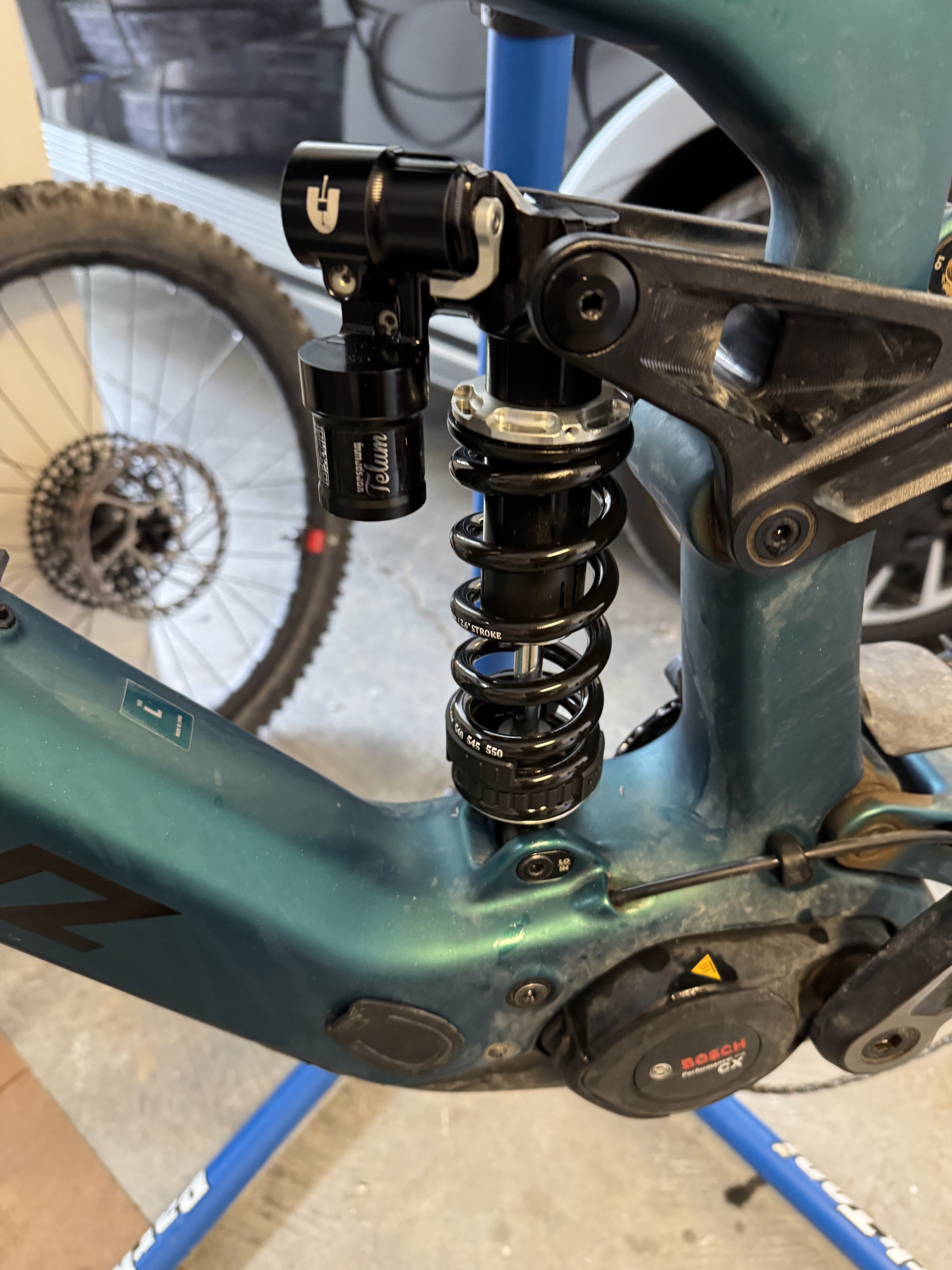

Made the splurge with the öhlins. Only one ride so far, but the coil transforms the bike, holy shit. Still dialing it in, but blows the X obviously out of the water. Riding with high progression setting. Also: motor update is a blast, emtb+ mode rocks.

Just an update on my side here a I finally got the chance to check. My HSC dial on my factory 38, grip x2 , definitely has more than 8 clicks HSC. I physically get 11 clicks from fully closed/clockwise.
After some googling I feel this damper has 10 clicks HSC opposed to 8
Only the 8 clicks do anything

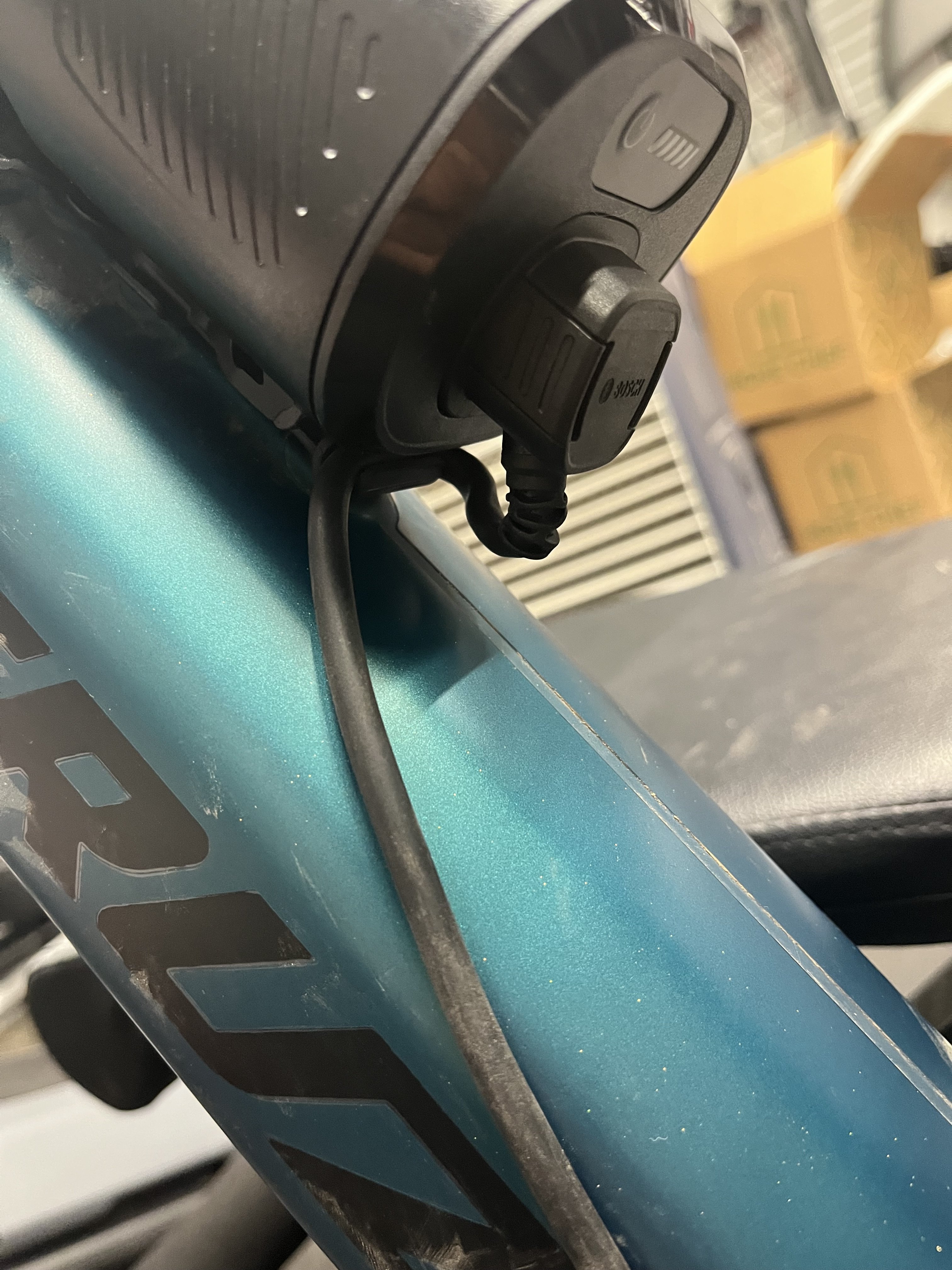

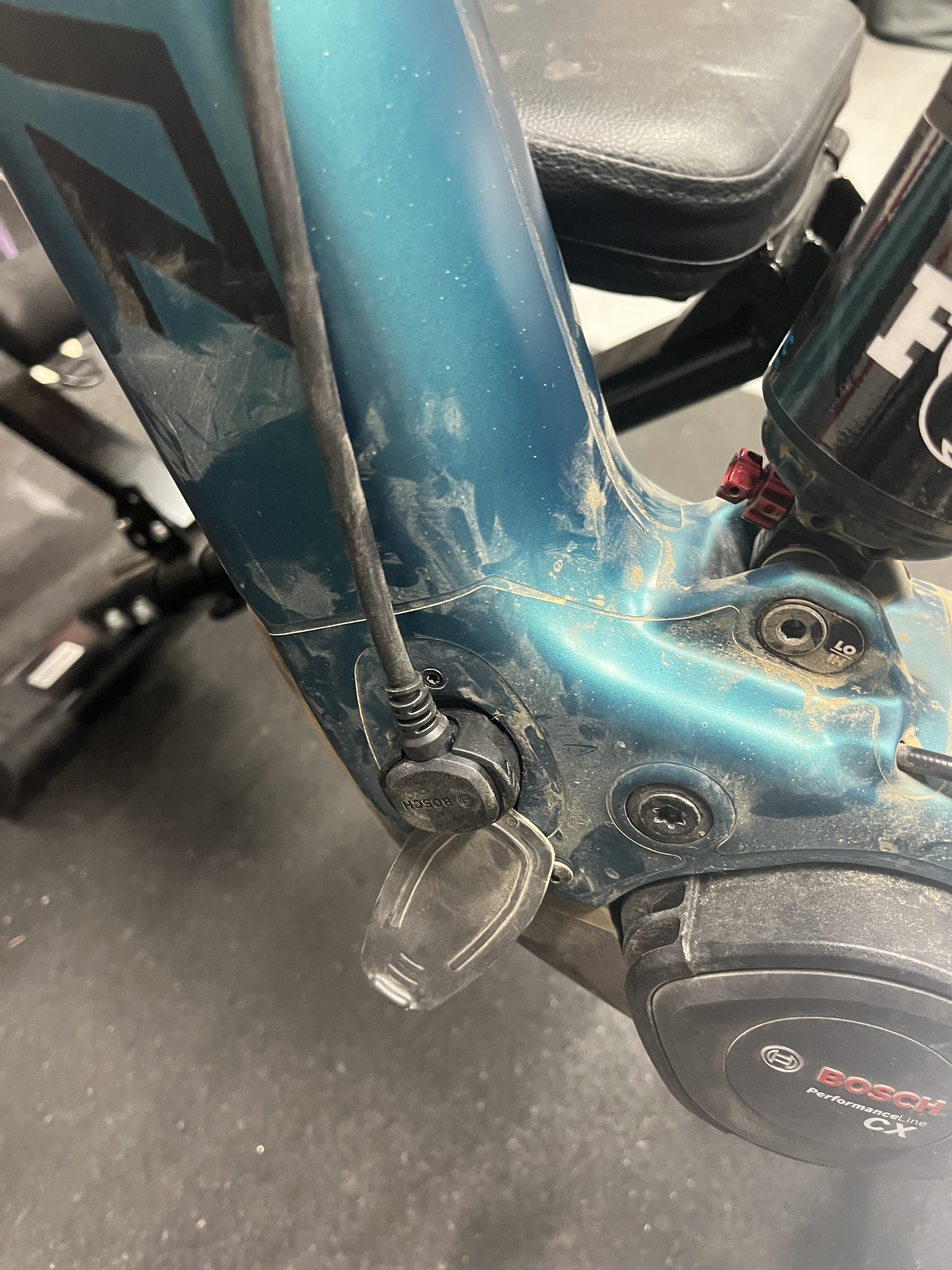

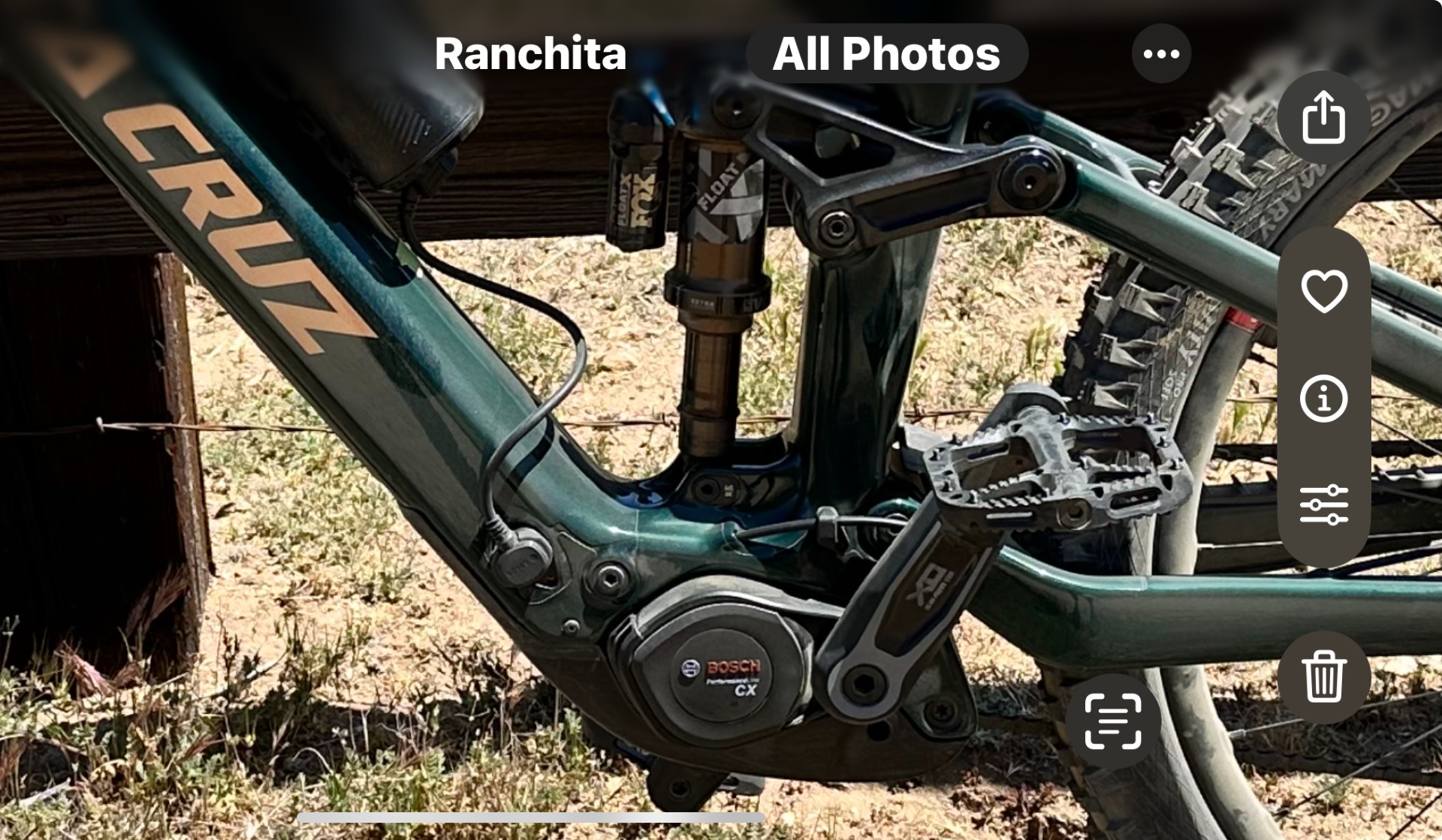

Thanks for that. Did you use the supplied plastic cable holder that Santa Cruz supply in the box? I didn’t get one but interested how it fits.
I just fitted a 250 mm with the Cord Wrangler and it seems super tight! The kink at the connector is far more tight than I like - feel like its going to wear like a bad iphone cable. How have others mounted? Also what do you guys do with respect to the rubber socket cover. Feels highly prone to get in the way of the crank and torn off.
Don’t use the clip, But my 250mm cable is much longer than that.. Are you sure thats not a 150mm?

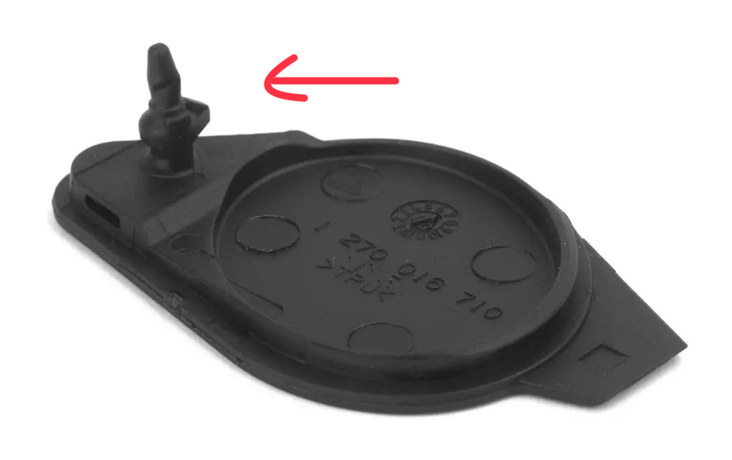

It’s easy to remove the rubber cover. After opening the cover you need to turn it 90° or 180° (don’t remember) and then you can pull the cover out. See photo how it looks on the backside.
Thanks for checking.
I thought the models with more than 8 clicks but only the first 8 doing anything where older models. Interesting to see this is still true for the newest version.
Had that thought as well but measured it. Saw elsewhere that people like the 300mm with the cord wrangler. ordered one of those and will report back.
Not a Bullitt but on my XXL Vala I used the 250 cable. The 250mm is only the center part of the cable, not including the ends. It stays out of the way, with no kinks and does not rub on the frame. I also cut off the tab that holds the charge port cover on so it was not flapping about. It stays in just fine when not using the range extender
Agreed. Yesterday I confirmed with fox and they noted “total HSC is 8. On some dampers the dial will be able to reach more clicks, however these additional clicks will not open up the HSC any further. It is for this reason that all settings are counted from the fully closed position.”
I confirmed with fox yesterday and they noted “total HSC is 8. On some dampers the dial will be able to reach more clicks, however these additional clicks will not open up the HSC any further. It is for this reason that all settings are counted from the fully closed position.”
