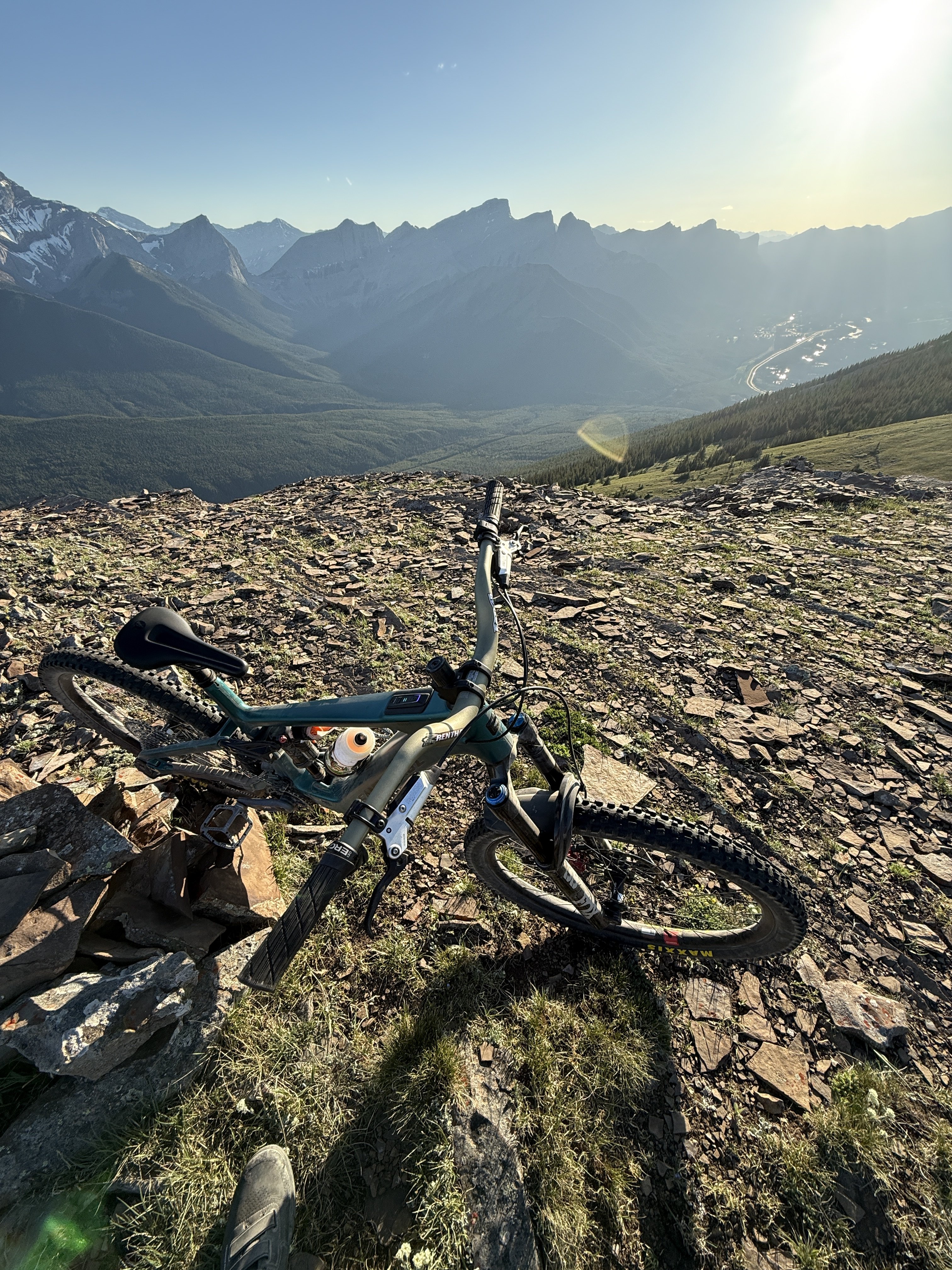

So I am a new Bullit owner! I am 205lbs, 6'3" and ride an XL, first ride I did 3300' elevation and 13.3miles toggling all of the power modes and when I finished the ride I had 29% battery remaining.
