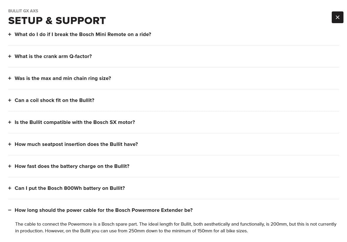

Do you know what length Powermore cable you bought?
I am using a 250mm cable. Santacruz adjusted the FAQ to provide the direction on this. FWIW, my LBS and I tried the 150mm cable on my XL and it fits, but it's way too tight for comfort in my opinion.

I’m looking at buying a powermore for my incoming Bullit. There are 2 cables available BCH3923 and BCH3925 Anyone know what one do I need.
Thanks
As far as I know, I started with the 150mm recommended cable and it was like just a hair too short. Was taught and hard to plug in. That did not seem a good thing given the beating these take. So i ordered the 250mm which is about 3.9” longer. You can kind of lay the cable on the frame and i think its better
Those are the choices as far as i know

Additional cable required to connect battery to charging port either BCH3923 for a cable that leaves away from the battery or BCH3925 that leaves the battery up from the battery.
The above is the choice I’ve been given. Both are available in 150 and 250mm.
Also mine is a medium so perhaps the 150 would be a better fit

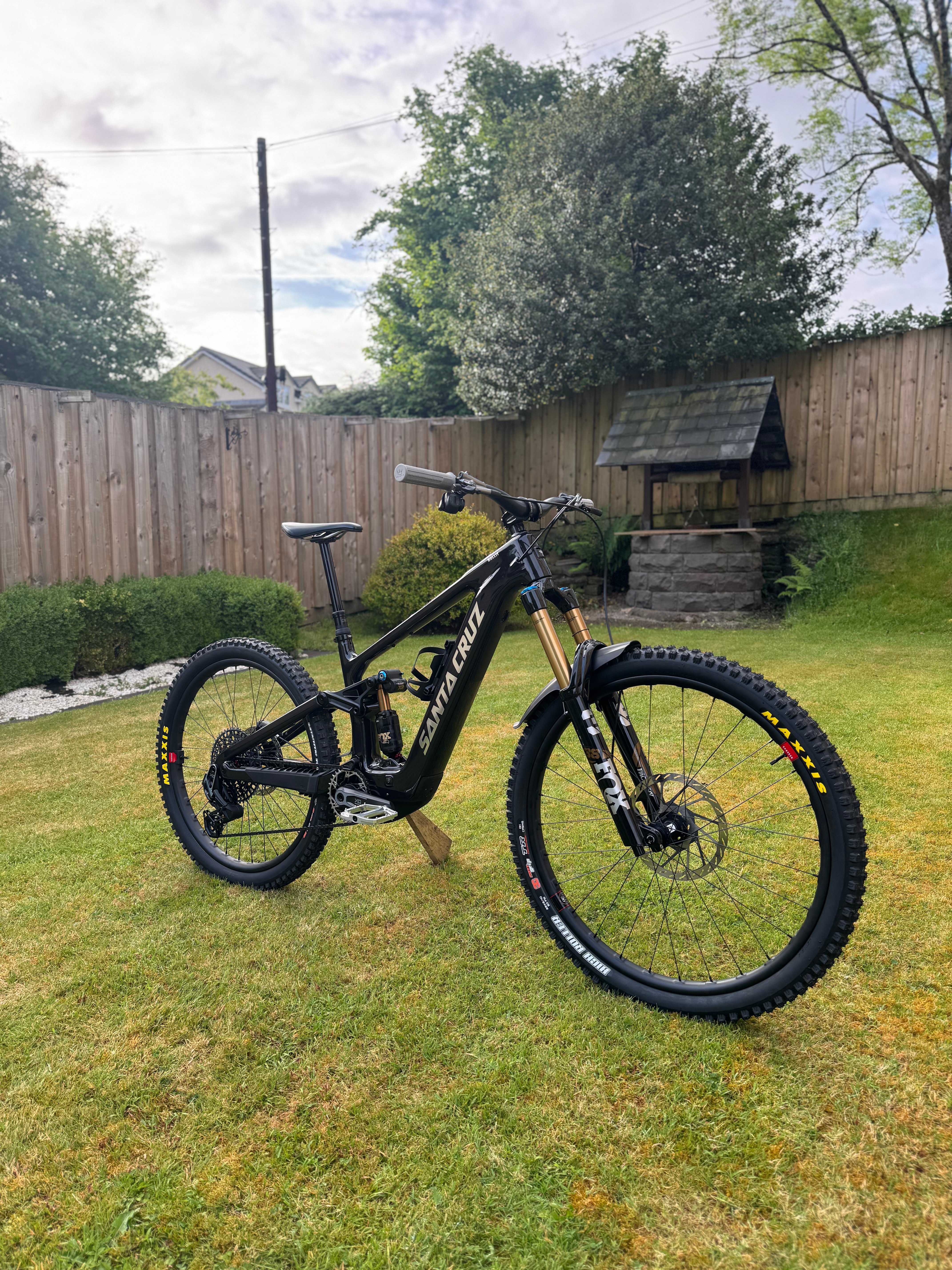

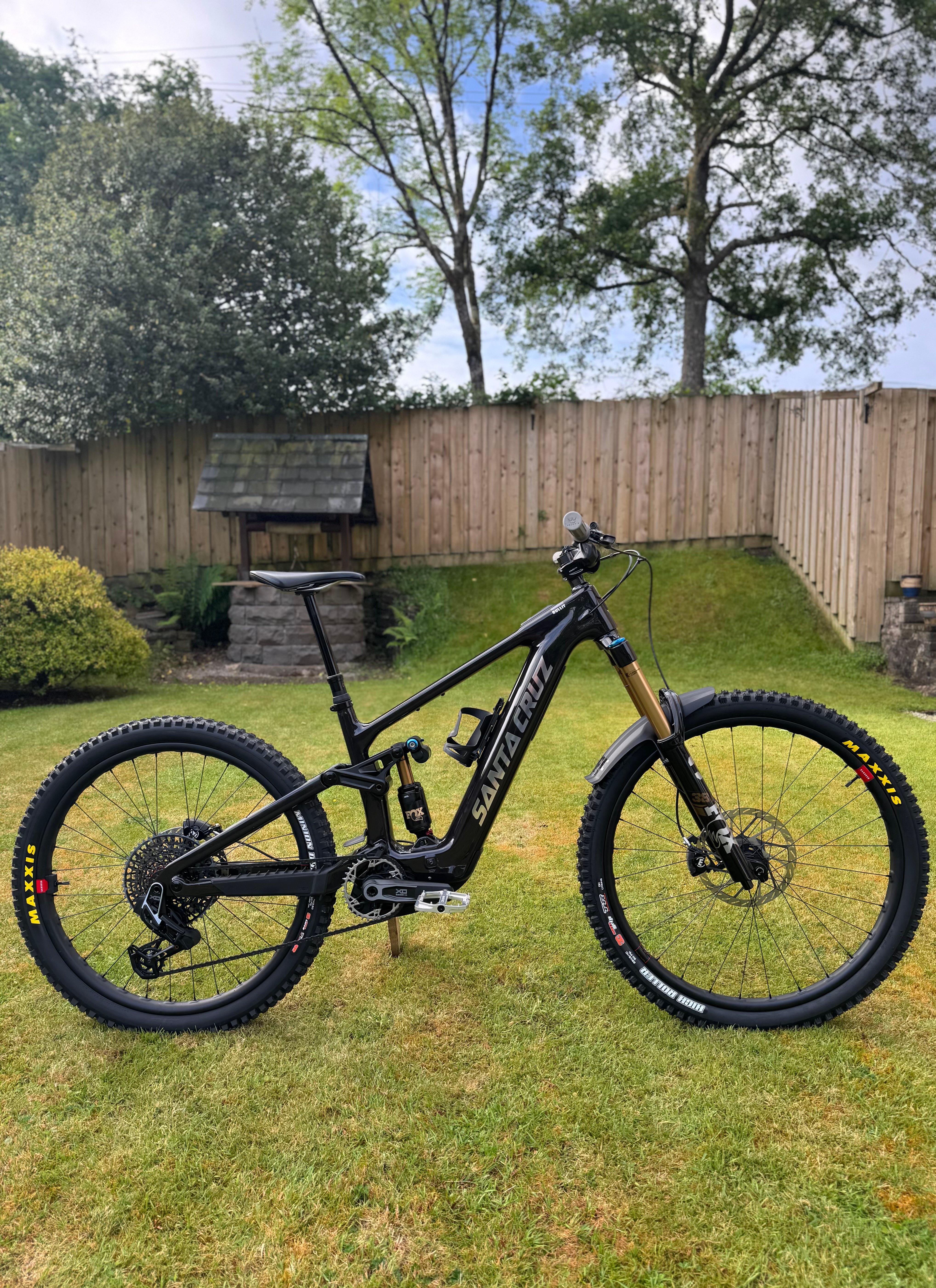

Finally collected mine on Saturday afternoon, spent most of that evening and yesterday sorting out bits on it and it’s ready to go for the first laps today, stoked on it.
Changed brakes to shigura XTR / MT5 and put a 220 HS2 rotor on the front
Swapped out bars and stem to Burgtec stem / OneUp bar, changed the saddle and grips and stuck a High Roller 3 DH casing on the front as the weather looks naff for the next few weeks. Rimpact insert in the rear for the DD DHR2.

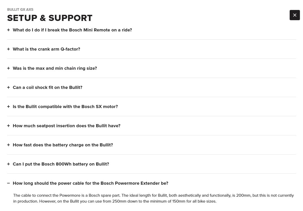

150mm powermore cable doesn’t reach the Range extender on a medium so have a 250mm for now. Hopefully Bosch come out with a 200mm option.
Haven’t bothered weighing it, it’s my first e-bike so even the eco/trail modes are a complete novelty to me.
Only thing I’d consider getting for it in the future would be an AXS dropper but would like to see if someone can slam a 200mm in a medium frame.

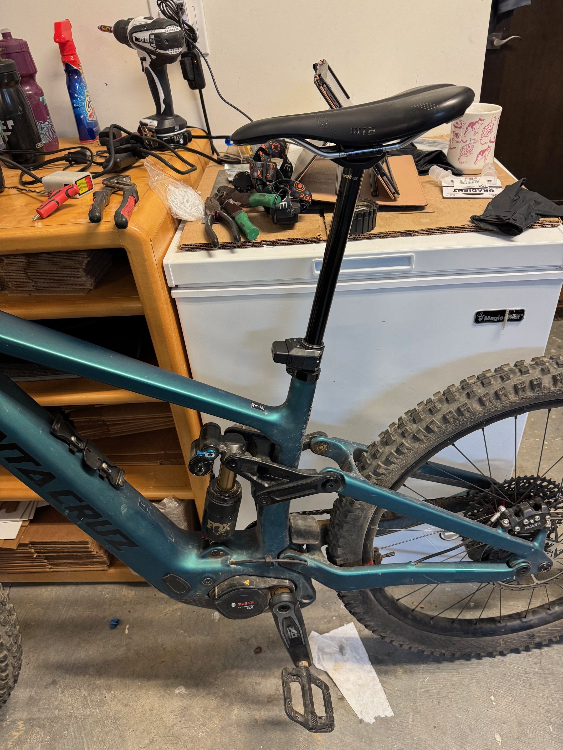

Large Bullit - Max seatpost insertion length?
Apologies if this has already been discussed but does anyone have a definitive figure on the max seatpost insertion length on size large Bullit?
Santa Cruz website does not appear to detail this.
Thanks
Thanks
Don’t know but i slammed a 225mm AXS REverb ion mine
