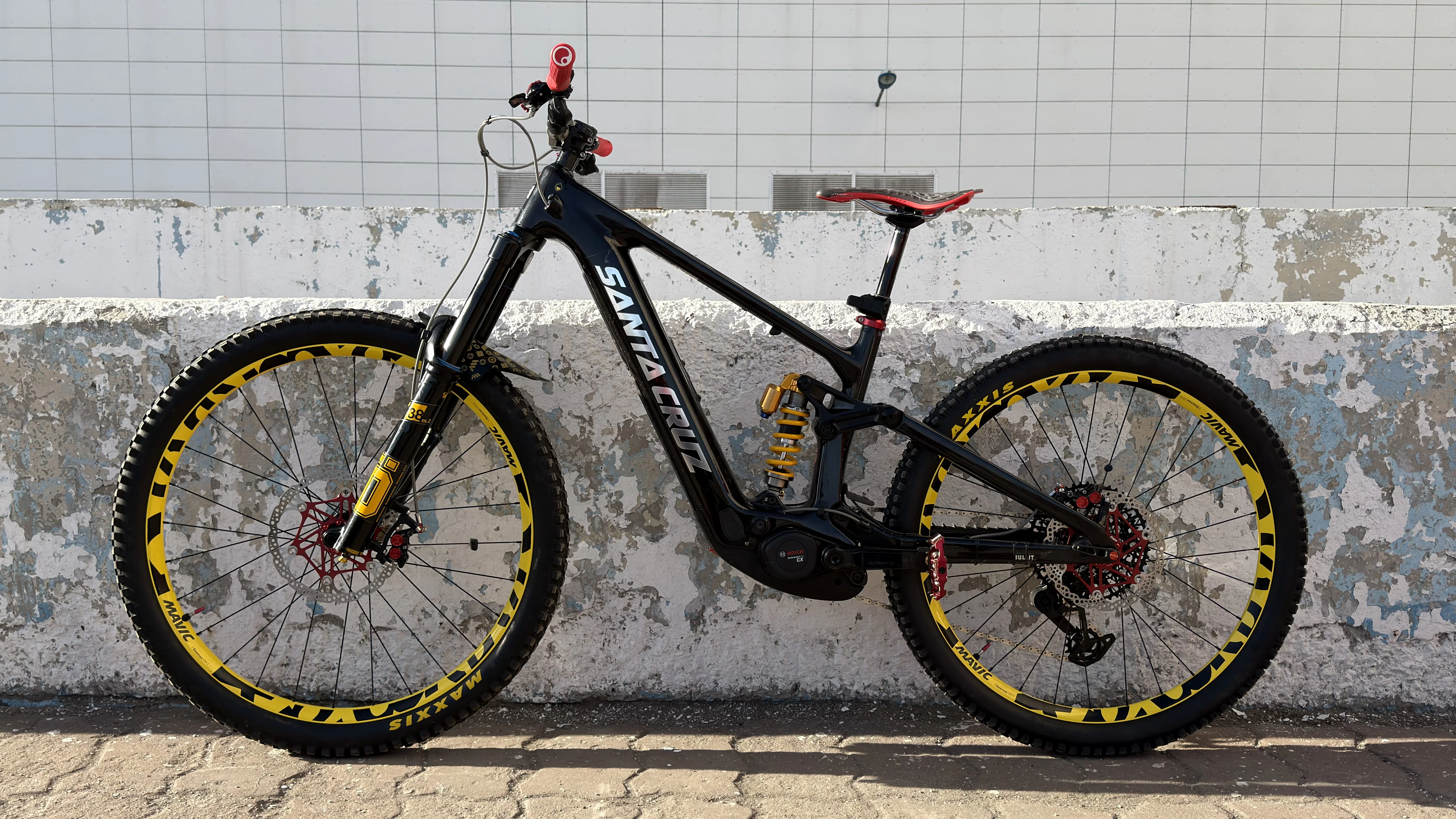

Hey, I’m at full Ohlins, great suspension, but patience and experience is required for a correct set up, fox is much “user friendly” but correctly adjusted Ohlins is much better as for me. Fox feels “stupid” after it. IMG_9089.webp

I’ve got ttx air too, great shox, but highly recommend thinking about switching to Ohlins coil, its mindblowing)
M3 forks are similar to m2 forks, the difference is in spacer in negative chamber, which u have to remove on your own in M2, so if U find a good deal on M2 - take it. In Ohlins forks it’s difficult to set up pressure in cameras which will suit u, cause their manual numbers work for nobody :)) and the point is to find that balance between plush/bottoming out according to your ride style. I also installed 180 travel upgrade, its much cheaper and easier to change Ohlins forks travel than others.
I got the m3 for cheaper than the m2, so all good there...the m3 does have a few other nice tweaks too, I just wish they had kept the matte finish! Rear shock has taken quite a bit of messing to set up, and the recommended pressures are way too low for how I ride, so expecting the same challenges with the fork. At least they are a starting point. Will post some feedback once I've got it dialled in. Appreciate the advice 👍
