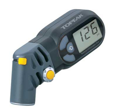

I have the Topeak gauge in this link. This older one works better than their updated one. No air loss with the Fillmore valves
Good to know thanks! Will prob get one

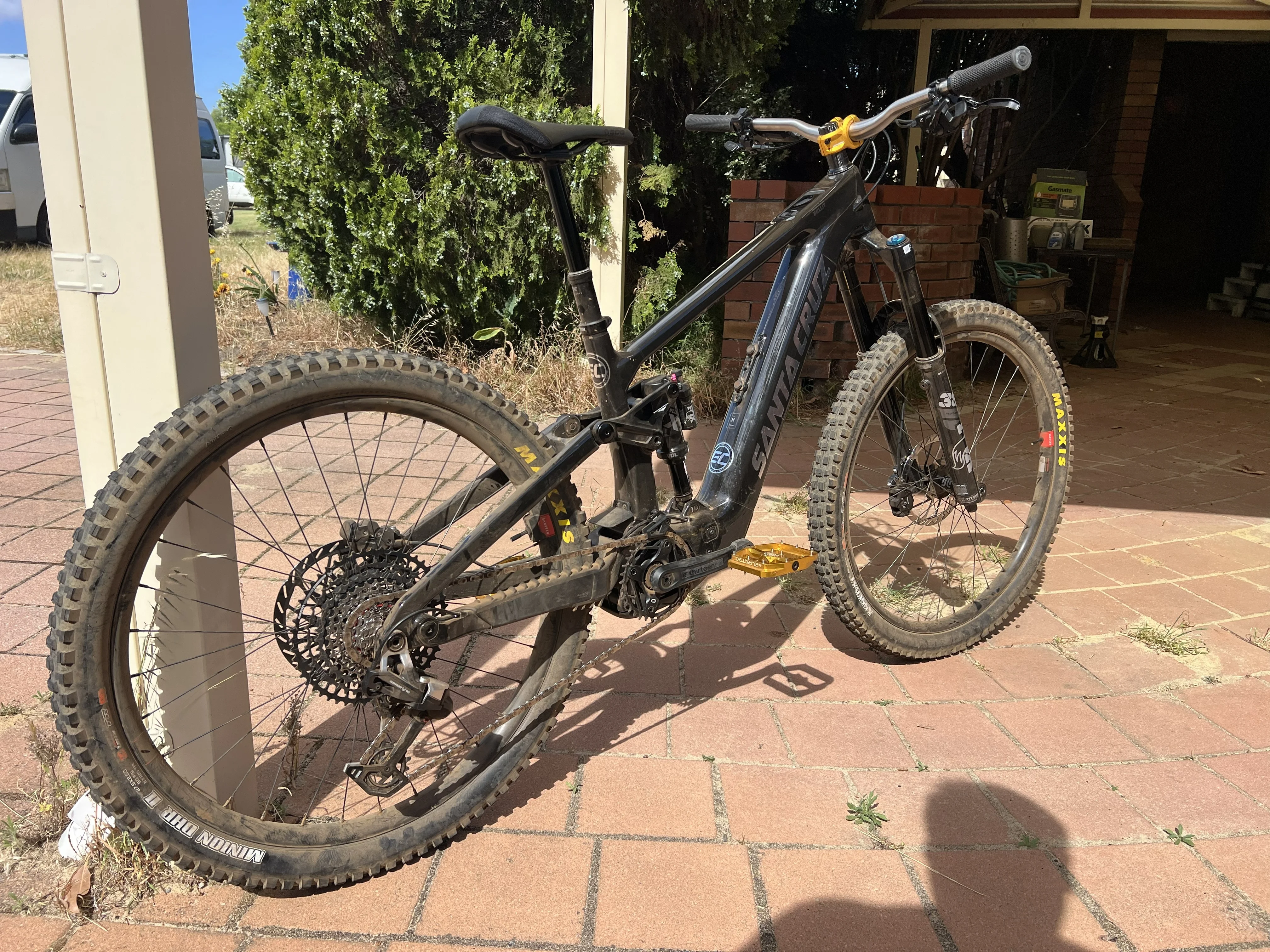

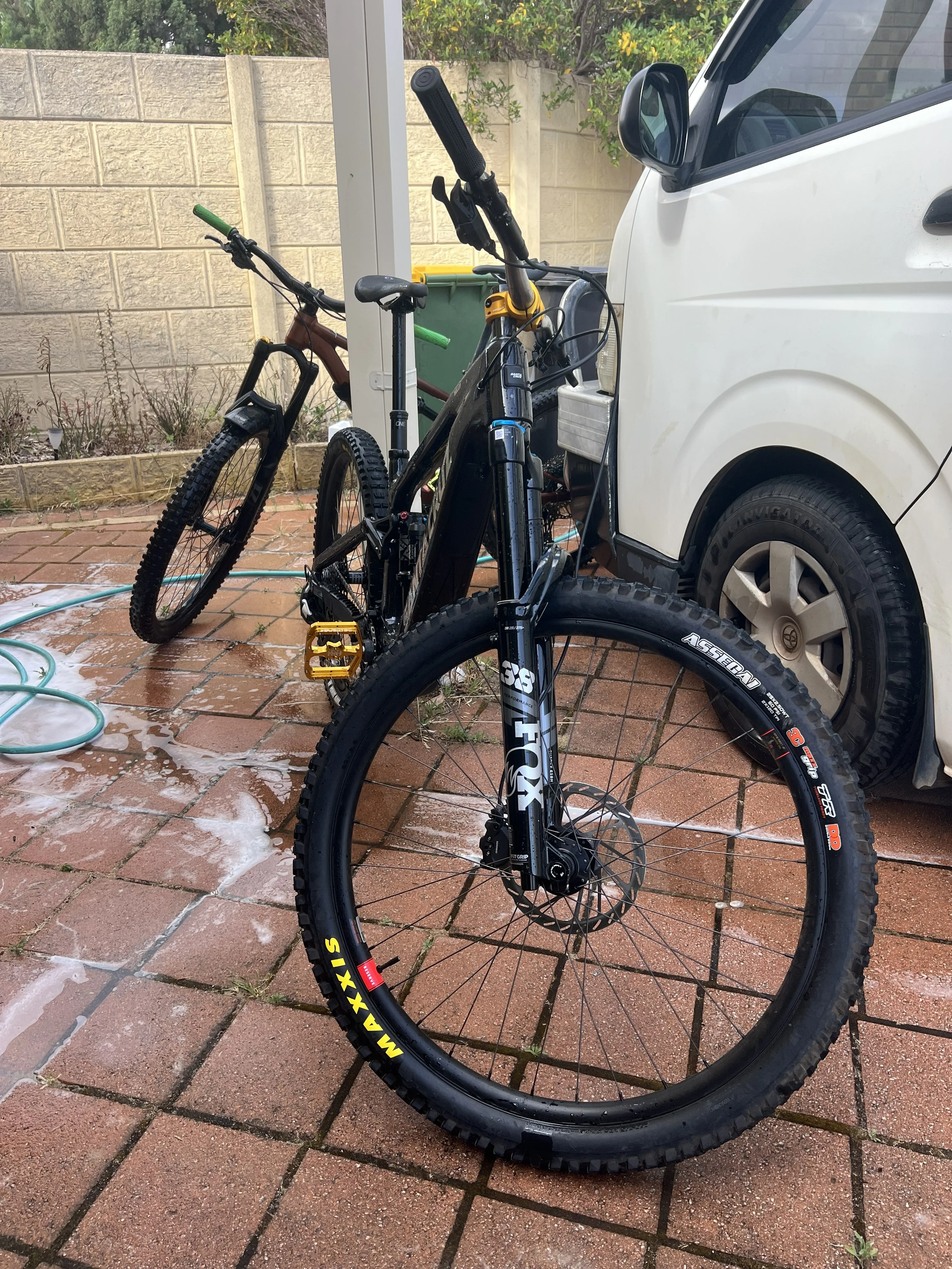

Got the Bullit in November but just found this forum recently. Tons of great information! Here is my bullit.
Here it is after the wash and my old bike looking jealouse in the back ground:
I am now running Schwalbe radial magic marys dh casing.
Im about 120kg with gear.
With the shock you guys recommend for heavier riders to skip the x2 and just go straight to a coil instead? and generally Ohlin's seems to be the go?

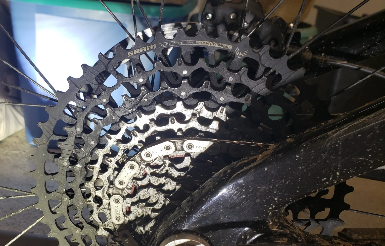

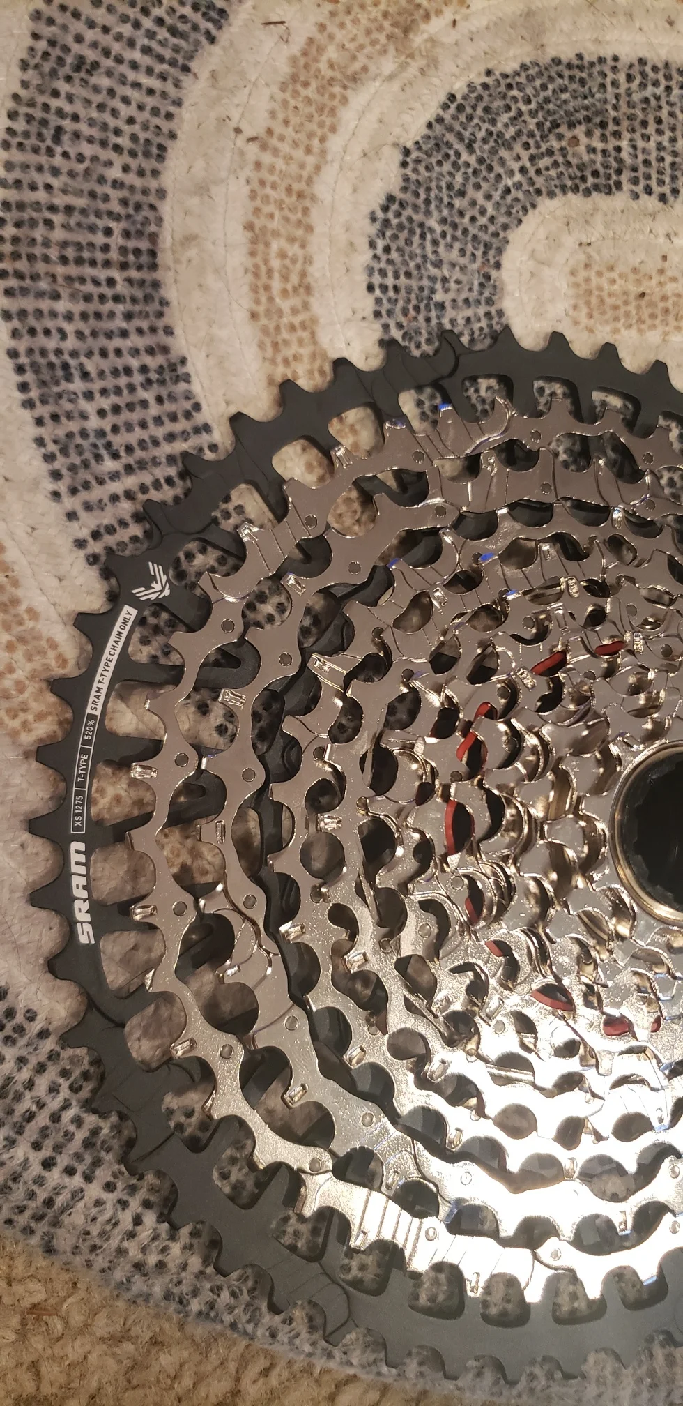

I bought a spare XS-1275 for my Bullit. I noticed only the outer ring is dark compared to stock cassette.
Curious if that's just cosmetic or a material difference?
Is that just an OEM vs aftermarket thing or was there a change?
I notice on Ally Express (didn't buy from them) that they show both offerings. Kinda seems like just a color thing rather than material difference. But I still wonder?

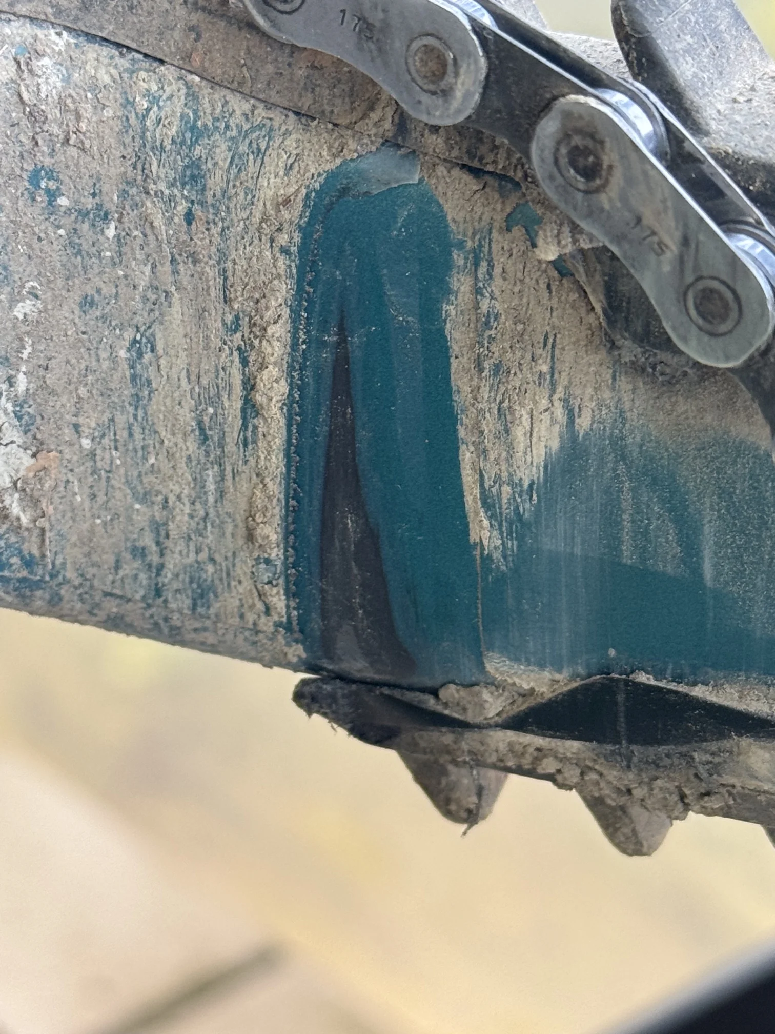

I've seen a few things around with Bullit and Vala where the mini controller has left marks on the top tube where users have swapped them out for the kiox display :(
I just did the swap and I do have those marks :(. That’s a bummer. Curious if there is a way to remove them?

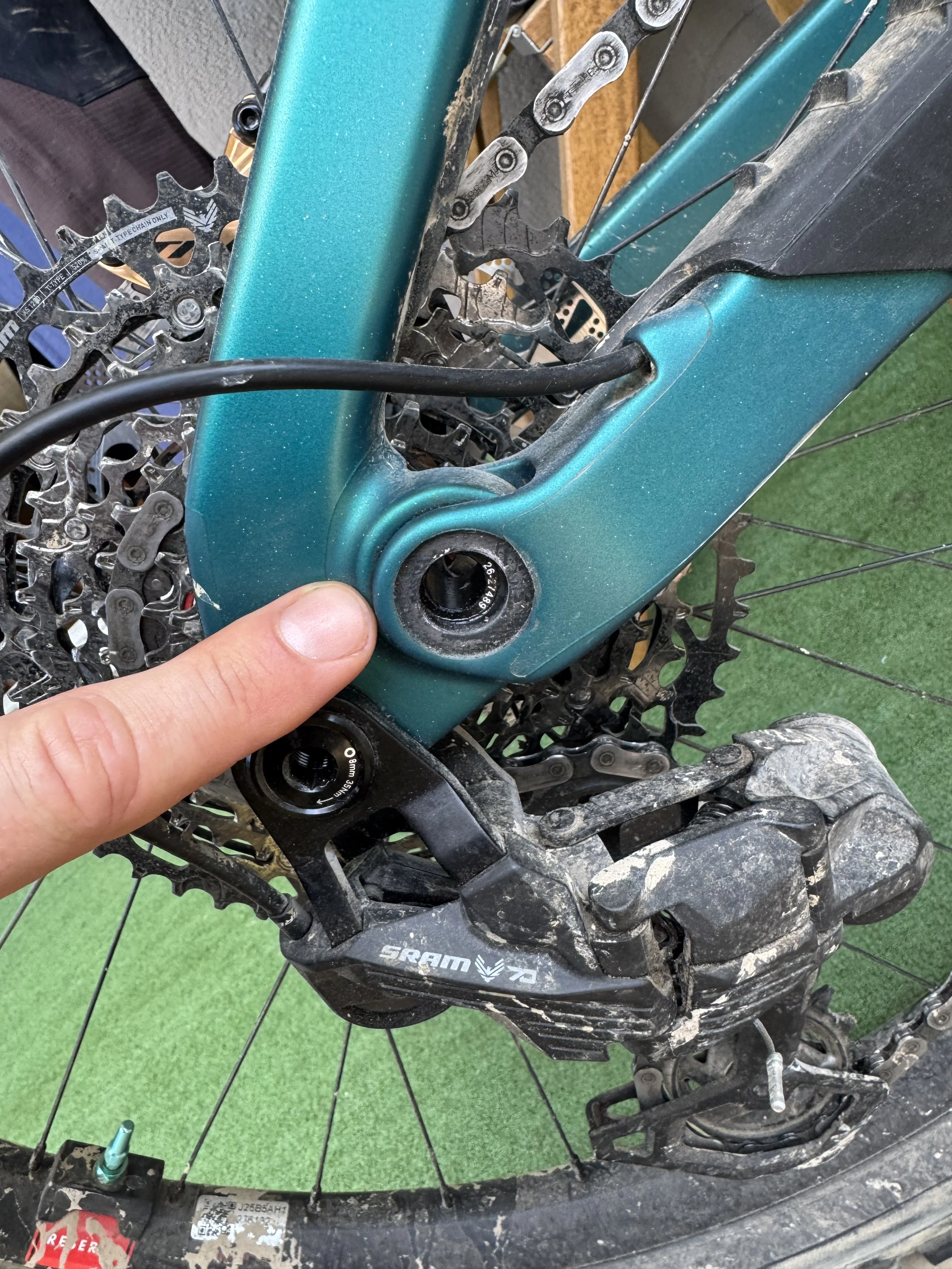

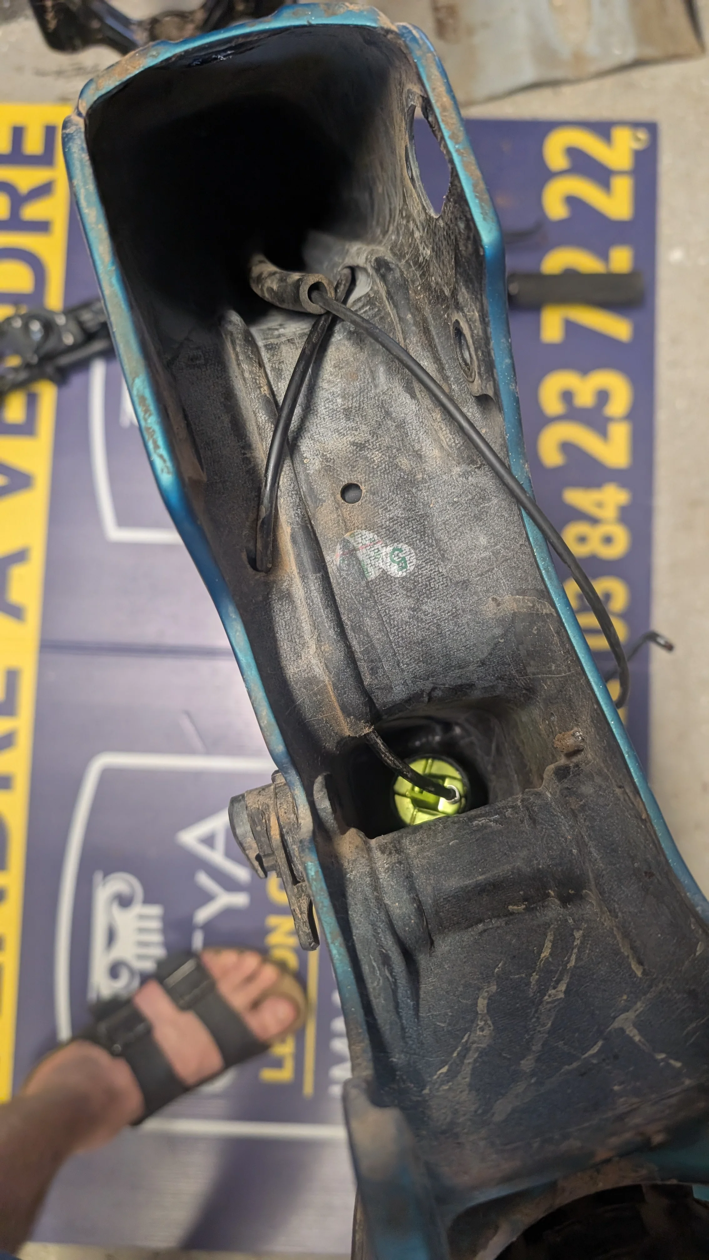

Here’s a new issue. Yesterday during a longish ride (including some loose rocky trails and steep forest sections) a rear triangle pivot bolt…. Just unscrewed itself and left the chat. I started hearing tyre rub under compression, similar to what you hear when there’s a good bit of mud or a stick stuck somewhere. I looked, couldn’t identify anything, and was in the middle of the forest, so had to continue down.
I was lucky that there’s a small bike repair shop in the village at the bottom; took us like 10 minutes to figure it out -noticed the bolt gone, so under compression the wheel would go sideways and rub the inside of the frame. Results: the tyre rubbed through the Ridewrap, then through the paint, all the way down to raw carbon :/
VERY not happy - lucky I didn’t crash and hurt myself. The bike has 250km on it, mostly pedaling uphill on smooth tarmac to get me to the trails, pretty much new. Did they ran out of Loctite in the factory? Or was the torque wrench missing?
I sent a ( somewhat angry) warranty claim :(
Same damn think happened to me. Good luck finding a bolt. I had to call Santa Cruz and get one shipped since the $150 bolt pack I bouth took 5 weeks!
I hope I didn't mess up anything incsme down into some tech and noticed the tire rubbing but couldning stop right away. I almost crashed.
Theres a special insert nut on the inside so check that didn't fall out you'll most likely need that also.
Update: luckily there’s a Santa Cruz dealer not too far (kudos to Chrisbike in Les Gets!) and they got me a bolt the following day, just in time for pre-opening day of the bike park :) Meanwhile, I contacted Santa Cruz and in 6 days I had a new rear triangle bottom, along with the bolt. The famous Santa Cruz warranty definitely deserves its reputation. Fyi: 16 Nm and loctite for these bolts 😅
