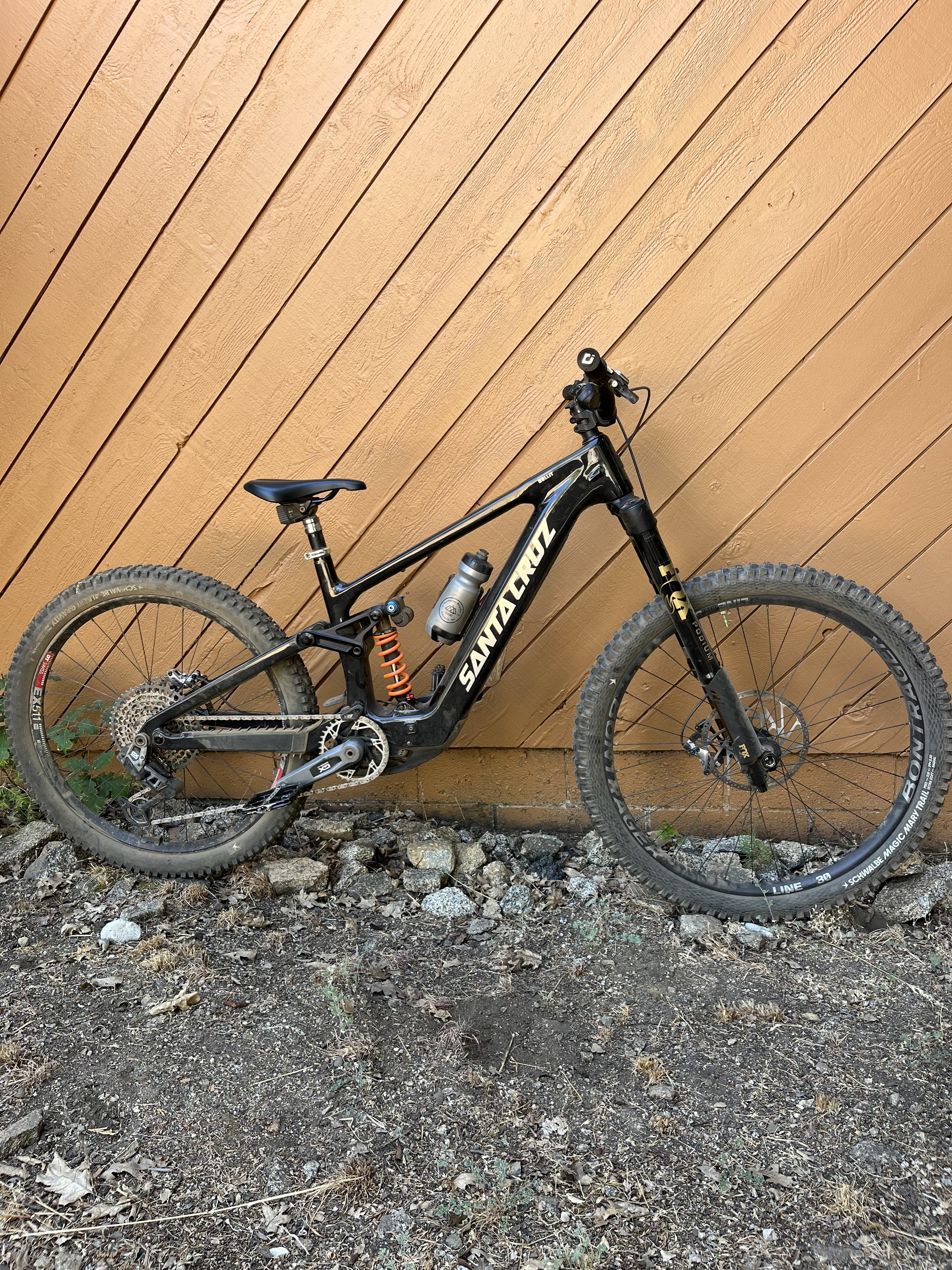

Hi guys. Just built up my bullit and am absolutely loving it. My float x2 is currently getting tuned for the bike so I’m rocking my dhx2. Still need to get it dialed in. Loving the podium. No issues thus far and I definitely think it’s the best feeling fork I’ve ridden. This is the 2nd bike I’ve had it on. Side note, has anyone else used chat gpt to dial in suspension? I tried it as a joke, and I’m actually kind of impressed with how good it actually worked!
View attachment 167044 View attachment 167045

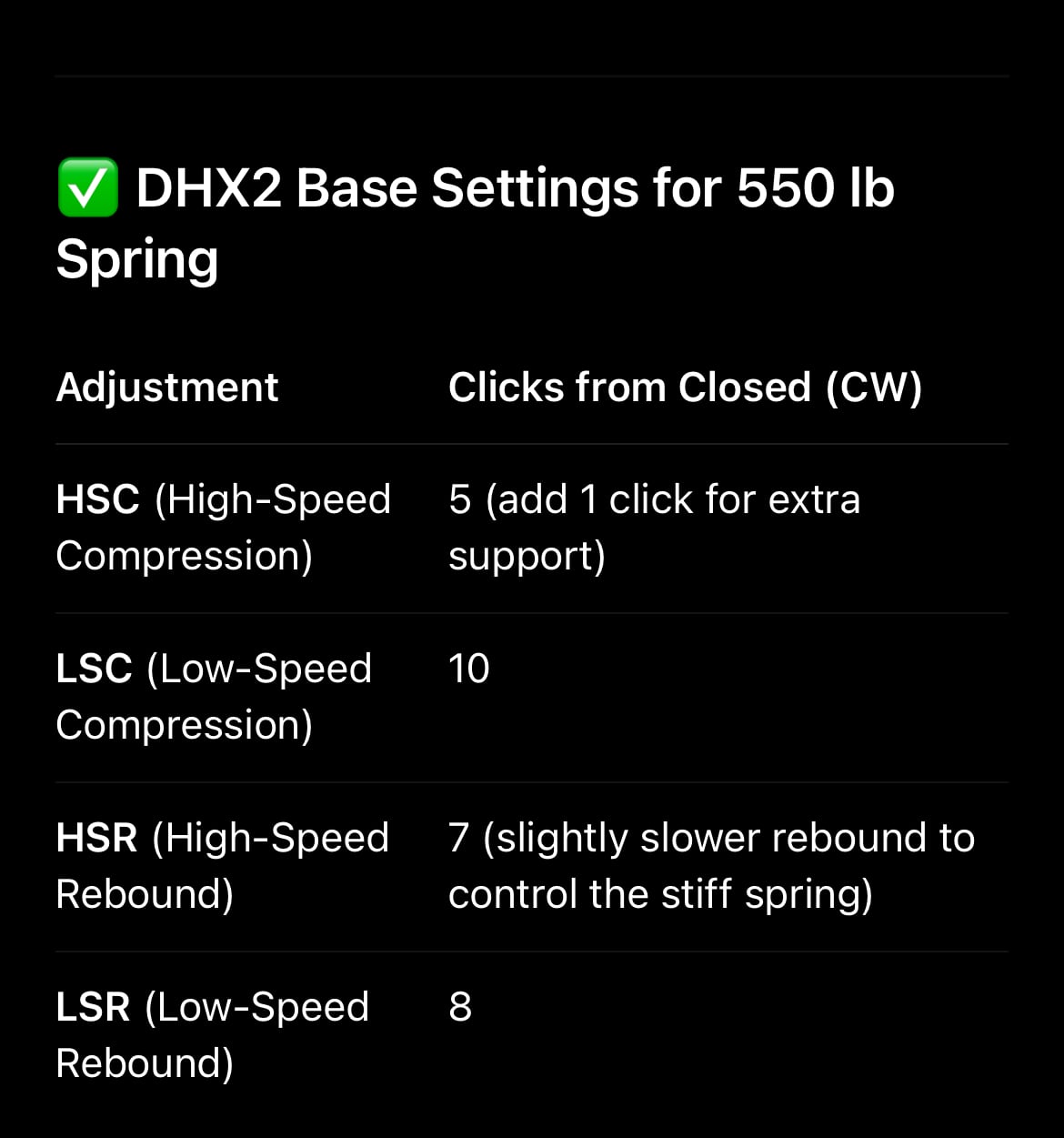

Dumb dumb Q but what size DHX2 are you running? Can’t seem to find the 205x65 anywhere…

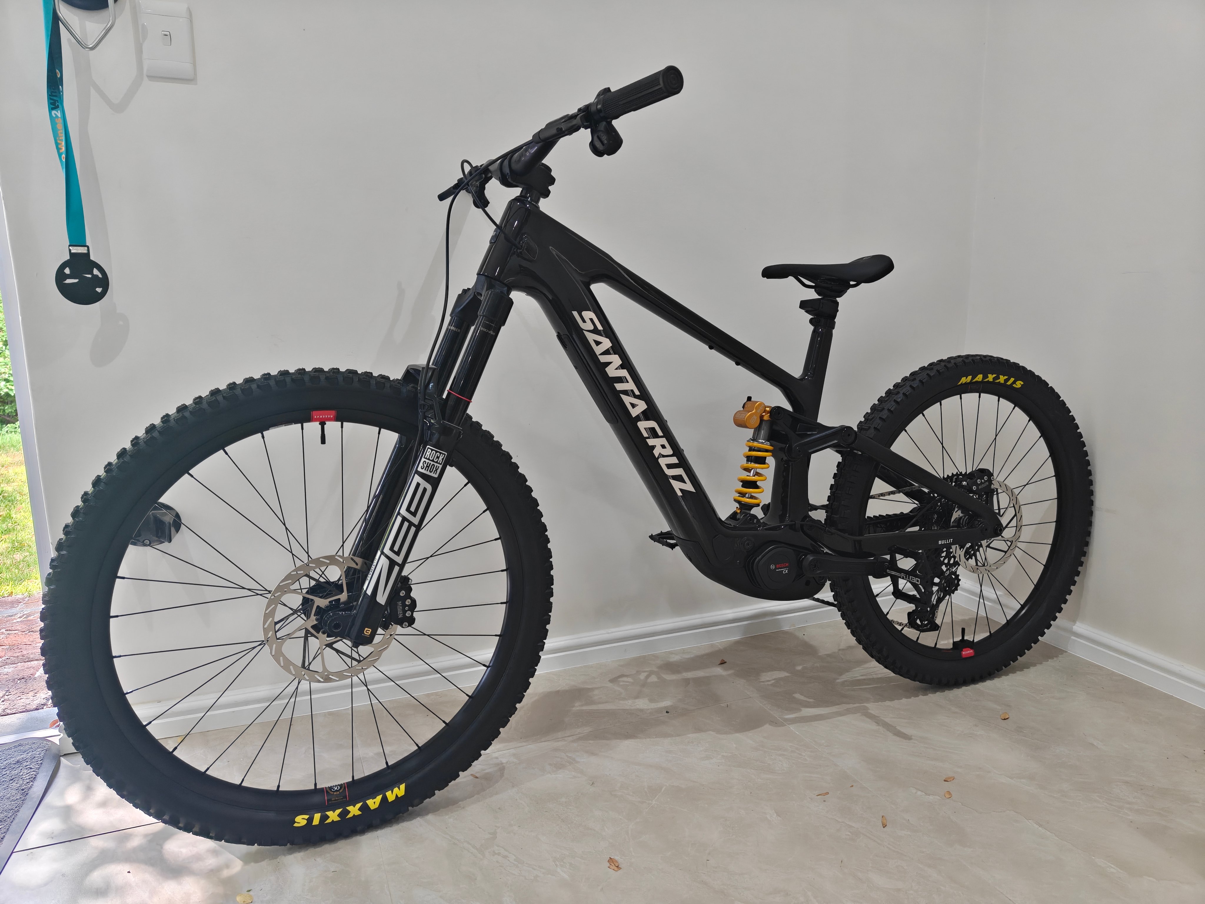

Had my first ride yesterday coming off the G4 Levo. I am very happy with the range on this bike which was quite a worry coming from the bigger battery bike.
Things changed over stock:
  • Fork
  • Rear Shock to coil
  • AXS 200mm dropper
  • GX AXS derailleur
some info: I weigh about 103kg kitted up, I did a 21km ride with 900m of elevation in 1:20hrs. I had 49% battery left, most of the ride was done in tour+ with the stock settings turned down a notch. There was quite a bit of EMTB and TURBO in the mix for the heavier climbs.
I had the V3 bullit so can compare. I decided to go up a size this time and am on a XL frame. I'm 6ft on the dot and prefer a bigger bike, although the XL doesn't feel too big. The older bullit felt a lot smaller than it should have so upsizing this time was a personal choice for what I currently am after. I would stick to normal reach numbers for your correct body formation.
Coil - imo this suspension setup loves a coil, I was fitted to a 550lbs spring which I feel is not the sweet spot, bike rode in the travel quite a bit and sag was around 33%. I'll be moving up to a 575lbs coil later this week. Rode like a magic carpet though so it's always the toss up. I'm getting old so sometimes it's nice to just float along :)
Bike is so planted and fast going straight through the rough stuff.. I did struggle a bit on the sharper turns going down but not enough to dislike the ride, I just need to get a bit stronger.
Overall I'm very happy with the bike. The mods are defos worth the money.

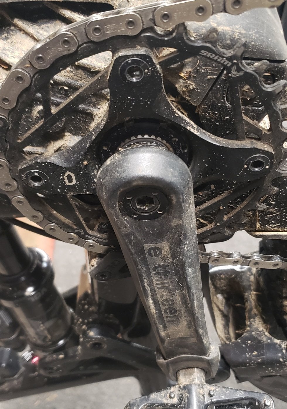

Can anyone tell me what special tools I need to remove the stock crank arms on the Bullit 90 (e*13 alum cranks)?
I did some checking around but seemed confusing. I think I need a crank puller (CCP-44?) and some special Bosch tool (BDU-something?).
thanks.
If you only want to remove the crank arms you'll need no special tool at all. Your photo shows that the crank has a self extractor cap installed. You only need a 8mm hex key, turn it counter clockwise to loosen the nut, turn it further and it will pull the crank arm from the spindle.
In case you also want to remove the chainring you'll need a lockring tool specified for Bosch gen3/gen4/gen5 motors. Gen4 and gen5 use identical lockring nuts, so any tool specified for gen4 will do. See an example here: EBIKE24 Lockring Tool for Bosch Gen3/4/5, Yamaha PW-X, Brose

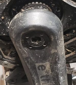

OK, got the cranks off, but the ring with the 4 holes backed out also. I see blue in the threads (threadlocker), so other than using a pick to rotate it back in, is there some tool to tighten it? (I would reapply the threadlocker)
