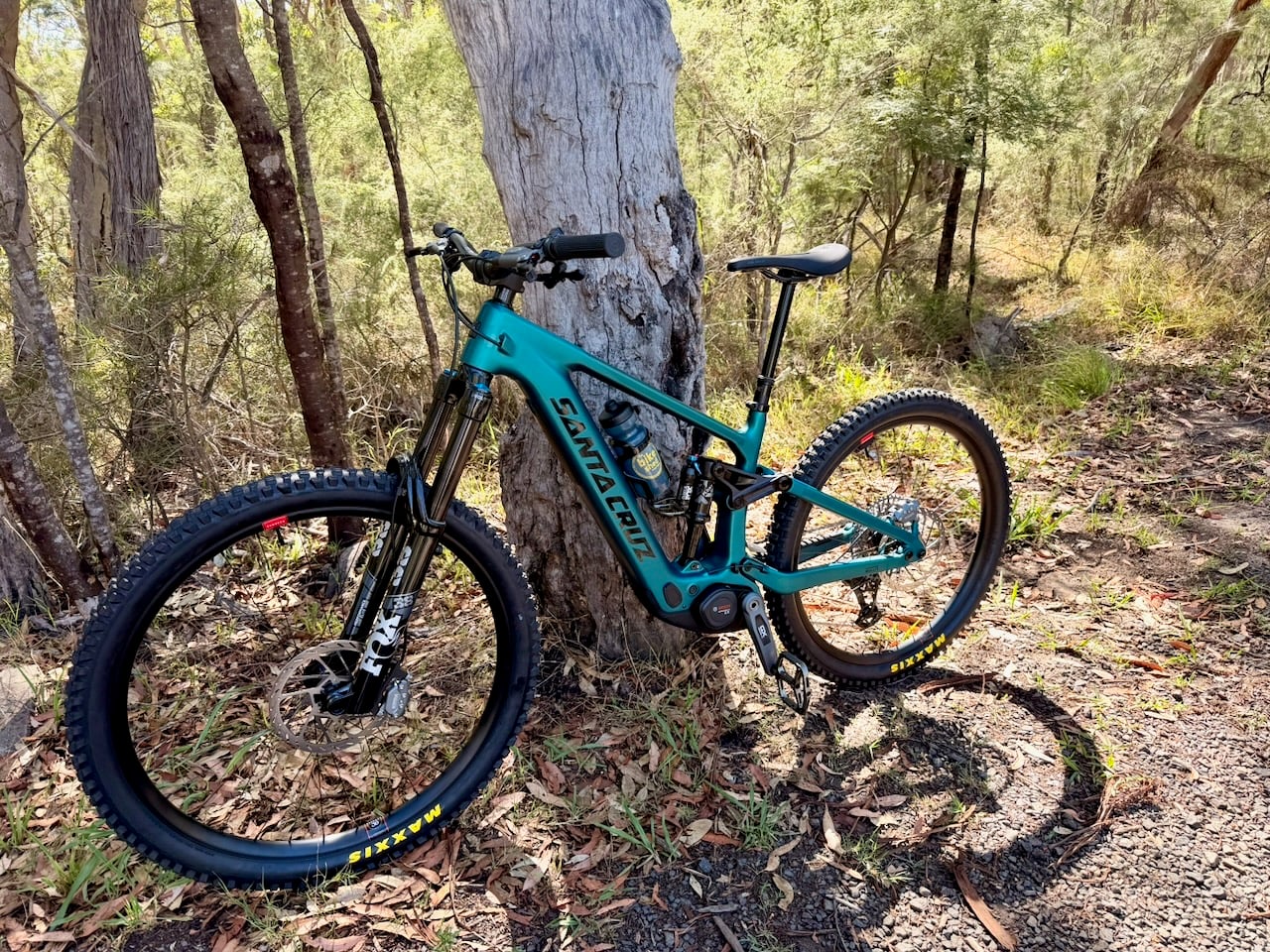

First ride today on a mellow'ish trail to dial things in. Felt really really good. Shock may need a little more air as the O ring is a few mm from the bottom and was only doing hip high drops.
Ride Wrap install went fairly well for my first time. Hopefully it all stays on after a few washes etc
