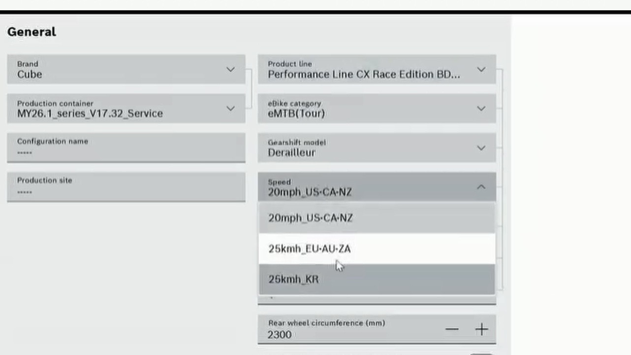

This is how it works:
You install teamviewer on computer(windows)!
You make sure you have a USB-C data cable to connect the bike to the computer.
I log in via the ID and password that teamviewer generates and make the change.
Then you can test and then make payment.
We set your bike's speed settings to the USA standard.
This makes your bike 32 KM/H also visible in the flow app.
We can also let it go up to a maximum of 64 KM/H, but we then halve your wheel circumference, causing the bicycle to halve its speed on the display, for example (20kmh=10km).
The flow app and updates remain fully intact.
Before the update, you must ensure that your bike has the latest software via the flow app.
Everything is done with original Bosch diagnostic software.
If you later decide to change from 32 to 64, this is free of charge or vice versa.
The cost is 75 euro I accept payment via PayPal or revolut.
This weekend only 50 euro!!

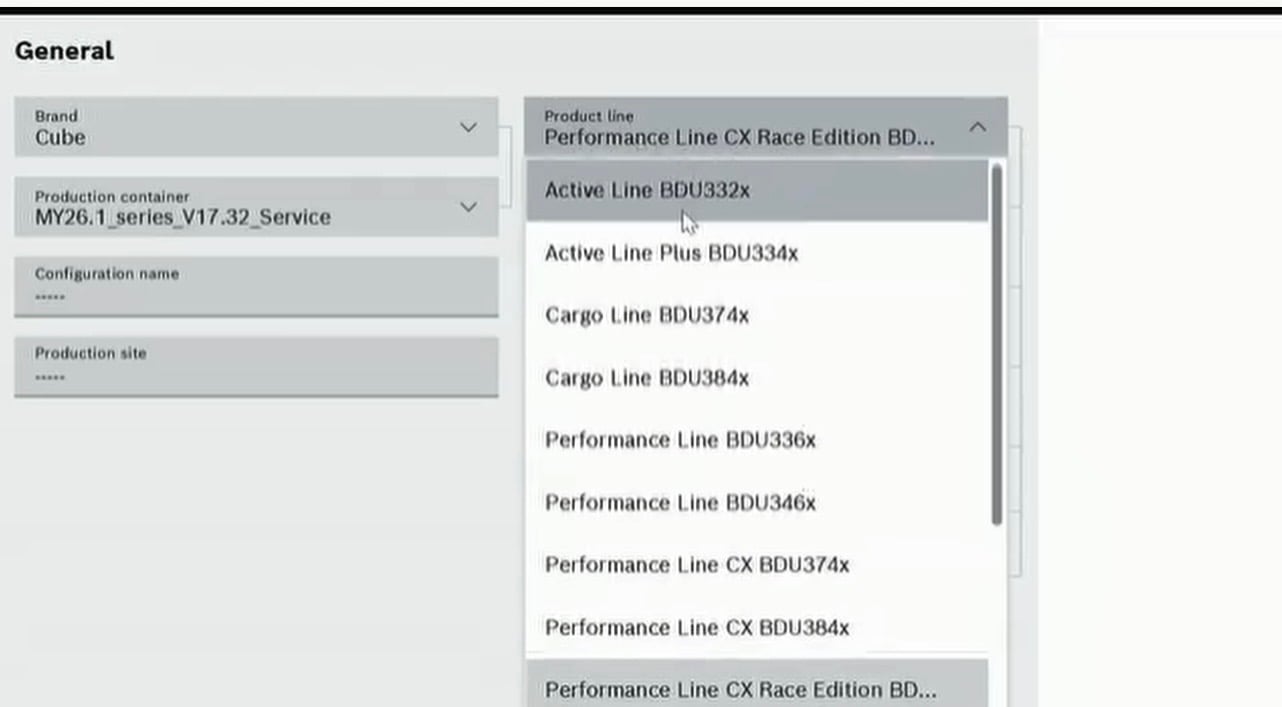

Can it be configured to 45km/hr without any issue to match the BDU388Y?
I wonder which tool this is.

It is the oem bosch diagnostic tool.
The 32km/h conversion working like with the original limit, can be updated in flow app.
The 64km/h version shows only half speed of the real speed on the display.

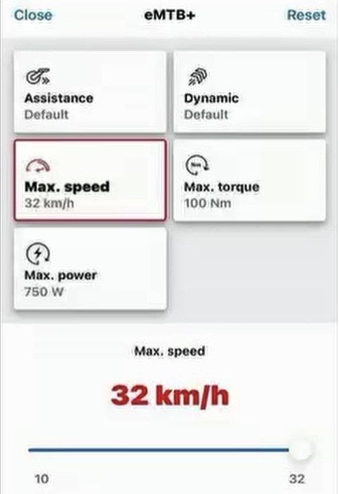

I highly recommend this procedure performed by Rudie:
5* service
5* speed (apx. 10 ~ 15 min.)
5* result
- All flow settings remain unchanged
- All Smart system components (Connect module, Purion200, Kiox300 & 500, and e-Shift connection) continue to function with their current settings.
- Simply put, the only thing that changes is the value of the slider in the max. speed tile, from 25 to 32 km/h.
- In practice, this means (in my case) 31.2 km/h
You even receive a status report of your bike in PDF format.
Only the speed limits gets changed power and everything stays the same.
