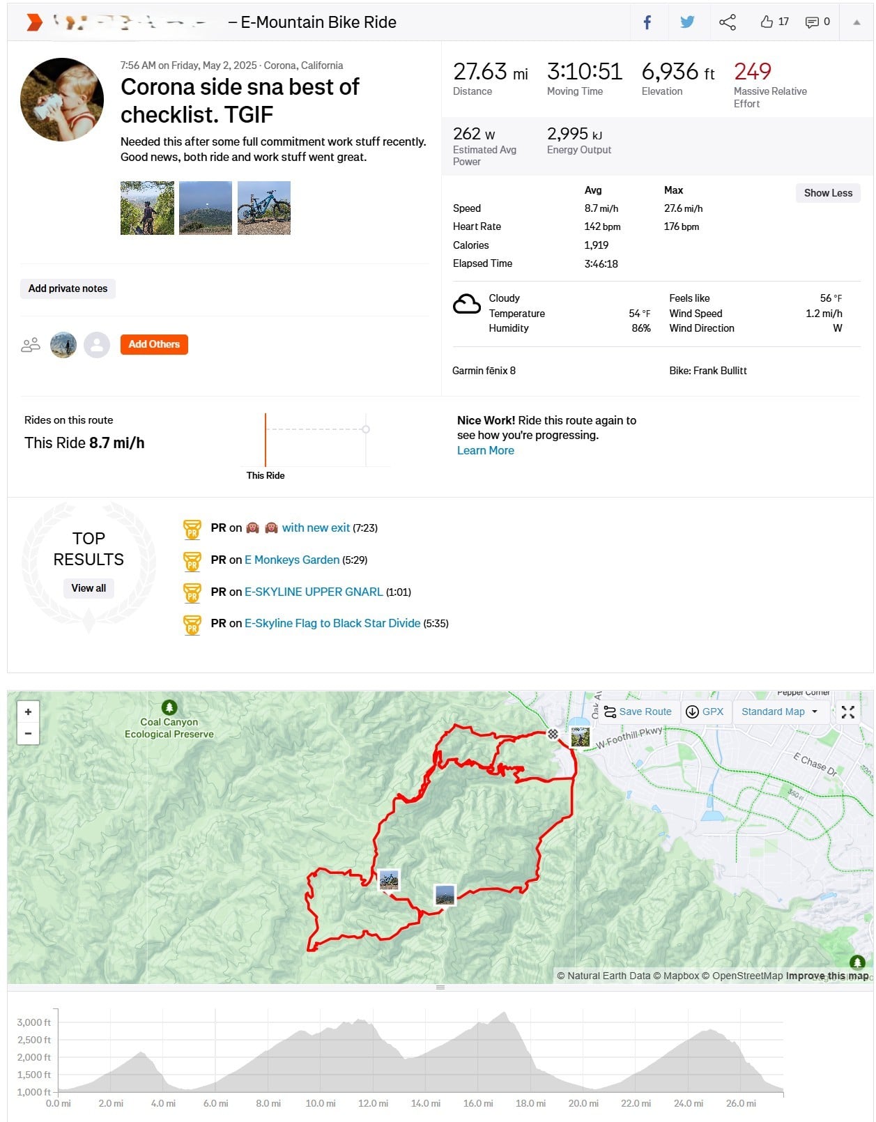

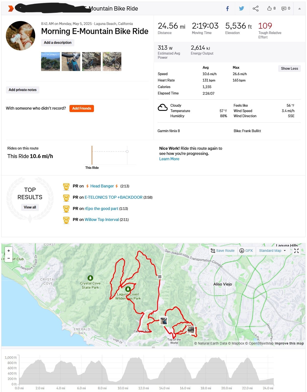

Day 1 - Epic Day Range Test - 27.6 Miles / ~7,000' elevation gain - w/Range Extender - 25% battery remaining. Mostly tour/emtb with boost a handful of times for steep climbs.

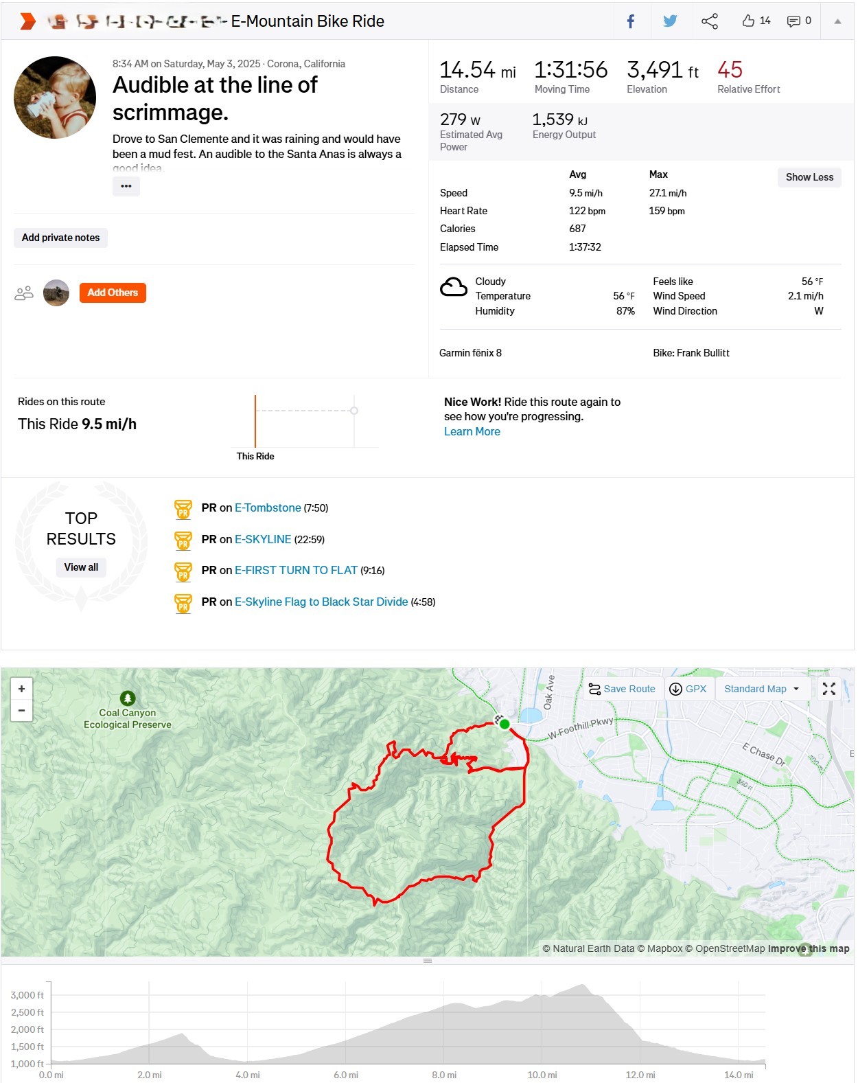

Day 2 - 14.5 Miles / ~3,500' elevation gain - NO range extender - 40% battery remaining - Tour/Emtb and boost for some of the steeper climb sections only.

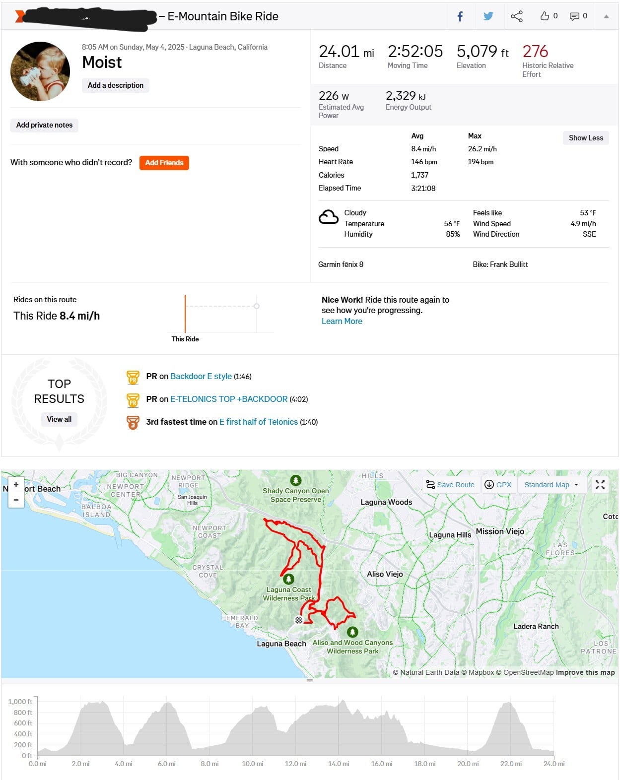

Day 3 - 24 Miles / ~5,100 elevation gain - NO range extender - 5% battery remaining - Nearly equal usage of all modes.
Day 4 - 24 Miles / ~5,500' elevation gain - Range Extender - 30% Emtb / 70% Boost - 15% battery remaining.

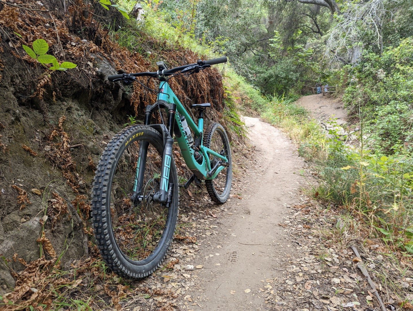

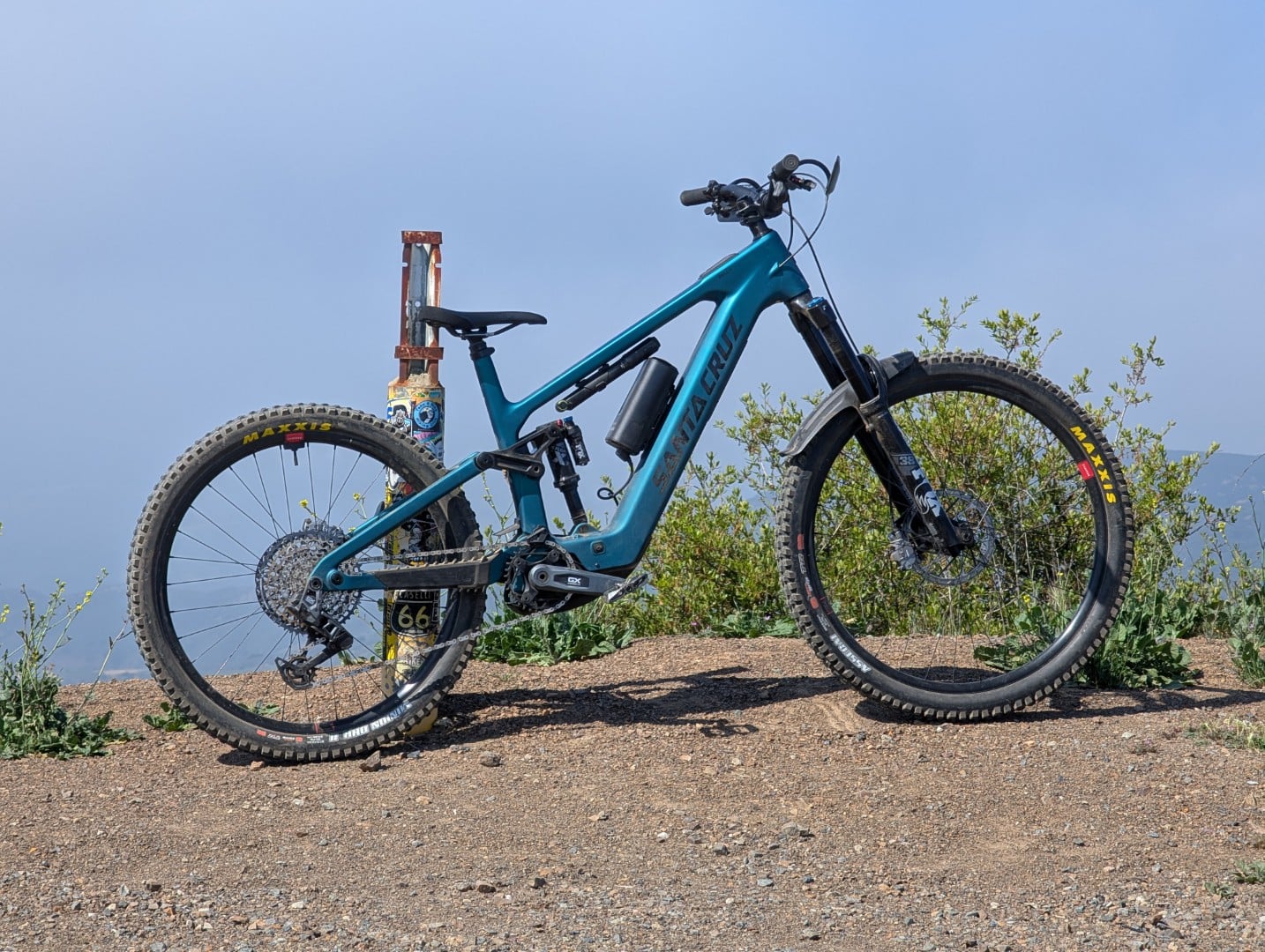

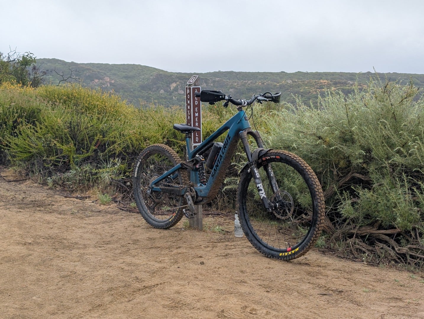

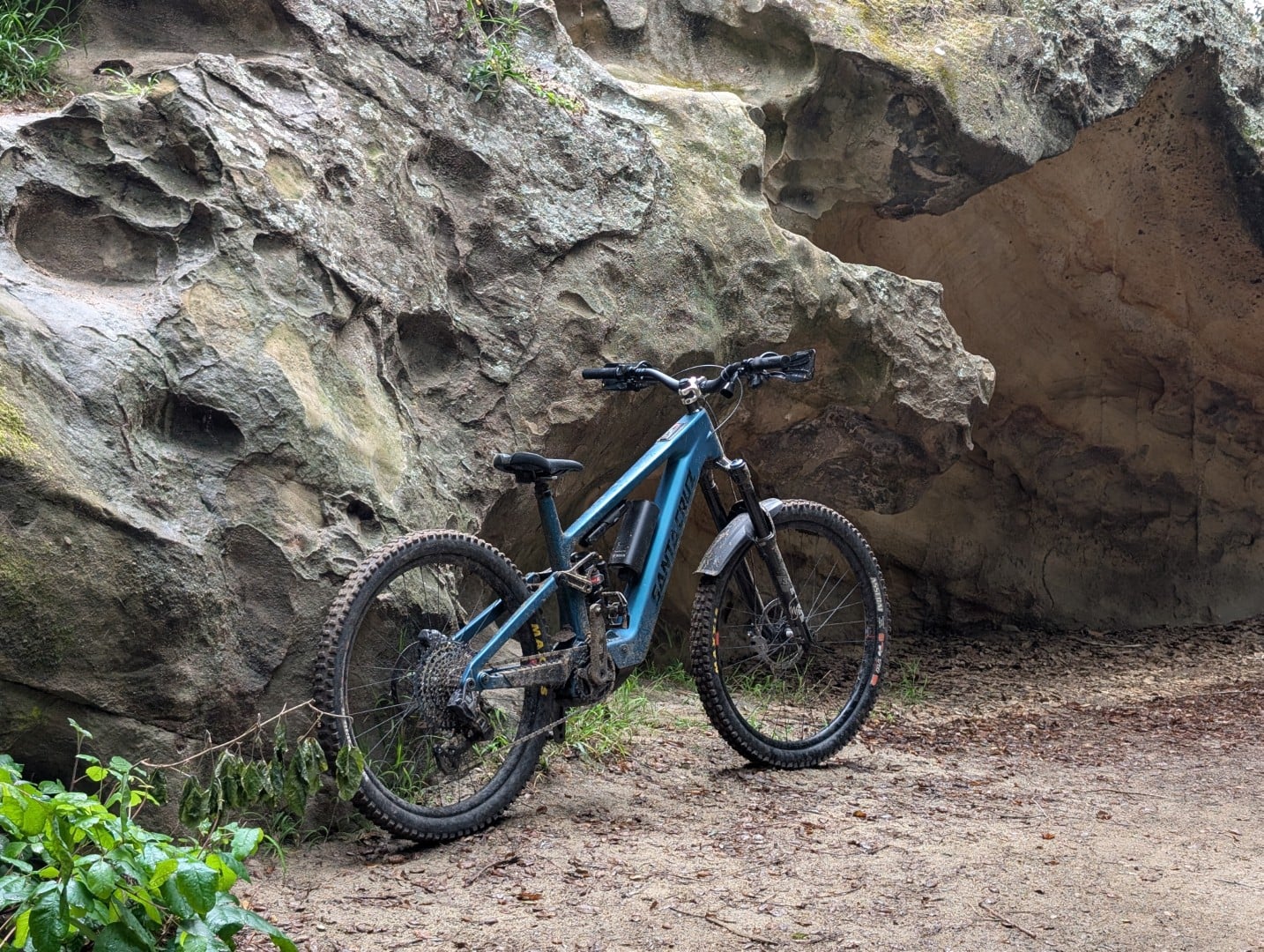

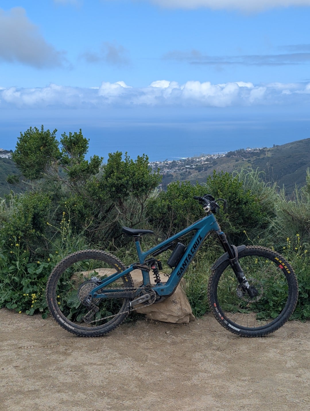

And some bike glamor shot photos from the rides along the way.
I bet there are loads of snakes hiding out there!

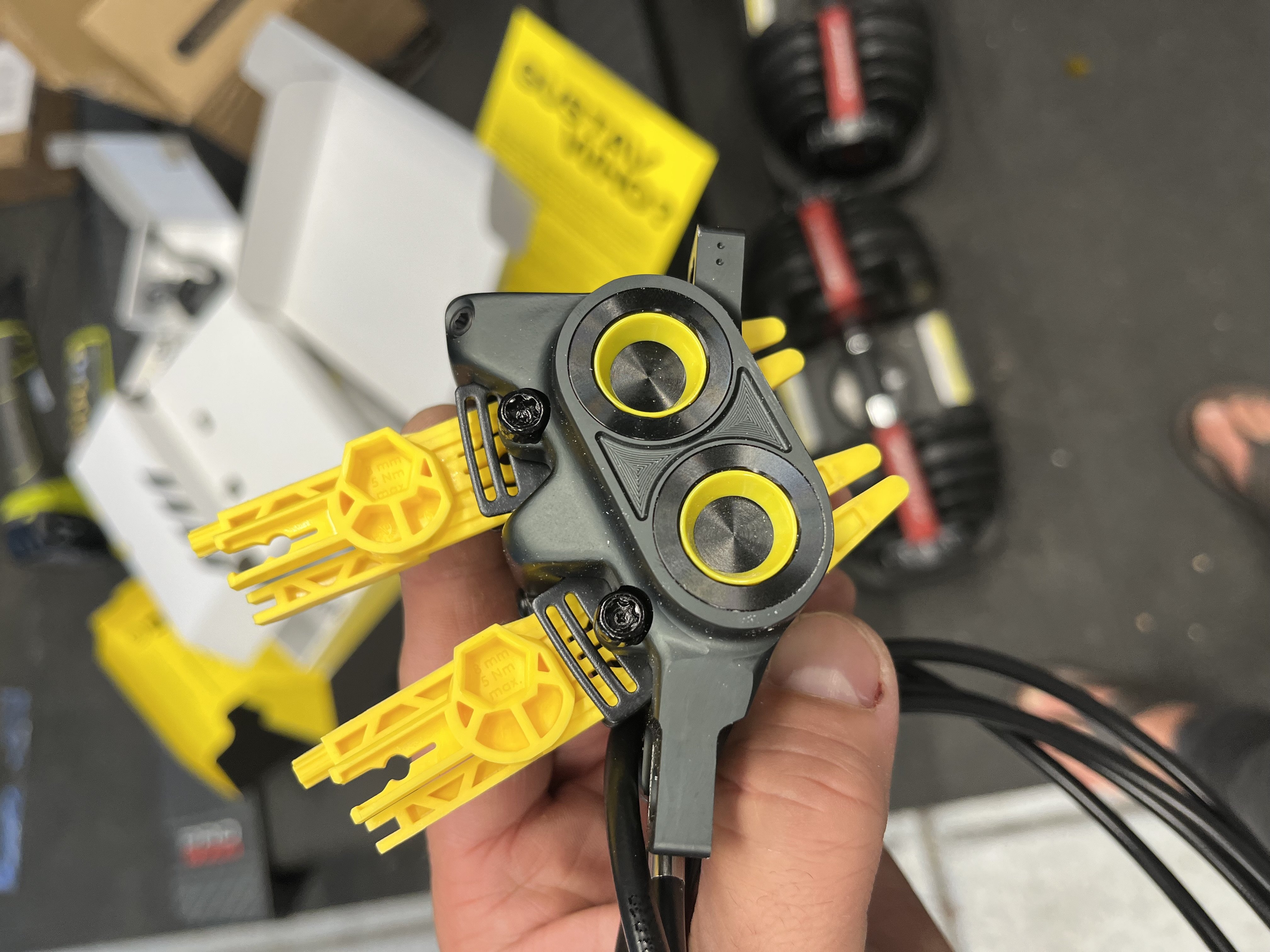

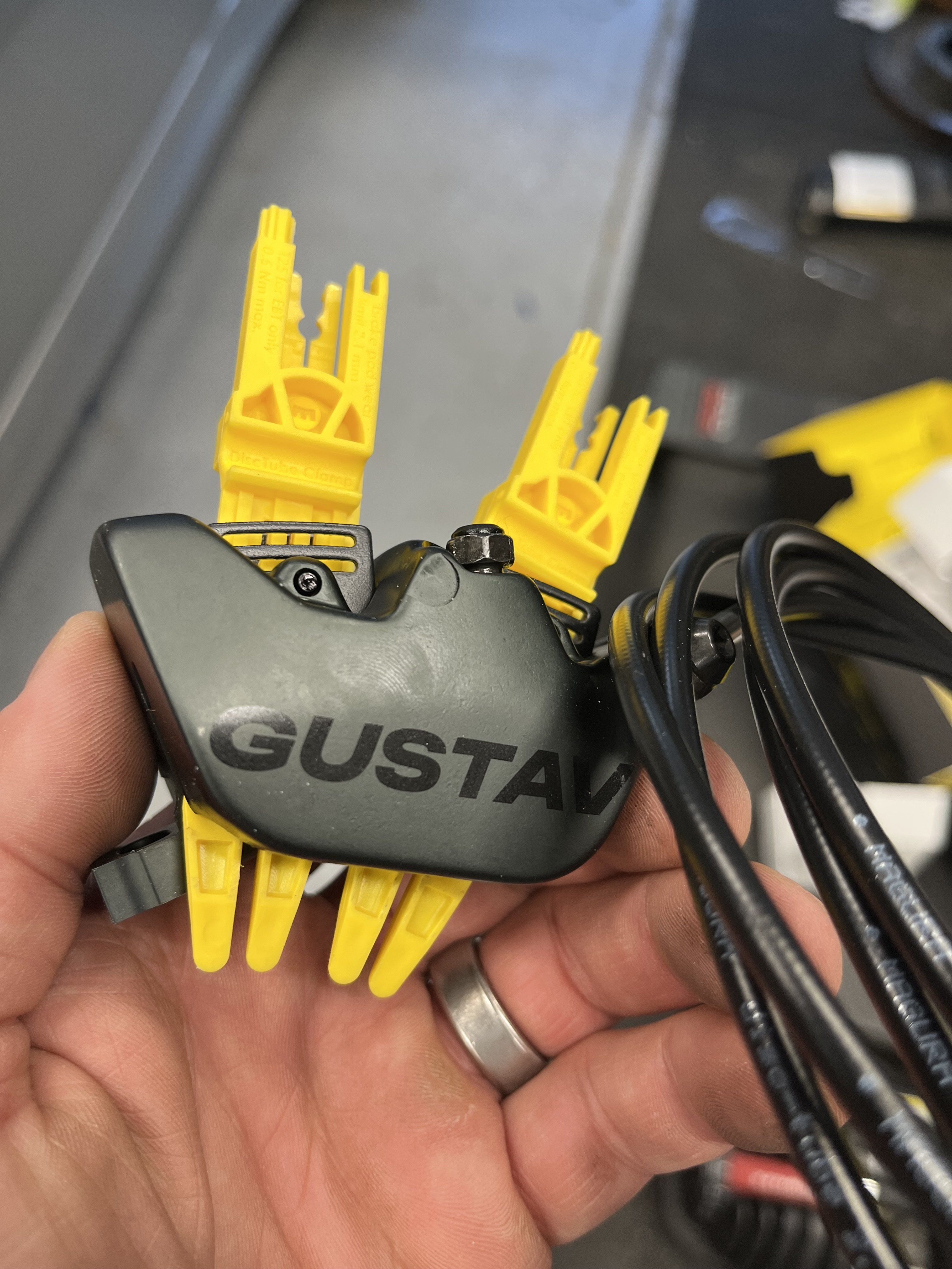

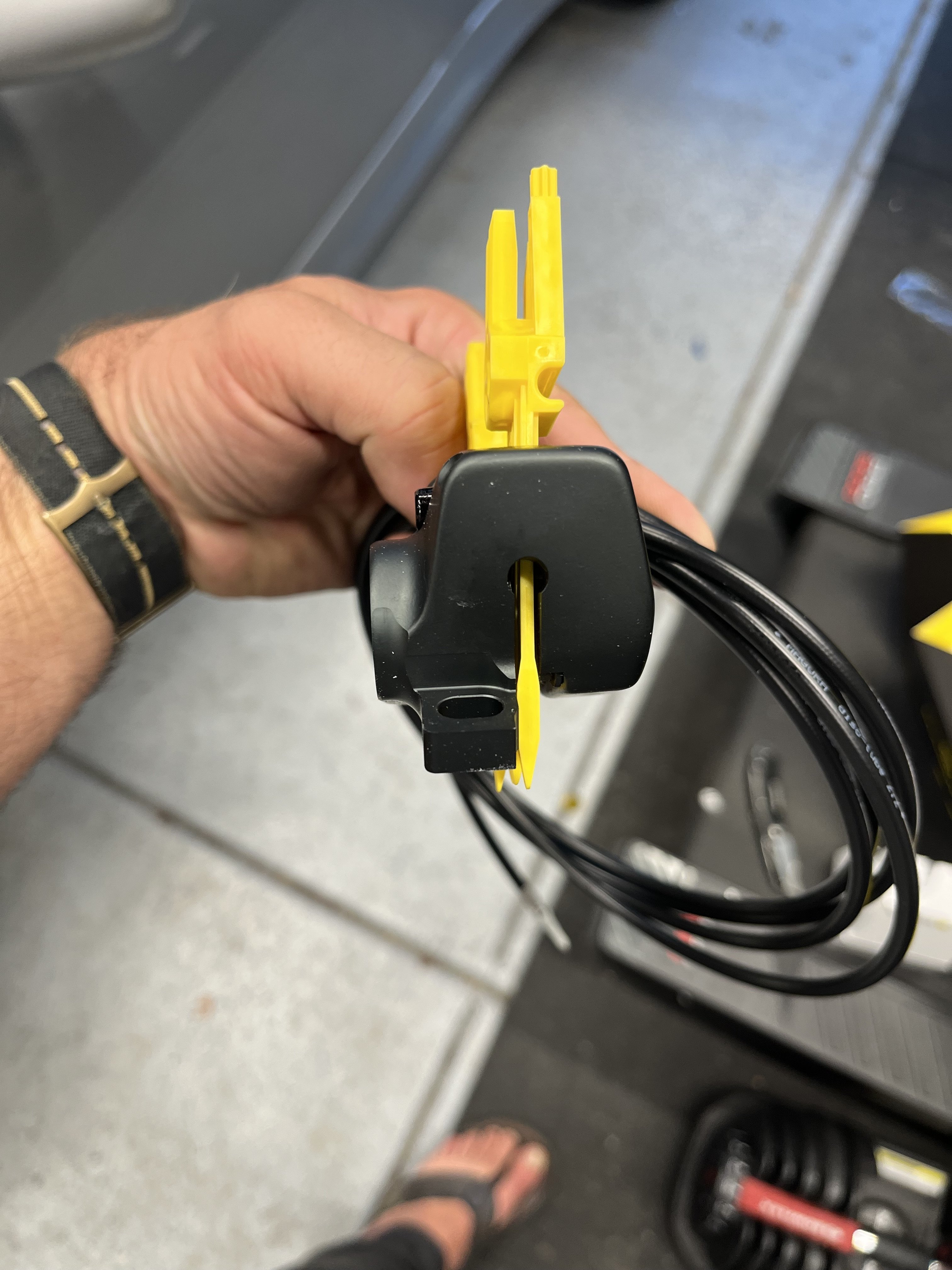

Parts are arriving for the incoming bike! Always run MT7s so figured I’d try out their new offering
